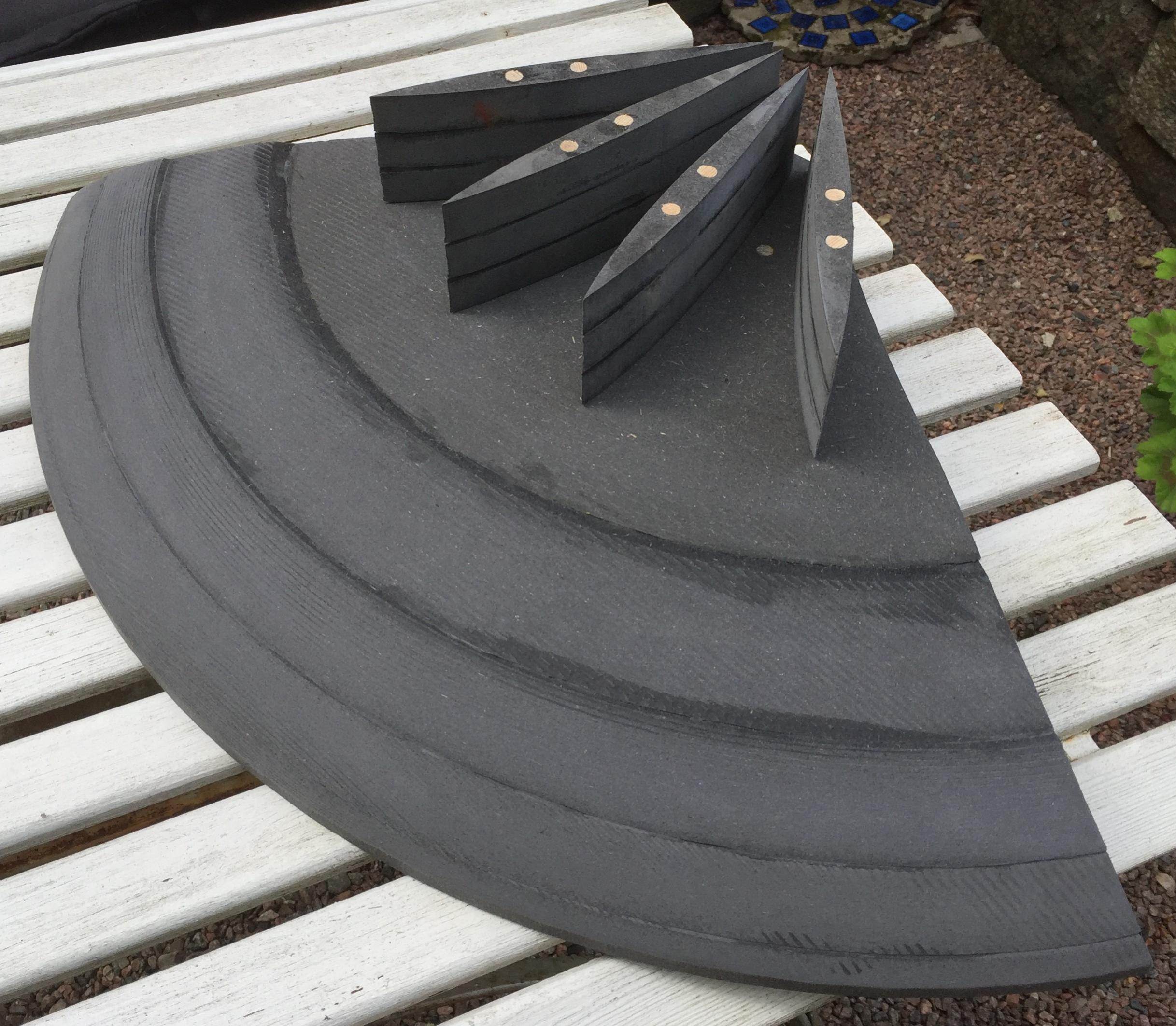

CAD plans are fairly easy. Getting them converted into the 2 STL files needed to 3D print them (you need a BIG 3D printer), or CNC files is the hard part.
If you have access to either and can convert the dxf, 7 pieces per horn (2 halves + the vanes) and away you go.
Can’t currently get at the picture of the file.
dave

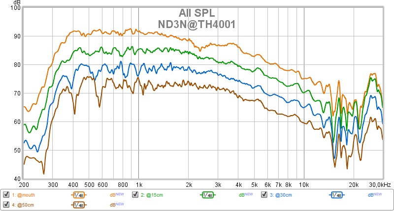

Only to show how good this design is another 18s driver ND3N attached to the TH4001 and this surprised me even more:

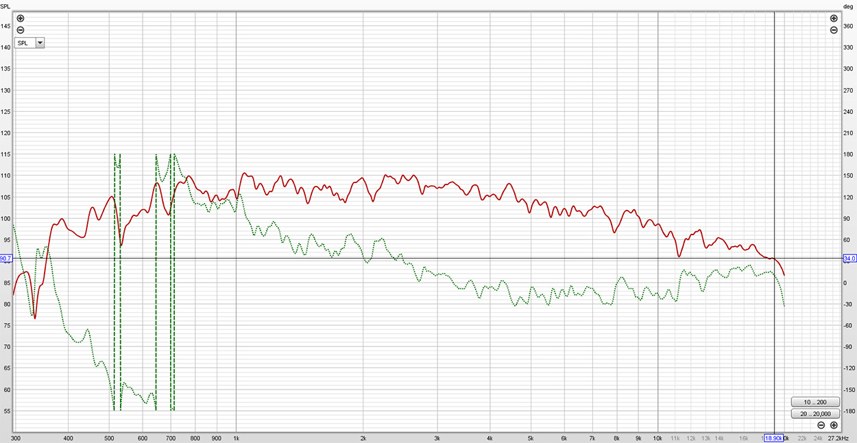

The curves have been separated within REW.
That woopty doo at 16khz is consistent I see....and the the low extension gets in trouble at distance
350hz elliptical tractrix at 36"
The magic of the Th-4001 must be in the horizontal dispersion and above 600hz
