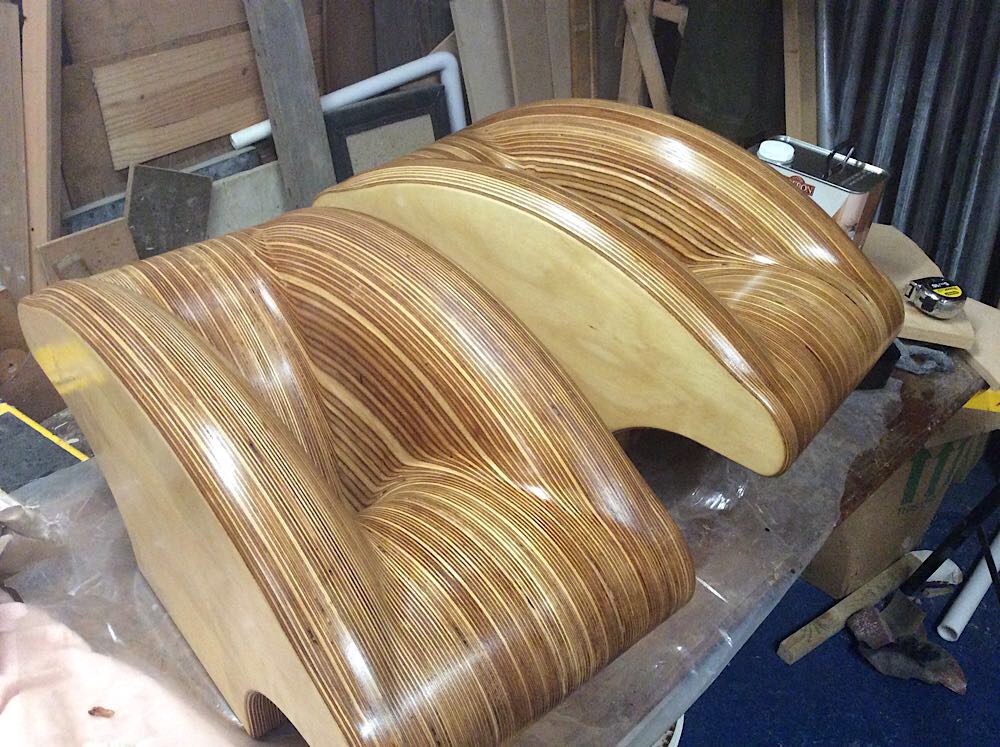

I recently finished a commission to make a pair of the ES290 for somebody, on my CNC router. Before I disassemble the fixturing is there anyone in the UK who is after a pair? PM message me if you are, you would need to pay Troy’s fees for his design as well as.
Is there anything that a CNC newcomer like myself needs to know in building these ES290's?

I’m the new owner of these horns and I can tell you they look great in the flesh. Very heavy and non-resonant. My horn guru is a great admirer of Joseph Crowe’s horns and I’m sure they are going to sound bewitching driven by my wonderful Colin Wonfor amps.
