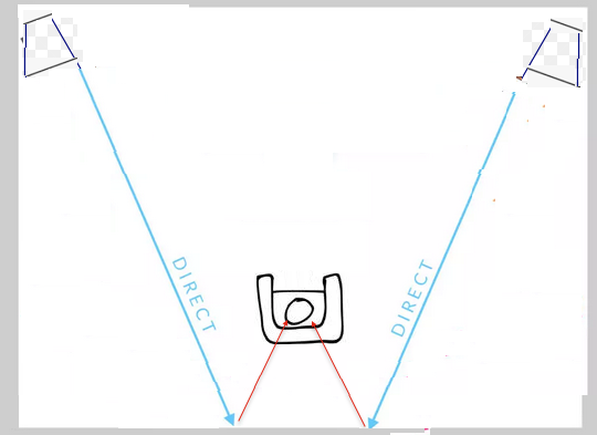

Incredibly 3D it sometimes sounds like it’s coming from behind you. Surreal.
Reflections from a high DI horn from behind the listening position may sound more like the sound is coming from behind than the more diffuse reflections from a lower DI speaker system.
Depending on the listening position in relation to the rear wall, and toe in angle of "Alternative_Eye's" horns, it's possible that the high frequency rear reflections are actually louder than the sound heard from the speaker direction, which could sound "surreal".
This diagram depicts a listening position where the direct "beam" misses the listeners head, but the red reflected beams arrive from the rear wall:
The reflected high frequency sounds are perceived as coming from either side of the listeners head from behind, while the wider dispersion lower frequency content will appear to come from their location as recorded.
Even mono signals will appear to diverge in space in that position, "incredibly 3D", is an interesting effect, not a credible reproduction.
One technique for "mono reprocessed to stereo sound" uses alternate frequency boost and cuts left and right. Frequencies boosted on the right are cut on the left, frequencies cut on the right are boosted on the left, creating a perception of a wide and shifting image, rather than a center image between the two speakers.
Listening to that sort of record in the above scenario can create a sensation the sound is coming from anywhere other than the speakers.
A more normal image projection of the recorded sound stage can easily be achieved by focusing the horns at the listeners ears, or a bit in front of the listening position for wider coverage.

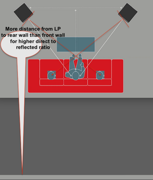

For a higher direct to reflected ratio (a more defined sound) the equilateral triangle apex should be closer to the speaker wall position than the rear wall.
Can't picture this; can you please sketch it for me?
