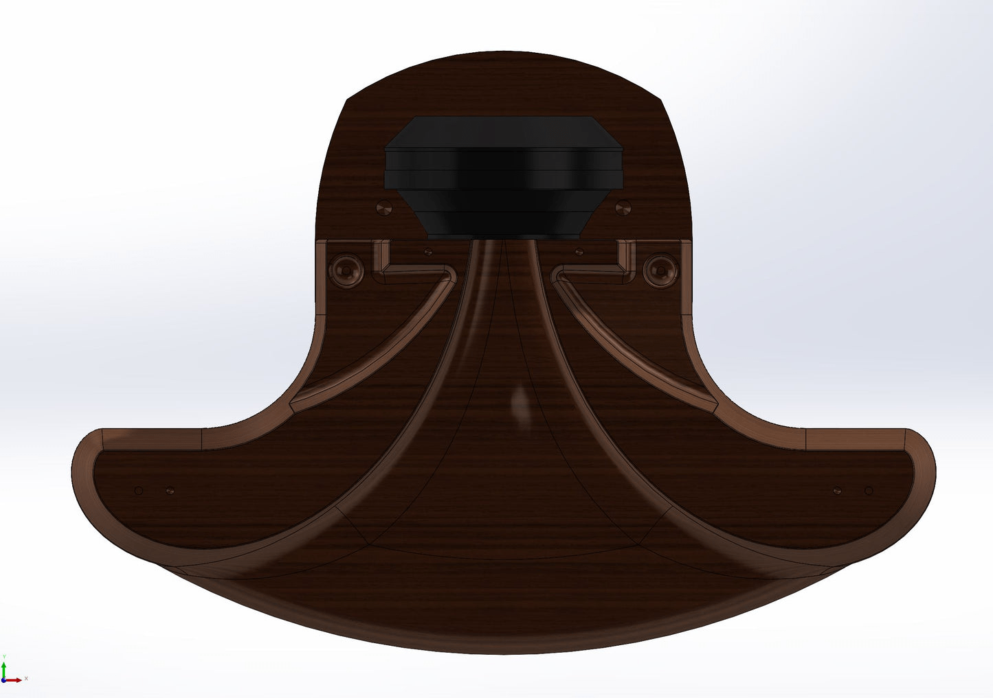

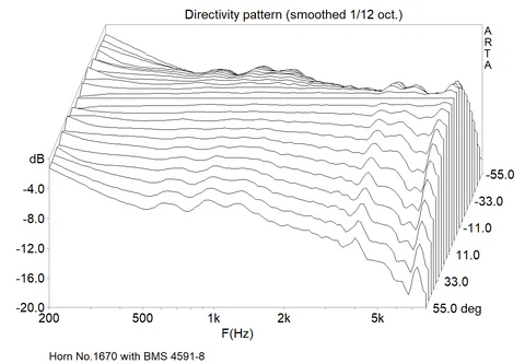

The polar in HF section has a little bit of Banding on the Troy 290. What exactly is the source would need to be figured.
The Effects of the sharp transitions can be seen in the Polar Simulation of the TH4001, at 700hz and possibly the source of the resonances at 1500hz, and slightly above and below 5khz but smoother off axis 5khz to 10khz
The Yuichi seems to be a more constant directivity and the Troy 290 rising DI from about 1500khz and up than the other horn.
Both good performing horns....

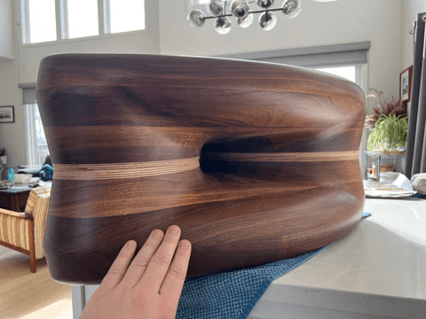

@oltos The horns are similar. I do prefer the thicker construction, regardless the horn profile. You should consider that we are looking at simulations of the Tad, above. Actual measurements may show that the horns are even more similar.
Exponential expansion
Vs
Wider sweet spot with the Tad horn
The Troy 290 will have a more focused sound on the top register due to high directivity.

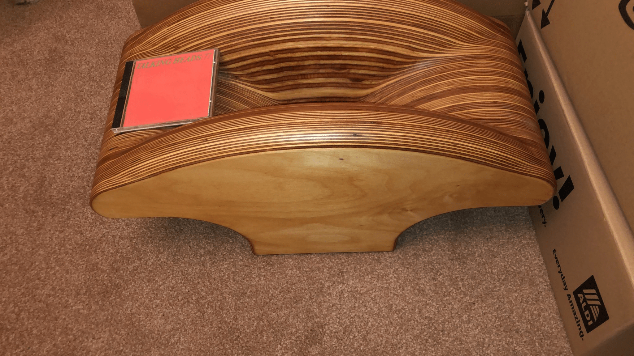

Proper executed expo horns sound more natural around upper cutoff than most others. My Athos A290s are more of a CD profile, similar to the larger JBL biradials, just with the vertical directivity flip around 1k. I believe this is common on most similar proportioned biradials. My issue is finding a driver which performs as good as the TAD without the price tag. I've found a PRV titanium/poly diaphragm driver which looks promising after dampening mods. The DCX50 is still on the table, but requires a proper adapter transition to make work up top. This is the issue with using other drivers on the original spec A290 throat adapter, as its designed for the larger TAD.
I was going to pair up a dual 12" midbass with the A290, but it really needs another FLH to properly gel with. I recently got a pair of 12PE32s in trade so the Inlow 100hz midbass horns would be a good pairing IMO.

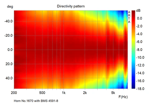

Meanwhile, how does this CD plot of Troy’s ES450 horn compare with the ES290?
Without even looking at it, the difference will be how far down directivity reaches. Waves can guided by the surfaces that are the same “size” as the frequencies being produced, which is to say, the larger the waveguide, the lower in the register the waveguide can have influence on directivity. Larger horns that are loading lower provide more sensitivity/efficiency, so looking at the same cover point, the larger horn will have lower distortion related to excursion. I would not trust the numerical designation of the horns in relation to cutoff as the number is chosen by the designers who are not synonymous in intentions or definitions of the term “cutoff”, still, if you are looking to cross over at 500hz-700hz, a strict approach would suggest a cutoff of 250-350hz.
Let’s say all your horn options are quality designs, I’d pic the biggest one and leave it at that.
Asking for subjective opinion is slippery slope into ambiguity. Stay objective to what you want, as your expectations are what you are likely serving. All your choices so far will result in high sound quality implemented correctly. You are trying to achieve “I am there” which is a listening experience dominated in Direct Sound. All horns discussed will give you Directivity which lead to that experience. Slight differences in performance causing difference in listening window and reverb. Objectively and on Axis the more narrow HF of the Troy horns will result in less excitation of the room but as I said you can also create the reduction of indirect sound, using room treatment. Size, once again, a bigger sized horn will allow the horns influence to reach lower into the spectrum and increased efficiency in lower parts of the tweeters reproduction.
It’s not which one is better, it’s what do you want, at this point, because they are all well performing horns at this point with only a little to criticize versus each other.

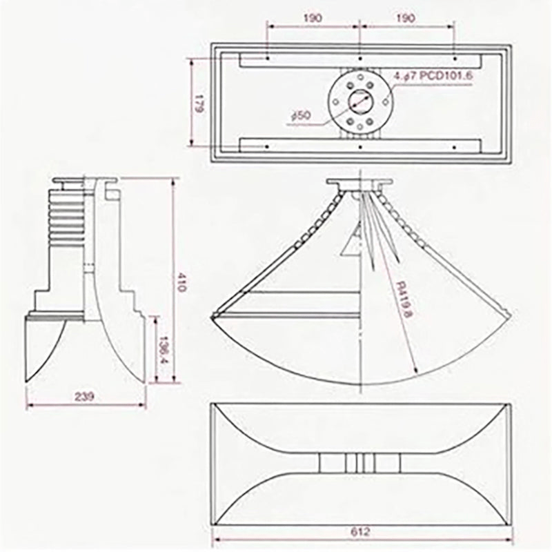

The TH4001 is an extraordinary good horn. Maybe the flare version (Yuichi) are even better but I have no experience.
The A290 is bigger than the TH4001, but even with the right throat adapter for the Radian745Be, because it's 3" rather than a 4" diaphragm the Radian can't cleanly cross at the Altec's ideal 500Hz Fc, even for home use, said https://www.diyaudio.com/community/members/fishball79.404/

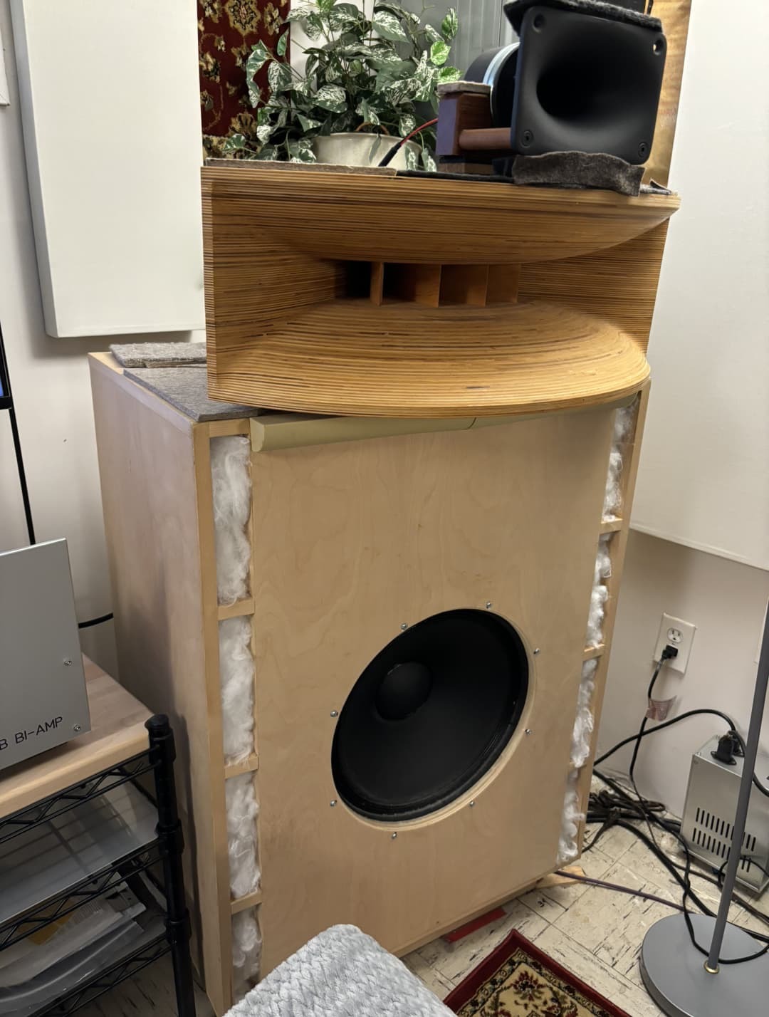

Ultimately it is the subjective result that matters, getting there seems to require a lot of work with the A-290 even with TD-4001 drivers, I have done thousands of measurements, treated the room, fiddled with the horn adapters to make sure the drivers are aligned properly to the flanges. (bolt hole diameter is too large) Lots of changes to EQ and crossover points over time, all of which is handled by DSP along with driver offsets.
The yuichi polars are not ideal for a room as small as mine, and they forced me to heavily treat the room in order to get acceptable performance. I like sound staging and lots of detail, I also like extended LF (I have subs), but truthfully have lost the entire top octave although I know when it isn't there. The joys of getting older.
I am making progress, but I am pretty sure knowing what I now know that I would have chosen a different route. I have also come to the conclusion that the Onkens are an 18 yr old mistake compounded with a deficit due to the center to center distance to the mid horn. The real problem is all of those ports. There is substantial output well above the range where I naively expected that to be the case, and there is also significant 2nd and 3rd harmonic radiating through the port which is well into the mid-range. (Yes it is as much as 50dB down) I have stuffed the ports which does seem to help with those harmonics.
