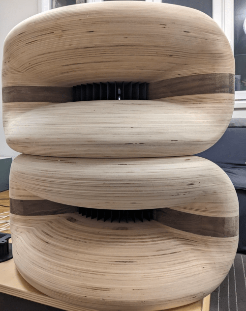

Looking at Yuichi A-290 or TAD TH-4001 Clones: Makers
Now, you're really asking from the impossible, at least from me. The best that I can do to help myself is precisely what Docali suggested: search for people who own this or those horn and listen to them. This will open up the mind in what direction to go.
What I described is the path that allows reliable analysis. You will be hearing with no reliability in judgement of why you are hearing what you are hearing in the first place.
The jmlc does have a proper roll off in all directions. You should create a list of expectations, that will help people, help you.
You are getting a little overly worried. The vertical off axis of the bi-radials are not optimal according to technicality but obviously its not a deal breaker considering some of the best horn designers on this forum have favor towards them. Matter of fact, just save yourself the time and go with the trends and opinion of the much more experienced and get the Yuichi/4001 horn. At least you can be confident in the choice of the people with much more experience.
There isn't a flawless option btw. Every horn you think about will present another set of pros n cons. My advice was to choose the biggest, quality, one, you can afford and to use a healthy dose of room treatment. This will get you your healthy dose of direct sound that you claim to desire.

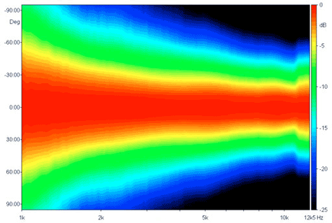

Even with my stunted grasp of those CD plots, those for Audiohorn biradial looks way better with that JBL driver. But would it remain that good with the Radian 745Be-and when equalized for extended HF response?
Furthermore, contrary to what you've been suggesting all along, this is hardly a wide horn. That page says that the biggest version is 36cm; less than 15 inches, or about 9 inches smaller than the other two horns. And numerically, what do you suppose they mean by "mid-distance usage"? Sitting 11 ft from the speakers with them placed 2.5 ft from the rear wall?

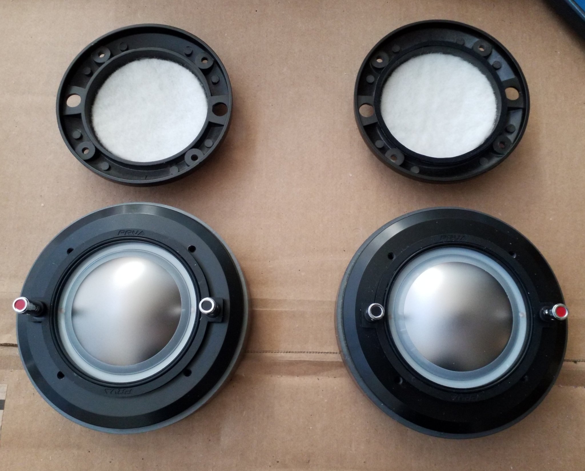

These are the 2" PVR D3220Ph drivers which have been outfitted with the hybrid Ti/Mylar diaphragms. They have a shallow throat exit angle and sound very extended for an off the shelf reasonably priced driver. With the diaphragms they were only $160 each. They badly needed a layer of wool felt in the chamber to stop some of the hash above 8k. Otherwise they're exceptionally smooth considering the price tag. I'll measure them again once they're back together with properly aligned VCs.
And BTW, I align most VCs in compression drivers using THD measurements, not just relying on manufacturers machining tolerances being accurate enough to just blindly bolt them on. There have been times I needed to sand a spot or two on the pole plates from them being out of center.

I think that elliptical horns are a middle ground between circle horns and the rectangle biradial horns. Their polars are something below
Not to detour you, it seems that you are set on by biradials and I think it's a good choice. I would look into the modern biradial that I posted above and see if they can make it in a larger size and if not, just go with the Yuichi/4001 horn. You also have to think about availability/cost.
