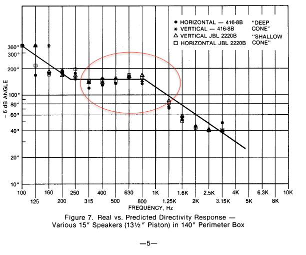

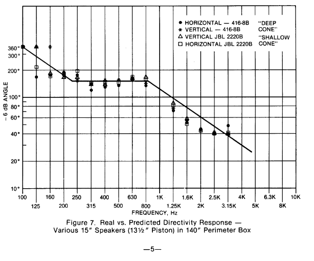

Sorry, my igorance. I thought Fc was crossover frequency. I did find this, though I can't assimilate enough of the info here to attempt to usefully answer my questions. http://alteclansingunofficial.nlenet.net/publications/techletters/TL_237.pdf
The info shows the 416B wouldn't be considered "beamy" (less than 90degrees) below 1250Hz, where it's -6dB level would be 80 degrees.
Even as high as 1000Hz, it's beamwidth is around 110 degrees, similar to the Yuichi A-290 high frequency horn.
The woofer beamwidth really is of no concern in the 400-800Hz crossover range you may be considering.
But Pierre said that given his TH4001, that (his TAD 1601B) woofer beaming is mostly due to the diameter differences in his 3" RadianBe driver and the 15 woofer. Thus would a 4" RadianBe result in substantially less woofer beaming?
Since you "can't assimilate" the concepts relating to beamwidth or polar response, as they relate to woofers and horns, you are probably misinterpreting something Pierre said.
The high frequency compression driver's diaphragm diameter has nothing to do with the woofer polar response.
The design of the compression driver's phase plug, it's exit diameter and the throat coupling do have an effect on it's frequency and polar response when coupled to a horn. That said, no aspect of the compression driver will have much impact on the horn's polar response in the range from 400-800 Hz.

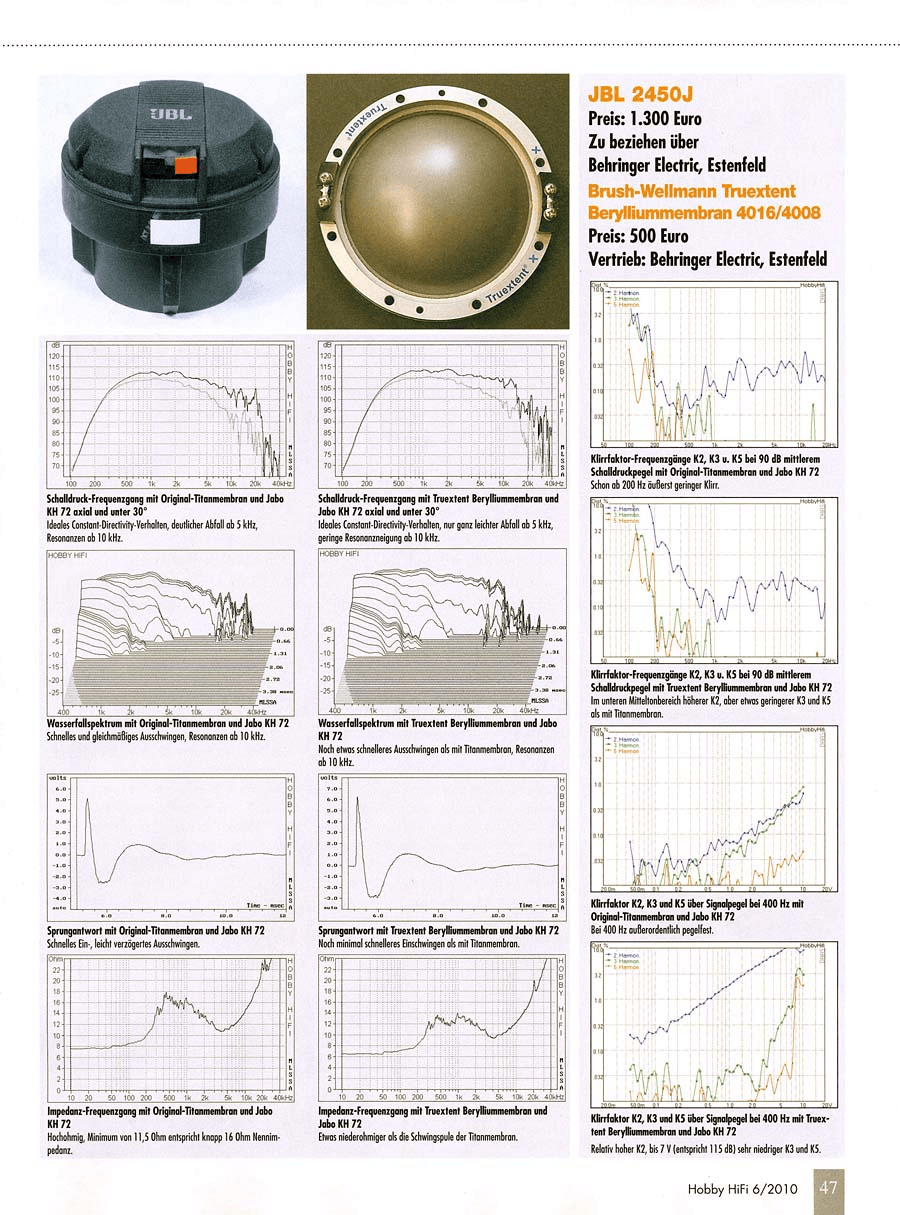

Those K&T measurements were done on an early batch of Be diaphragms which had some issues - this has been widely reported.
Sadly, there have been no other semi-official / reputable measurements since, though 🙁

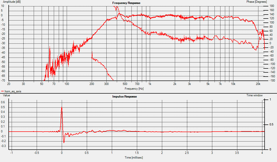

Below are my own on-axis measurements of the JBL 2450J + Be diaphragm, when mounted to the Yuichi Arai A320FL horn (a "fin-less" version of the more widely known A290, with similar geometry but without the vanes):

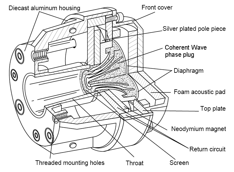

I have seen you mentioned Joseph Crowe in some posts at some point i believe.
Take a look at the 3D model pictures in the link below of the ES-450 with the TD-4002.
See how the exit of the compression driver is smoothly blended to the horn, and the horn "throat" maintaining the same shape as the exit from the compression driver.
https://josephcrowe.com/products/3d-cad-files-es450-biradial-for-tad-td-4002
Having a horn that is a mismatch to the compression driver will have detrimental effects to different degrees.

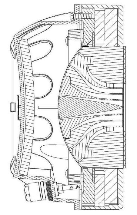

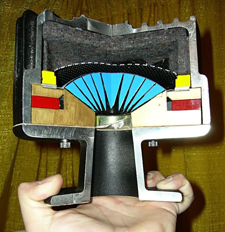

The last pictures i added, you can see the cutaway of a JBL 476 (2450sl style), with the phase plug ending at the driver exit and 0 deg. angle.
Where the cutaway TD-4002 has a throat starting infront of the phase plug that expands from 39 mm to 2" through the throat adapter. And the horn should follow the same shape, set by the drivers internal throat geometry.
And even at 39mm exit, the driver has a short internal throat still.
And a cutaway of the 475ND which is based on the 2450H/J.
