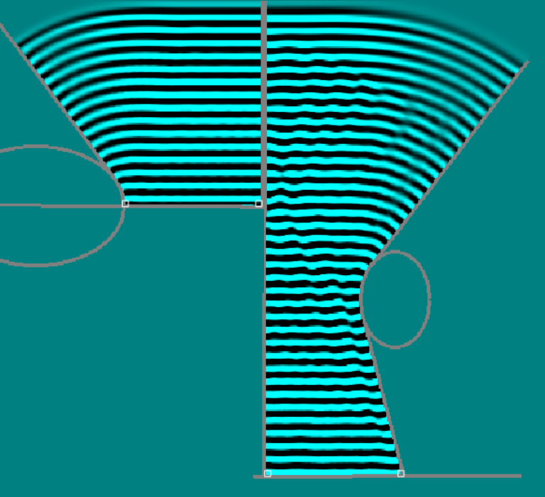

When oltos mentioned it recently I began working on a way to show the effect of pinching an adapter. It's often said that a diffraction slot is problematic.
What is less often said is that a reduction in area preceding it causes reflected higher order modes.
In addition to this there can be axial reflections.

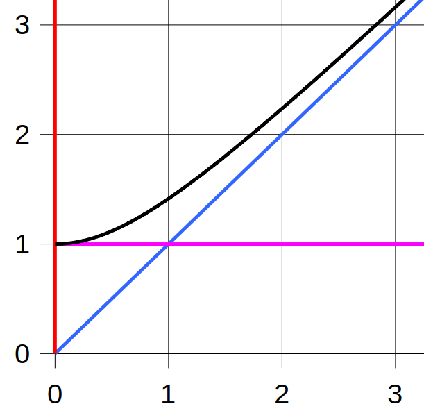

Unfortunately, Hyp/Ex is not a one parameter expansion per the Webster plane-wave approximation.

If or if not a function is one parameter wrt Webster eq. is irrelevant. You can do everything what you prefer and like.

If the adapter doesn't line up just right at the WG entrance and retain the sidewall shape it will produce reflections and other artifacts. The adapters which came with my A290s didn't line up well with the WG entrance. There was at least a 1/16" mismatch in shape in both planes. Even if the driver exit angle were appropriately chosen, the adapter discrepancy would have significant hurt performance virtually everywhere in the curve. I confirmed this by using modeling clay to smooth out the transition, which improved performance everywhere, especially below mass rolloff. This was with a B&C DCX50 driver.
A chosen driver for this WG would have to be suitable for a slower expansion rate after the phase plug. A low exit angle would definitely be more suitable, rendering a shallow, shorter driver exit wall profile a poor choice.
A planar wave front is necessary with the A290 WG to get the best performance from it. The adapter mismatch is an additional issue which is much harder to solve, requiring a complete redesign of the adapter IMO. I would venture to bet a short 1.4 to 2" adapter with a decent, low exit angle driver would be more suitable for this WG. It would open up more choices for compatible drivers and the smaller WG throat would improve HF extension.

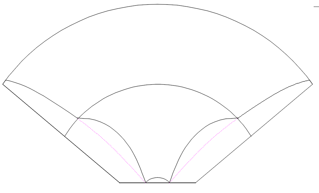

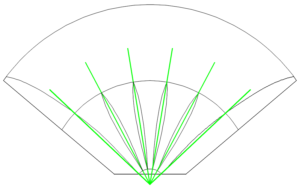

It is shown here that notwithstanding the vanes, the overall horizontal situation is conical like. The expansion will not do anything to turn a plane wave into a radial one before the vanes begin, other than what naturally develops over that small distance.The A290 throat is designed to feed the individual horizontal sectors with a flat plane of pressure waves up until the adapter exit point, where it expands to follow the horn curvature.
Unless you use a multicell adapter, you have to take it as a whole, even though the vanes cause the total included angle to be less.
I've drawn the horizontal expansion without the vanes, showing their combined effect.
