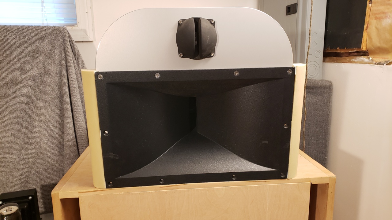

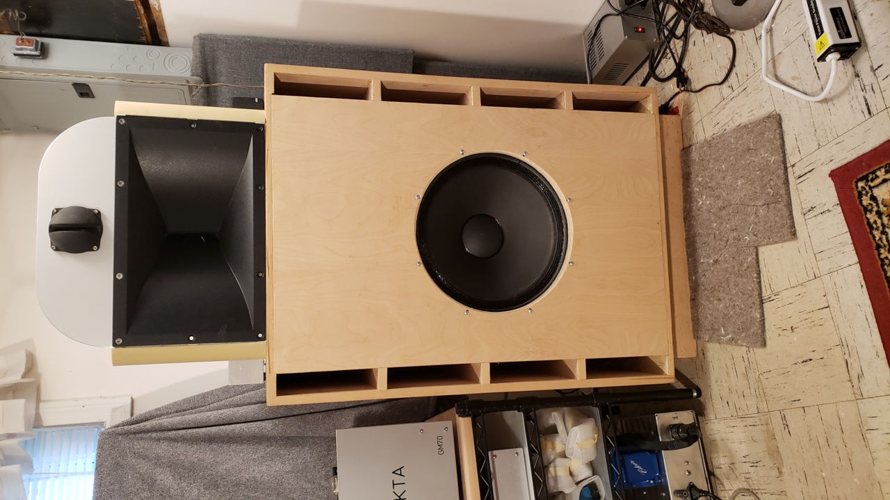

For you bass cabinets this type of horn is a very good choice imho as they have a small vertical foot print and a very good horizontal dispersion. You can read more about this type of horn in Kolbrek/Dunker's book also with suggestions how to improve them.

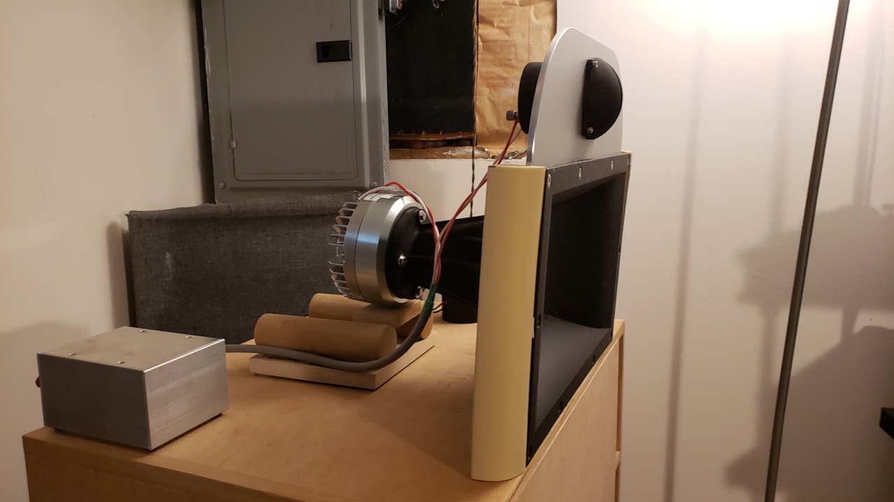

It is hard to get dimensions right from your photo but I would have placed the bass driver more in the upper region to have the acoustic centres more close to each other.
On the other hand, crossing at 600 should bring this within a wavelength. The floor bounce is also near the cross, which might be a good thing. Moving the woofer higher could push the null down into the woofer passband, and it might not be low enough for an easy EQ.It is hard to get dimensions right from your photo but I would have placed the bass driver more in the upper region to have the acoustic centres more close to each other.
Worth investigating though.

The center to center spacing is sub-optimum which is one of the reasons I am interested in a horn with a lower cutoff, that and perhaps a fairly healthy dose.

A lower loading horn could definitely increase the CTC, which is why I would not want to go over 30cm height. The 2380A is a tad under 28cm. I think any of these horns fit within my constraints.
Like the Strauss my horns are angled slightly downward although not to the same extent (perhaps 6° or so) to address the vertical directivity of the horns relative to my listening position. Works much better than the 0° I used for years - this is a change implemented early this year and carried over when I replaced the drivers.

The appeal of the A290/TH4001 was that it can cross comfortably below 1khz and even lower. What I didn't really consider was how the two different horns differed. I see now they are similar but not the same. Which does one pursue?
Understanding the errors in my design and that I also recognize I made those errors I think it would be fair to share some pictures of the speakers and the system in general.

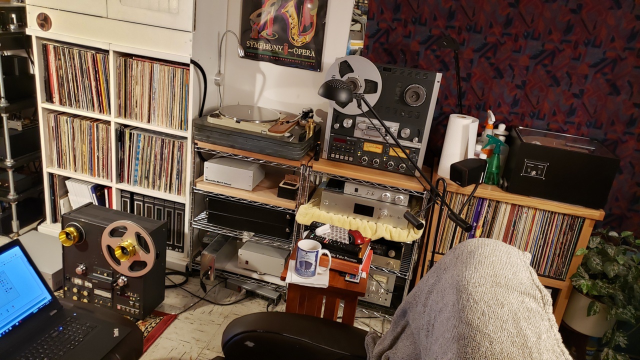

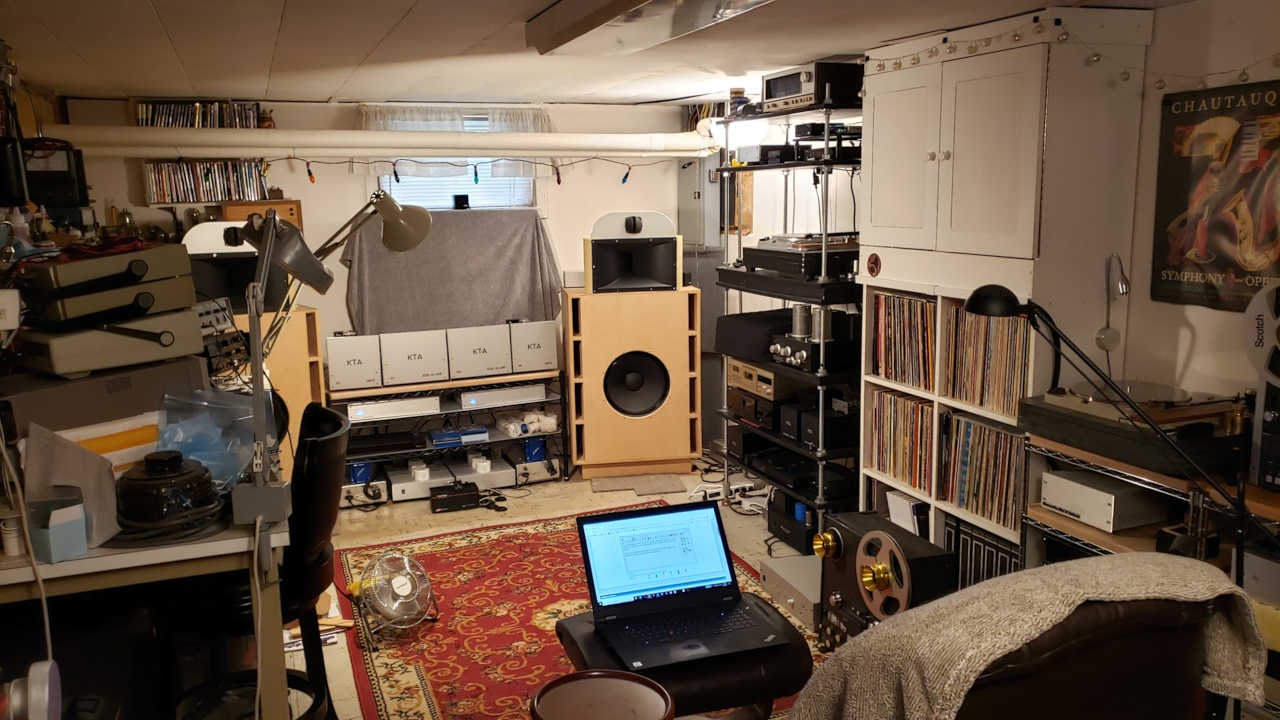

My room is small and cluttered which is why I like these sort of horns, their controlled directivity works really well in my room.
This has been an ongoing project since 2006, and I expect the evolution to continue to some extent into the future. (KTA is in honor of my long defunct audio business.. lol)

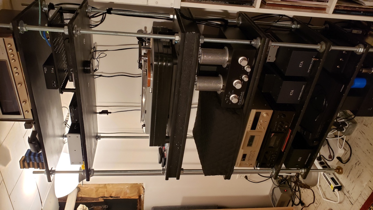

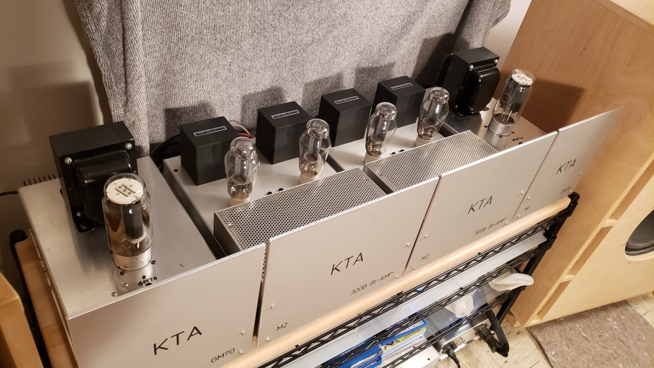

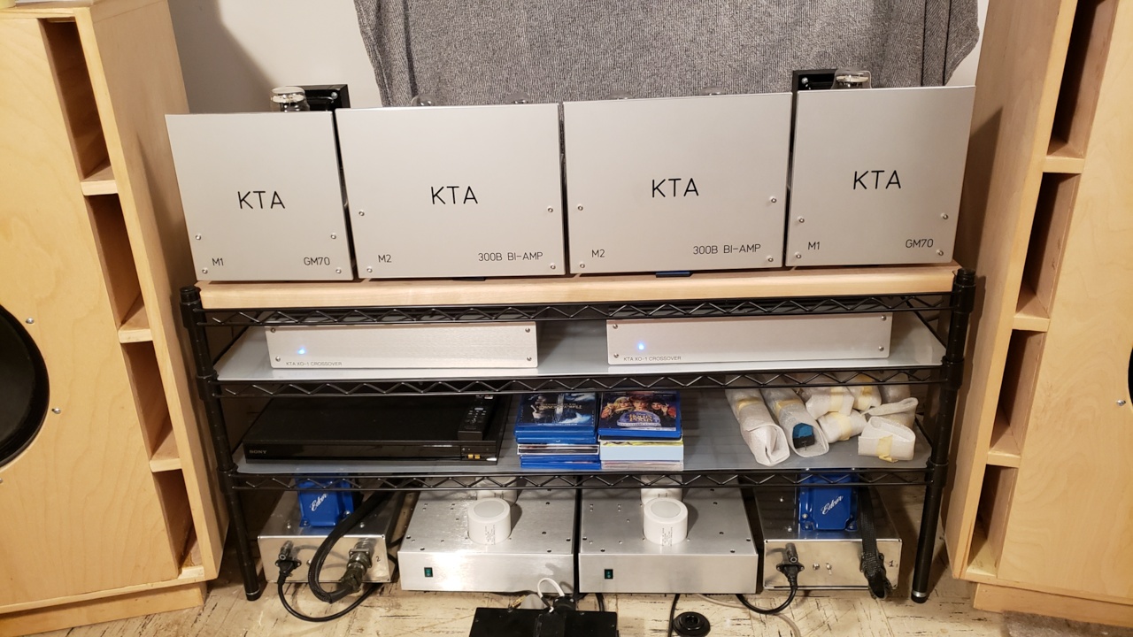

The architecture is line stage > MiniDSP SHD > electronic crossovers > hybrid tube amplifiers > drivers.
I am currently running Dirac3 on my SHD. All of the electronics are of my own design except for the SHD.
Sweet spot is really for 1 or at most 2 people. Under the current circumstances there are no visitors.

I left the idea of a lower loading horn with a question mark because I am not 100% on that...If there is not a full flair on the vertical portion of the horn, like with some rectangle and elliptical shaped horns...it is in the favor of CTC though not in favor of vertical off axis performance....I think around 200hz and lower the wavelength gets big enough that it relaxes, to a point where optimal CTC can be achieved with a horn....looking at the bigger horn, a round tractrix, is about 23" inches....13550/200/4=16..... that horn directly on top of a 15" would be around 19"....as long as we can expect to go a little bit lower than the tuning of the horn, this would make it. Even being off only 3" isn't too shabby, as long as SQ is still acceptable...A lot of if's involved there lol....Docali helped be arrive at the Hvdiff which is elliptical and tuned to around 170hz...we are hoping this will allow a 200hz XO with the Axi.
Woofer too far from the horn? Turn those Onken upside down! 😀

I always wonder what people are thinking when they place the woofer so far from the top baffle...Theres enough space on that front baffle to mount that horn in it....
Camplo, You pretty much hit the nail on the head, the original intention was to mount a 2391 horn and lens, and 2420 driver inside the cabinet just above the woofer. I ended up going a different route and ultimately after many trials ended up with the current set up a couple of years ago.
There isn't quite enough material to mount a 2380A in the available space, and back in 2006 when I designed the cabinets I was too inexperienced to know what direction I was going in.
I don't think in 2006 that I had any idea that I would still be using these bass cabinets 15 years later, more or less unchanged. Knowing what I know today I would have done some things differently.
Unfortunately flipping the cabinets isn't an option, the bases were not designed to be removed once installed and attempting to do so would likely compromise the panels they are attached to. WYSIWYG 🙂
I can fit a horn on top of no more than 80cm width and 50cm depth - and horns in that size range are likely too big for this room, and create mounting issues - I am not a good carpenter and most importantly I really don't want to be over 100° horizontal pattern in this room. I'm really looking at staying under 70cm wide and no more than 41cm deep excluding the driver.
