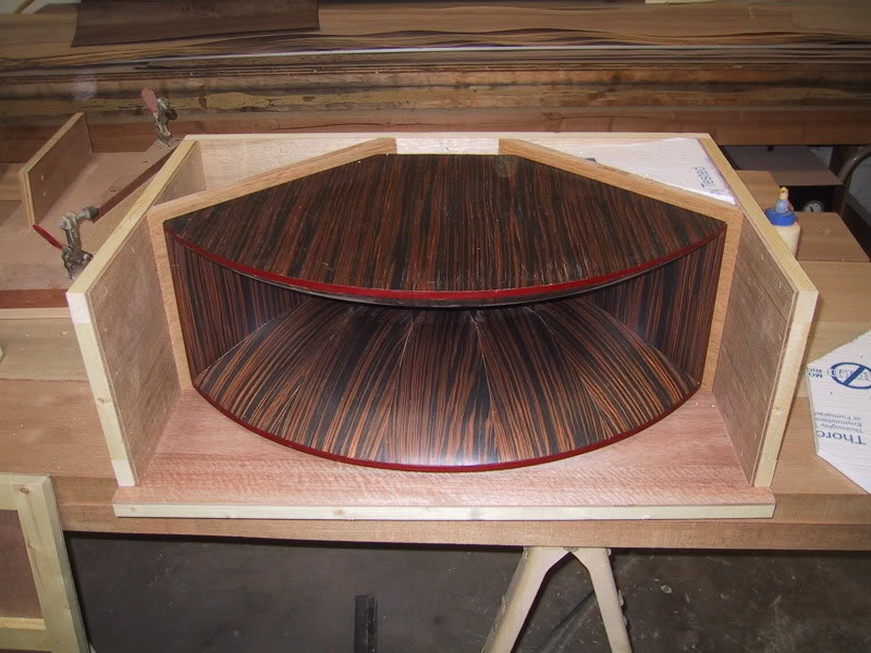

I have Yuichi A-290 plans and built a pair of them 20+ years ago. They are an exceptional radial horn. I sold them a while ago and they are kicking around the midwest somewhere. Here's a picture of one of them as I was packing them for shipping.

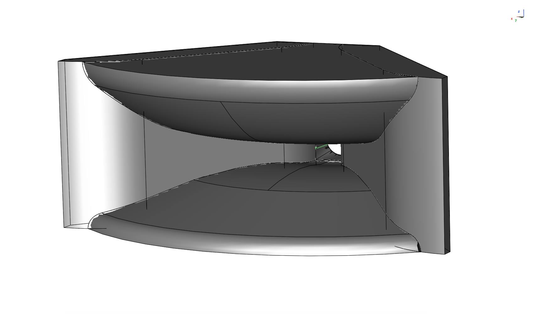

I've also worked up an and Apaxial design for TAD 4001 drivers, much like the smaller throat H-4003 horn. Haven't built them yet, but that one is approaching the top of the cue. That is for a near clone of Exclusive 2401 monitors with 2 15" and using TAD TN-1 networks ...
Either one is expensive to purchase because they are material and labor intensive.

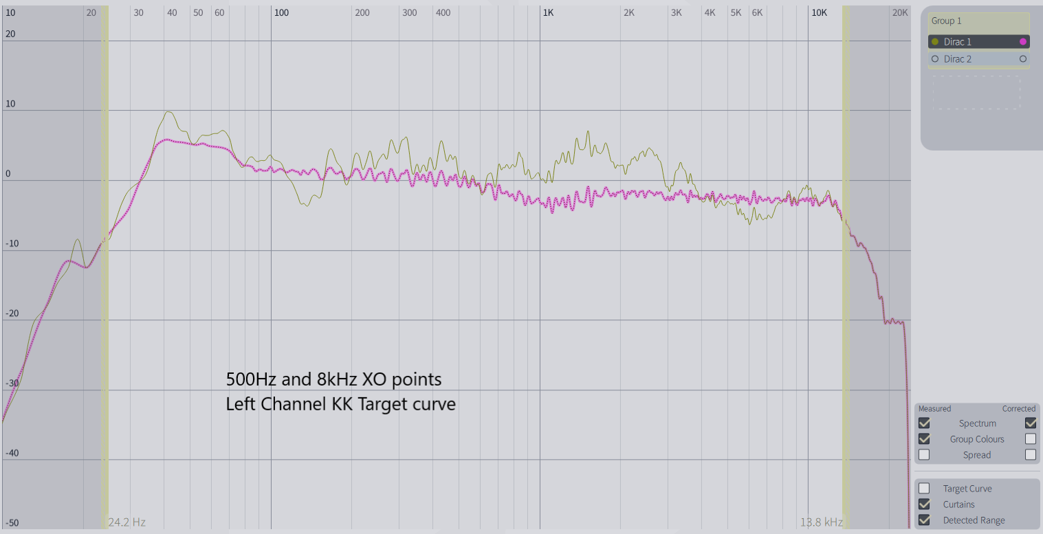

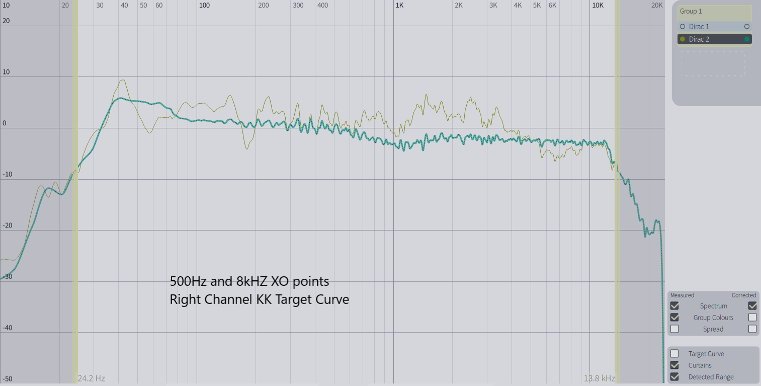

Today's activity was to determine how well the Radians play down to 500Hz, reconfigured the crossovers and did a 13 pt room measurement in Dirac3. See both corrected and uncorrected results for both channels.
Apparently not getting much tweeter above 14kHz or so at the listening position, I think vertical directivity is playing a major role here as I have done better than 16kHz in previous measurements, but I am refining my measurement technique and there are occasional changes as a result. My highest measurements this time around were a few inches lower than the last time. What I am trying to say is this is a measurement artifact. EQ is not applied above the remarked frequency.
It works well, the Radian has no problem at all reproducing down to 500Hz on this horn.
Overall it sounds a bit more coherent. I am happy enough with the result to live with it for a few days before further tweaking.
Hmm, tweeters. Note that unfortunately I cannot hear much beyond 10kHz on a good day.
The target curve is modified Harman Kardon target. I've added back most of the bass below 100Hz as it adds weight at my modest listening levels and isn't overwhelming even at high levels. I added a dip centered just above 1kHz, it's fairly mild, and the rest of it is basically the HK curve offset a bit to align with the dip.

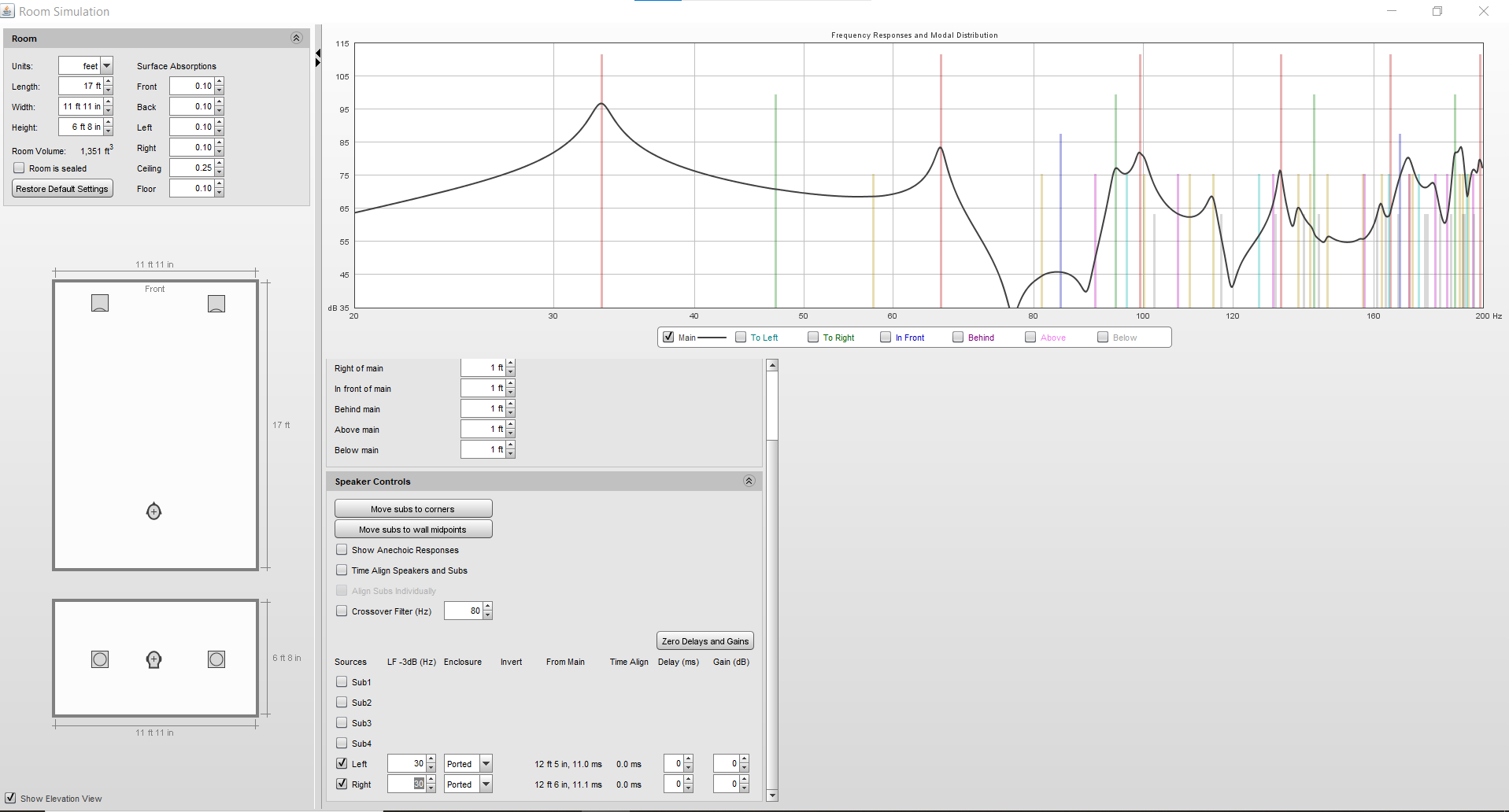

See the attached measurements below from Dirac3. I've added a room simulation from REW. The room is rather more complicated than shown, but given the tool I did the best I could.

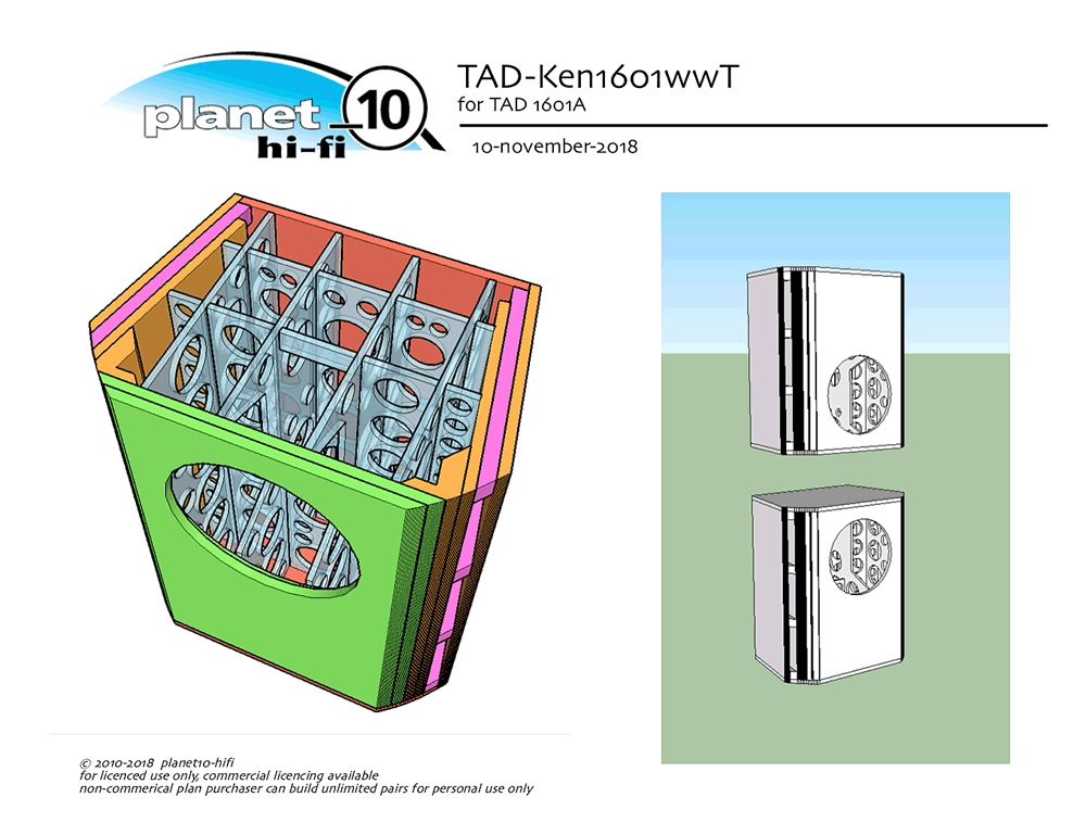

Can you spill more details regarding these cabinets? I'd be happy to donate/contribute if this design would suit my 15 inch Faital 15pr400. This render looks stunning!
OT: I currently use the 6-24 crossover to cross between my jbl2450 (with yuichi 290) and the woofers. Currently set to 24/12db @ 480 hz.
See below link with details and measurements wrt this setup:
TAD TSM2 en construction ...des idees !! - Page 5
Wow. The driver drops into a well in the horn structure? If so, does the bottom of the well support the driver's weight?
I am not familiar with the fine detail, my work on the project was the bass enclosure for the TAD1601.
This specific design is the only one so far where the client has donated an amount sufficient for him to get ownership of the design, They are building them to demo their DD TT, i really hope they get to the point of making them for others.
I would love to have the opportunity to do a similar box for a different (more affordable) woofer. This is the biggest (finished) miniOnken to date. But the miniOnken alignemnt tends to smaller boxes than often used, with very articualte bass, but no attempt is made to try to stretch the bass extention for the sake of bass extention. Quality over quantity.
The Yuchi (or whatever your preference is, and it doesn’t have to be a horn) fits in the space between the 2 bass enclosures.
