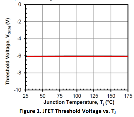

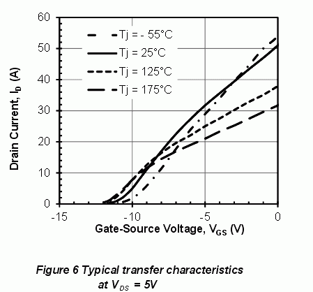

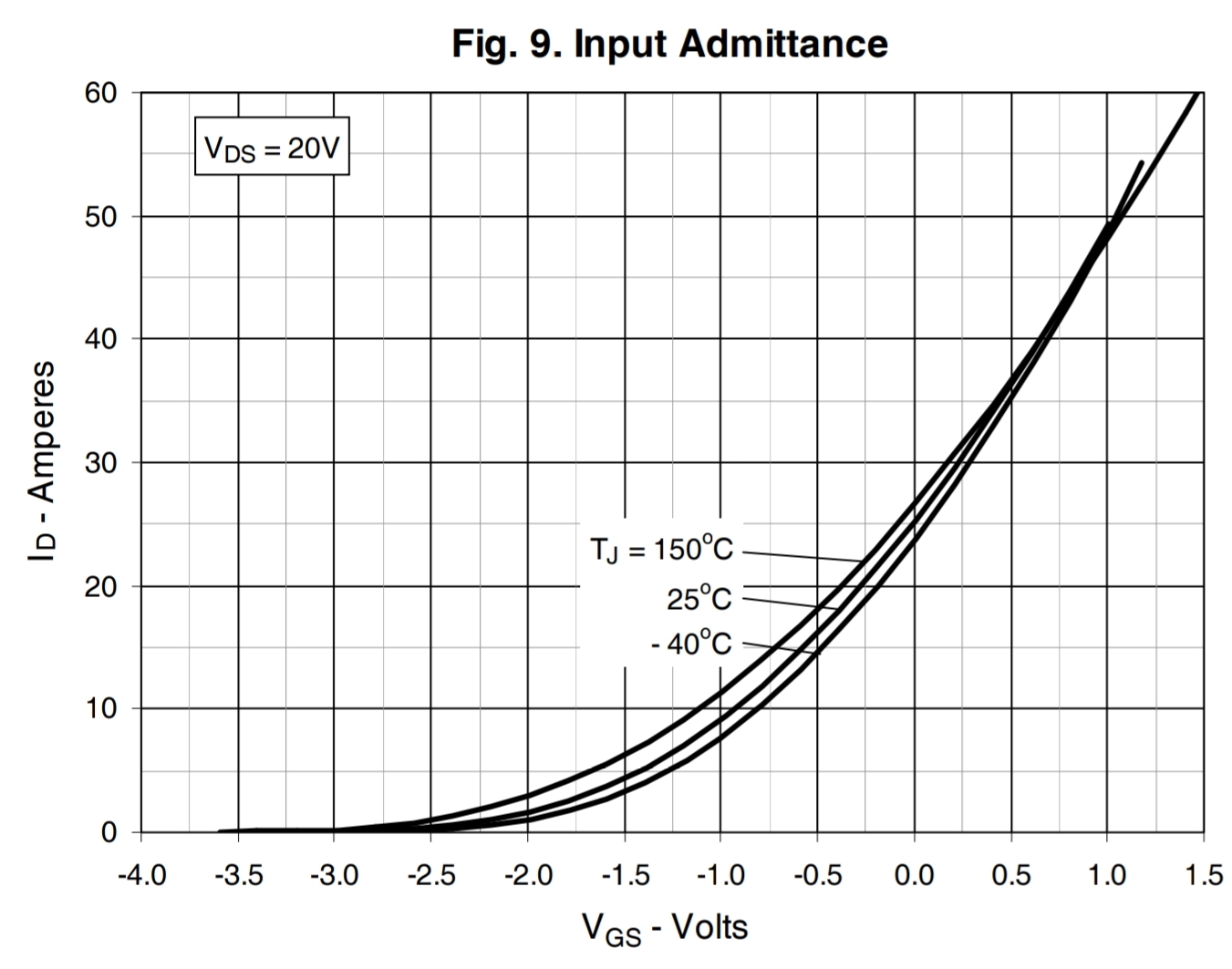

A typical
UnitedSiC JFET has a threshold or “Gate cutoff Voltage” of -6 Volts. In Figure 1, The threshold Voltage is stable
across temperature. This stability simplifies gate drive analysis with respect to a standard silicon device would have
a 2 Volt swing over the equivalent temperature range.

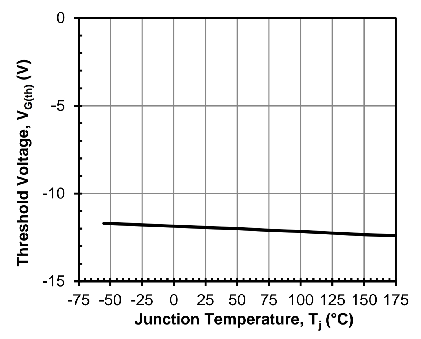

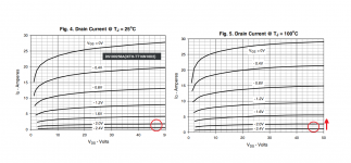

The UJ3N065080K3S
has some temperature dependence, only about 0.7V across the whole range. Jpatay, I think your graph shows just the maximum rating, see datasheet. Pic is taken from Rev. B.

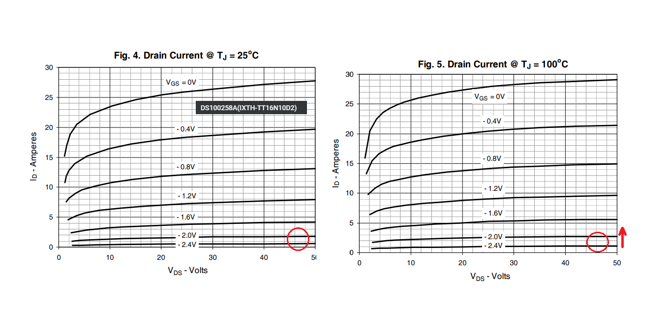

Alexey Semin got good results on 2SK1058 laterals.

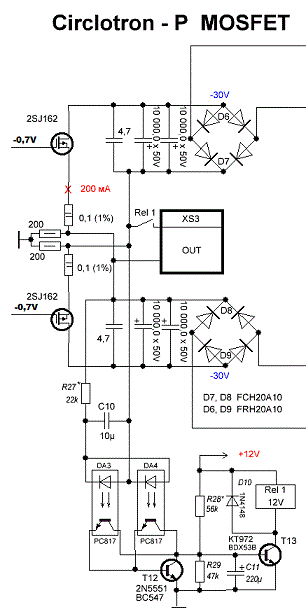

And if I try on P-channel laterals 2SJ162? I only need to change the polarity of the supply voltage at the output stage?

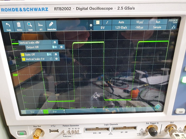

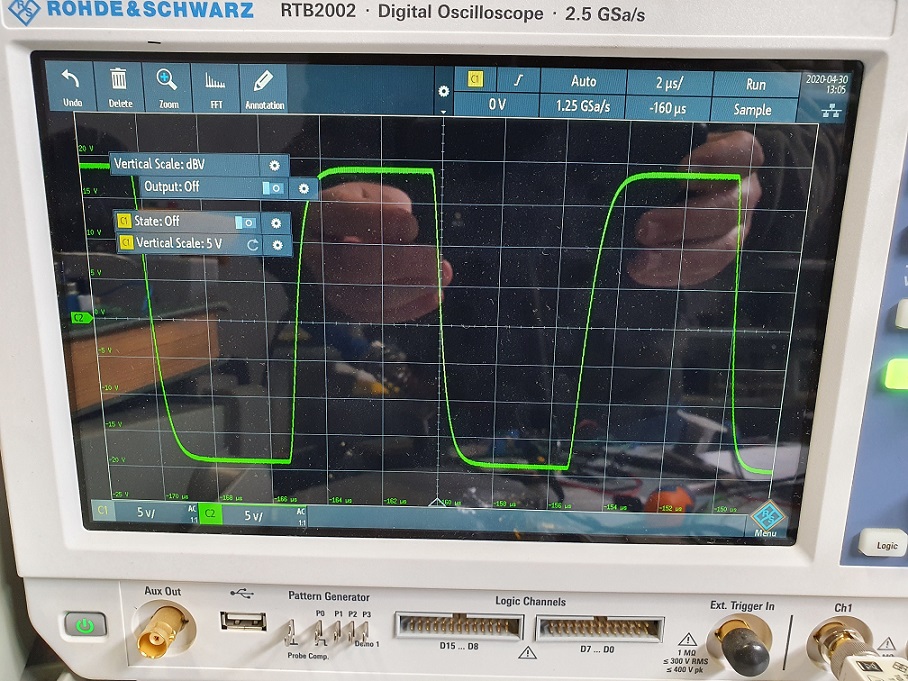

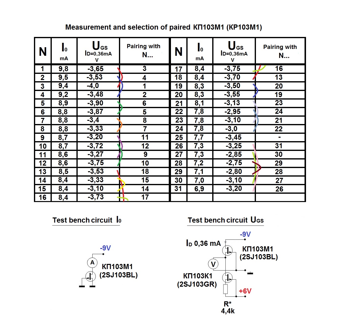

Selection of appropriate transistors to service the first stage of the circuit.
It is seen that there is not enough information on the initial current.
Requires source-gate voltage at operating current.

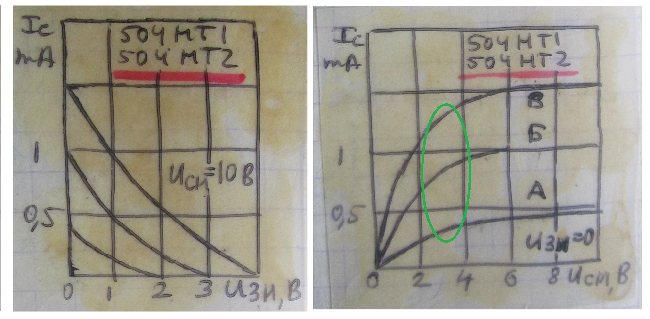

The second attachment shows the properties of KR504NT1 and KR504NT2.
There is information about the voltage they need for the source - drain (green ring).

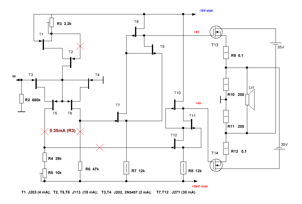

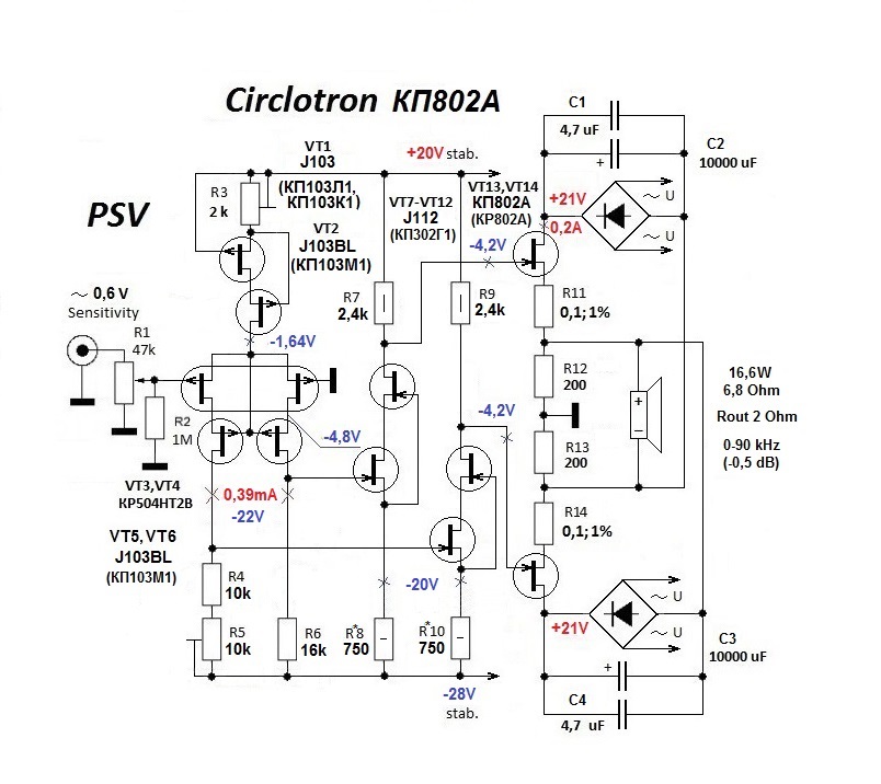

I conducted such an experiment. I used the N-channel jfet in the differential input, and the P-channel in the driver. The transistors were used in SOT-23 (MMBFJxxx) packages.
As a result, the MOSFET received an amplitude of ~ 14 V at the gates (5 Volts more than in the first circuit).
The transistor current is indicated in brackets:
Idss Zero-Gate Voltage Drain Current. For example: J202 - 2 mA.

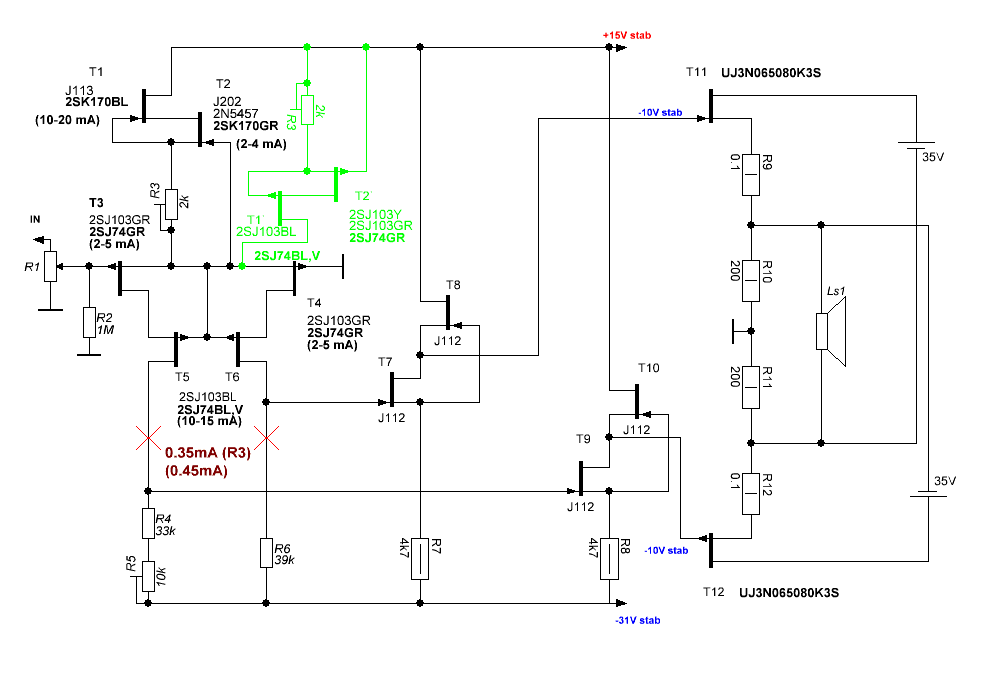

I just posted in an older thread but I see there have been some updates here. Very interested in trying the United SiC Jfet version of this amp. A question on the TO-92 jfets used. I would assume 2sj103 can be substituted with 2SK170? Does the grade matter, GR vs. BL? And 2sk246 can be 2sj74? Also, is there matching between any of the components?
Hi jwjarch, look at the circuit for possible replacement of transistors, but everything must be checked in practice. We have simplified the scheme a little. The buffer is already on two transistors. It is advisable to use transistors with a maximum voltage of 30-50 V.
