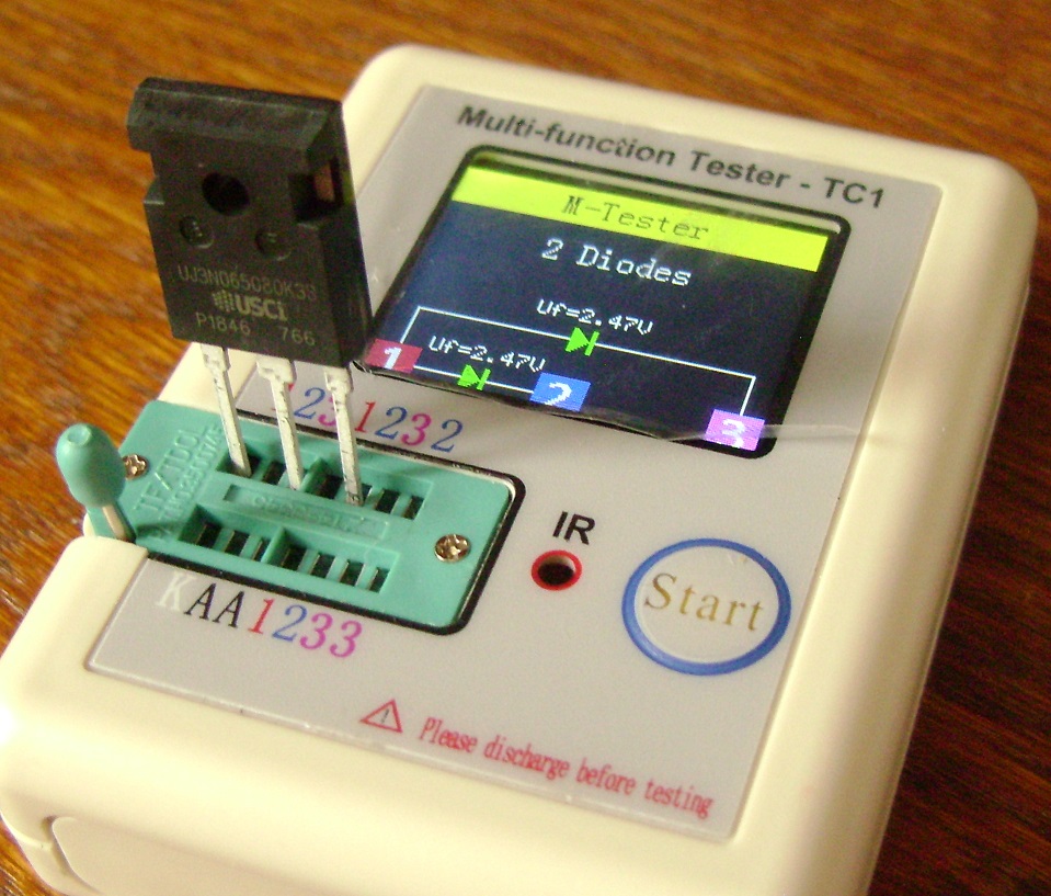

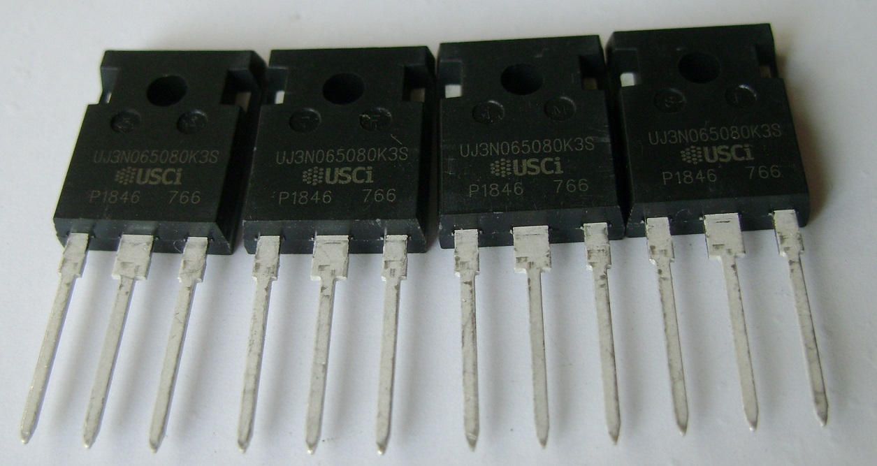

I finally got USCi. I measured them with a multimeter. The gate has a resistance greater than 2 mΩ. D-S shows resistance-full zero. Probably because SiC Normally-On Junction Gate Field-Effect Transistors. The Chinese device identified them as two diodes.🙂

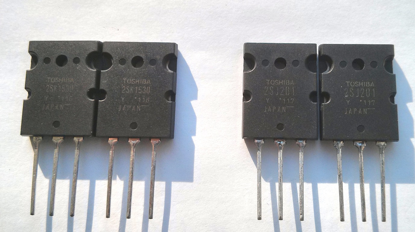

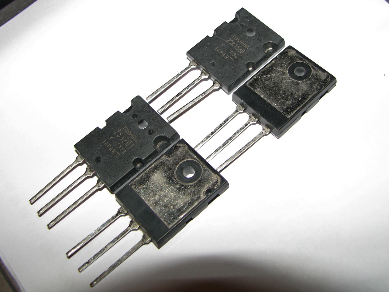

A good result was obtained with the 2SK1530.
But now it will be difficult to find original ones. Here is a photo of the original 2SK1530.
There should be a dash where - Note 2 and JAPAN is slightly shifted to the left.
