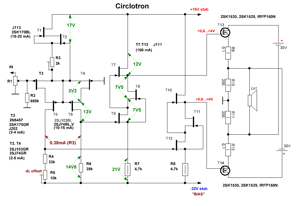

So jpatay, best schematic for the 2SK1530’s? Maybe post #103? Any changes to R4-R8 for the Toshibas?
On the circuit, the voltages may differ slightly. The current is regulated by changing the voltage -32 V. First, you need to set +0.5 V on the 2SK1530 gates without applying voltage to them. Резистор R4 должен выравнивать напряжение на затворах +0,5 В.
Then turn on the power to the 2SK1530 and set the current (for example - 200 mA) with a 10kΩ resistor in the -32V stabilizer. In order not to damage the 2SK1530, you need to successively put a 220 V, 100-150 W incandescent lamp in the primary winding of the transformer.
At a load of 6-8 ohms, it is more accurate to set zero voltage with resistor R4. Set the voltage across the 0.1 ohm resistor to 20 mV, this will correspond to 200 mA.
I think you know that.
Good luck!

Do you already have other transistors (J113, J111, 2SJ103 ...)?
Jpatay, yes I already have J113, J111, 2sj74-GR and 2sj74-BL, and planning on using 2sk209x4 in place of 2sk170’s.

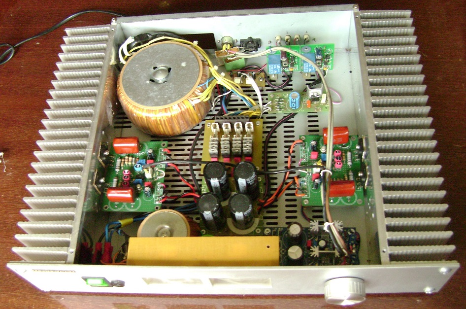

Regarding power supply, how is yours set up? Can you use the same toroid for the whole amp or do I need one toroid for bias and a separate toroid for the outputs? I think I can get all the voltages I need with one 400VA toroid with 25v dual secondaries.

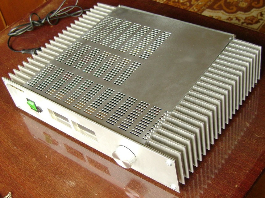

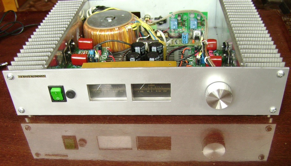

One toroid can be used. 250 W is enough. I used a non-working German amplifier in my prototype.
And I had to insert another small toroid to power the stabilizer, because I was too lazy to wind up the necessary windings on the large toroid.
It turned out ugly, but this is the first prototype. Now that the circuit is fully debugged, you can build everything from scratch as it should.
