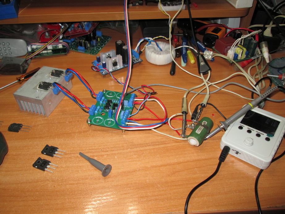

I carried out measurements on a breadboard, the power to the output stage was supplied from a laboratory power supply. Therefore, I did not have the same problem as the jpatay. 🙂

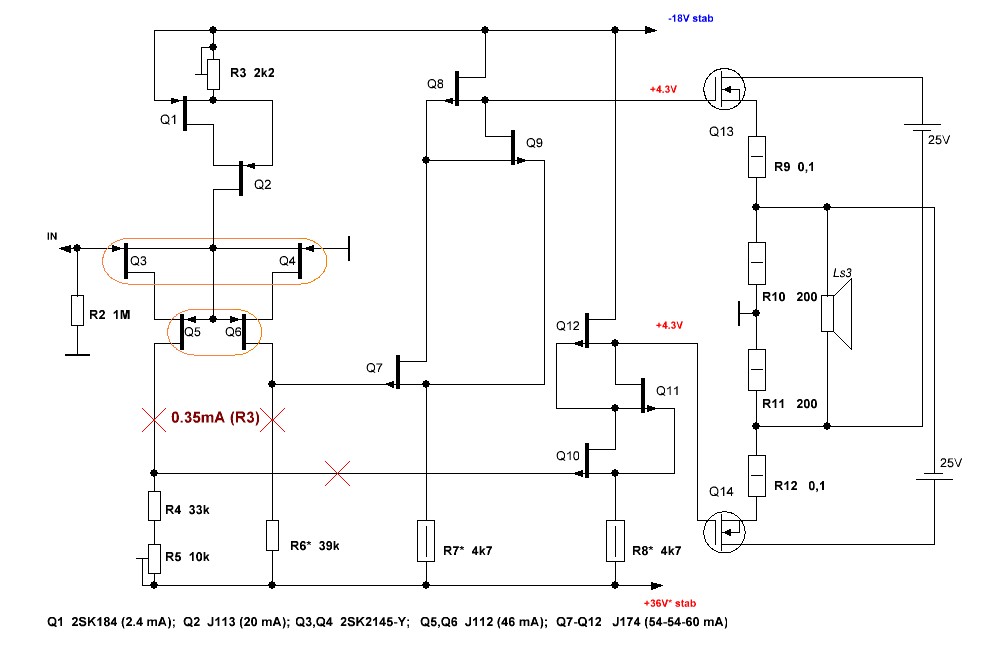

Today I tested the circuit with the inverted power supply of the preliminary part. The diagram shows the transistors that were used. At the output I used transistors IRF150, 2SJ162, 2SK1058. Quiescent current in all cases was 300mA, load 10 Ohm.
IRF150: Vout max=24V, Rout=0.38 Om
2SK1058: Vout max=20V, Rout=2.85 Om
2SK162: Vout max=18V, Rout=2.85 Om

I put transistors IRG4PC40U on the output. Output impedance 0.28 ohm. The maximum output voltage dropped to 13V into a 10 ohm load. When testing the meander, the output transistors went into self-heating. This was not observed with mosfet.

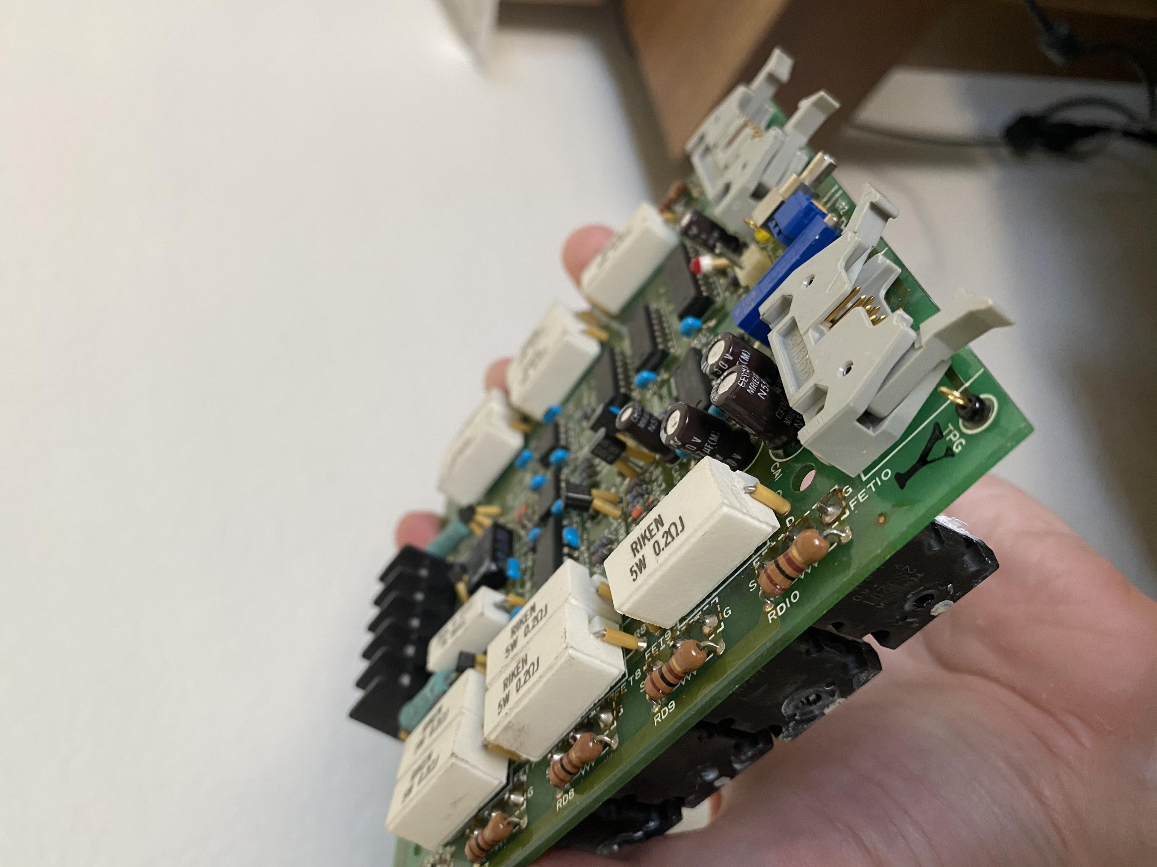

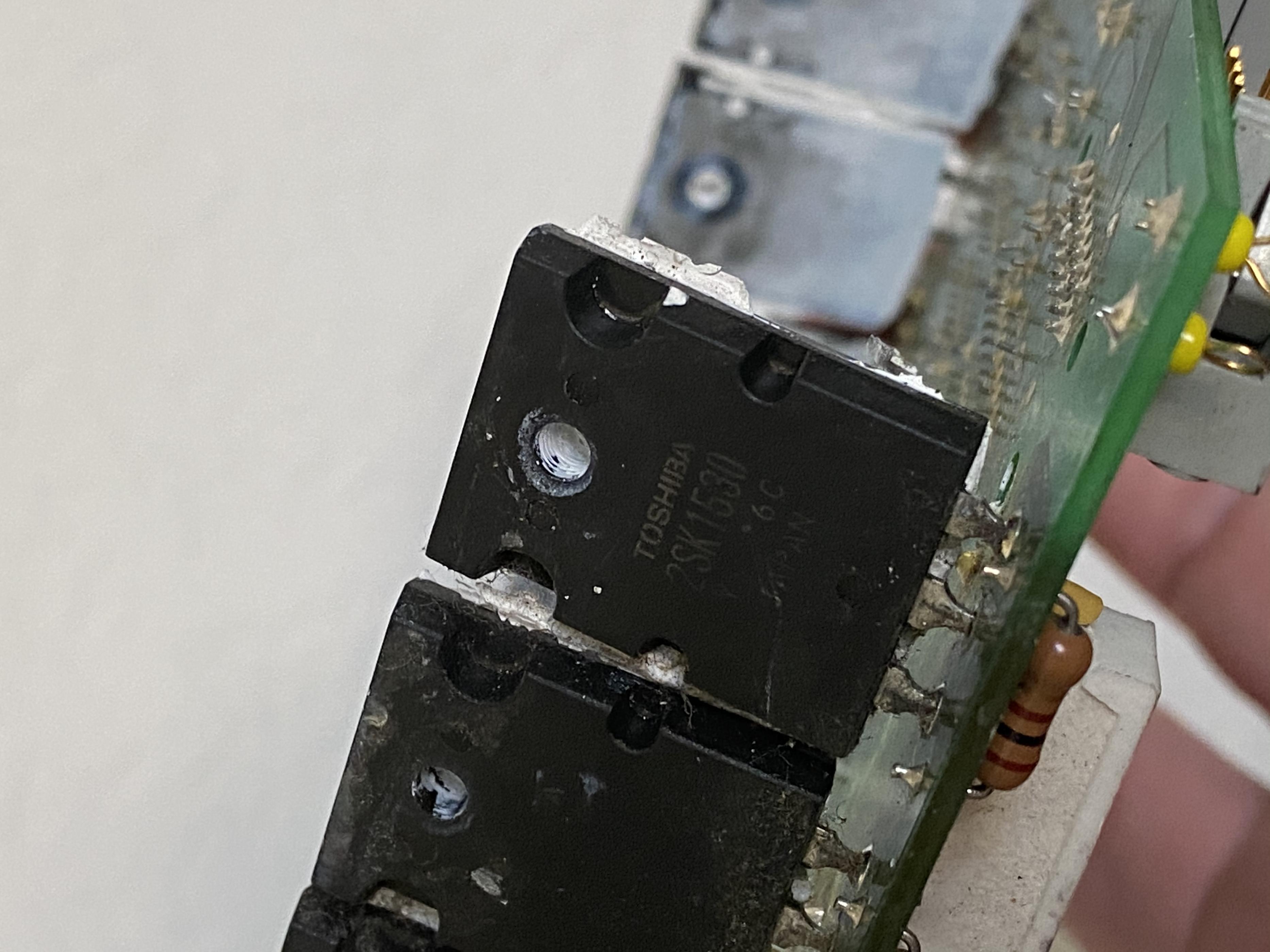

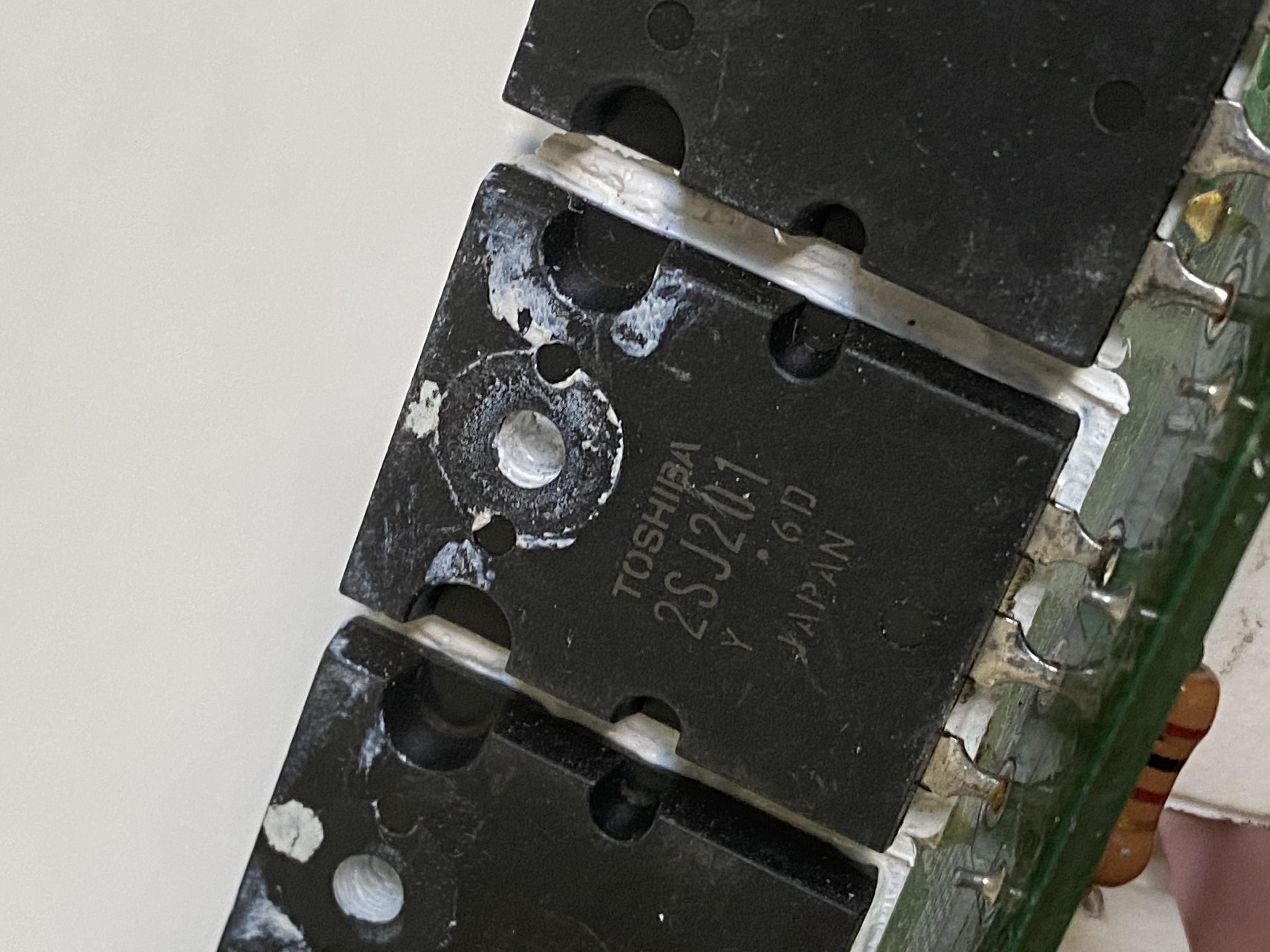

Received my 2SK1530 from Pras1170 today. Used obviously. Nice little board with 5 pairs of 1530 and 2SJ201 in good shape. Maybe some bonus components can be salvaged for tinkering too. 😉 Thanks again Pras!

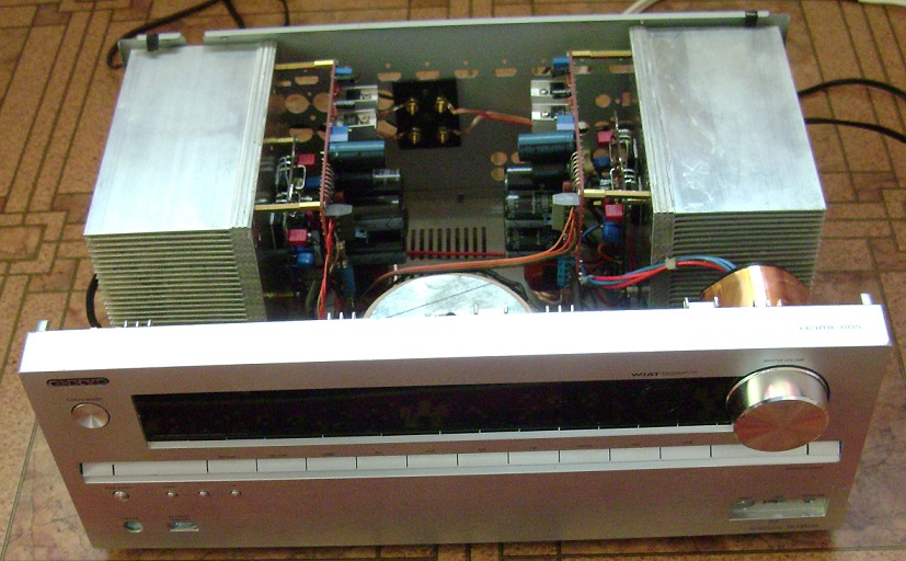

I finally tamed the JFET SiC UJ3N065080K3S.
The optimal current is 400 mA. For three hours of operation, the current increases from 200 mA to 600 mA. I had to install thermal stabilization from two germanium diodes Д7Б (see circuit).
I am very pleased with the sound. High frequencies cut through. Air and volume appeared in the sound. But I had to make a delay in turning on the UJ3N065080K3S.
Rout - 0.78 Ohm. Frequency response: 5 Hz - 0.6 MHz (0 dB).
Square wave - 60 kHz.
