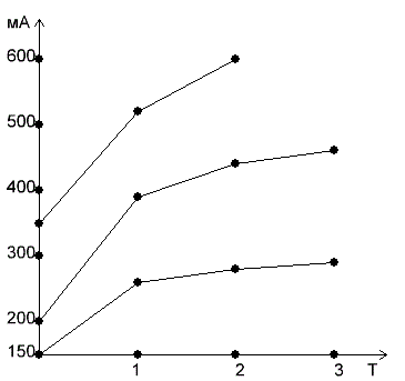

Without thermal stabilization, the current rises slowly. When the cold amplifier is turned on at currents of 150 mA, 200 mA and 350 mA for three hours, an increase in the current is visible on the diagram.
If, when you turn on the amplifier with cold radiators, set the current to 150 mA, then the thermal sensor is not needed.

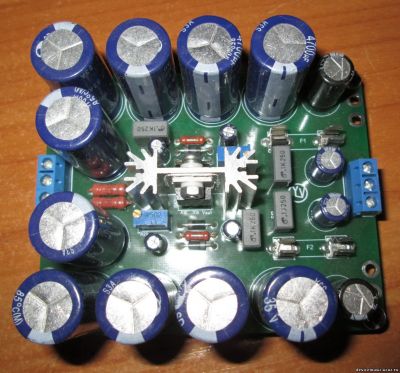

Jfet and Sit requires two transformers. One of them is small with four windings for stabilized power supply 2x15 V, 2x30 V.
And a powerful transformer with four windings for Jfet and Sit.
Yes, each channel needs its own stabilizer(+15V,-30V), then there will be no background at all.

Why 2x15? for stereo?
You need two such power supplies. They already have capacitors for the output stage and fuses. The PCB can be ordered in China.

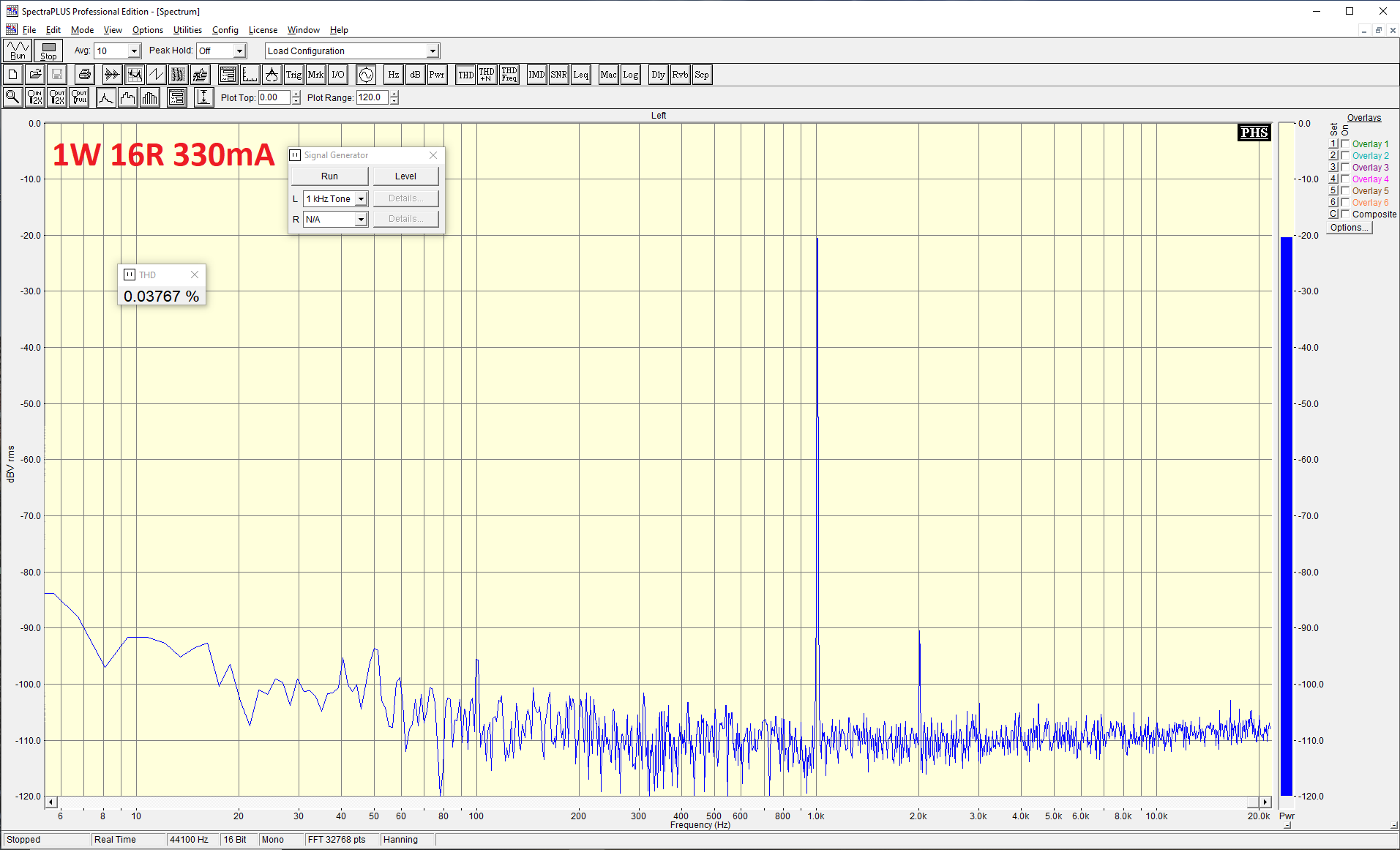

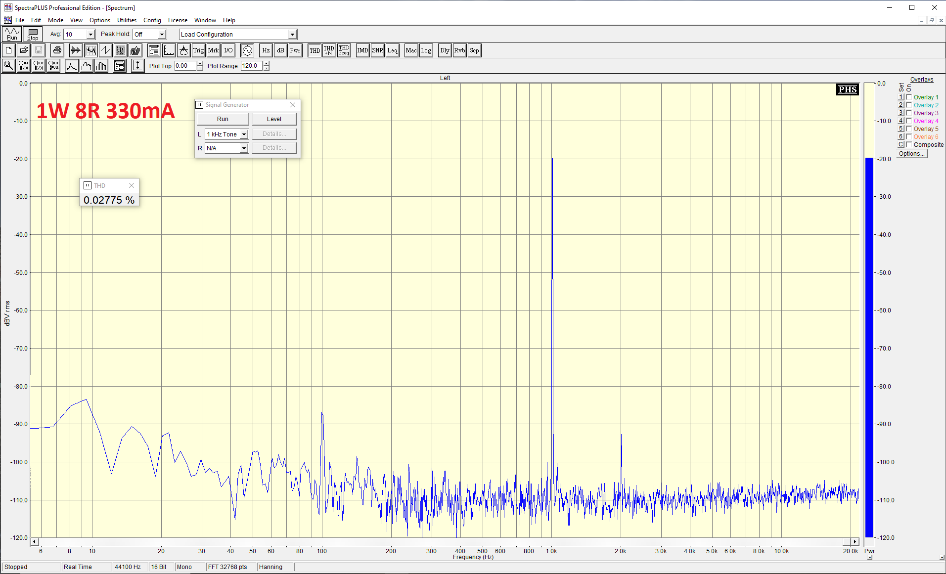

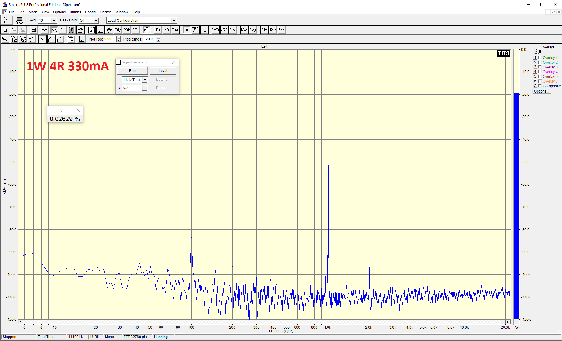

Spectrum at different load resistances. Output transistors russian KP802.
impressive. In my simulations with Spice, however, I get very different type of response, mainly 3rd harmonic (with Sics not Russian).
Yes Yurik, I believe you, I am puzzled however from the difference. Anyway, the final stage is Russian, what is the front end in this plot? Russian JFETs too?
I also want to note here that in simulations, front behavior changes a lot, changing the current. 800-900 mA, 2nd harmonic lower, 900-950 2nd=3rd harmonic, 950 and more 2nd > 3rd.
Unfortunately, distortion, never goes really low. I am thinking we could enhance the front end current source, what do you think?
