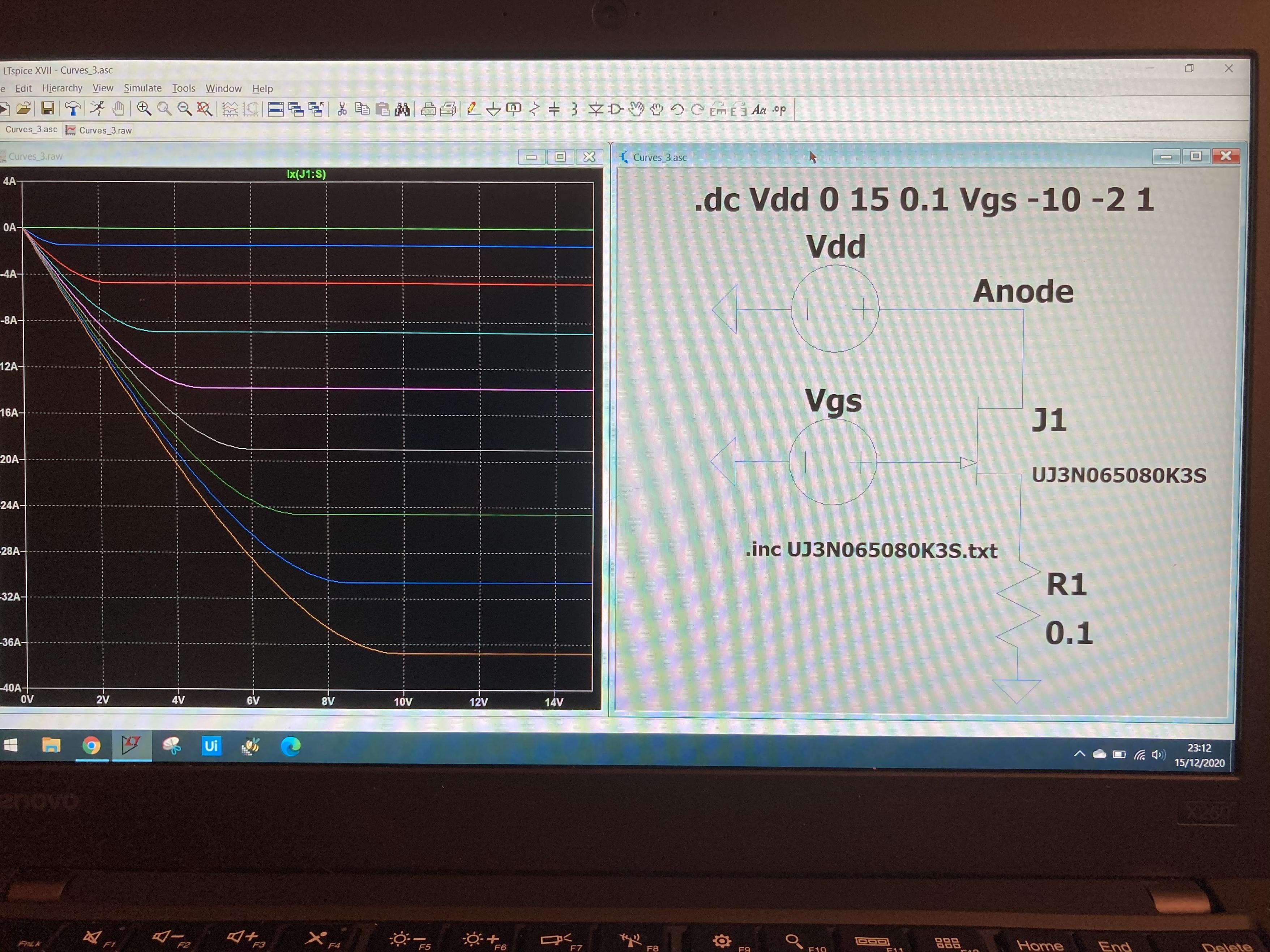

Source curves based on manufacturer spice model

Savu, thanks for this. However, I don't understand what I see. I do not speak SPICE, and the plot has no axis labels and no legend.
What voltage did you show in the plot? Voltage across the source resistor?
What are the different curves (my guess is they correspond to different gate-source voltages, but I have no clue what voltage values)?
So, the info on the previous picture is as follows:
Vdd (Drain to GND) from 0 to 15Vdc in 0.1V steps
Vgs (gate to GND) from -10Vdc to -2Vdc in 1V steps.
Left is source current right is drain voltage and the curves are source current at every Vgs mentioned above.

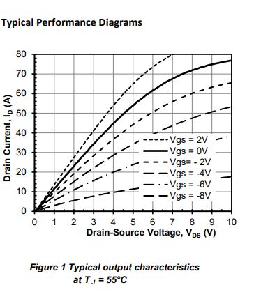

It's like this one in the attachment but instead of drain curves measurement is the source curves measurement. That's why it's upside down
Sooo, looking at the curves in post 247, the drain current is not a linear function of the gate voltage. This means that that the voltage across the 0.1 Ohm load resistor is not a linear function of the gate voltage. Why is this so? My brain thought that a source follower is just a current buffer that copies the gate voltage to the source pin (with some DC offset). Where is he wrong?
Well it copies the voltage but because it's a V to I converter I think that the linearity of the source follower is dictated by it's transfer curves characteristics.
Thus the source current will not be perfectly linear because the jfet/tube follower is not a perfectly linear device.
If you look at emitter follower bjt output stages they (the high end designers) always pick transistors with very good linearity like the very famous 2SA1295 and 2SC3264 from Sanken. I think the reason is to keep the output stage inherited distortion down.
https://www.semicon.sanken-ele.co.jp/sk_content/2sc3264_ds_en.pdf
https://www.semicon.sanken-ele.co.jp/sk_content/2sa1295_ds_en.pdf
If you check the transfer characteristics you will notice that they are very linear in the triode region.

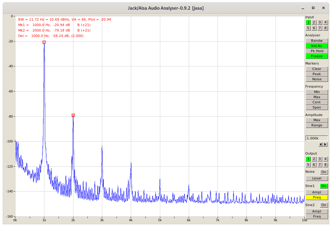

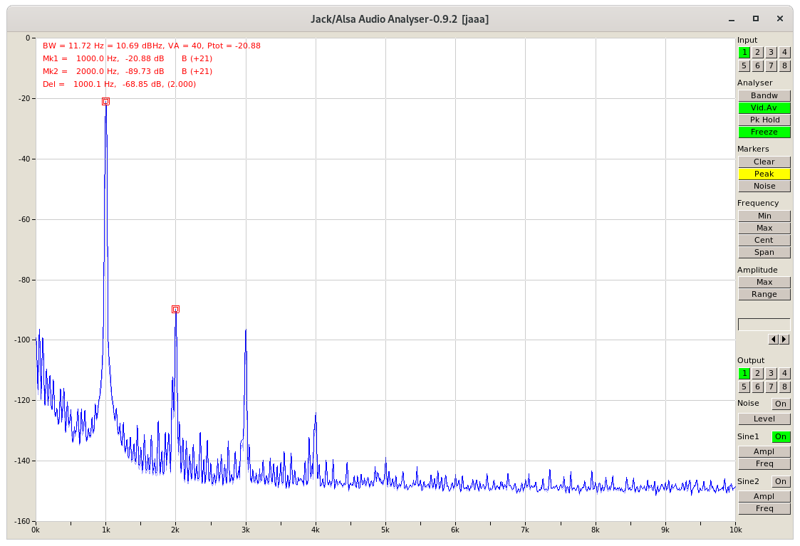

Just to convince myself I set up two circlotron output stages. One with IRFP150 MosFETs, the other with THF51 SITs (I had these parts on the bench). The harmonic distortion profiles of these two stages were always quite different. I tried different operating points, but the differences were persistent. The IRFP150 always resulted in more higher harmonics, and the THF51 always gave clearly lower 2nd. The attachments show the IRFP150 and the THF51 circlotrons biased at 24 VDC / 2 A, running at 1 W into 8 Ohm.

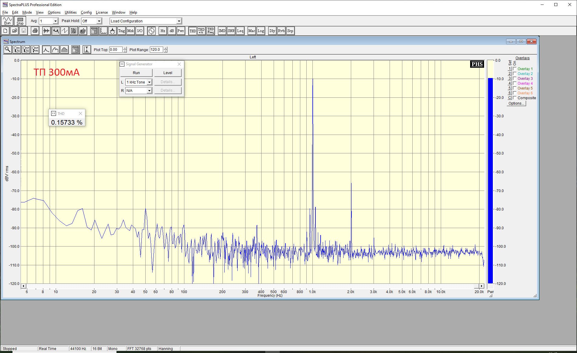

The harmonic spectrum of IRFP150 and SIT KP802A, but the output stage on the SIT has a resistance 20 times higher.
The spectrum was taken from "live" amplifiers.

exactly mbren that's what i was talking you about from beginning, you choose the distortion you like, SIT or other FET. Also bear in mind that capacitance is different, impedance is different, they have local feedback due to small degen, so it is a different story. And again try to see, when you change the bias point ending up with serious bias current (which is what i am aiming in the end). I am in the very beginning of this amplifier, since he is in the queue as next project. I ordered all JFETs though.I also have ended design, since I have changed things to have more power (at least in simulation).
And a comment for your saying that SPICE is a black box. If you feed it with good data and gets you great approximations. All my projects were really close to spice results but I was paying very close attention to spice models.

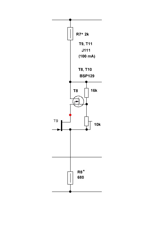

To increase the amplifier power, it is necessary to switch the buffer to the amplification mode.
You can look at such a buffer stage in LTspice, but the parameters of the amplifier may deteriorate. I do not know how to work with LTspice. The Drain-Source voltage of J111 should be 3 ... 3.5 V.
