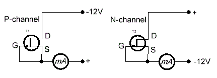

Transistors still need to measure Idss (Vgs = 0, Vds = 12 V).

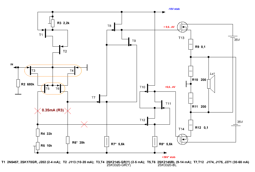

And select Idss, as written in the circuit. T3, T4 and T5, T6 must be matched. The more accurate the better.

I conducted such an experiment. I used the N-channel jfet in the differential input, and the P-channel in the driver. The transistors were used in SOT-23 (MMBFJxxx) packages.
As a result, the MOSFET received an amplitude of ~ 14 V at the gates (5 Volts more than in the first circuit).
The transistor current is indicated in brackets:
Idss Zero-Gate Voltage Drain Current. For example: J202 - 2 mA.

Hi Sébastien!!! I have already ordered the J174 and 2SK2145GR. I will assemble the layout soon. J174 - Idss: 50-60 mA.
2SK2145GR has more Yfs than 2SJ103GR. And there is no need to compare T3,4 and T5,6.

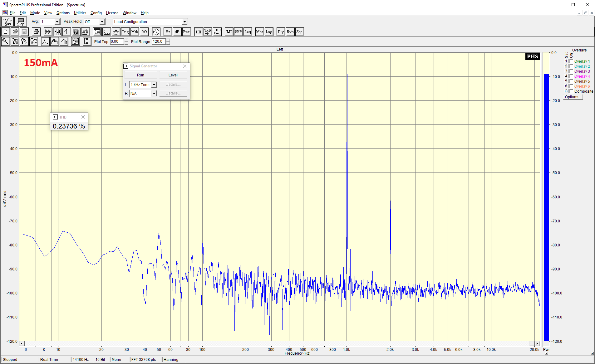

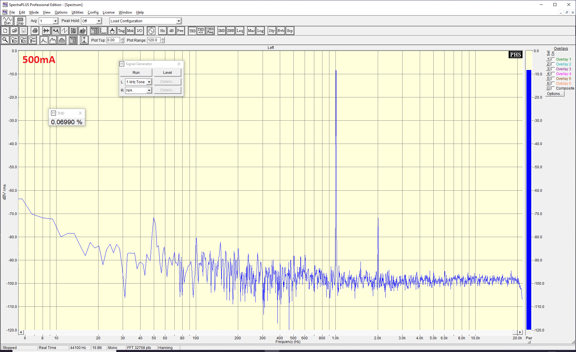

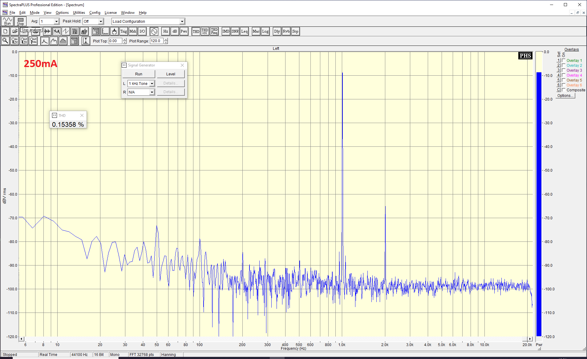

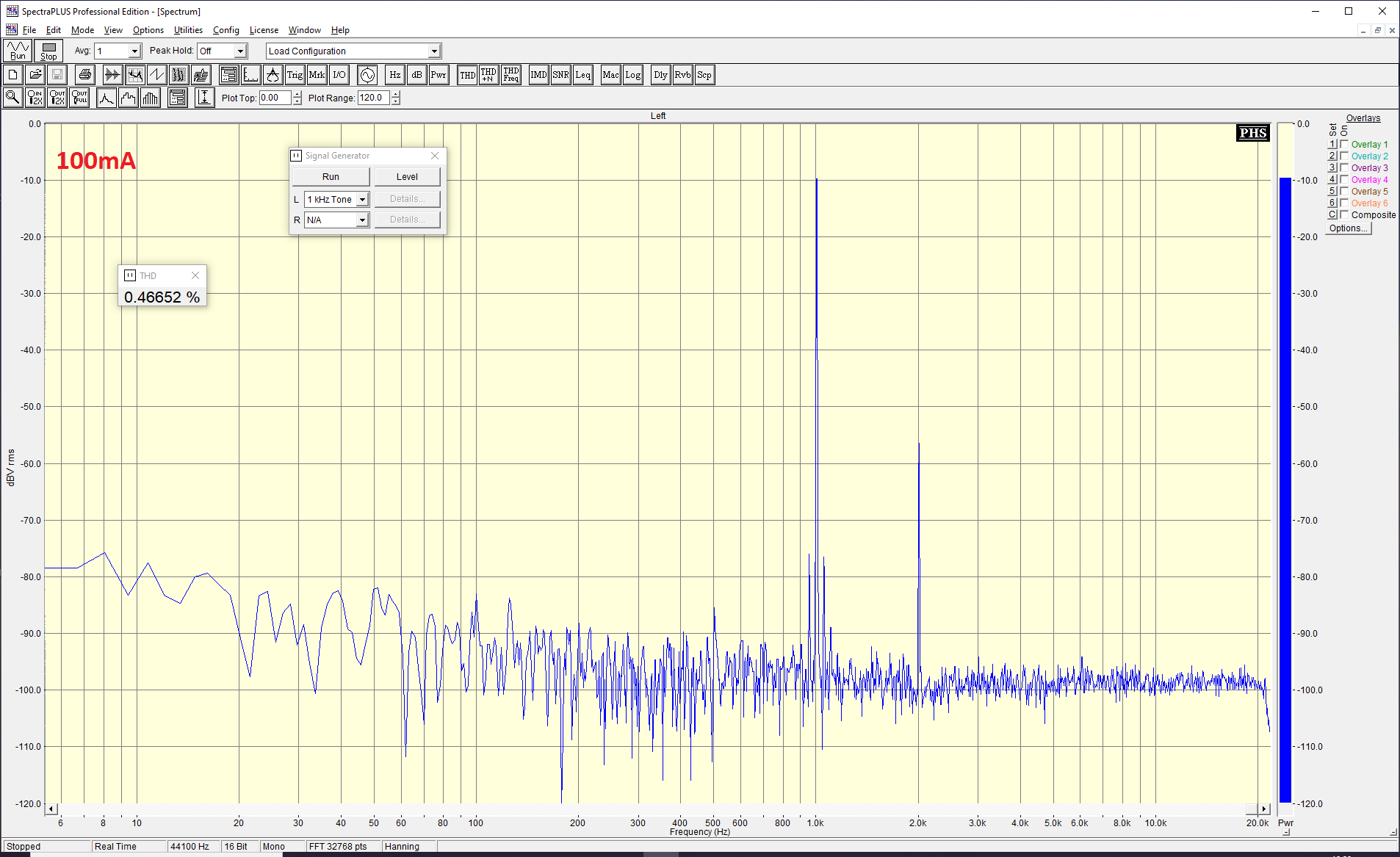

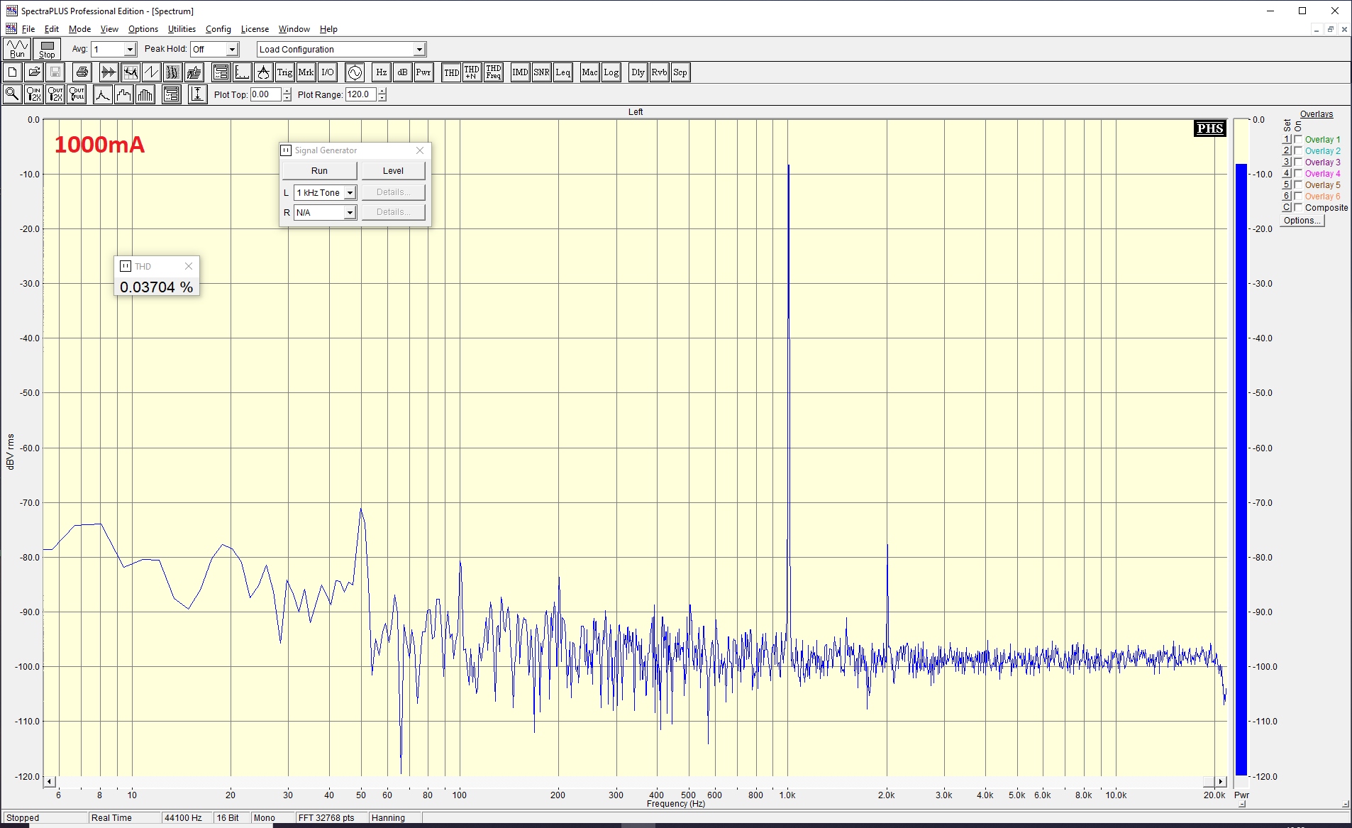

The dependence of the THD on the quiescent current. 1W/8R
Output transistors uj3n065080k3s.
