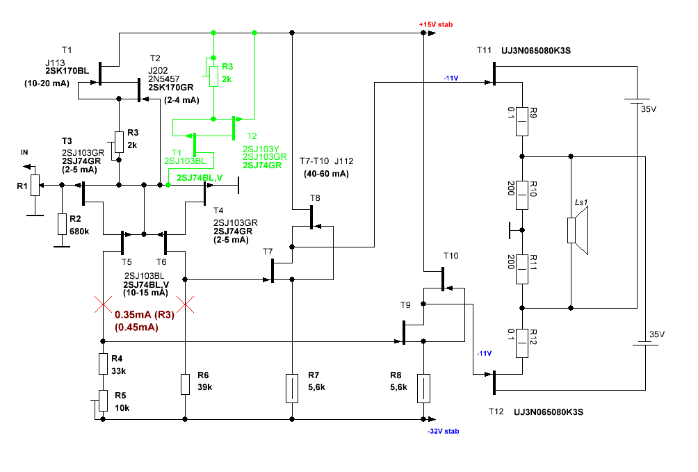

I have already bought UJ3N065080K3S, I will receive the package at the end of this month.
We have already checked T3, T4, T5, T6 - 2SJ103GR, 2SJ103BL, T7-T10 - J112 (45 mA). Things are good.
The amplitude across the UJ3N065080K3S gates is 13 V.
It depends on the steepness of T3, T4.
The buffer acts as a repeater. He has a low Rout.
Fixed bugs.

Thank you for the updated info jpatay. Sorry about the mix up on the N vs P channel. For some reason I had a brain fart on that. Thanks for correcting me.
This is a very exciting concept using the newer and more available SiC jfets. I'll be gathering parts soon.

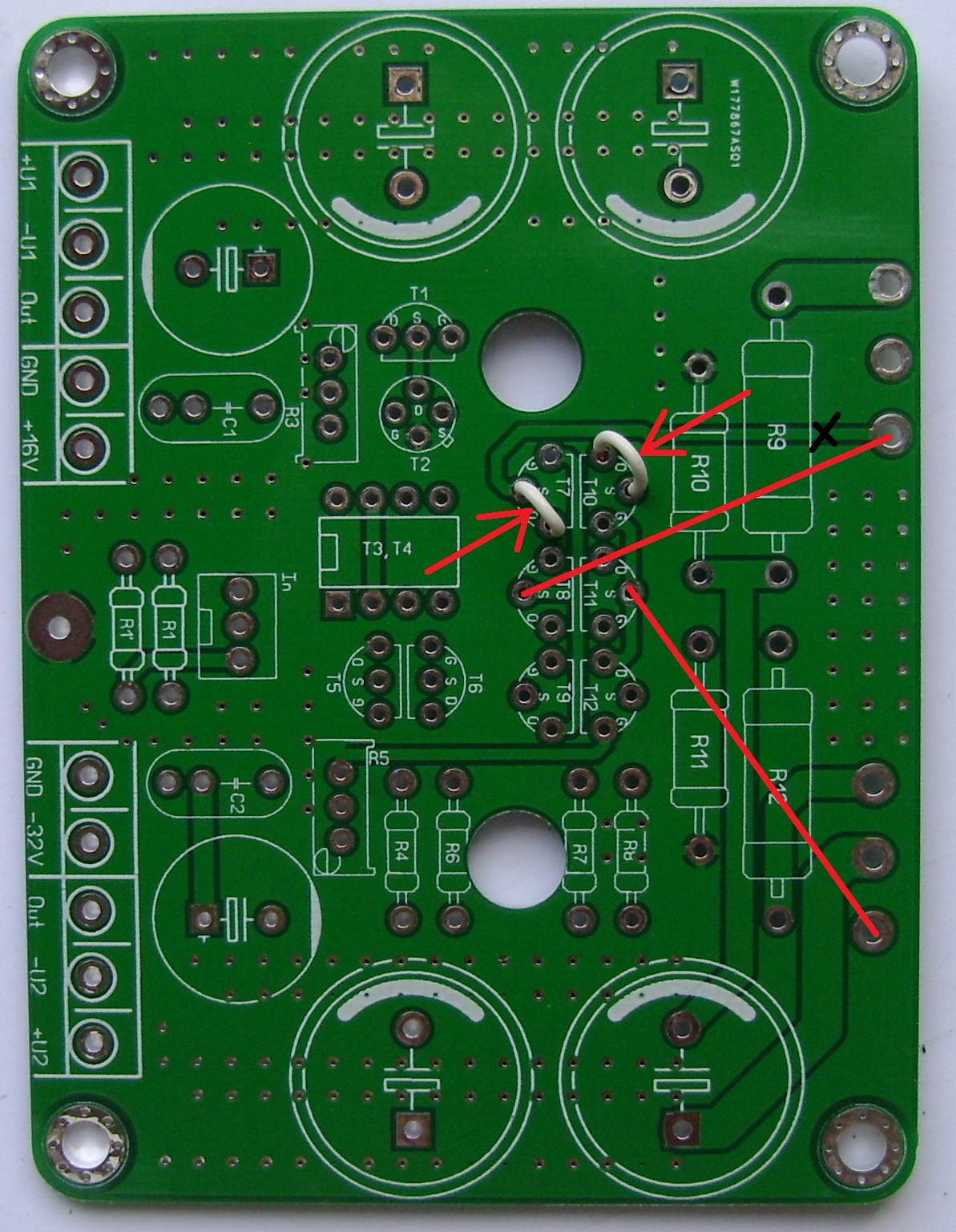

A question on the revision to the buffer. Does this make the V2 PCB's obsolete or can they still be used with or without modifications?

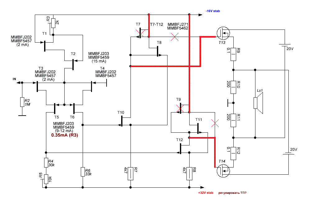

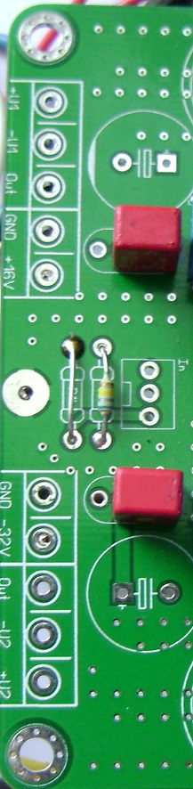

Not. It is necessary to put jumpers instead of T7 and T10. But then you need to cut the tracks on the SiC gates and set the jumpers as shown.
But it's better to leave it as it is. With T7-T12, this circuit also works well.
P.S. The circuit in the figure is completely different, as an example.
