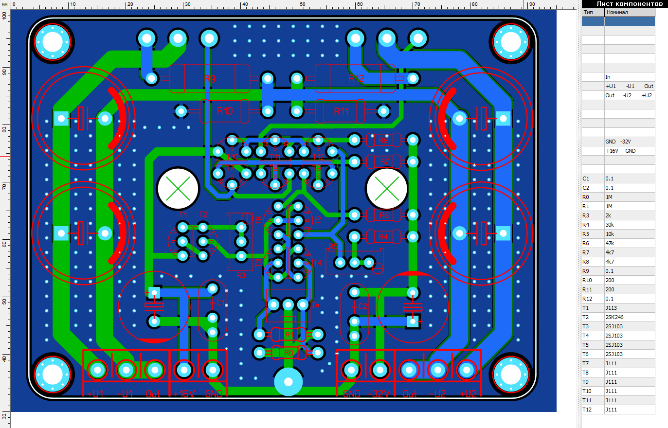

Printed circuit boards for these gerberas were ordered twice and there were no complaints from the manufacturer. I fixed the gerberas and uploaded to the manufacturer's website.
Please note that some of the transistors on this board are Russian-made. The wiring of these transistors does not coincide with the generally accepted among world manufacturers. If necessary, I can fix the board for other transistors.

Jura, it would be very nice to develop a PСB for 2SJ103, 2SK246, J112.
yess please
So I could made it with lateral mosfet
PCB without russian semiconductors.
Link for ordering PCB:

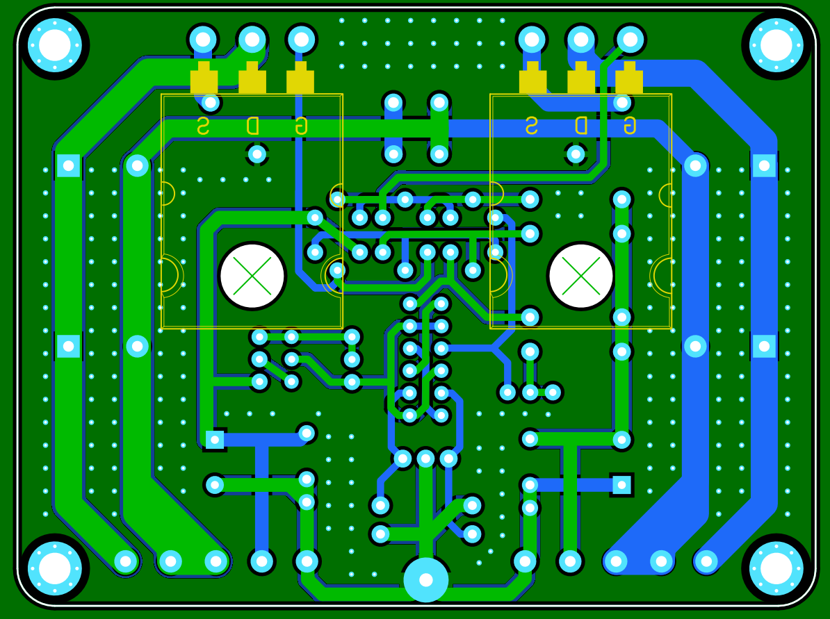

is the pinout for the UJ3N power JFETs intended for bottom mounting?
Yes, transistors on the bottom side of the PCB.
Also, what is the recommended supply voltage range?
The supply voltage can still be increased, but it is important that the transistors of the differential stage withstand the maximum voltage.

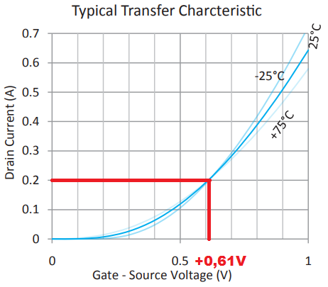

Even at low rest currents (50 mA) there is no "stair".
In addition, the small JFET transistors in this switching circuit turned out to be very resistant to breakdown voltage.
Which allows you to increase the supply voltage.
