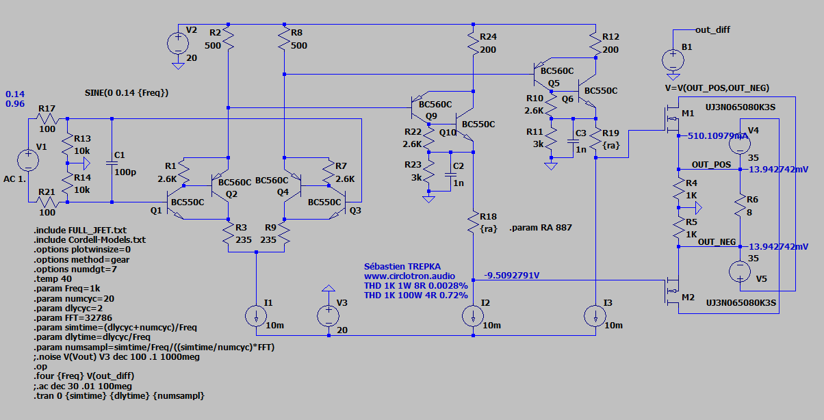

hi
UJ3N065080K3S model is already in FULL_JFET.txt, but i don't know if it's a good idea to use a mosfet in the diagram
but i donc know how to create a Jfet subckt
yes R6 need to be adjusted but the quiescent current is not a problem.
In simulation the gain is too high, my 2sj103 model should be wrong

HI
With the difficulty of finding input jfets, I thought why not bipolar, so I tried to simulate this one
Jpatay, this is the amp so I spoke to you in December, but I just invert the schematic and put the Power Jfet that you proposed
HI
Hi Seb!:wave:
It is very good that you have completed this circuit. It would be nice to collect and listen to it.
And also check for thermal stability. Spring. I don’t want to do anything.😉

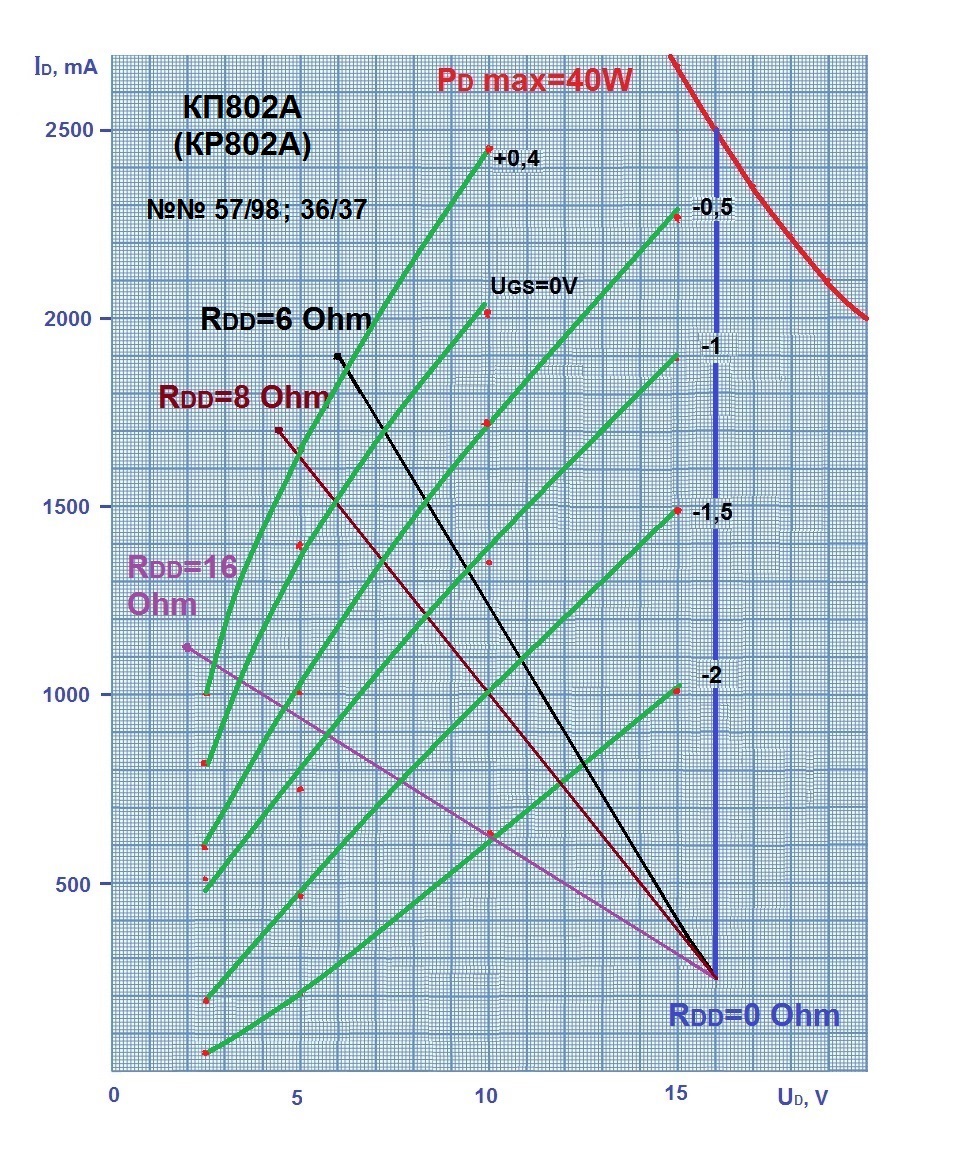

I measured the output impedance of the amplifier by the method of two loads at different values of the quiescent current.
I = 100mA / Rout = 0.14R
I = 200mA / Rout = 0.12R
I = 300mA / Rout = 0.12R

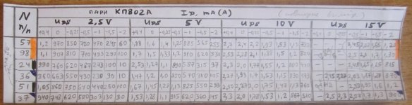

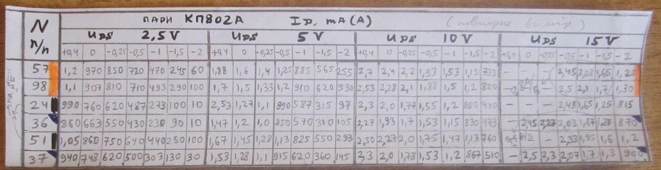

Measured its stock SIT-JFET KP802A (КП802А).
A total of 114 pieces, 87-92 production years.
Began to disassemble the "fours".
In the attachment is a table of those with the highest drain current initial, the tip of the iceberg.
Schedule for the "average" of the four transistor 57 / 98 - 36 / 37.
Average parameters calculated: Ri=(15-5)/(1,89-0,747)= 8,7 Ohm, S=(2,27-1,49)/(1,5-0,5)=0,78 A/V, u=RixS=6,8 units.
Output impedance of the common-drain amplifier:
1/S=1,28 Ohm.
It is seen that the output arm voltage should be kept 18-19 V. For these numbers.
