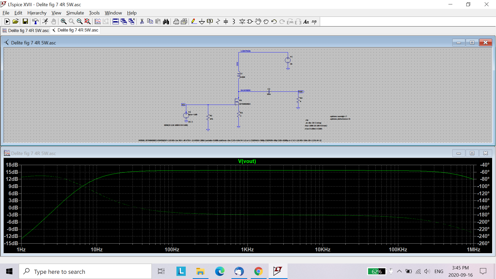

Another factor to consider is the output impedance of your preamp (modeled as series resistance of the input signal in the simulation) that will feed the amplifier. High preamp output impedance will affect the high frequency response of the amplifier.
If the output impedance of your preamp is too high, you can add a buffer at the front of the amplifier.
Simulations with 100R, 1K, and 10K impedance:

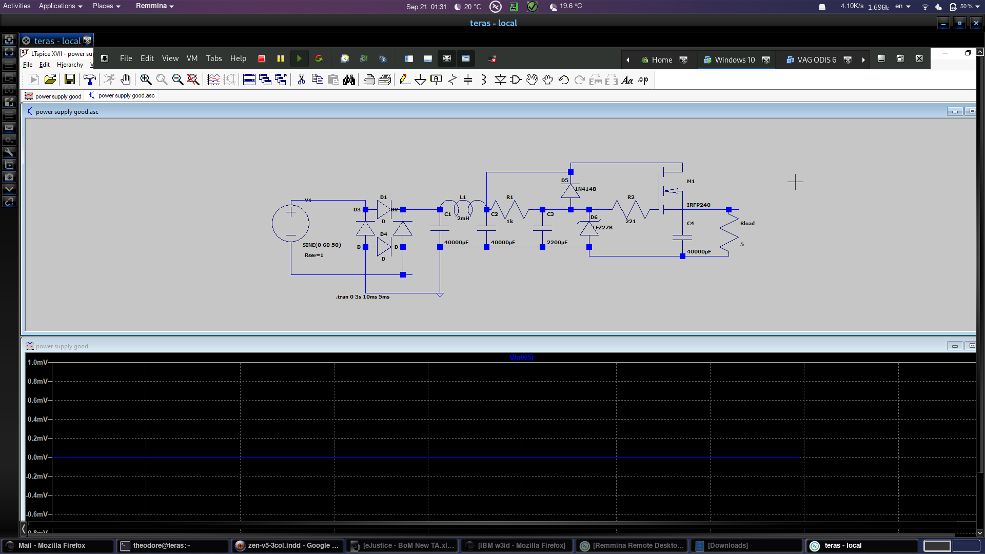

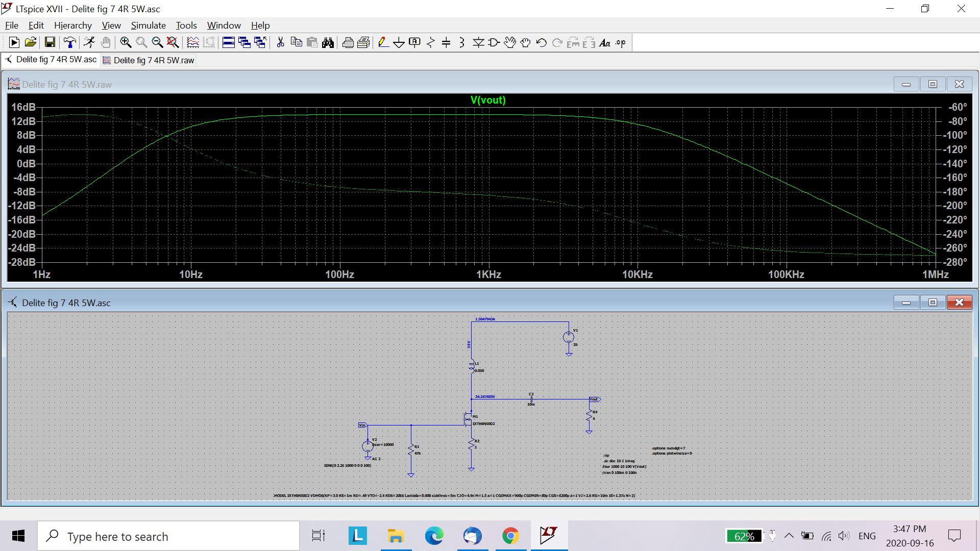

Question. I am trying to simulate the PSU from Zen 5 and when I use the topology as it is it doesn't work. When I change to 2nd scheme it works. Anyone knows what is going on? (ok it is half the PSU, only the positive, shouldn't have any issue right?)
Are you questioning NP's design? 😱
In your first scheme, it looks like the Rload connection to Mosfet source is faulty - there is no connection. It looks like you attempted to connect to the "body" of the Mosfet.
Once you get it running, I think you will find that you are trying to drop too much voltage with R1 at 1K. The output voltage should be about 25V - 4V = 21V or so. The current through R1 and subsequently D6 will be too high in order to get the output voltage to 21V. R1 can be increased to decrease the current.
In your second scheme the Mosfet is not regulating voltage. I believe it is doing nothing. The Mosfet is parallel to the Rload, but with C4 in series with the Mosfet, DC does not pass through so it does not affect the circuit. The C4 probably prevents the Mosfet from burning up. I think in effect you have a CLC supply supplying power to Rload.

You are right it was the connection, though it made contact but not.
Now it works but for 60V input transformer on my load I get 21V? Is this correct?
Never mind had forgot to change the zener, now drops to 40+ V. Seems impressive to me
The model with the PSU takes a couple of hours to calculate. Anyway, it is impressive how much is the voltage drop, I guess this is what CCS tries to beat right? However in the end, with some increase in distortion, it gives results.

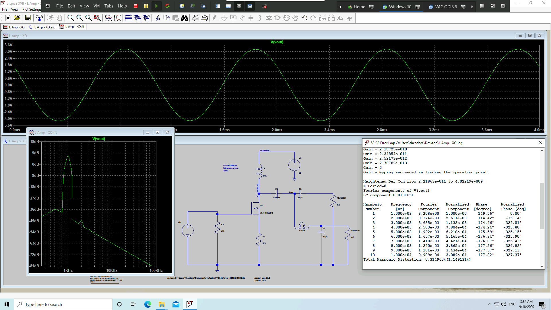

Ordered 180ES from China, aliexpress from our friend, too. Put it on the same circuit and LTSpice says it works, weird. I would expect to have to have much different settings. Anyway, when I have them will try them.

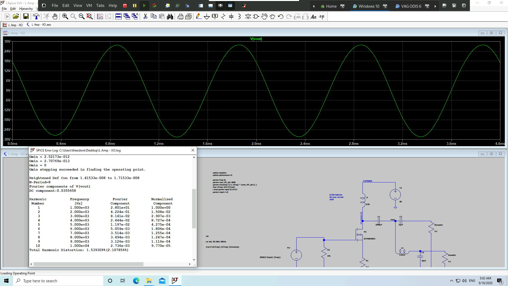

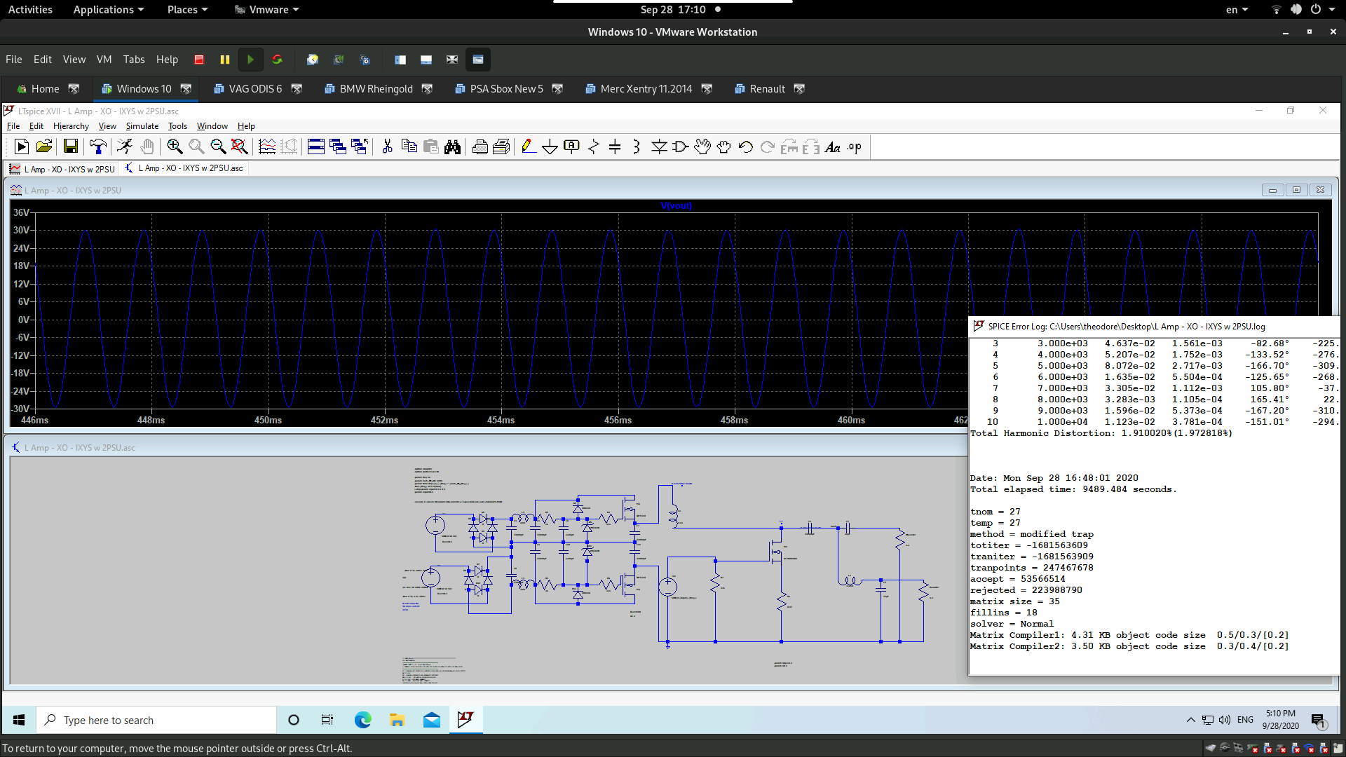

I have ended up in the below scheme, which seems to give me 1.9% thd with 30 Vp @1KHz. I am a little worried if I have the ground correctly or what. Simulation though runs like a kitten.
IXYS FET finally arrived but 193V hasn't been posted yet (finally bought from Italy). For PSU capacitors I found some huge 33mF. For output I ll try 3300uF and 33mF
