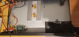

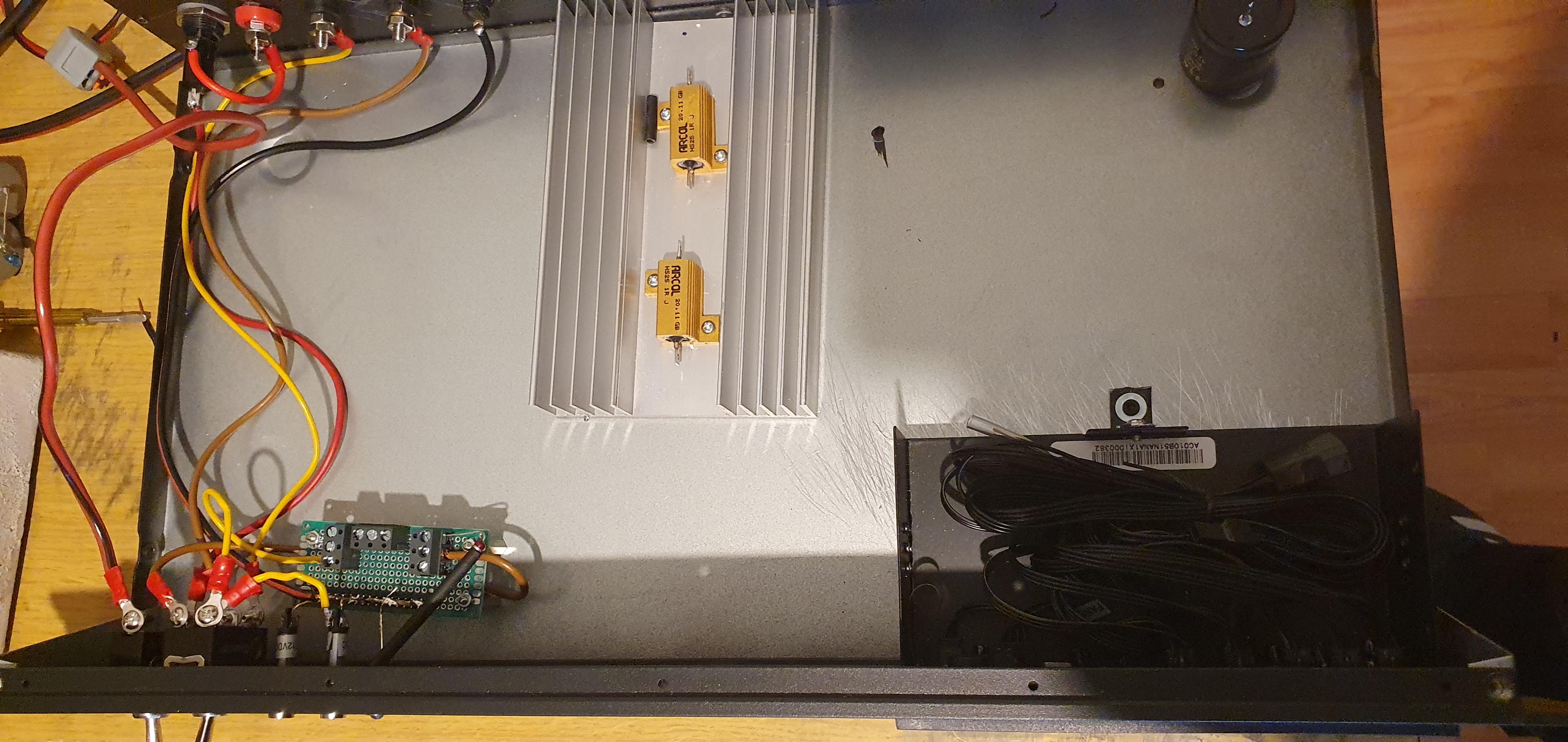

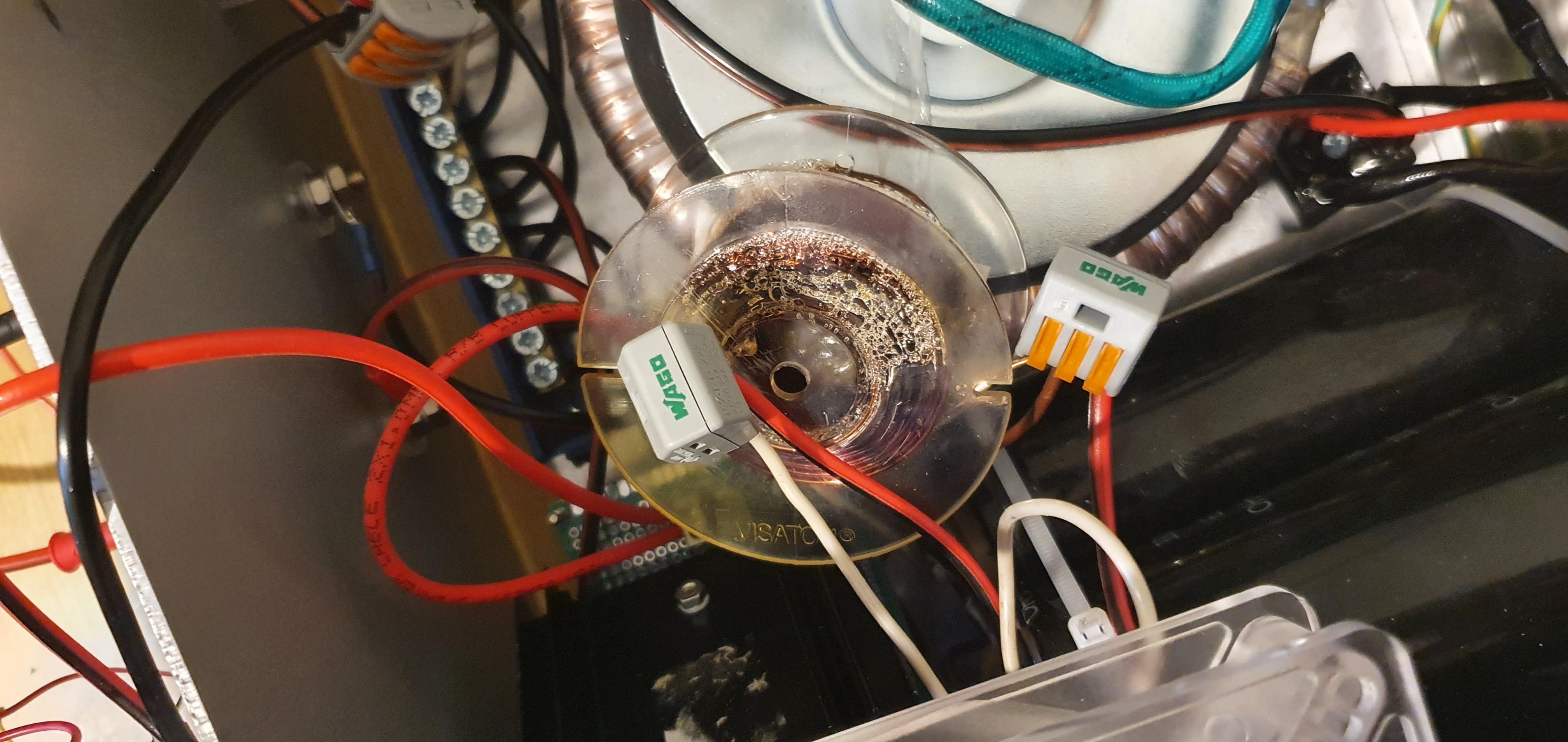

I have a victim of war, see photo, coils melted... I have ordered much bigger but still on the way
I am preparing the stereo, see photo..
