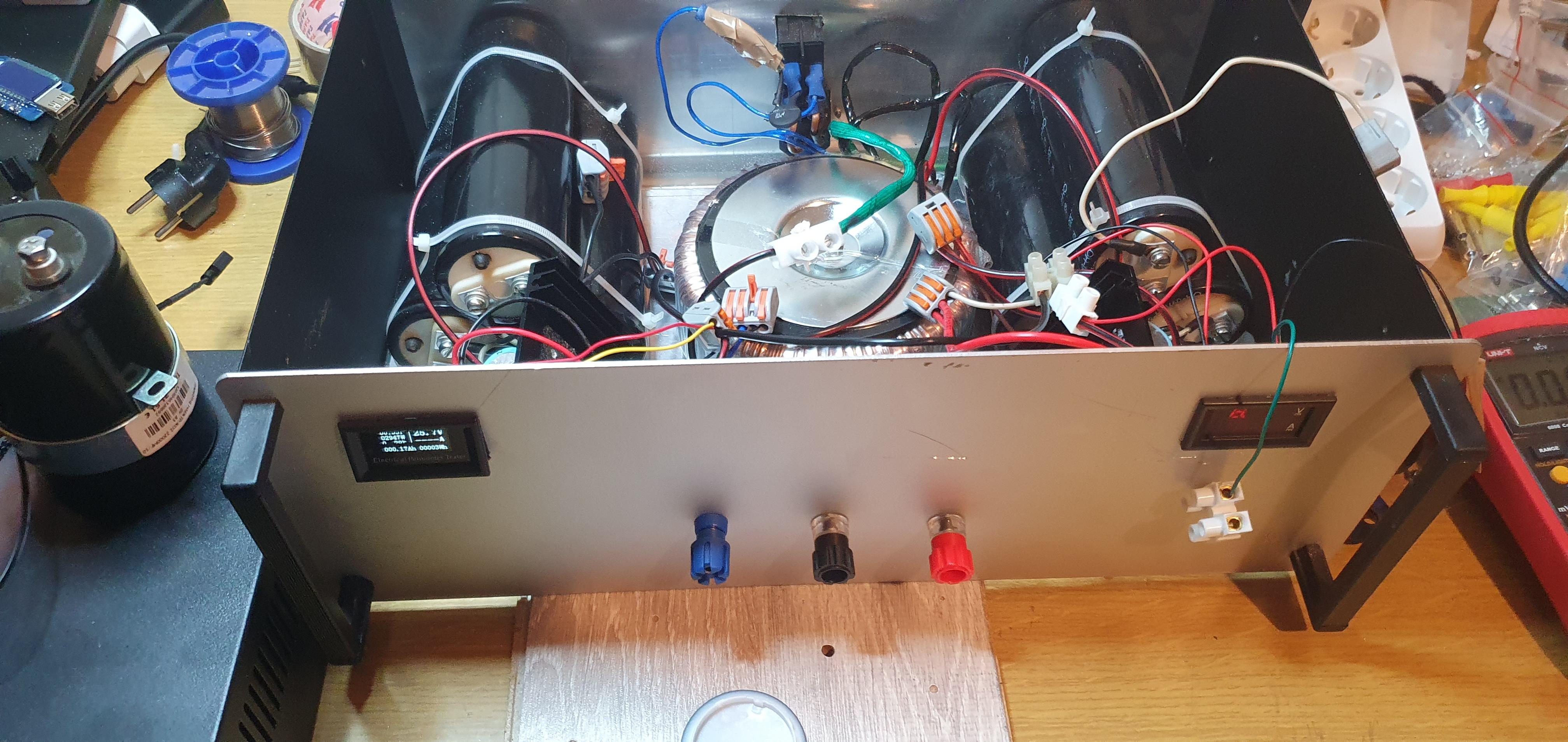

I have some questions...
- On PSU one of the two IRFPs are getting very hot, I have a minimal heatsink, is this correct? i need to put a big one?
- I have large capacitors 33mF in PSU. Is it better to use many smaller ones?
And some pics more..

The bias supply current draw is low so that Mosfet power dissipation is low. However the Mosfet in the supply for the Iq of the amplifier output device is dissipating V x Iq, so it needs appropriate heatsinking.

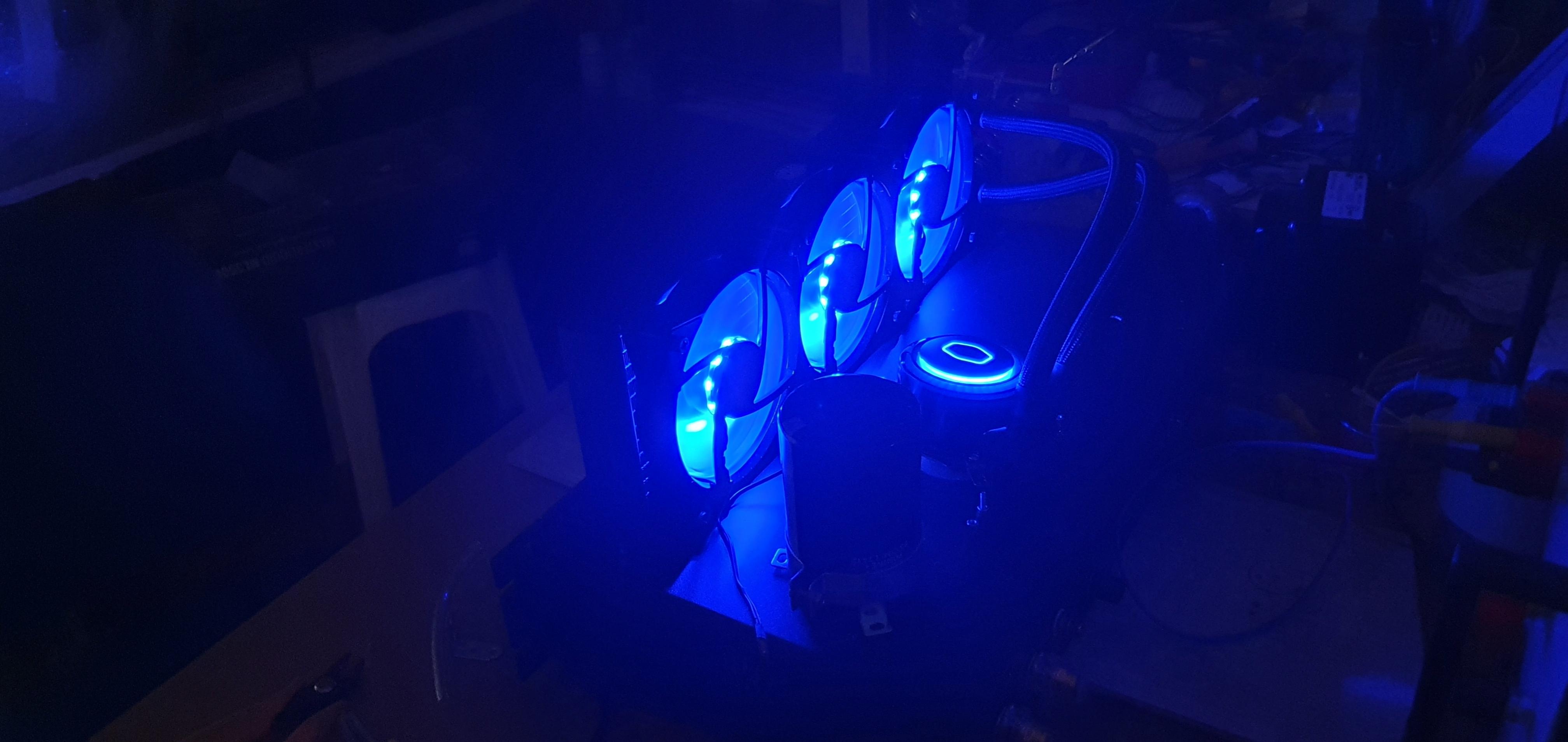

first one (blue) is porn worthy
keep them coming

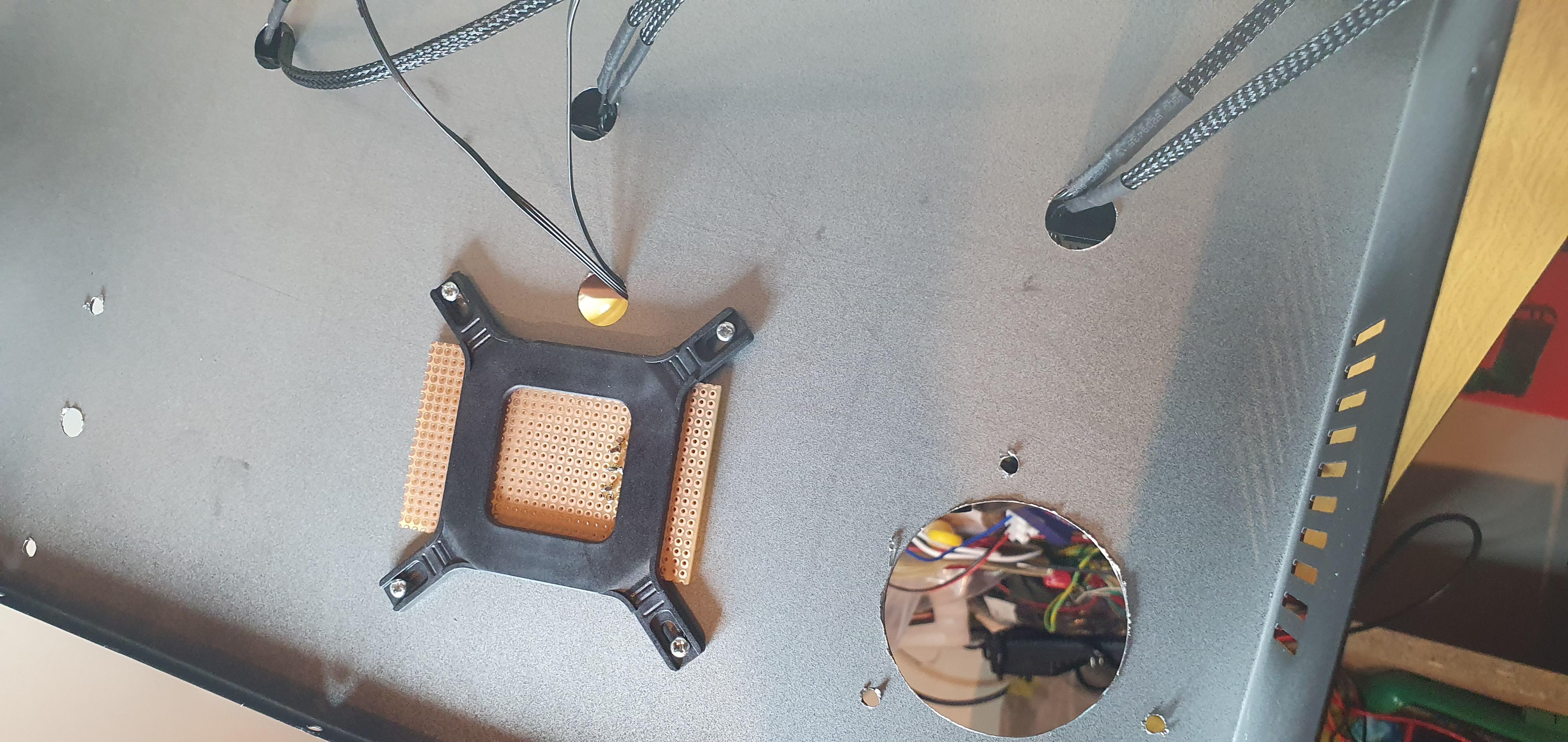

Water cooling started working 🙂 I touched one tube and was hot. Temp of FET 66 C with low speed of fans, 50 C with full speed.Is this a good temp?
Low speed is quiet enough, I can't hear them from 2-3 meters.

I also added fans on heatsink of FETs of PSU (IRFP 250), maybe I will put one pair more, now it has a pair, one for positive and one for negative. I have some small heatsinks for now, I have ordered bigger and maybe in the end pout them on the chassis, now are on the air. With fans working, I could touch for some seconds the heatsink.
I have put 120mF total for now, it will go to 200 mF approx when my coils arrive.
I know about the 300W+ that's why I am using the liquid cooler, which to be honest seems to do a great job. I let the system more than an hour running and seems very stable. Ambient temp was 29 C and when I have fans in full speed FET goes to 44 C in the end. I hope when it is working speakers consume some of this 🙂
