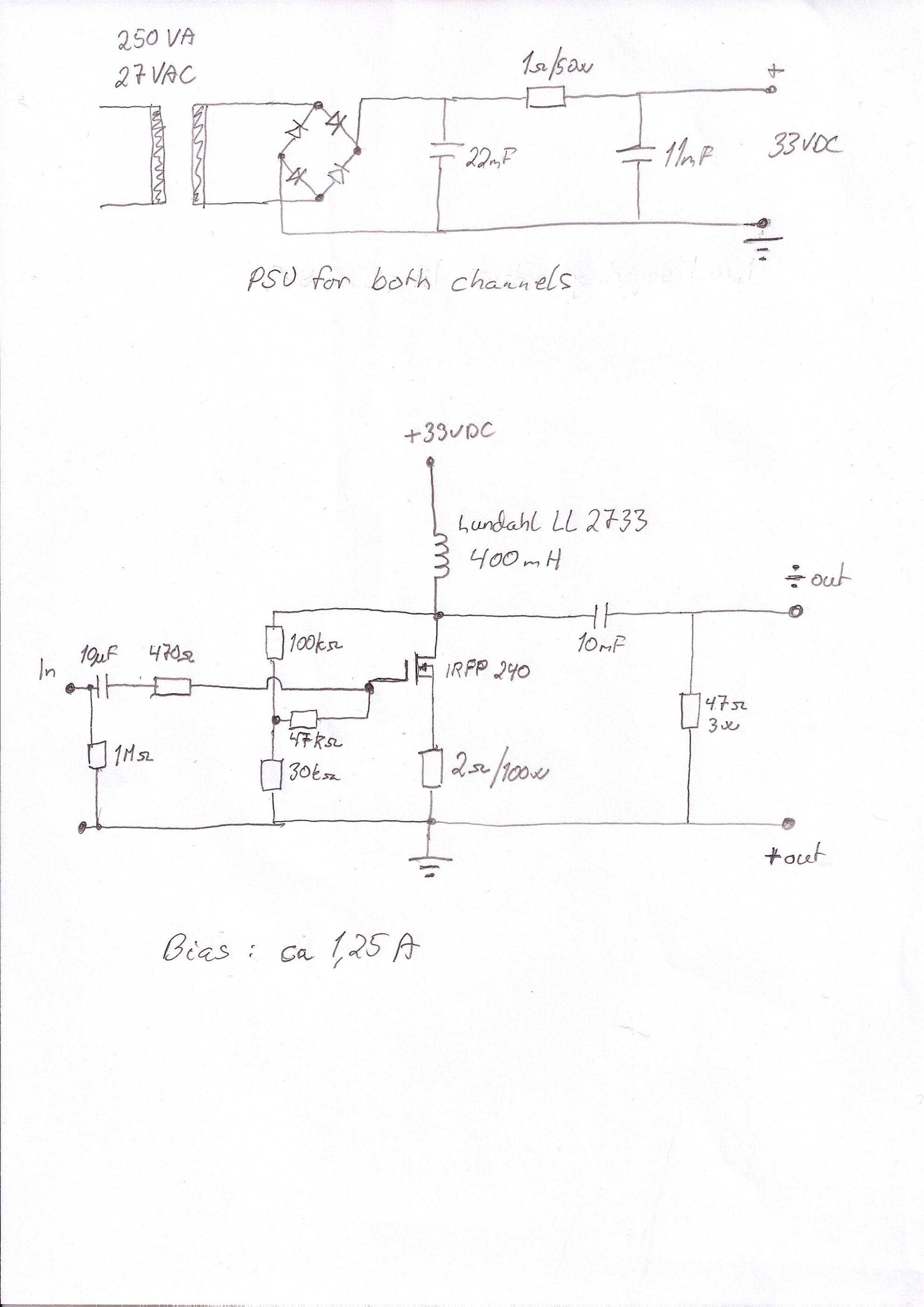

Update:
I am running steadily at 6A 50V, that is 300W. FET temp is 36.
Everything is fine, sound is now at an acceptable level still with SONY CD player only, didn't manage the weekend to bring the preamp.
Now I can listen on the Magnepans too but on family level..
I have a victim of war, see photo, coils melted... I have ordered much bigger but still on the way
I am preparing the stereo, see photo..

Situation:
6+ Amperes. This is demanding, it is very difficult to have 6+ A always on. Everything is getting heat. But now I know what to cool...
Ambient temp 22C. Vin 55V, FETs temp 45-50C (When music is loud temp falls). Vbias 2.4V, Vsg 3.3V.
