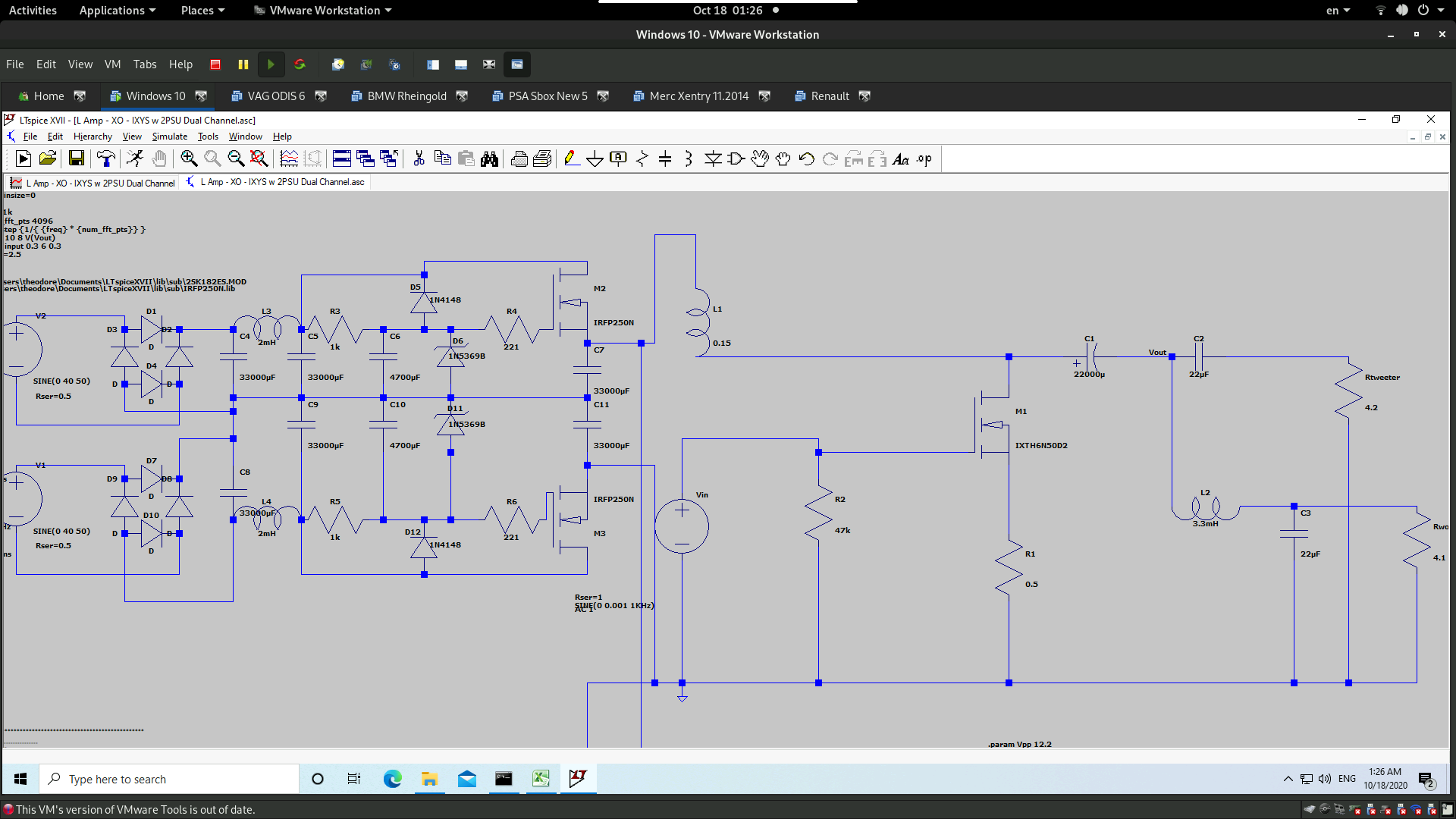

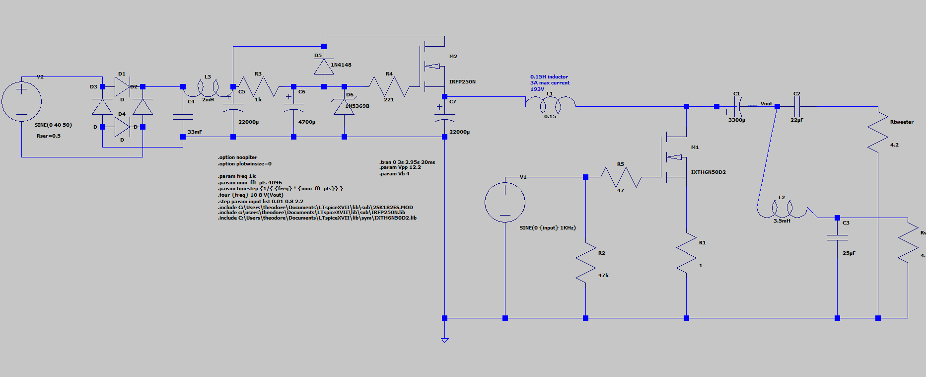

Simulation takes too long when I added the PSU into account. Before that it was running fast. Output FET is IXYS IXTH6N50D2. I found the models for IXYS in this site and i think IRFP on vendors site.
I destroyed the IXYS FET.
I upload one better picture, I have added there the XO from speakers nd PSU, also a second channel which doesn't show so we have better view.

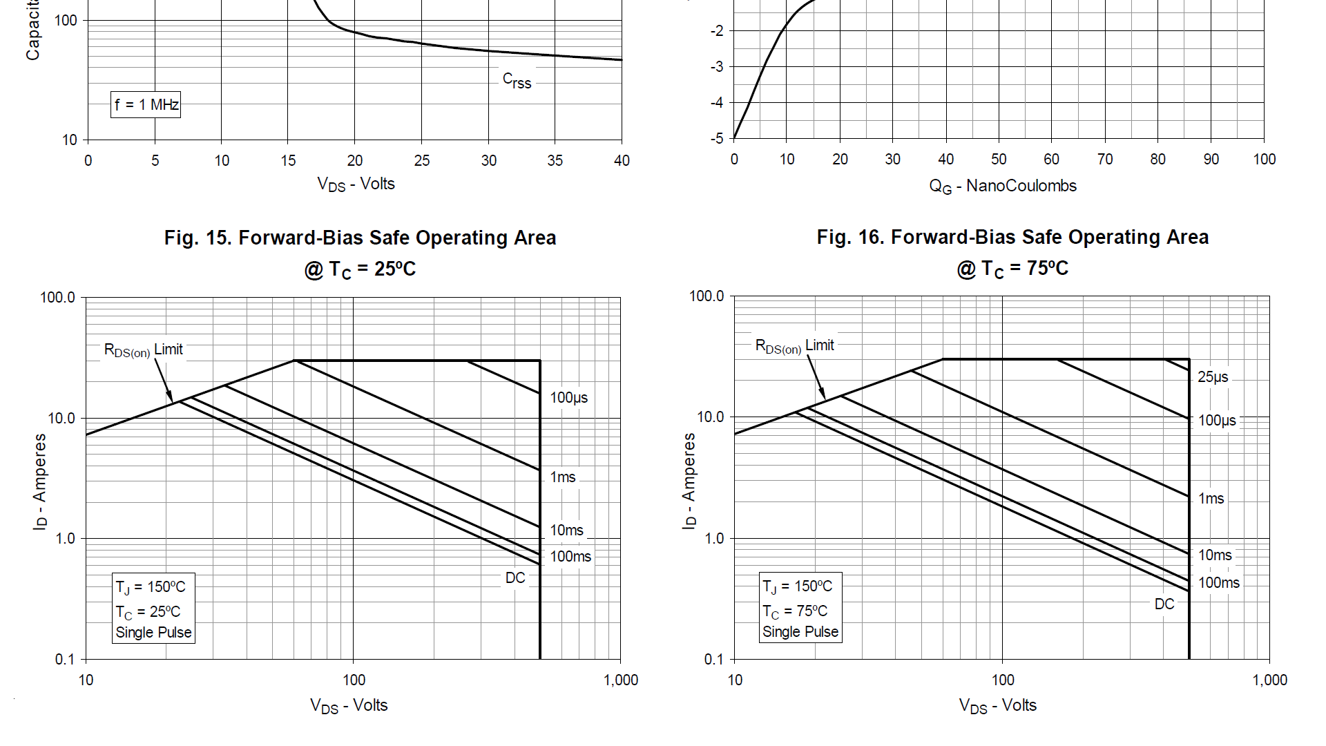

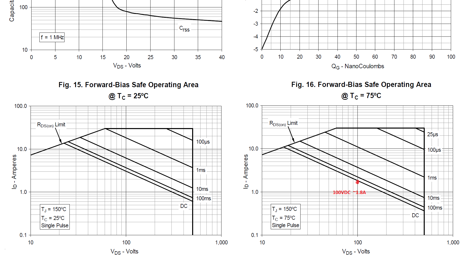

https://ixapps.ixys.com/DataSheet/DS100177B(IXTA-TP-TH6N50D2).pdf
SOA from data sheet:
Note that for DC operation at case temperature 75 C, 2.0A at 90VDC.
@Stanislav
This FET is supposed to be autobiased but you are right, I intend to put a potentiometer and a resistor in source in order to go to 2.2V, where Nelson has found a sweet spot at 100V, we ll see. A resistor between G and D? Like a feedback?
The 221 ohm is in series with input signal, right?
@PRR, this zener will looks from S to G, right? And what value?
@Ben I am not sure how to read this, what I can read is that for 75 C 4A and 100V I am safe (?), I understand I am safe below the lines right, I am not sure about the pulses. I am also a little concerned about this FET, I am ordering IXTH16N50D2, which has 16A nominal, since I am afraid some peaks may go over 6A.
I assume that is from http://www.firstwatt.com/pdf/art_delite.pdf De-Lux De-Lite.
The De-Lux De-Lite has a 100VDC supply but it also has a 300W bulb, not a Hammond 193V choke:
"As the light bulb glows brighter, the distortion continues to decline and the power
increases. And the transistor runs hotter, so take care that you have enough
heat sink. We are getting into the 50 to 60 watt dissipation territory for devices
which are rated at 300 watts, and with care mounting the transistor, it should be
plenty fine if you can put your hand on the sink for 10 seconds (50-55 deg C)".
Also:
"We can do much the same for the IXTH6N50D2, and Figure 10 shows the circuit
of Figure 7 at 100V DC and 2.2 A. This requires a Gate voltage in between the
Source and Ground voltage, so we adjust the input bias with a potentiometer as
shown. Typically a 10K pot will end up being adjusted for about 25V DC at the
Drain of the transistor."
So Vds is 25V-2.2V= 22.8V, Iq=2.2A, power dissipation = 22.8V x 2.2A=50.2W.
You are running your device much hotter.

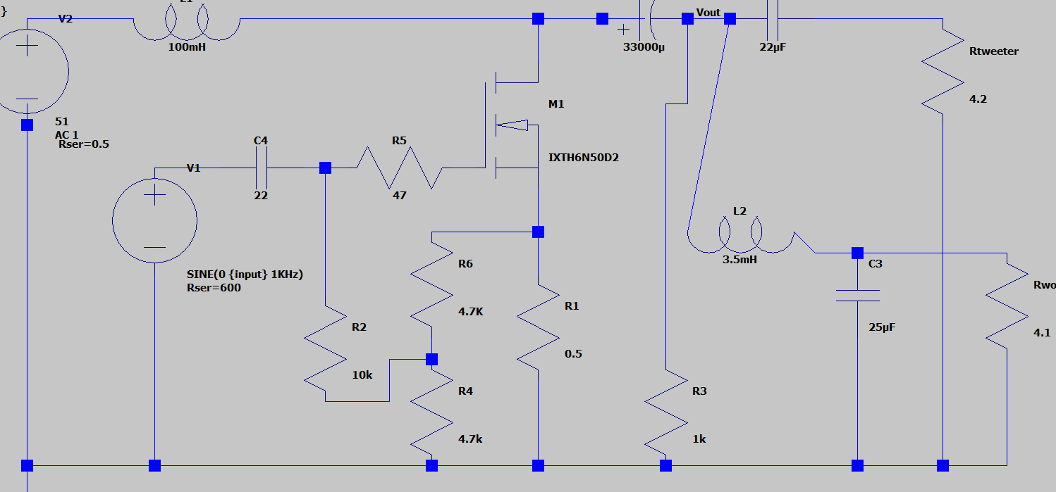

I want to bias this thing and I followed the voltage divider as per scheme and it was a total defeat. Rs smoked again, measured 13V Vs before I shut it down.... I don't understand what's wrong. Double checked it, in LTSpice it works and gives good distortion numbers.
I answer my own question. It seems Rs needs cooling. what happened is that Vs started with 3.7V, then it got too hot and dropped resistance too low, so I was over 15A (everything hold together though . I ordered 0.5 to 1 Ohm resistors 50W, so I can put them on a heatsink.
Seems that the wattage resistors need cooling after a couple of watts.
For now changed to 1.5 30W I had and bias is at 1V. Better, sweeter sound but for now I miss power, waiting for correct resistors.

.. to continue my monologue, Vs measures 3.87V (LTSpice shows 2.7). Heat dissipation in LTSpice shows 6W on Rs. Bias is 1.86V. Adding bias surely pushes amp more and Rs produces heat.
Now the sound. Distortion is lower indeed, I believe I am somehow reaching the limit of the cheap setup. Tomorrow I hope I ll find time to put on a preamp I had built 30+ years ago and was laying around there... Vd is 51V. 193V is a big dog, handled many times more than 3A.
Now we should be more than 120W heat from the FET, we are doing ok.

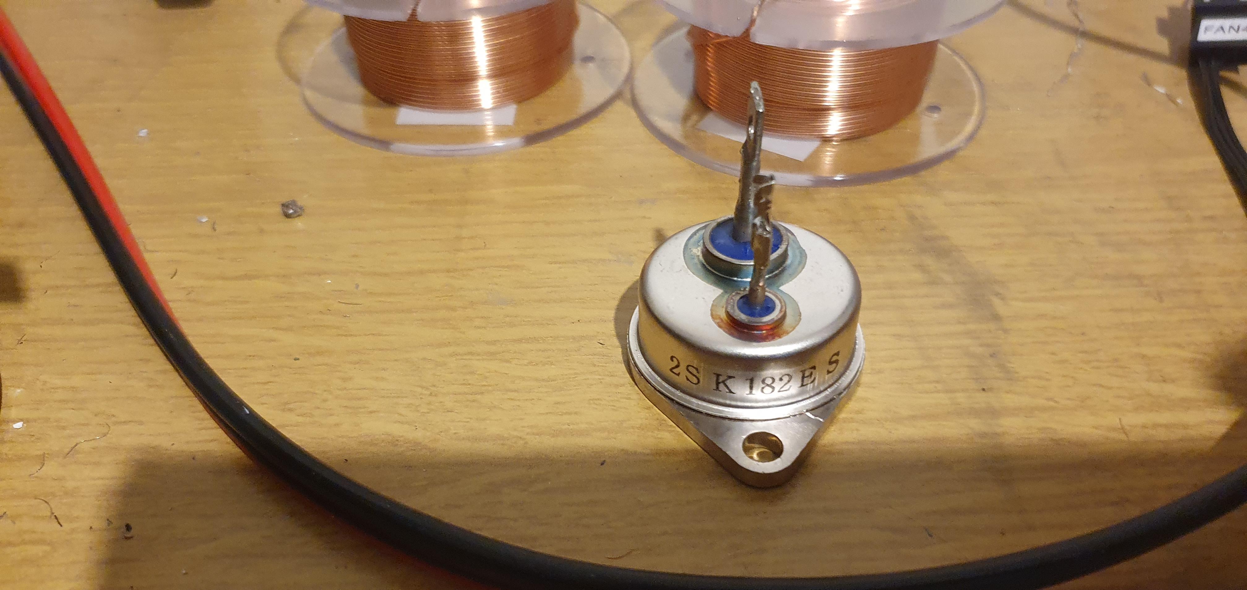

Today another toy arrived, see
