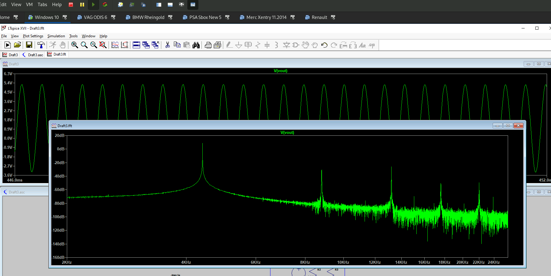

I am not sure I get this right. This is 1 Vpp input 4400Hz, and I put FFT, this i the result...
Power output is (Vrms out)squared/Rout, or (0.707 x Vp-p/2)squared/Rout.

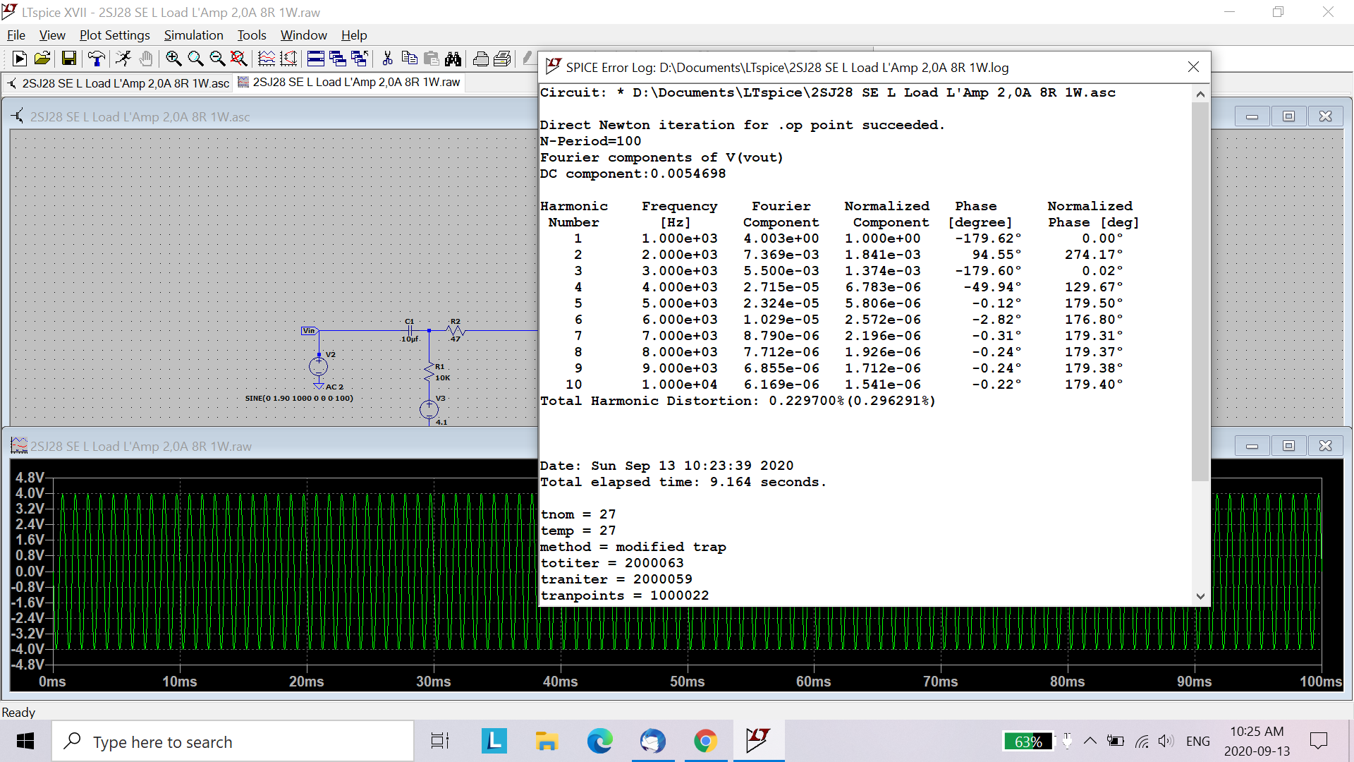

The "standard" input frequency that many people use for Distortion analysis is 1000Hz.

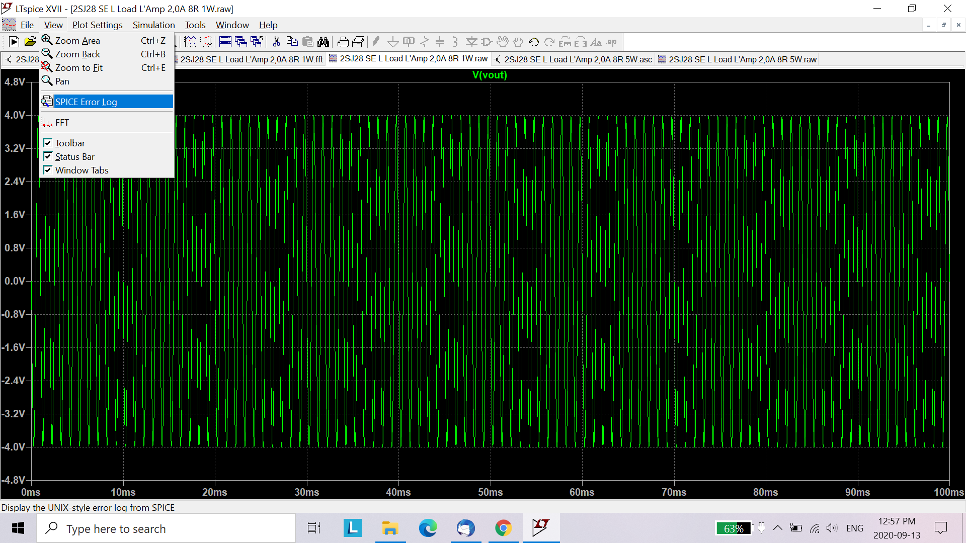

For a numerical display of Harmonic distortion, go to "View" and "Spice Error Log".

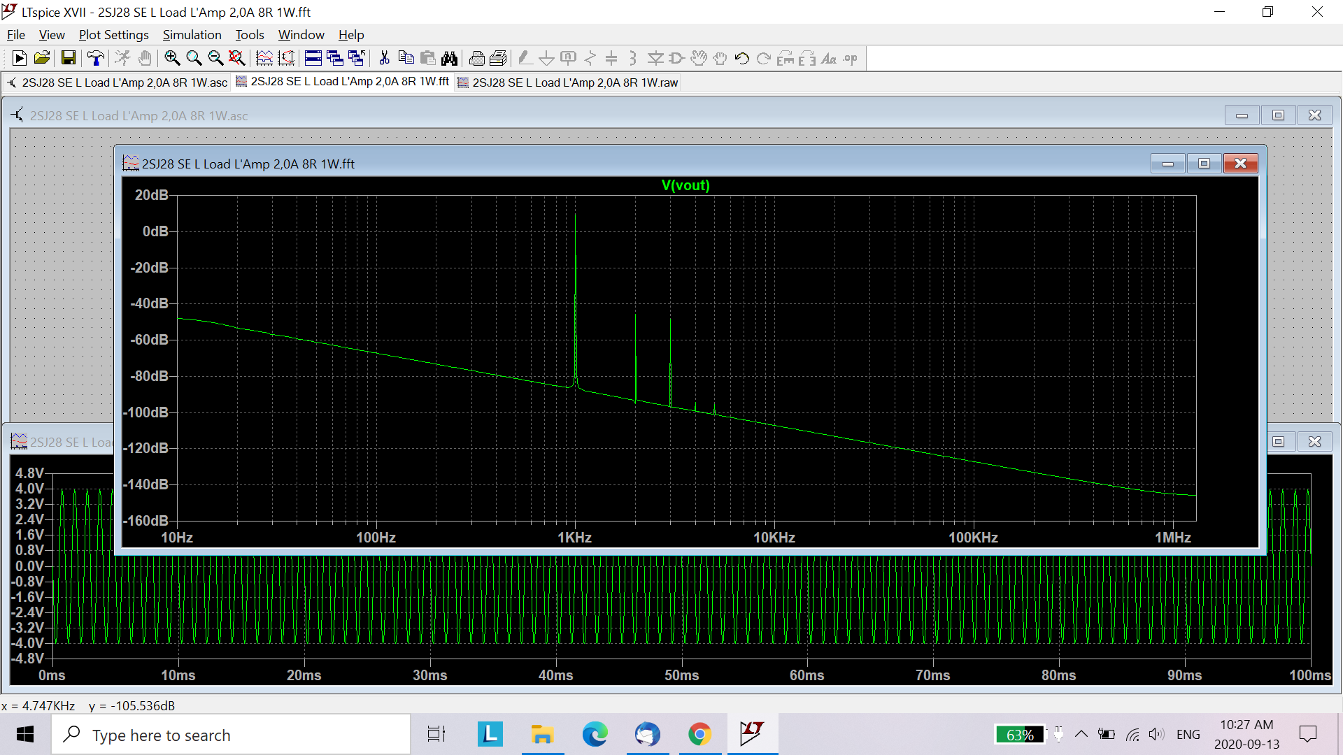

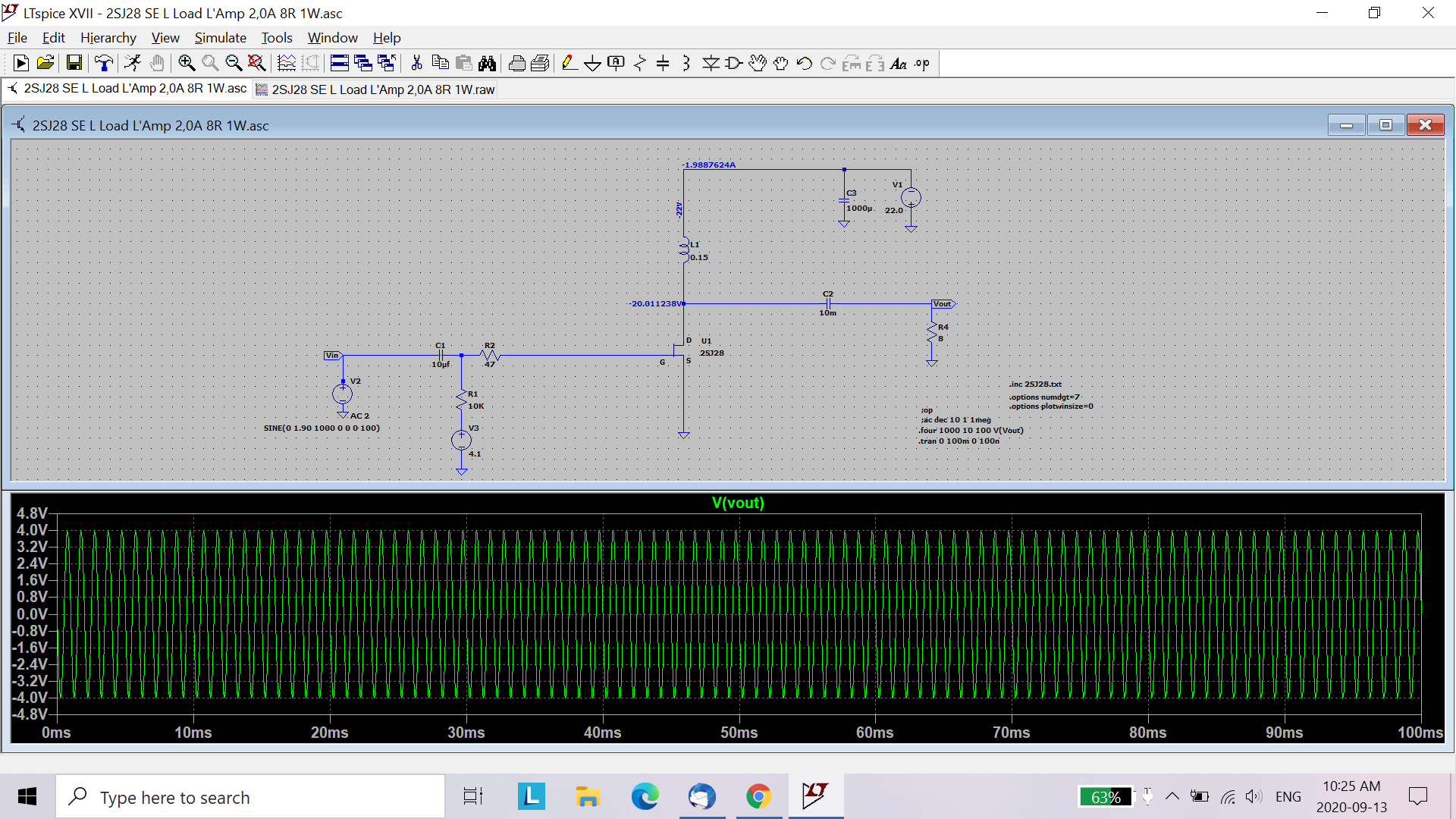

Here is one that I had done of one of my amps:
Yep, 1W@1K error log is what I usually check at first. However, your 3-4W output chart does not look very healthy anyway, a little excessive higher order distortion for this type of amp, maybe.

You should see the "Spice Error Log" option in "View". It is directly above "FFT".

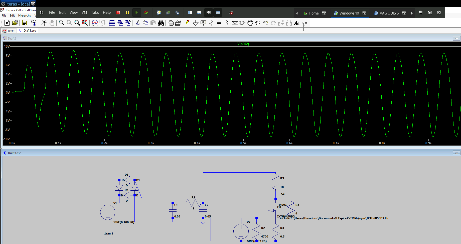

Ben, I worked a little, now seems a better schematic I think.
When in max, I get 16Vp.

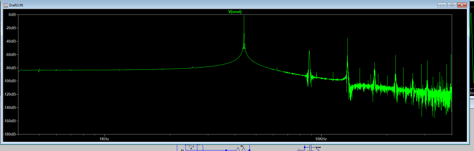

I tried many hours of testing, the original schematic included. Same FFT always. I believe that I don't do something correct, since I get 262000 samples on all 3 seconds of the run. Anyway, I ll try it anyways, waiting for parts.

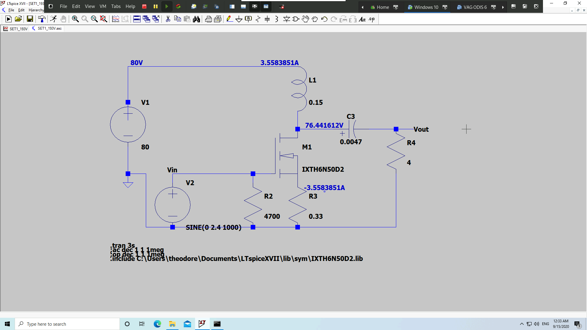

In your simulation circuit I see that you are running 3.56A through a 0.15H choke. If that is a Hammond 193V, that is higher than its 3.0A rating.
You are also dissipating approximately 270W at the IXTH6N50D2. Data sheets show that it is a 300W device (also see Safe Operating Area graphs). I believe most builders run devices up to 25 or 30 percent of their rating for durability and long life. Of course the cooler you run them (with more heat sinking or active cooling) the more you can probably push them.

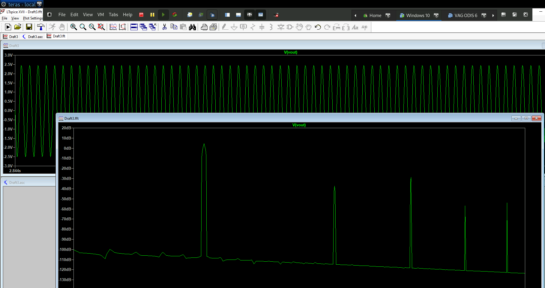

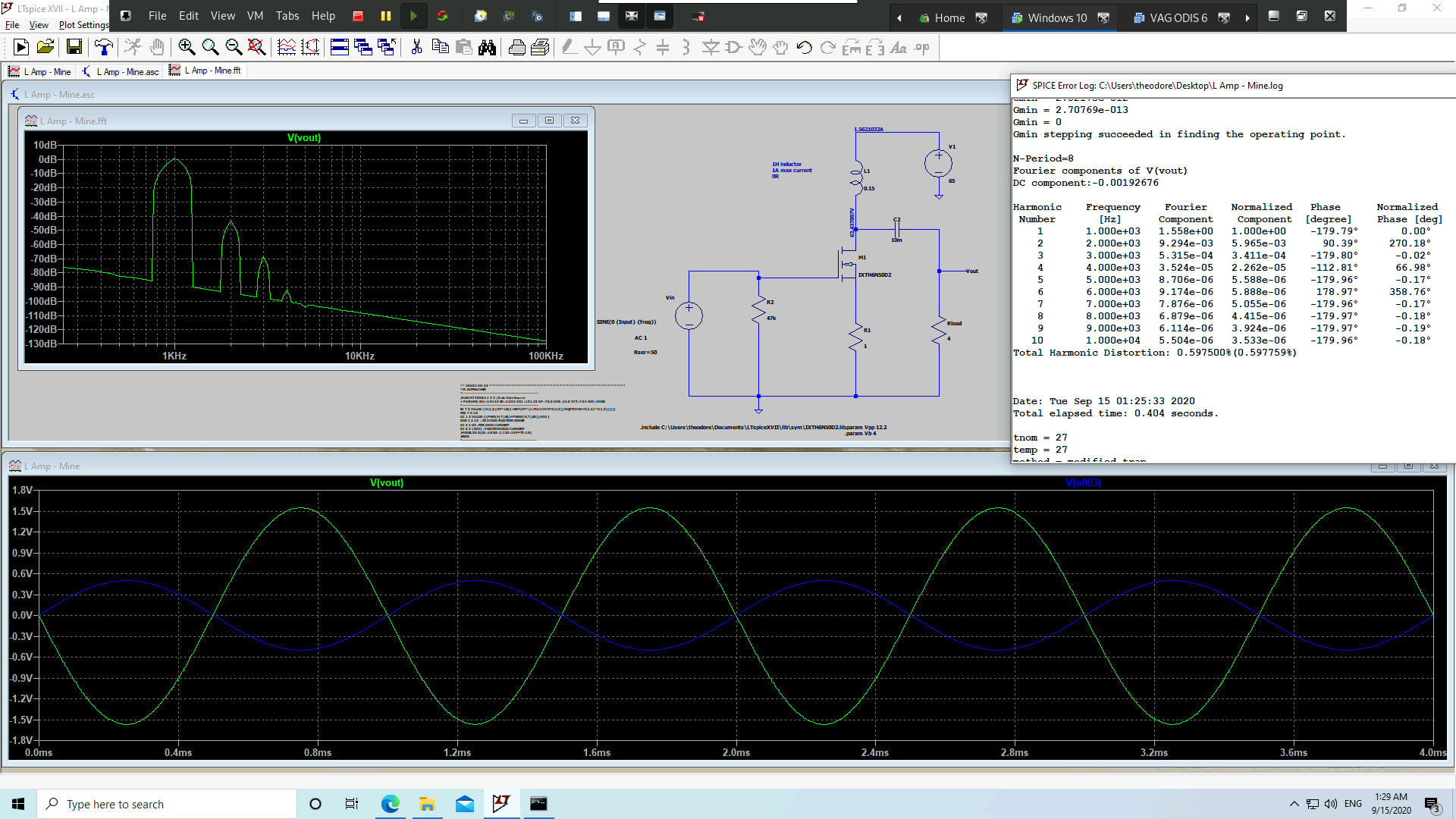

Still en error in the log for the FET bu anyways... Here it is...
Run some tests:
1W 0.23% THD
12W 4.2% THD
Run some tests:
1W 0.23% THD
12W 4.2% THD
You are still running it on the hot side at 97W.

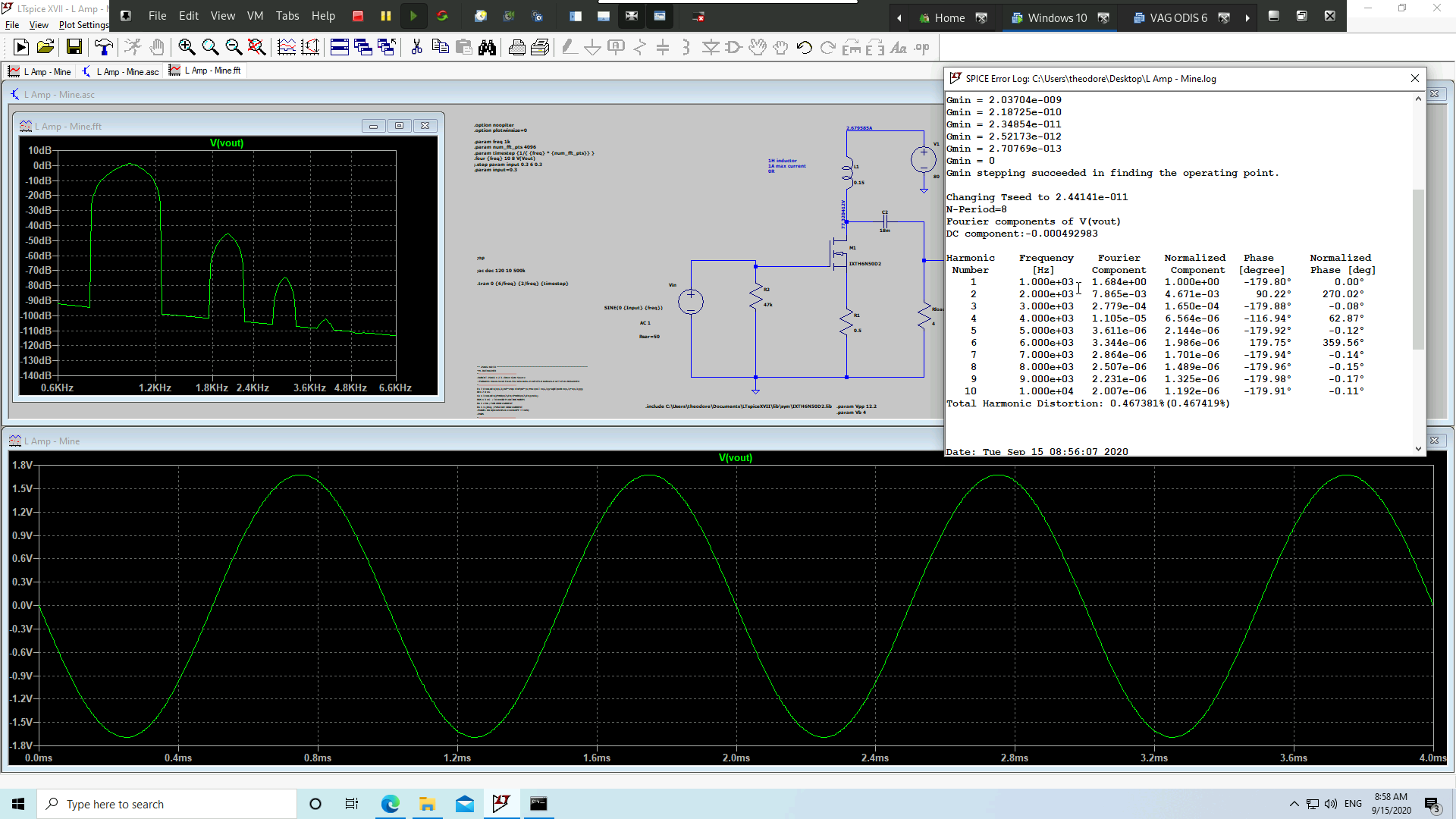

I wonder about the 1W and 12W THD that you posted. The simulation run that you posted showed Vp out of approximately 1.55V at 4R. P= (0.707 x 1.55V)squared/4R= 0.30W. Simulation showed THD = 0.597...%. This is higher than 1W 0.23% THD.
If you are building this circuit, I suggest you do a variation of Fig.10 of http://www.firstwatt.com/pdf/art_delite.pdf (choke load in place of light bulbs). With this circuit, you can adjust Vgs to vary Iq. That gives you flexibility when seeking your preferred operating point. It also has lower distortion so you will get higher usable power.
I would also suggest you start with NP's operating point. He ran it at 2.2A and Vds is somewhere between 30 and 35V. I can't be sure because I am not sure what the light bulb resistance is in that circuit. Simulate with 8R speaker load to start with and compare to NP's measured distortion. Then change simulation to 4R speaker load and see what changes. Then go from there.

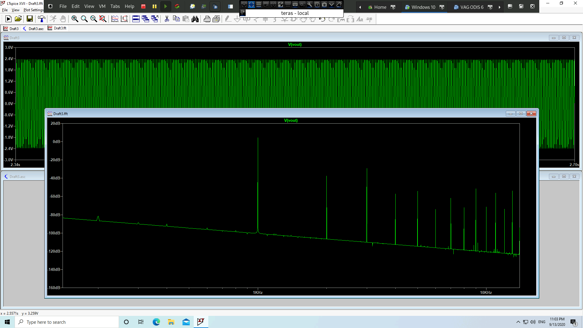

Oh, I changed the values on the circuit, so THD is different.
Now on this example we have 1.7Vp^2 x 0.707 x 4 = 5.6W and THD is 0.46%

Again, your power calculation is incorrrect.
rms Power = Vrms x I = Vrms x (Vrms/R) = (Vrms)^2/R = (0.707 x Vp)^2/R = (0.707V x 1.7V)^2/4 Ohm = 0.36W
You are not getting the power that you think you are getting.
Also running the device at 77V and 2.7A (208W) is quite hot.😱
