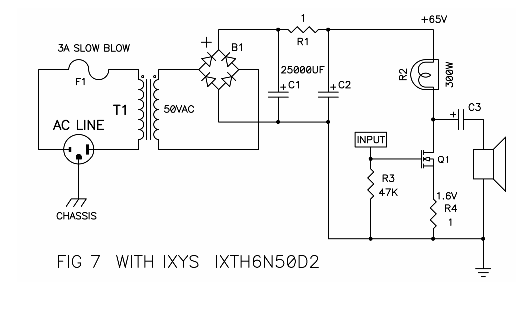

Ok, I finally got around to making a proper schematic of what I want to build. It's really just a combination of the De-Luxe De-Lite circuit with the L'Amp 193V power supply.
I remember reading that inductor loaded amps are trickier to bias than those with an active or resistor load. Can anyone shed some light on this? Would it require a scope to measure the output and its distortion?
Might be a neat thing to build, make a couple monoblocks on some nice pieces of wood. I just want to make sure that the circuit isn't so bad that I can't fix it if it doesn't work. I do want to try something riskier than my ACA though :p
Hi reviving this, seems to be very interesting. I want to build a pure class A, single ended. Here are the requirements:
1. Drive my Magnepans 3.6 or 1.6. I have changed crossovers on both with Mondurf gold caps and seem a little more "sensitive".
2. I can suffer heat from FETs at about 300W, I will use liquid cooling.
3. Preamp will be Symphonic Line RG3+
4. I will use best capacitors in the market, so the less capacitors the better, so I am thinking last implementation from firstwatt. In general, I want to follow a very minimal approach, with excellent quality parts.
So questions,
1.how the schematic should be? Is it feasible?
2. Could this implementation compete/beat my Symphonic Line RG7 monoblocks? Or should I look some other implementation and maybe not Class A?
I read some part of the threads, they are huge in content.... :)
I decided to go really pure, at least for start and see where I will go.
This is what I will do.
I ordered the FET from Germany.
For prototype I have all the rest except the transformer. i am going for 50V 800VA, I am ordering any time soon.
I will use Coolermaster liquid cooling.
I am excited :). my first audiophile creation.
I am electrical engineer but my job has nothing to do with electronics, so it is what I remember from Polytechnical school (almost nothing), at least I understand what I read here but for sure I am far from creating stuff my own.
I won't do it fast, because I am really busy and I have to finish two other projects.

Questions:
1. can I use two of them in parallel to produce 24V?
2. How many uFs for capacitors in PS in CRC topology?
3. I understand that my road is to get one Hammond 193V. Till this arrives, could I use one of these toroidals? On the low voltage side?
4. I guess I need 14Ohm for R2. Is this resistance or impedance?
5. C3 what capacitance for 4ohm speaker load? And what type?
Yes.
I would recommend to see ripple performance with PSUD or LTSpice.
Most probably not enough for flat 20Hz. You can certainly check 1K signal with them.
14 ohm is resistance. Are you going to use choke or resistor?
I would recommend to check low frequency response with LTSpice.

@ZenMod, ok I have seen a schema of 2 transformers in parallel to double voltage, I wanted your valuable opinion :). So I ll go for it.
@plasnu I have just installed LTSpice for the first time in my life. I worked a couple of hours, i need many hours to understand how it works. I know I have to do my homework guys, haven't work with electronic circuits from university. I have a lot of work in front of me but I would like to learn, kids have grown up now and I need to have back my music... :)
I have read the other threads and I understood that 193V is the best solution, although lamps are fun. So I believe i will go with 193V, unless this is damaging my purist sound concept. Note I have chosen the schematic without the input capacitor, i want to have the simplest path for my sound signal travel.
Of course this will be the 1st approach, we will see what happens and if we need to go two stage (if this design has no success).
Again for (5), what type of capacitor? It seems electrolytic but I guess I don't want an electrolytic there
I started leaning LTSpice with Michael Rothacher's Youtube video. Also, his blog has concise articles to understand the concept of zen style amp. Both highly recommended.
If you planning to pursue choke loaded amp in the future, get as large as possible choke. Better low frequency response, and I'm not really sure if you can get enough power with 3A limit of 193V.
Nelson Pass uses electrolytic + small bypass film for SIT-1 amp and F8(?), and the most of the other people do the same. I understand you do not want to see electrolytic there, but there is no other practical choice, I suppose.
