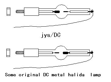

I got my new lamp. It is for commercial projection use. people use it to replace the
I got my bulb today as well 🙂 good job guys!
but I have a problem! I installed the new bulb into the housing today, and the bulb works great, but the projector doesnt! the bulb will come up for about 15 sec or so and than will turn itself off, and the lap LED will start flashing indicating that it overheated! is it that the bulb is 400w instead of 370w? and its hotter than the stock one, and triggers the temp sensor?
I would really appreciate it if someone could help me with this!
Thanks for the help 🙂
I did some tests and I dont think its a temp sensor anymore. I took the lamp out and connected to the ballast, and powerd it on, the lamp fired up (and damn its bright!) but it did the same thing again, after about 15 sec, it will turn off and lamp LED will come out. Did I maybe install the bulb wrong? are the ground wires suppose to be connected in a very specific way? .... I will take pictures later and post 🙂
Thanks a lot guys!
Hello, I got the Jys bulb too work as you can see in the picture, but there is no screen, it just projects a blank white image. I opened it up and saw that the LCD's are working.
When I start up the projector it gets brighter and then it starts to pulse (flash) in a constant pattern, I'm not sure what's going on.
Nothing is projected, not the Proxima logo or anything, and I have my Xbox hooked up to the Video 1-Svideo connection. I get the audio from that but I don't get the video. I've checked all the connections I can't tell what's going on... 😕
Anyone know what might be wrong? Help is greatly appreciated! 🙁
pic
