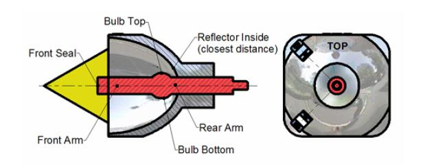

I have already dissasembled a 4805 lamp, and did exactly as you mentioned...(using a diamond bit in a hi-speed rotary tool) to remove the white cement from the ceramic rear housing. So I am primed & ready for new lamp install! I have read up as much as possible on the short arc lamps we need.
Question 1: Ywh website address?
Question2: You mention a "hotspot"....??????
Question 3: How do we realign the lamp properly?.....it seems that the focal length needs to be measured from a good lamp and duplicated with the new bulb?
Thanks for your help!

marek,
look at your projector or bulb. It may have the info on the side listed just like on my sharp projectors.
But I'm guessing its ac😕
BTW- for anyone consider using muffler mender or similar to adhere the lamp in the center, DON'T use it.
I find the mender paste too goopy to work with and as a result, the lamp pushes to one side because of it.
I am considering high heat ceramic clay or similar instead as it is thicker and not as goopy as muffler mender, allowing me to better center the lamp without fear of it moving around before it dries.

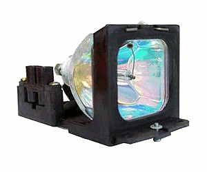

Plus UP880 replecament lamp
My name is Adamo and I'm french with a bad english (sorry for that).
I'll have next week a Plus UP880 projector (for free, normaly) with a dead lamp.
According the replacement pdf file, the new one I need is a JYd120/A.C.
Could someone give me the price, shipment cost and paypal charges, please?
I also would like to know where to place the order.

ahh
and hotspot means the optimal point of the middle of the lamp....
that the light "flows" correctly.... its very important on a dlp projector....
normaly you have to mesaure how deep the inner lamp is plugged in to the reflector ant mount the new one the same in....
but if you dont have the right size you can see in the front of the reflector and try to alingn them... if you see the middle sidewall of the inner lamp in the middle of the reflector it seems to be ok...
but better is measuring....
or you can move the bulb in and out and take a look at the light output.... but the problem is you have to do this in the running condition..... this is very dangerous!!

"hotspot" = focal length
Ok...I was using the technical term for"hotspot" which is "focal length". Adjusting the bulb depth in the reflector will be critical for proper lamp function. If the focal length is incorrect I would expect either decreased lumens to the screen, or even projector damage. As seen in the attached pic, the focal length (yellow cone) is precisely targeted into the color wheel or optical engine assembly.......so IMHO, this focal length would need to be measured and duplicated exactly to acheive equal performance of a new lamp. As Psycho says, this is not a small feat.......First you need a working lamp and a way to measure the focal length while the lamp is on......and protect yourself from the UV......I'm beginning to see why they charge so much!
The solution would be the ability to buy the bulb/reflector without having to buy the whole lamp cage assembly...but we know that's not gonna happen......
