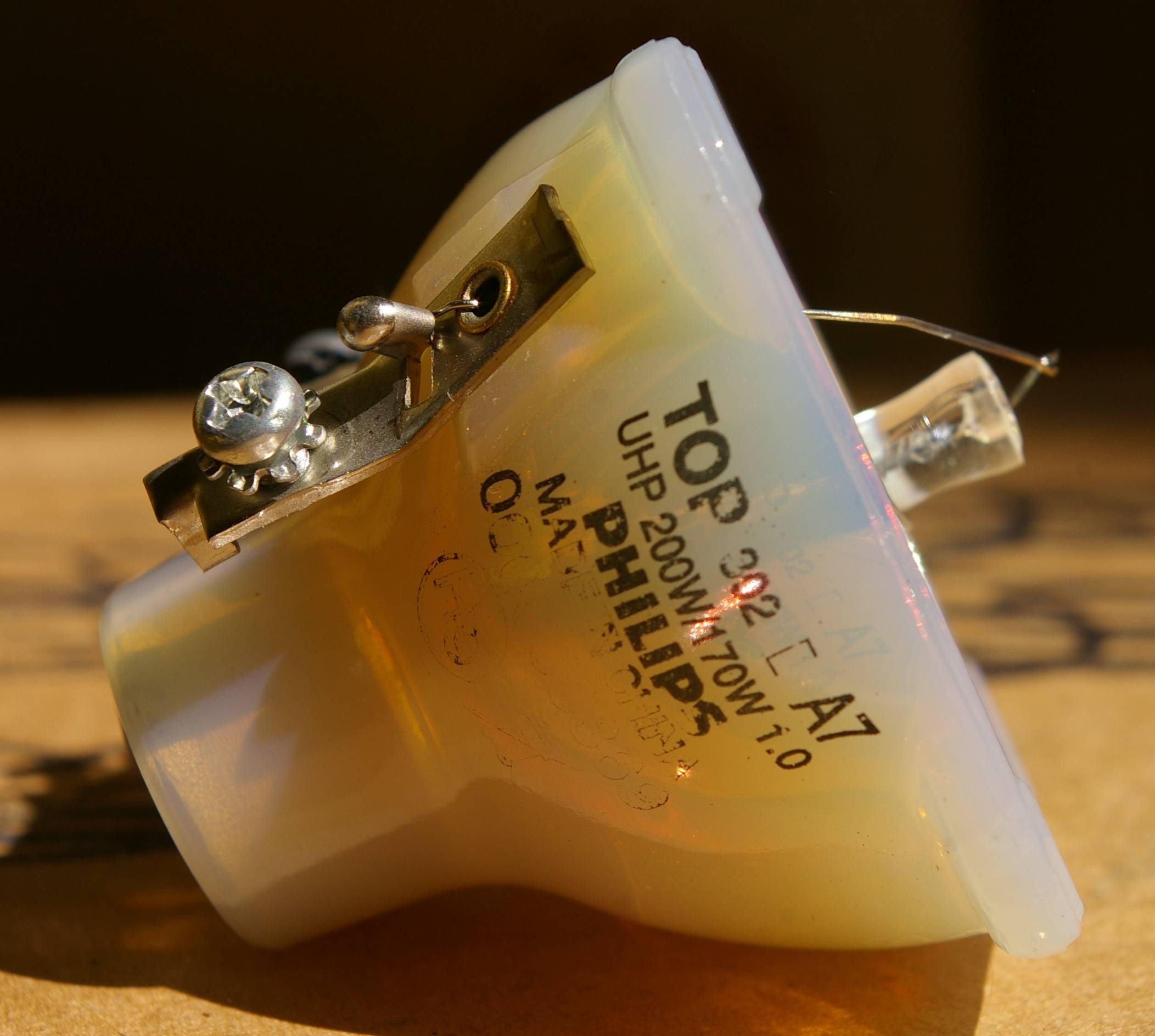

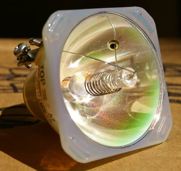

Hi ywh,
Here are some pictures of the reflector and lamp. Let me know if you need to see anything else.
Alex
