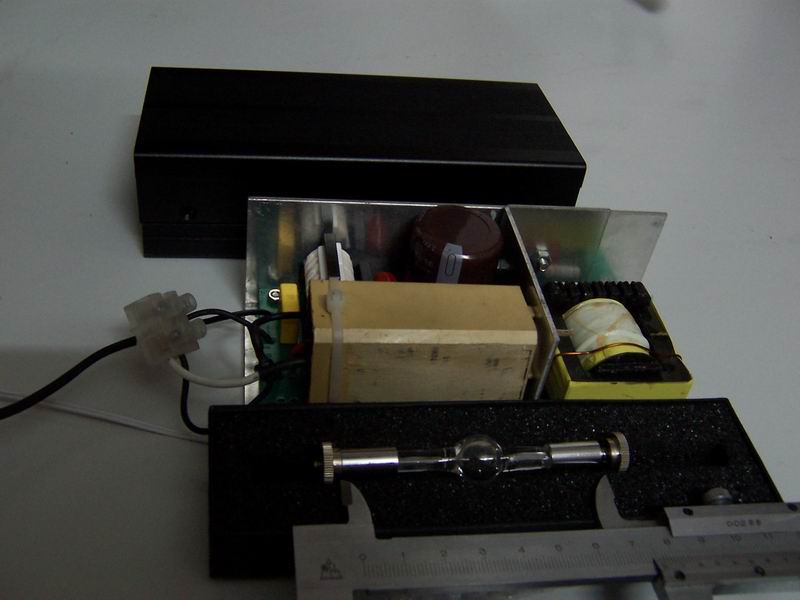

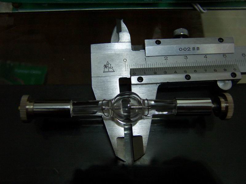

I got my new lamp. It is for commercial projection use. people use it to replace the
I got my new lamp. It is for commercial projection use. people use it to replace the bulb in the commercial projector's lamp (the "light" part, the refelctor is kept).
Here is some specs:
wattage: 250W
arc length < 4mm
color temp: 6500K
life span: > 2500hr (replacing, not failure time)
ballast: integrated electronic ballast
I am going to replace my OSRAM HQI 5000K. I will post result in a few
days and compare to the HQI.:smash:

Wow! it is a wonderful lamp. how much did you pay for it? how heavy is the ballast? can the ballast be used in US (110V) ?
I paid about $120 for the whole set. It is cheaper
than a HQI setup.
The ballast is 220V, but the manufacturer told me they can make it 110V if I special order a bunch. It weights about 500g, not as heavy as core and coil type ballasts.

That bulb is a double ended one. It can not be put in an ellipsoidal reflector.
Do you know how many lumens it sends out?
As for the LCD, I'm also interested.
change a small screw capin one ended, connect the wire,other ended is setscrew,it can be put in an ellipsoidal reflector.
