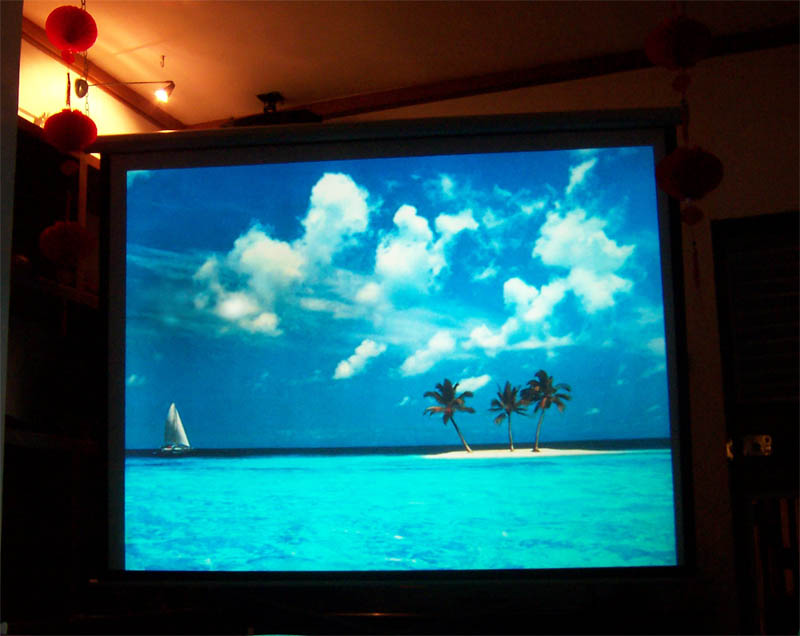

18wheeler ! the screen is 100',

So far, picture with this lamp is brighter than 250W HQI. in the
picture posted above, the sky is almost too bright to stare at. My
eyes hurt when looking at the bright area. I also feel the picture is
sharper and contrast is increased. Comparing to this lamp, HQI seems
to have a 'softener' lens on.
I tested emitted heat by putting my hand in front of the light. It
feels cooler than HQI. Heat glass is no longer a must-have. Also lower
speed fans can be used, so noise can be decreased too.

ywh said:I also feel the picture is sharper and contrast is increased. Comparing to this lamp, HQI seems to have a 'softener' lens on.
It is expected because there is less defused light, which would blur the image.
