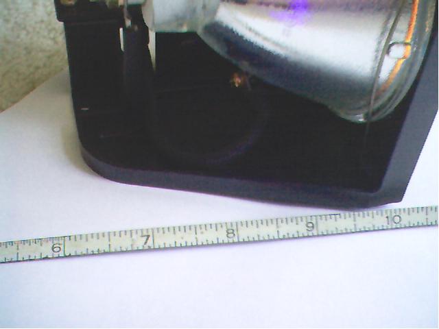

Hi YWH,
i just got a Dream Vision DL500 starlight DLP Projector.
do the manufacturer have a 120W UHP lamp?
i bought this as used condition with only 50 hrs. of lamp usage ( i hope it's true) i still have 1950 hours to figure out how to DIY the UHP lamp 🙂
thanks in advance.

give me a pic: lamp or lamp cup
i have not open the projector yet. also i tried to search the net but no luck in getting the exact image for the lamp.
i plan to DIY the lamp based from the pictures you have attached where the lamp is inserted inside the module/reflector.
was thinking if a 120W UHP replacement lamp is available, then i don't need to worry about the power supply. but if not, then i have to get an replacement lamp with a power supply, maybe a 150W UHP?
I have a 120w UHP projector and a extra lamp I will take Some pictures of the lamp Tomorrow and post them. 🙂

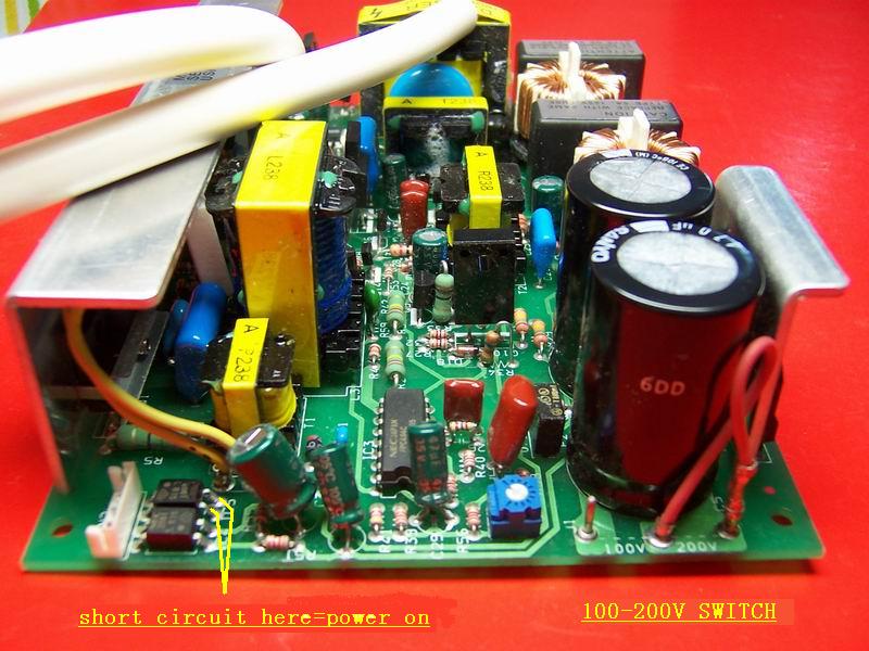

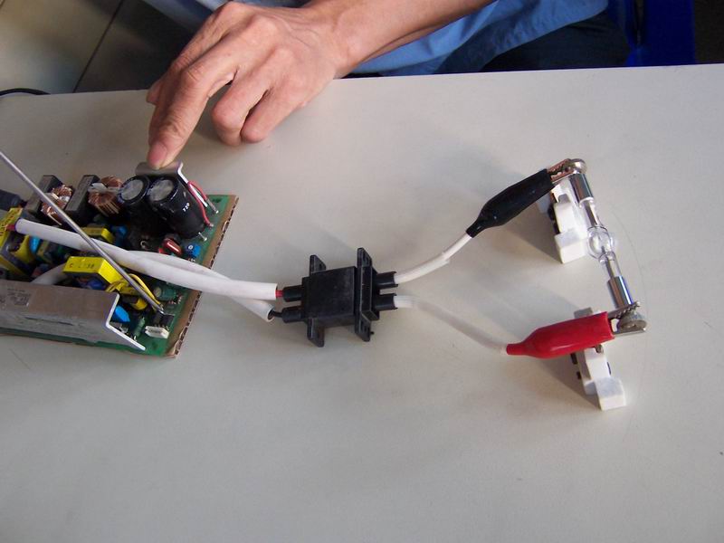

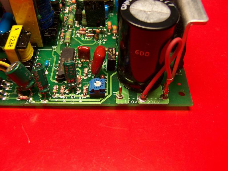

Re: ha ha ha!!!!
What is this new ballast? If it supports 100V can it be ordered in small quanties 1-5??? How much would a bulb and ballast cost?
ywh said:i can get it ,and i can send it for you!a new ballast,it can be used everyplace, everycountry!

Re: Re: ha ha ha!!!!
I can get 120W UHP lamp for you,It can be started in your Dream Vision DL500 starlight DLP Projector.

OK!Video Freak said:I have a 120w UHP projector and a extra lamp I will take Some pictures of the lamp Tomorrow and post them. 🙂
the cost http://home.earthlink.net/~18wheeler/

lamp
to YWH the lamp in the picture the one with the reflector I am shure is the one I need, I am pretty shure is the same also in the Dream Vision
Dream Vision 120 uhp
Mine, Davis 150 uhp also they fit in Mitsubushi VLT 70 and VLT50u and some epson
Please email me if you can get me one
My email is anthp@freeuk.com
