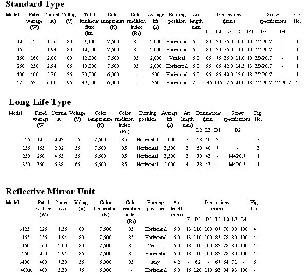

I am interested in in a single end 250W bulb, maybe a 120W too, can you post their confirmed information on here? Arc gap, lumens, etc?

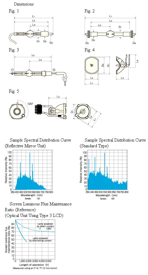

Okay I have finally pinpointed the manufacturer of these ballasts and bulbs and I have some solid information I can share with you all.
I do not know why this information was not shared earlier, this is no small company nor do they refuse to export out of their country (which is not China). This company is here to stay I can tell you that.
Heres some details:
