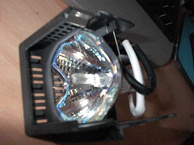

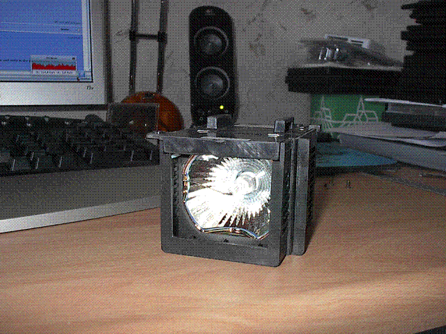

Nothing is writen on the reflector as you can see on the pictures.

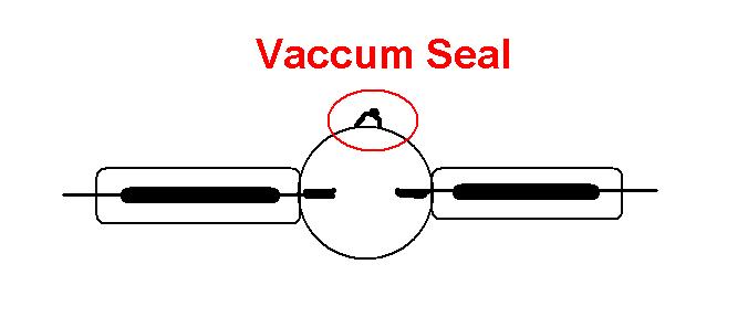

About the vaccum seal, sorry but I don't uderstand your question, and I don't see something like that.
I don't have the spec sheet of the original lamp, :xeye:
The distance between the two electrodes seems to be longer than 2mm and one of them bigger than the other, than means DC lamp....
Hope it helps.

ok a vaccum seal is a very smal nose of glass, they used tu put out the air/ put in the gas and got after that melted to close the lamp
looks like this:
