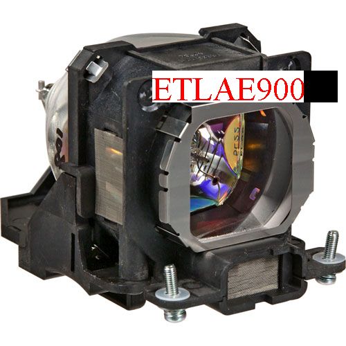

Hi
Thank very much too answer ywh.
yhw wrote:
"we have not inf of the UHM know."
I think that it is exactly getting to know worth as the lamp looks to Panasonic PT-AE900U.
That is why from the this the cheapest and the best pj is on the market.
I as yet have only picture of this lamp
Maybe some owner which is the better picture will disclose?
Panasonic PT-AE900U lamp

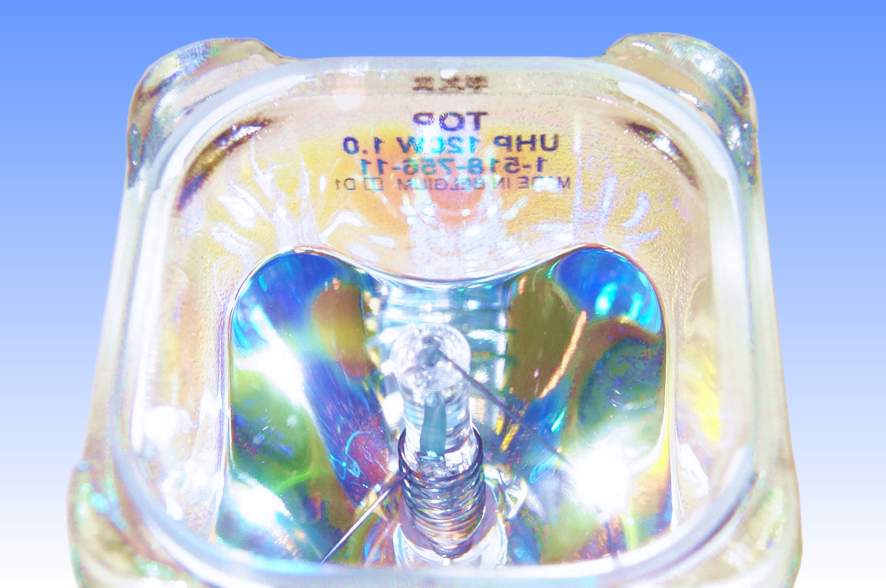

Is this this lamp maybe?
Maybe only bulb?
Manufacturer: Philips Lighting
Max Lamp Power: 120 Watts
Max Lamp Current: 2.0 Amps
Max Lamp Operating Voltage: 65 Volts
Ignition Voltage: 5 KV
Bulb Finish: Hard Dichroic Cold Mirror
Bulb Type: PAR-22 Borosilicate with front glass
Reflector Size: Parabolic 65x70mm
Arc Gap: 1.0 mm
Electrodes: Solid tungsten
Atmosphere: Argon + bromine
Luminous Flux: 6000 lm at 100W
7000 lm at 120W
Hi ! marek301@tlen.p
where are you find this detail of UHM ?
we have some case of unsuccessful in repalce UHM, we don't know why?
if you can give me the PDF file of UHM lamps we can do other type lamps to fit your projector, maybe.
the lamp in your picture is UHP, not UHM.

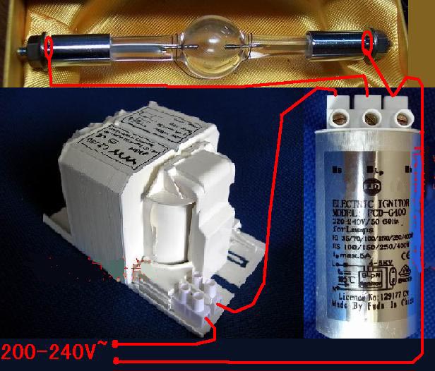

Hi ! victor-eyd
I have this integrated (lamp/ballast) lamp kit that can successfully light a 15" lcd for 220. voltage, but not 110v.
if you can find a ballast can run a Europe standard HQI in U.S.
it can run my lamp too.
the ballast is electromagnetic, not electronical, so they are cheaper.
the ballast is for 400w metal halid lamp or mercury-arc lamp, not sodium lamp.
I thought a ballast was part of the kit? If not, this system seems to be more cumbersome (and possibly just as/if not more expensive) than a LL lamp-setup since I'll have to source a ballast for the lamp and a transformer to use for 110v.
Do you have any recommendations?
Victor
