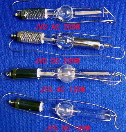

i also wish to see the 4 different lamps on a pic ....
i mean:
JYS DC
JYS AC
JYD DC
JYD AC
thank you for your help!!!!

Hi! SausageRocket
I can order your now, but we need wait 18wheeler
Hi ! Psycho
sorry! I don't konw this word "paff".
and what is " the brigtness sucks"
the white is cold color, and brown or red is hot color.
If its too much white, unable like brown or red.
is The voltage of the jys/dc 94V @ 1.6A ?
maybe you need clear the strainer again,
or the 94V is too high, I can look for others.
Hi ! Psycho
Hello
Hehehe
Thank you Very much.....
Try to say PAFF *** loud as you can,,,,,, hehe
I mean "Paff" was the noise off the exploding lamp.... hehe
I think there is to less withe, because the brightness is very bad ... not much lumen output....
The Brigthness sucks ->>> that means like the lumens are very low..... (suck = bad / **** / not good) (like in a Online game ---> I suck --> im not good..)
ok now the photo gives me several answers.....
i think i need a jyd dc lamp..... shorter Arc -> less Volts = Better colors ^^
i order one to test....
thank you guys!!
