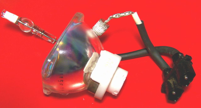

To anyone that has actually replaced the lamp with these new bulbs: How did you align the new lamp inside the reflector and how did you get it to stay while the new cement dried?
So how does one align the arc gap so it sits at the focal point of the reflector?

I moved the lamp until the image of the bulb section completely filled the mirrored section of the reflector; that was an indication that I had hit the focal point. You can actually see that the electrodes have become really large.
As for keeping the lamp at the final position it was pure patience on my part. The muffler mender sets very quickly so I held the reflector and the lamp for about 20 minutes when it had already begun to harden and then used duct tape between the reflector and the end of the lamp.
This method worked out okay for me.

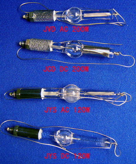

about the Sharp PG-M15X DLP projector, I have not inf of UHL.the UH like ultra-high, but the life is 1000Hr only, that like MHL. can you find some inf of UHL?
but I found the Osram VIP-R 120/12, I think it like your VIP-R 120/20, in this pdf, the lamp is High Pressure Mercury Discharge Lamps, it like jyd/ac.
http://www.hp.com/hpinfo/globalcitizenship/environment/pdf/L1515A_PSDS.pdf
in the you give me web, Sharp PG-M15X need VIP-R 120 too.
If you like, you can send back the jys and your ballast to me so I can choose which lamp is nice.
reflector id OK, but I think it is 65mm x 70mm, all of sharp in your web are 65mm x 70mm.
what do you think?
Hi fill_soft
you need 150w jyd/ac lamp.

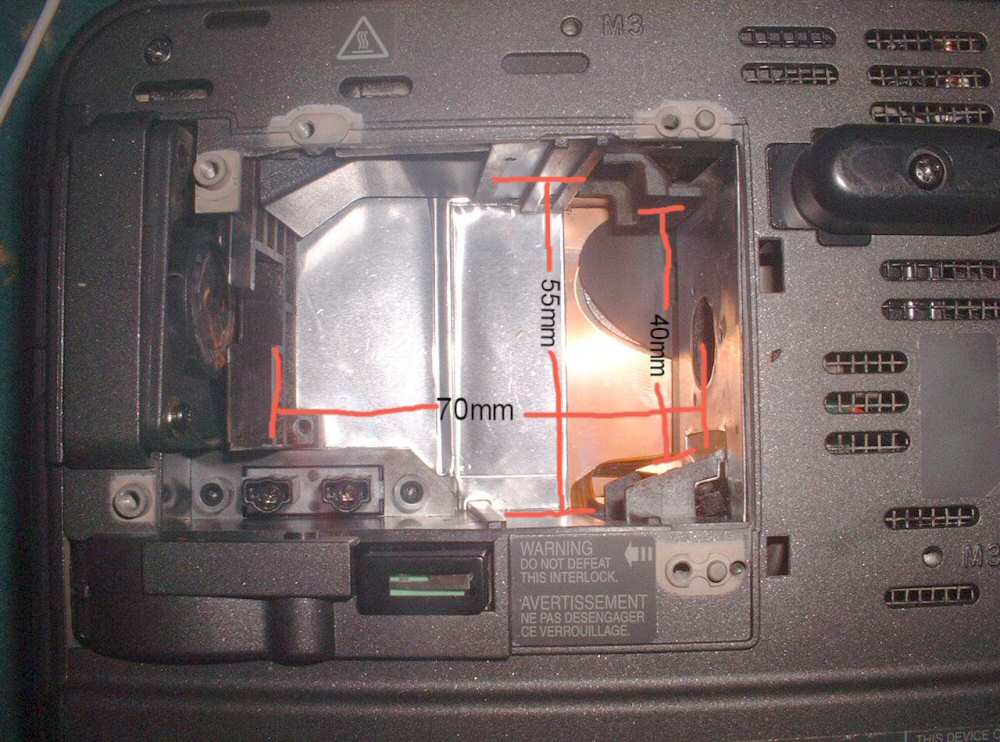

Also, the lamp housing on the sharp is very small. I've attached a photo of the Sharp's lamp housing with some rough measurements on it. You can see that there are two fan vents at the sides of the housing which force air into the front of the original lamp. (the hole to the right-hand side of the housing is where the front of the lamp "points". The colour wheel is directly behind the hole.)
When I finally found a photo of the original lamp the other day, it seems to have one of those box-shaped things on the front of the reflector with a UV filter on the front. The box part obviously must have fit between the two vents in the lamp housing. So, unless I modify the Sharp to move the air vents out of the way, I just need a very small reflector which would fit AFTER the fan vents, but still focus the light well onto the colour wheel?
However, if I used the new JYs lamp in the Proxima, I already have the reflector for it. I'll have to move our LED experiments to the Sharp and try to fit everything in that. Early experiments with the Sharp and the jumbo LEDs showed promise. With only seven jumbo LEDs, it actually produced a watchable picture! (in a darkened room and only a 1-foot wide image). At least the Sharp should be FAR more light-efficient than the Proxima, it's just a shame because I wanted to use the Sharp as my main projector (XGA, HDTV, DVI input etc.)
So, if anyone has any suggestions for what I could use as a reflector for the Sharp, I'd be very grateful.

the Sharp PG-M15X XGA is DLP type. you need accurately install the bulb, and accurately install the reflector , if not , you will burn the color wheel, so that is very hard to do it if you have not the original lamp and lamp holder,
I find this , but I can not sure this picture is true.
http://detail.zol.com.cn/79/78088/param.shtml
this reflector is in my hand, 45mm*45mm
