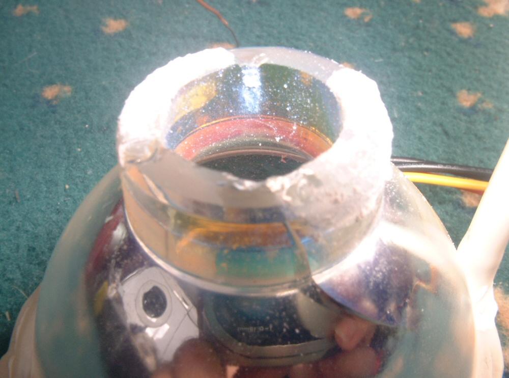

I just managed to remove the bulb from it's reflector on the Proxima DS1.... It wasn't quite as difficult as I thought it would be, you just need to scrape away the majority of the cement, then try pulling the bulb out. If it doesn't move very easily, then you need to scrape more cement away.
I wasn't quite careful enough with my reflector, and used a screwdriver to prise off the lamp holder. I cracked the reflector very slightly, but the crack is only on the outside luckily.
The strange thing is, the crack happened just AFTER I'd removed the bulb! It appeared to be fine, then a split second later, I heard a 'ping', and the reflector was then cracked slightly? It must have been thermal stress from when the lamp was working, and the bulb holder was keeping the original crack from growing.
I'll post a pic of the actual lamp in the next post. I doubt the lamp works (ballast is broken), but I should be getting a new lamp and ballast from the very kind ywh soon.
Here's a photo of the back of the reflector, you can just see the small crack to the bottom left of the picture......

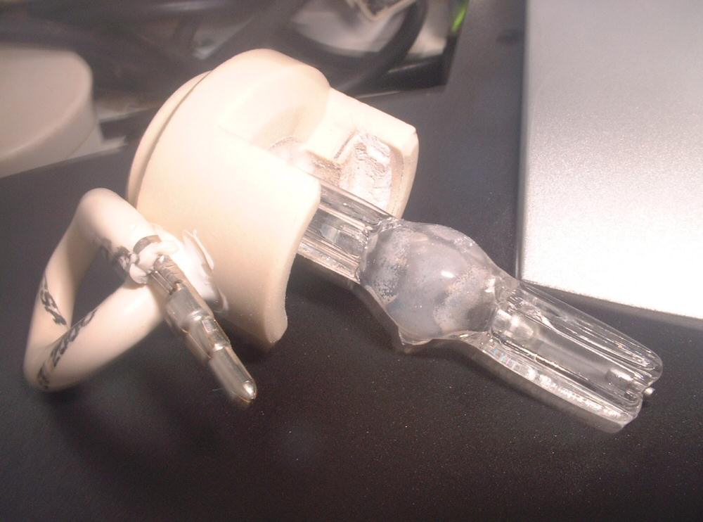

Below is a photo of the bulb itself. You can hardly see the electrodes on this bulb. I think it's safe to say this one's broken, or wouldn't have lasted very long (if I could have tested it).
The bulb is the Osram VIP 273/46 and is still in it's ceramic holder...

dont bother the crack, we have used these crack reflector . it is nice too.
think you for your pic, I can see the bulb, there is a vacuum seal on the bulb.this is a mark of MHL,so I know VIP is MHL.
