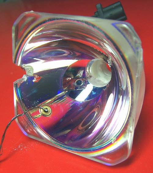

Thanks for your quick replies and useful information! I have tried a lamp and reflector from a Sanyo projector in the Sharp, but it's still too big to fit properly. But, even without the lamp fitting correctly, the image was very bright.
I'm not sure what a UHL lamp is exactly, but the Sharp ballast works fine with those VIP R 120/20 and 120/24 lamps?
I'm not too worried about the alignment of the lamp as long as I can find a reflector to fit the housing. What is the reason for the incorrect alignment burning the colour wheel? Is it because the focus of the beam has to make a certain size of spot on the colour wheel?
I've been thinking of a few ways to possible aligning these lamps. Do you think it might be possible to get a fairly good alignment by running the lamp from a small backlight inverter? This would only be a very low current, and would only create a small spark between the arc gap, but it might give just enough light to do some sort of alignment?
Is that reflector you've got a spare one? If so, how much do you want for it? I don't mind that it's got a broken part, as I'm sure it would still collect plenty of light! What is the length of the reflector? If it's not much longer than 55mm, then it should be perfect!
Also, is the 4:3 rectangle thing very important? I would be willing to take the risk on any reflector at the moment, as I can't find anything else that might fit. Why is that reflector not 4:3? Do you just mean that part of the beam will be lost because of the broken part?
Hopefully the JYs lamp isn't too badly damaged as I only ran it on the wrong ballast for a few seconds. Most of the metallic coating has disappeared now, and the lamps are SO much cheaper (thanks to you! 😀 ), that I'm not too worried about the lamp life!
So, this PMA161X and the JYs lamp is more like a metal halide system? Many of the newer projectors seem to use a JYd type lamp w(ith a much shorter arc gap), is this generally correct?

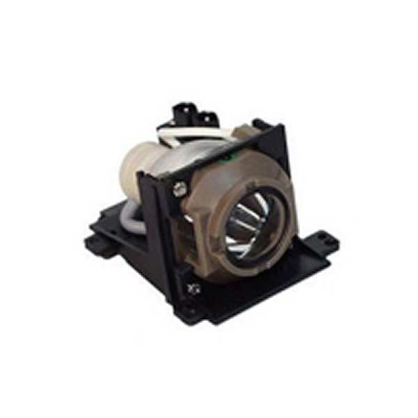

Hi ! OzOnE_2k3
is this pic your sharp need?
http://shopping.msn.com/specs/shp/?itemId=91778633
or
or

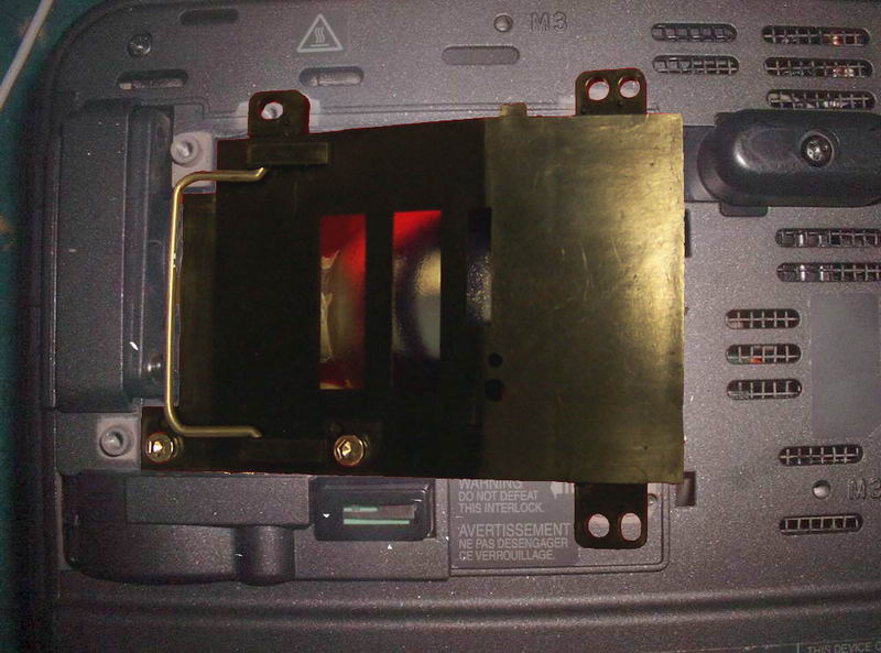

Hi ywh,
None of the pictures of the lamps on the Internet I can find look like they would fit in the Sharp? (they look like either the first or second lamp in your last post)....
Those lamps wouldn't fit in the Sharp because there's nowhere on the lamp housing where that plastic tab on the front of the lamp would screw into?
But, I realized I bought the service manual for the Sharp a while back, and I managed to find a picture of the proper lamp which matches the picture in the service manual.
I've attached a picture of the correct lamp for the Sharp PG-M15X DLP projector. This lamp must be the correct one, because 1. It's the right shape, 2. The bulb connector is in the right place, and 3. It matches the picture of the lamp in the Sharp's service manual.
You can see how the small filter section on the front of the lamp would fit between the two small air vents at each side of the Sharp's lamp housing.
I don't know the exact measurements of the lamp / reflector, but anything that's small enough to fit would be fine. I should be able to figure out how to hold everything in place if the reflector isn't an original one.

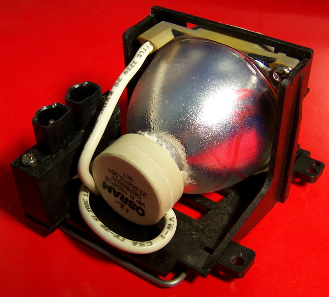

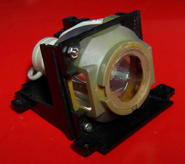

Hi ywh!
Fantastic news! How much do you want for the lamp?
Is this a new lamp, or is the bulb at it end of life?
OzOnE.
Edit: Oh, also, I noticed this lamp is a VIP R 150 / 16 (150W?) Does this mean that it will run near to it's full brightness on the Sharp, as the Sharp ballast is supposed to be only 120W?
OzOnE.
Hi OzOnE!
The lamp is cheaper for you, $40! include the shipping😉
The bulb is not end of life, but the boss said it has been protect, can not work with some projector.
The bulb has not broken or burned, you can do some test, but I think that you change your VIP R 120 is the best way.
yes! lamp is a VIP R 150 / 16 (150W) , the reflector is the same as other VIP R 120, the holder is same too. but the VIP R 120 is work well, it's price is $130,
so I got this cheaper reflector and holder for you.
If the VIP R 150 / 16 (150W) can run in your Sharp ballast, it is only 120W.but longer life😀
