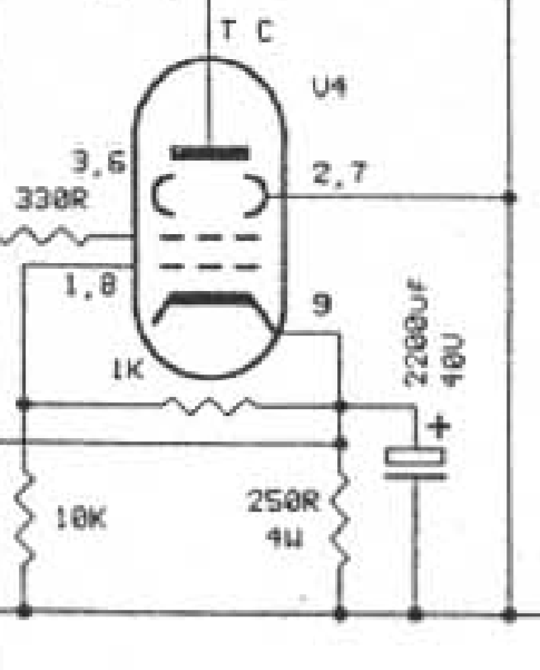

How would you drive an EL509 in enhanced triode mode.
Anyone know what the purpose is of the 10k resistor to ground...in Tim's design?

I believe you if you say it. I pretty much suck at theory. So I just look at what others do and listen to the result. (Wish I did have a decent electronics background and measurement equipment)
So instead of trying to educate an old lazy dog. Just tell me what you would do. And forget the enhanced triode question. I just thought it was the cat's pyjamas because Tim designed it.
G1 is directly connected to cathode for signal, but is given some negative DC bias. Some valves like some bias on G3, etc. Tweeks. It's a small variation quite possibly introduced to avoid a (bogus) patent fight. They're all the rage in America.

It all depends on the driver that you are going to implement. If the driver can deliver some current (DC current to the grid so no coupling cap). then you have all options open.
If you decide to use a coupling capacitor on the grid of the power tube you have only 1 option: G1 (the standard).
As you can see in any G2 drivers that these are low impedant drivers (followers of some kind).
In this case you would need a combination tube (in case it is a 2 tube design) like a ECL82/85 etc. or a Mosfet
If you do not like a negative DC driver then you just "lift" the output tube (Tim and Synola etc.). You then need a slightly higher B+ voltage. Or you can choose to have a negative voltage on the driver tube and ground the cathode of the power tube. In this case you need a c between the gain stage (input stage) and the driver stage. This grid of the driver stage will then be you bias regulator as wel as it is DC coupled to the grid of the power tube.
Remember that a tube does not care what ground is or B+ etc. only we do...
As long as the tube gets the voltages between the grid C and A and it can draw enough current it will be fine.. So putting a tube on a high voltage (or even minus) is fine as long as all the other voltages are adjusted accordingly.
Chris
This can be all true but then we do not have a triode in any of these cases, as the grids ARE meddling with the electrode flow within the tube. Only if ALL of the non "drive grids" are "neutralized" (no different potentials) they will not.
David's patent is valid as he states that because of cathode heating the G1 will heat up (more then other grids within a tube) as it is so close to the heat source causing secondary emissions (current can then draw from the grid) causing tube runaway (instability). Therefore using G2 instead of G1 and neutralizing G1 will prolong tube life plus is even more linear and the tubes run cooler. So this idea is interesting) funny that on diyaudio not much is discussed about this as it already an old patent.
