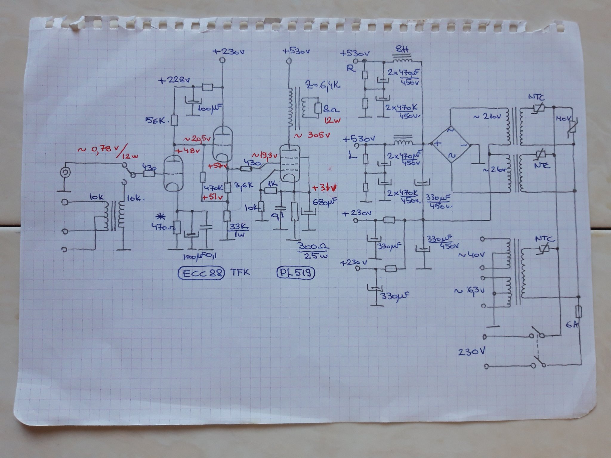

How would you drive an EL509 in enhanced triode mode.
This is the wiring diagram
