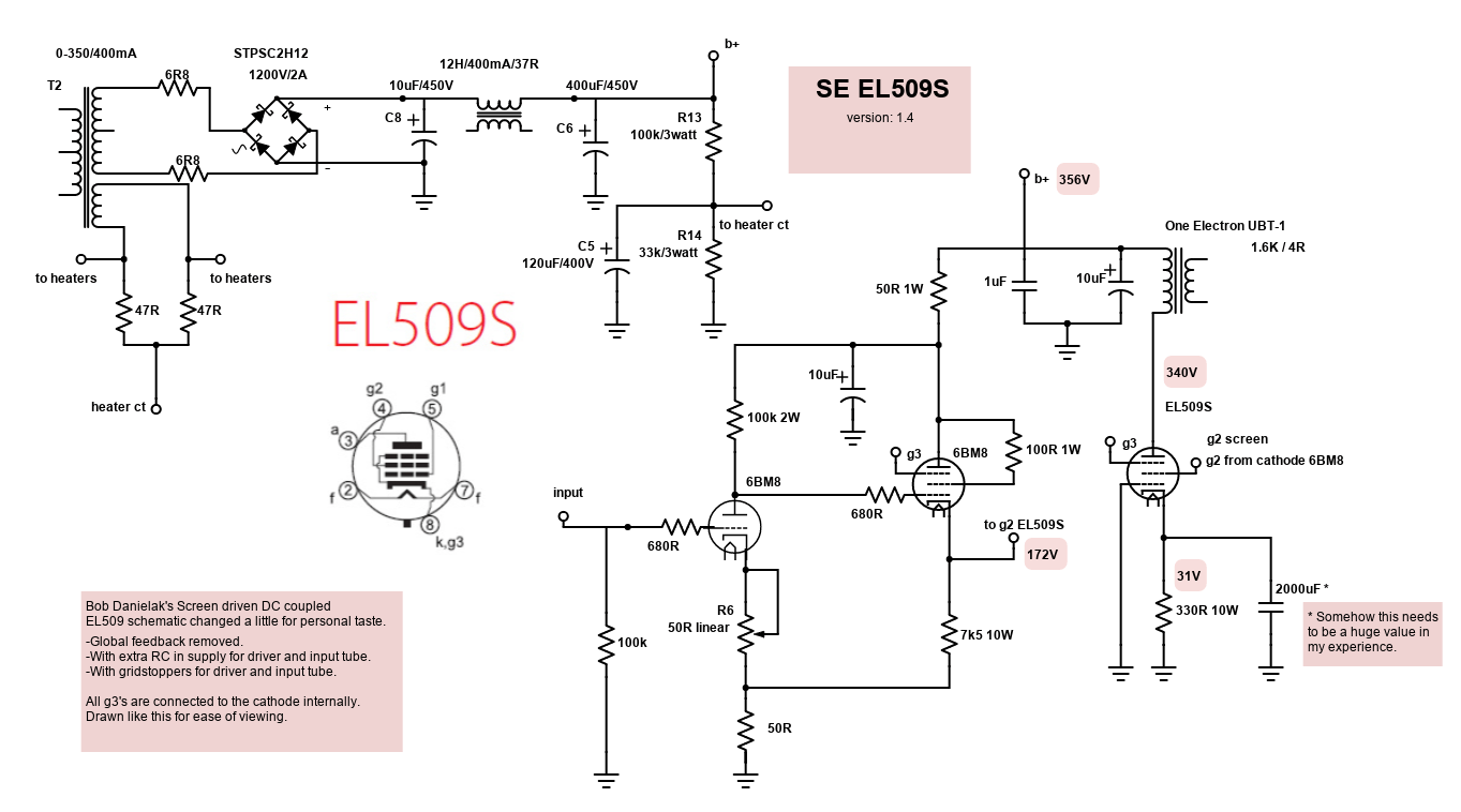

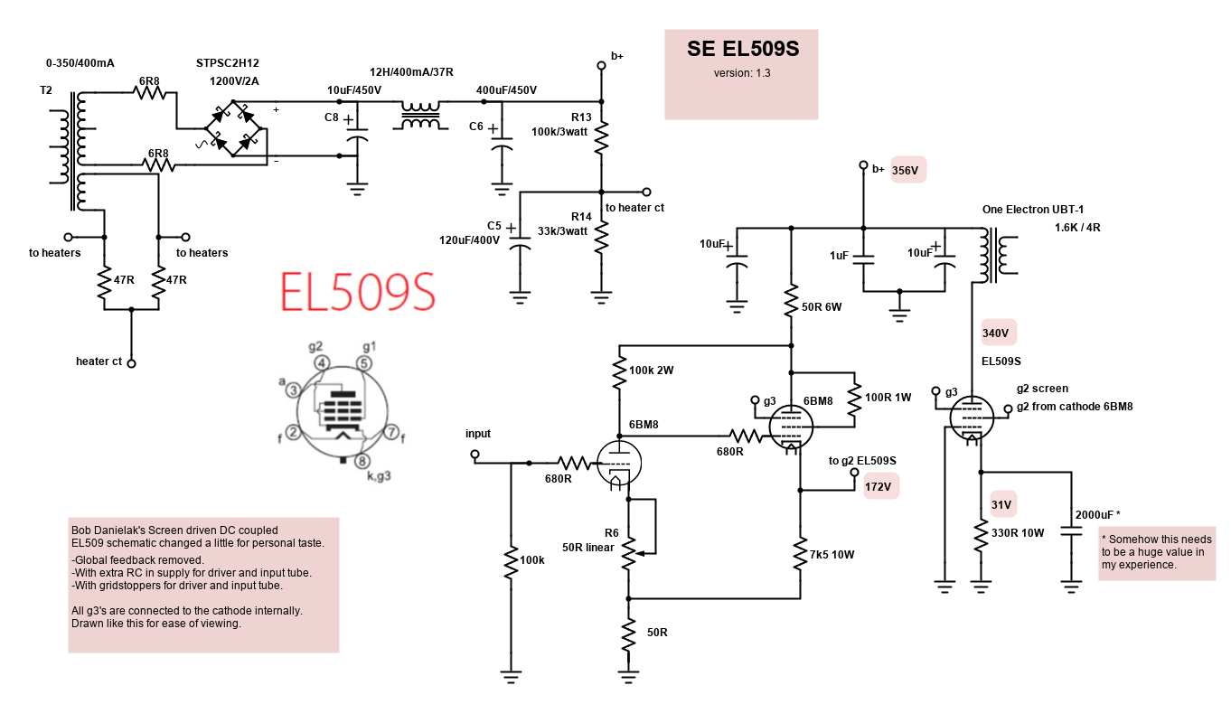

Two things. Since I have an active subwoofer to augment the open baffles and they are supplied by the preamp. When you add a bypass cap the gain of the amplifier goes up....and the subwoofer is lagging way behind because the amp is so much louder...leaving one essentially with squaking midrange...I did compensate a little more vigourously this time as I realised it while thinking about the problem last night. And it just sounds great now! A little less tubey....(which is something aparently that I like) but more even handed for sure. I'll have to do some more listening...and will try the feedback again. I also feel that the 2000uF cap contributed somehow to the warmer sound (even without my subwoofer issue).
So in the end reason and logic wins. Now I'll get a single cap instead of my three paralled jobbies of sufficient value and rating. So Kay happy. Bas happy.

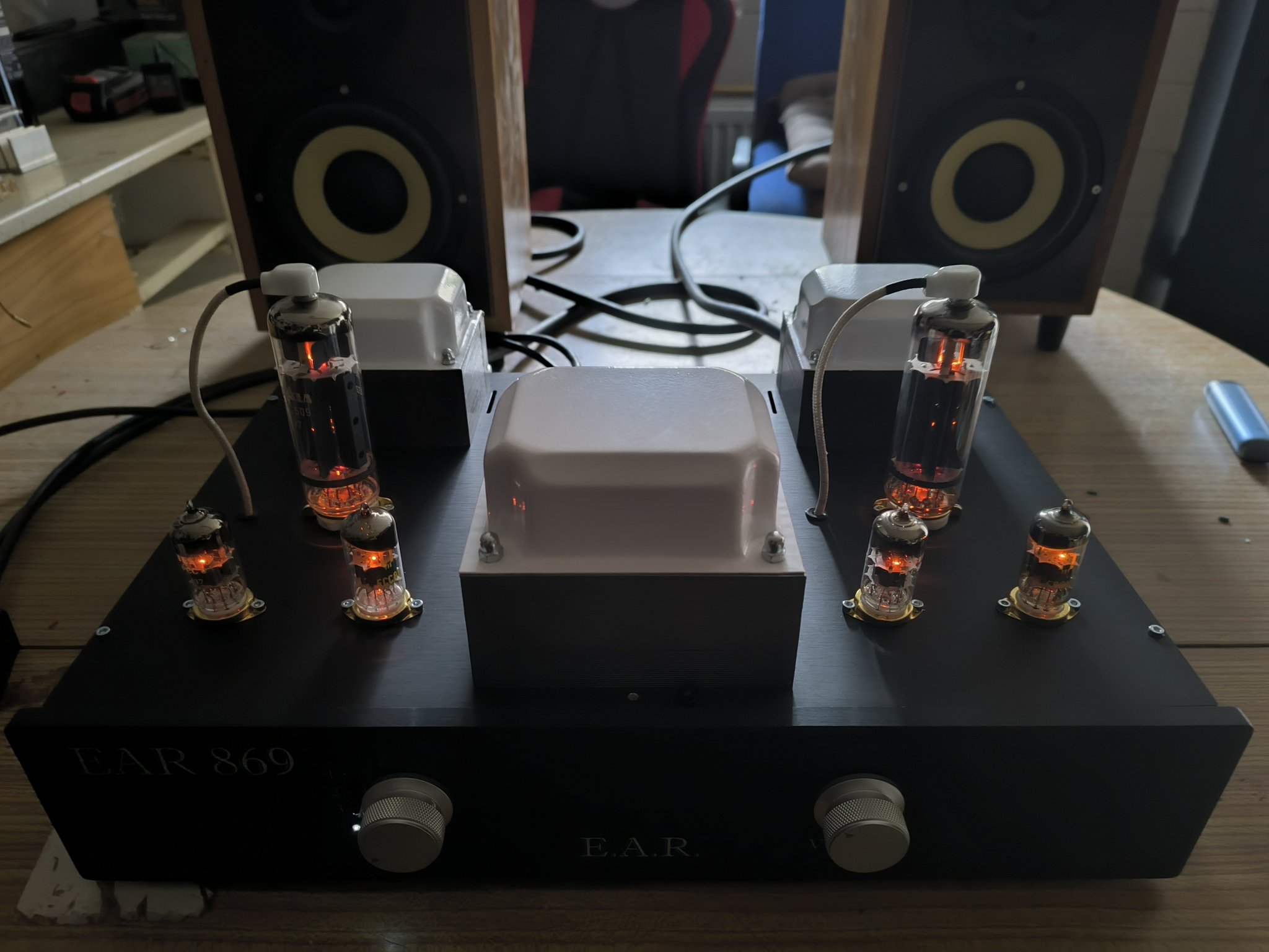

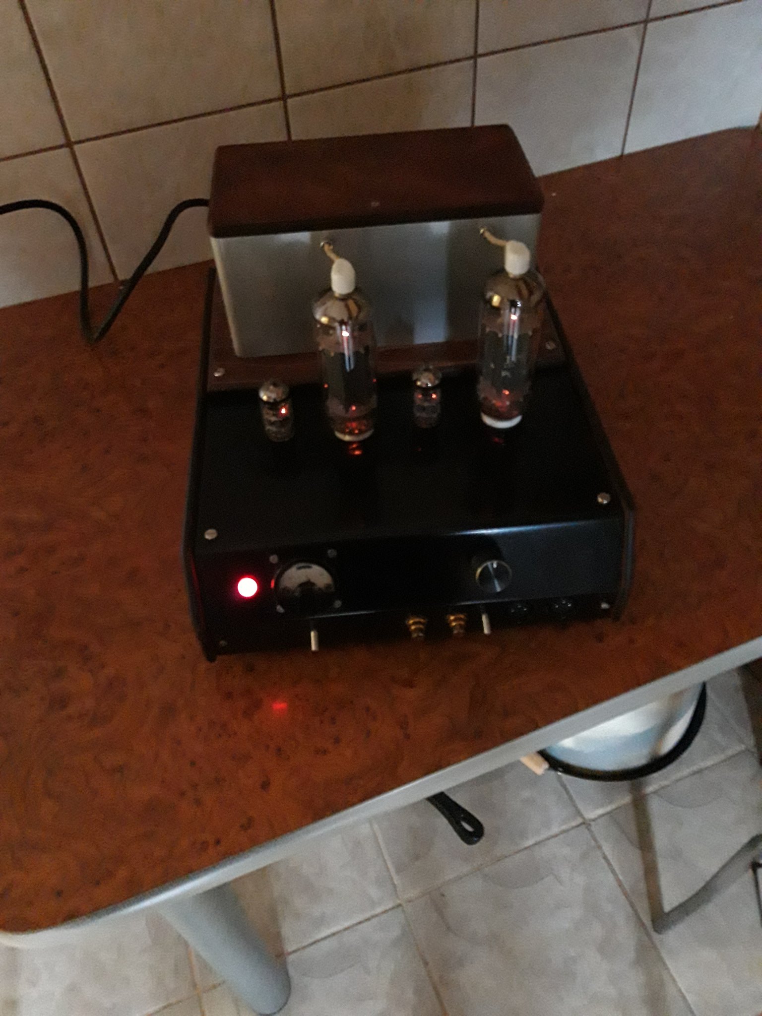

Here is my EAR 859. Sound fantastic.

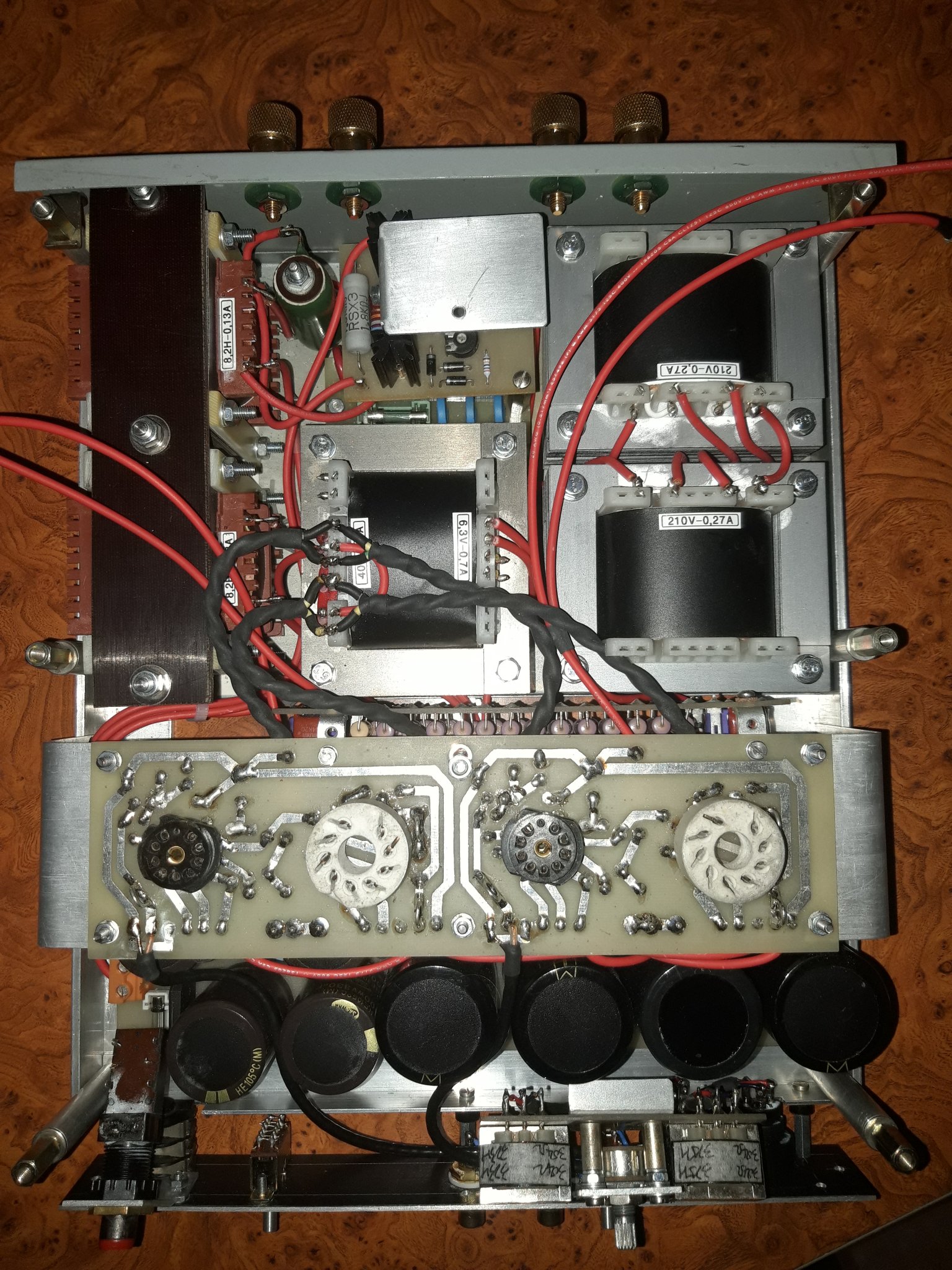

@platon.rado, that is a great-looking build of an EAR 859! Congratulations! How about a picture of the underbelly of the beast?
