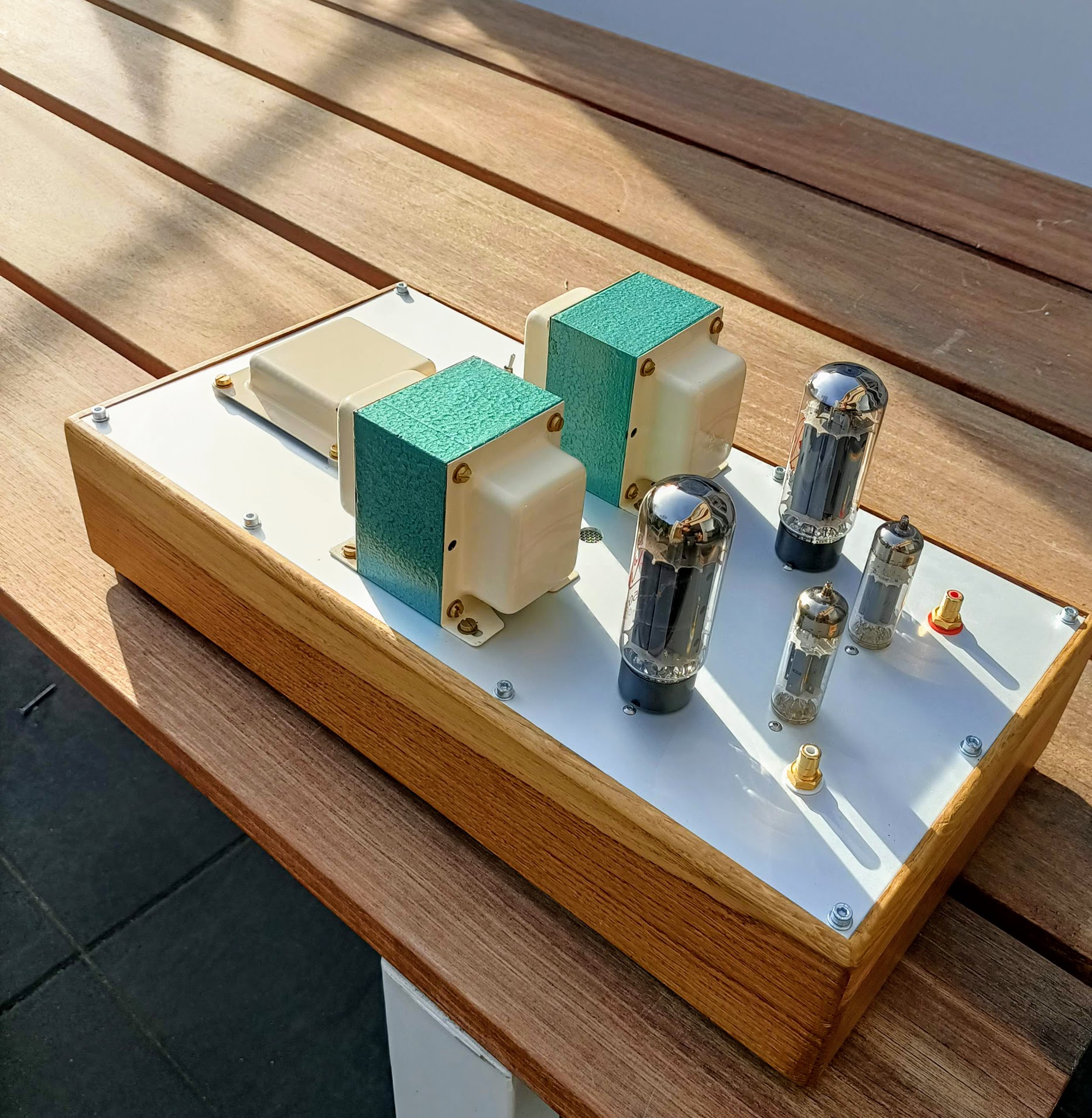

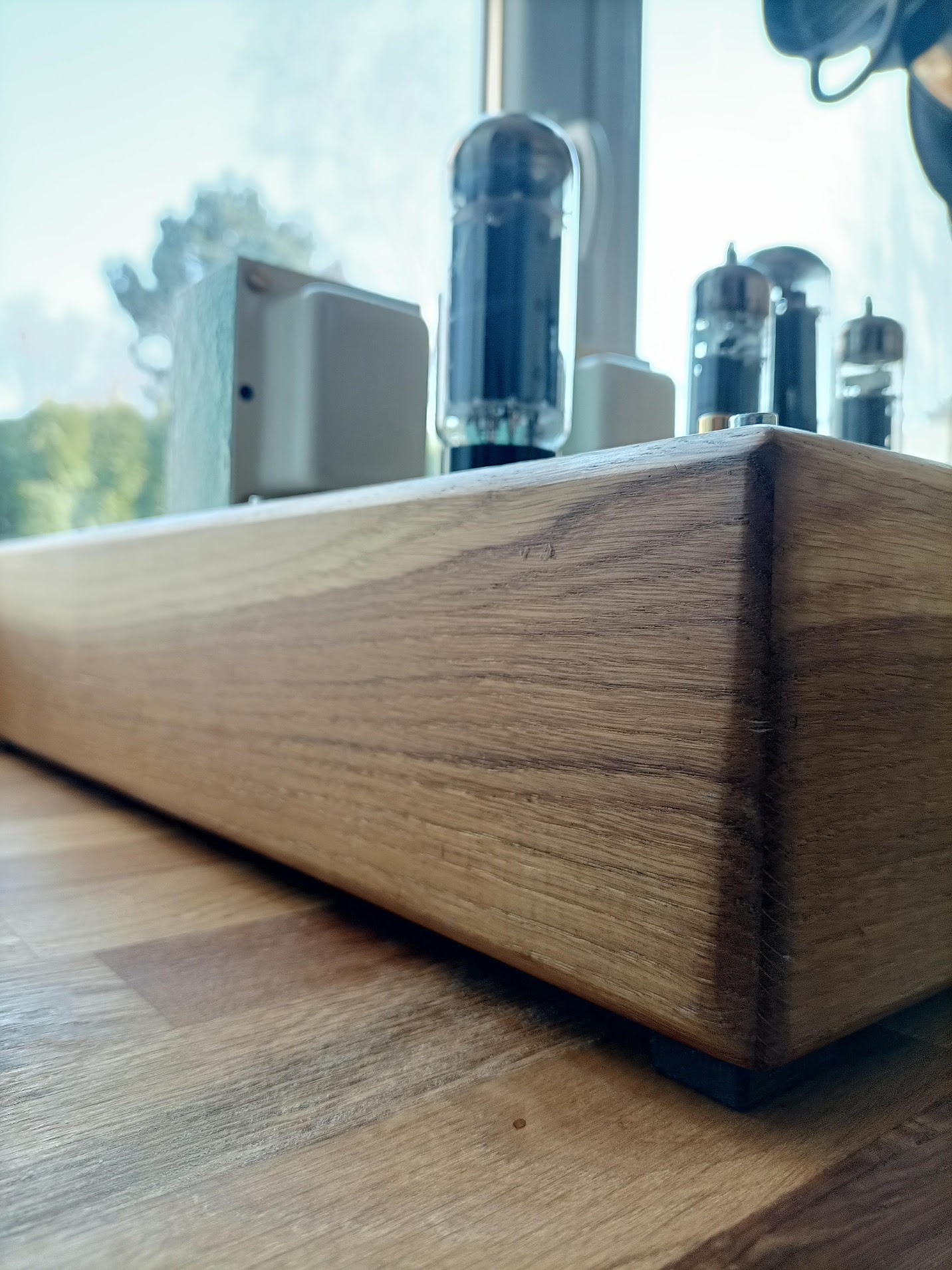

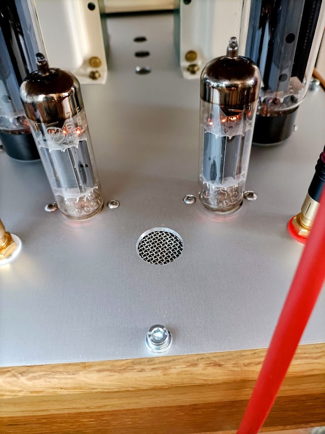

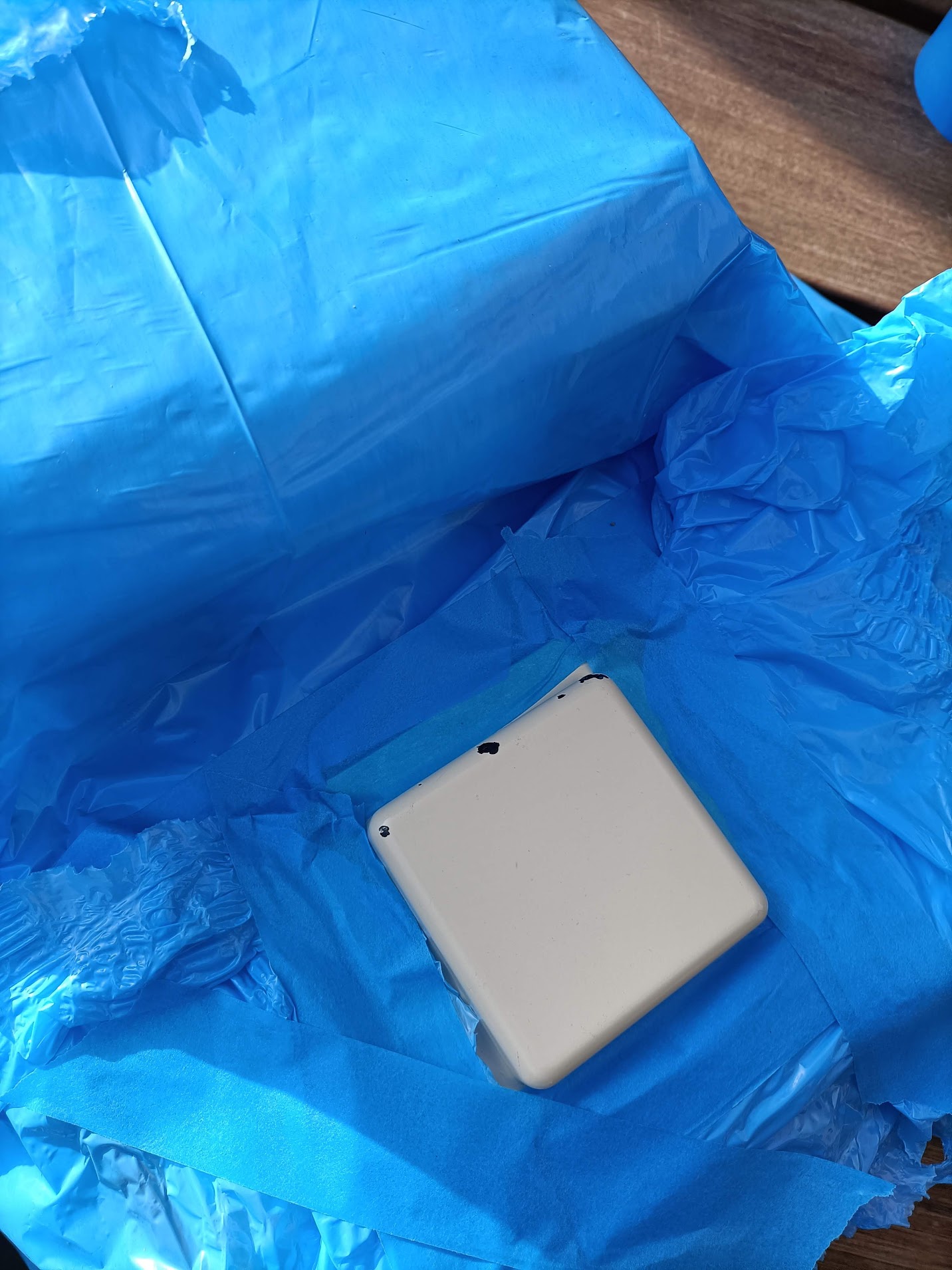

As you can see from some pics something fell on my amp. Chipping of the pain. Emergency surgery busy as we speak. Output transformers also had a touch up...but must be improved...

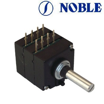

Thank you again Bas, I'm indeed used to 50k log pots at the inlet of my amps and I would say I'm quite happy with them.
Just wanted to know if this could be possible upgrade, but at the moment I'll keep the old solution.

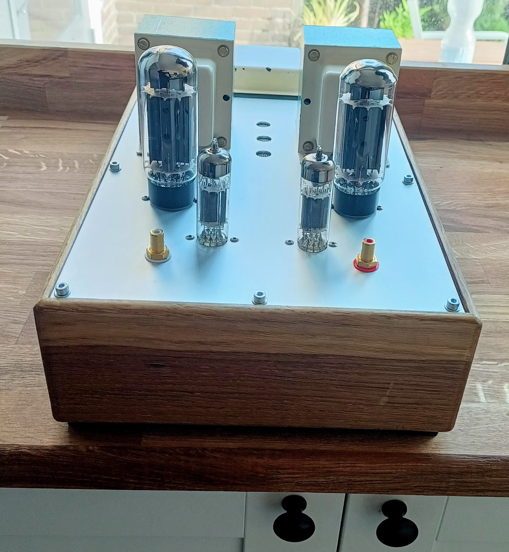

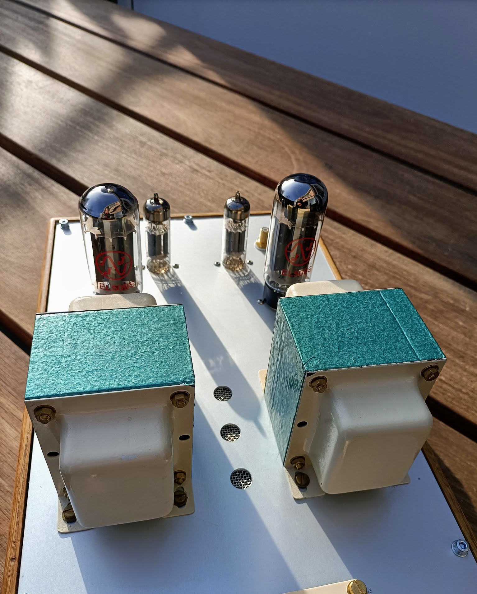

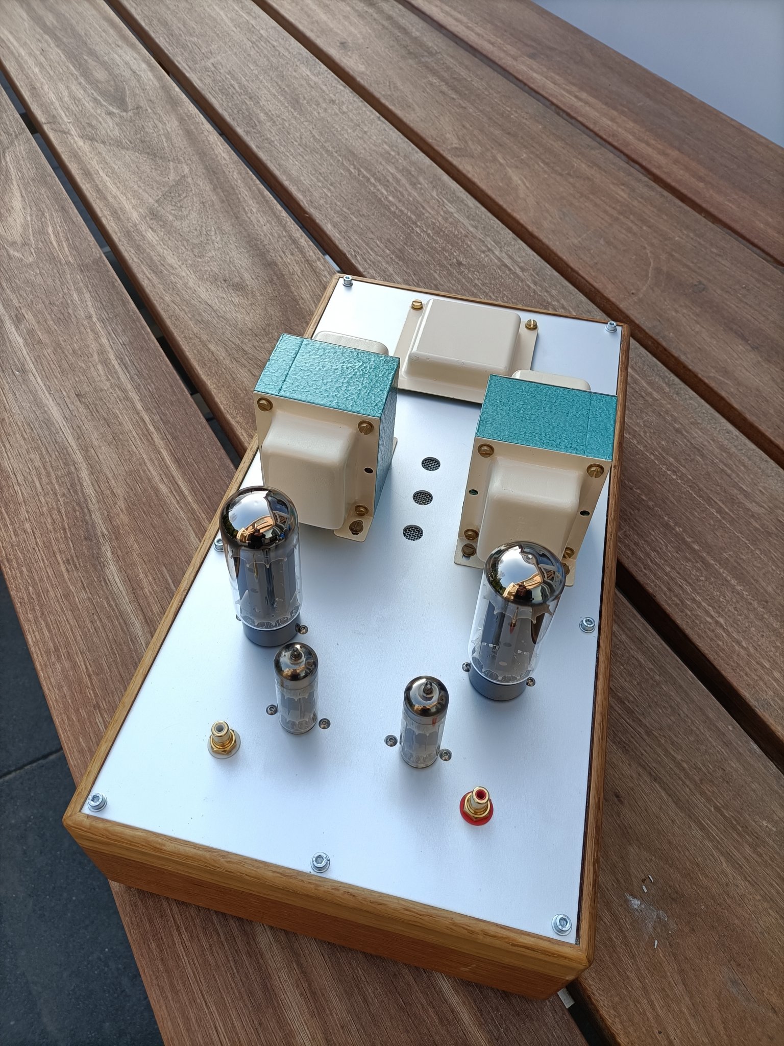

I can already tell you Francois it's a keeper. Definitely worth building. I have been playing with a single ended el84 the past couple of years. And whilst I loved it. I kept wondering what a bigger tube could do...in terms of handling the 12 inch drivers...though efficient. I got my answer. I know it sounds basic...because a watt is a watt. But it has way more bass and sounds more in control.
Apart from the PSU it is exactly the same as Bob's schematic.
Regarding watts: Which output power do you achieve?
I'm quite convinced that Bob based his 11 to 12 watts claim exclusively on his 6P45S simulation model, not on real performance. As written in another tread, I had to severely modify his design in order to increase output voltage swing before the screen grid takes over the cathode current's biggest part. I used a brand new PL519 of European provenance during my measurements and had not more than a mere 8 watts before clipping. This made me think that there are many ways to achieve such output power more conveniently and more economically (think of 12 watts heater power and 35 watts DC plate input power with the PL519).
With this aspect the design was a big disappointment for me, despite of it's admittedly very good sound.

I have no idea what output power it has. But then again it was not one of the reasons I built it. I was just looking for something more than an EL84 could provide. I believe you when you say it comes nowhere near 11-12Watts.

Hi Bas,The 7k5 resistors in the tail of the 6bm8 generate a lot of heat. I thought this might help. But the radiated heat makes the aluminium top plate quite hot. Perhaps a blower/fan...
I have searched through the topic but did not find the schematics that you have used to build the amplifier. I am assuming that the 7k5 resistor is connected between the G2 on the EL509 and Ground? The Synola had a connection like this but I found that it is not required as G2 already provides a path to ground.
If I am right you could just remove the resistor. Would love to hear what your findings are 🙂
