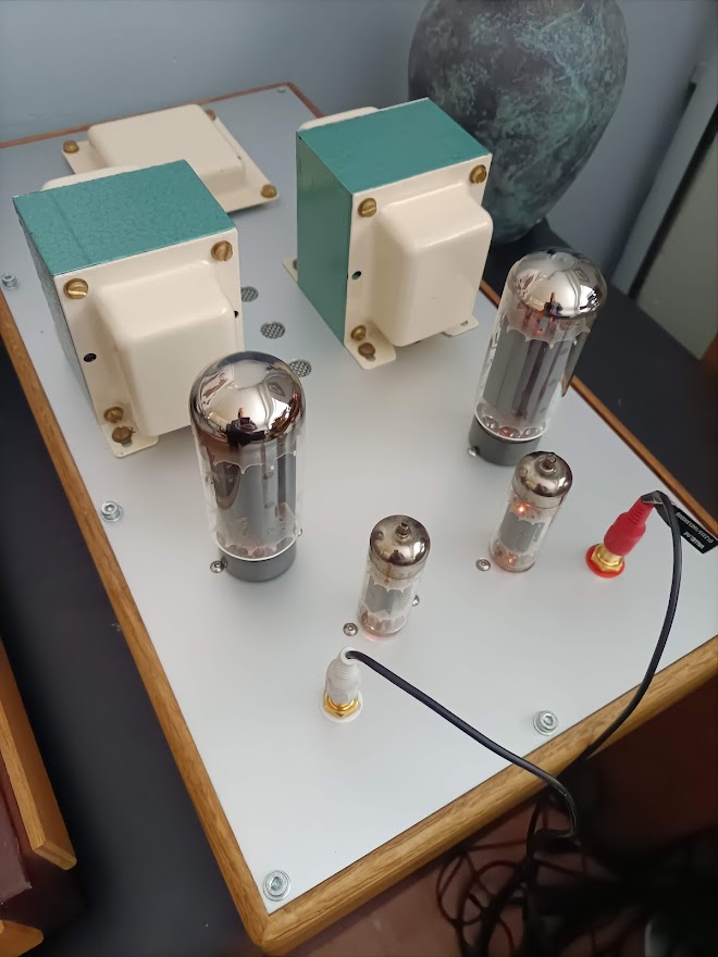

I was looking at Bob Danielak's amp, screen driven output tube, with cathode bias and G1 to gnd.
He drives that screen directly from a cathode follower, no resistor involved. I have seen another example with several 100 ohms series R between cathode follower and screen, and complaints of high distortion.
BTW What is the sensitivity of screen drive, is it higher or lower than grid drive?
Jan
Jan
Bob Danielak is actually using a standard grid modulator (as can be see in RF transmitters).
This will even need more current as G2 is on a higher voltage and therefore attracts electrons.
In triode or enhanced mode it also needs a higher voltage swing but is more linear as the voltage on G2 is much lower (near 0 V). Because of the higher voltage swing you will need a better buffer/driver...
No resitors on G2 as you like curent to flow if needed....

What is the purpose of the 50ohm pot? There is no mention of it by Bob. Probably to do with the dc coupling. But I don't see how 50ohm will make a difference.
Hi Bas,
just to complement. changing the pot changes the current through the driver tube. This changes the voltage drop over the plate resistor and therefore at the drivers plate. This changes the voltage at the CF's grid, consequently at it's cathode, and so the voltage at the G2 of the output tube.
Good luck with the build!
erik
erik
BUT: This potentiometer also impacts closed loop gain. I didn't want this, so I went another way in my build.
