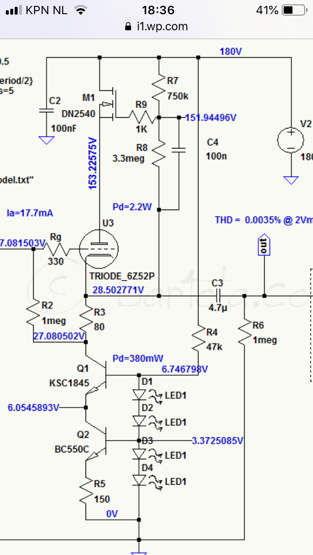

How would you drive an EL509 in enhanced triode mode.
Something like this:
Aikido is great in a preamp, but in a power amp the noise is not your main concern. Here you need current. A mu follower with a pentode as follower can give you the current you need if you choose the appropriate tubes. Using a cathode follower is ok but then also use pentodes or 2 triodes in parallel. The problem with triodes is that they deliver less current with lower voltages (dynamics). Pentodes can still deliver even when the voltage drops, that’s why they do a better job as followers then triodes.
Imagine... the voltage on the grid of the follower goes up, so does the cathode (hence follower) but the power supply voltage doesn’t, so less voltage for the follower and therefore less current! But the screen grid voltage of the output tube also increases and more current will flow (but it’s not available) and here you have it....

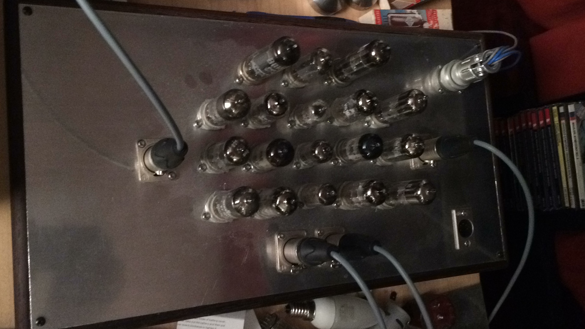

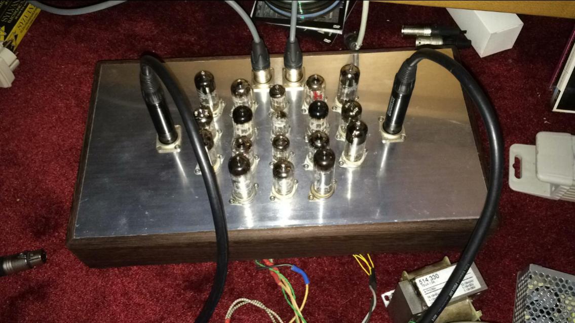

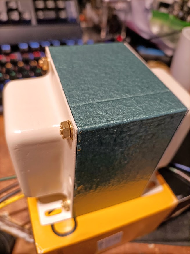

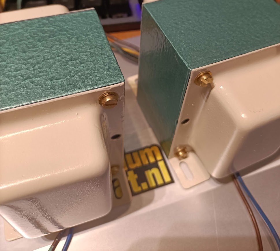

I have build amps using 18 tubes because i could improve linearity and it cost me nothing at all.
Reactions: decramer

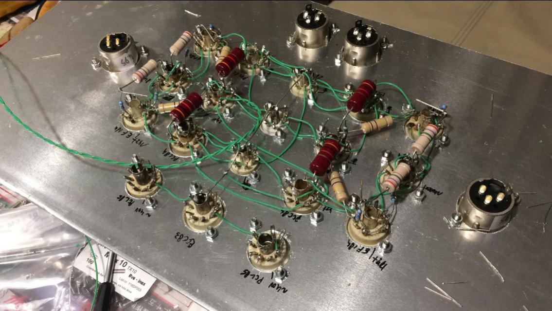

Hi Bas,
Any further development in your effort to build the UBT-1 “enhanced mode” EL509 amp?

Bas, looking real good! But do you know what you are building yet? 😀
You mentioned B+ adequate to put 270 Vdc between cathode and plates, and UBT-1 with 1.6k primary. What are the other operating point and drive parameters?
I’m eagerly waiting for your to show the way 😉
