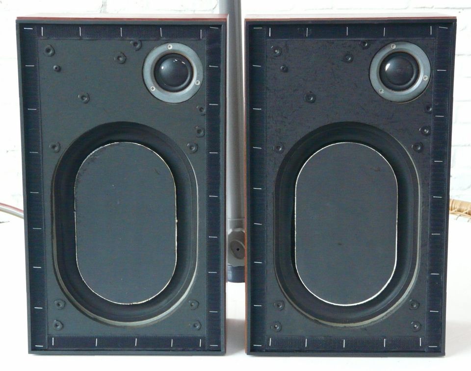

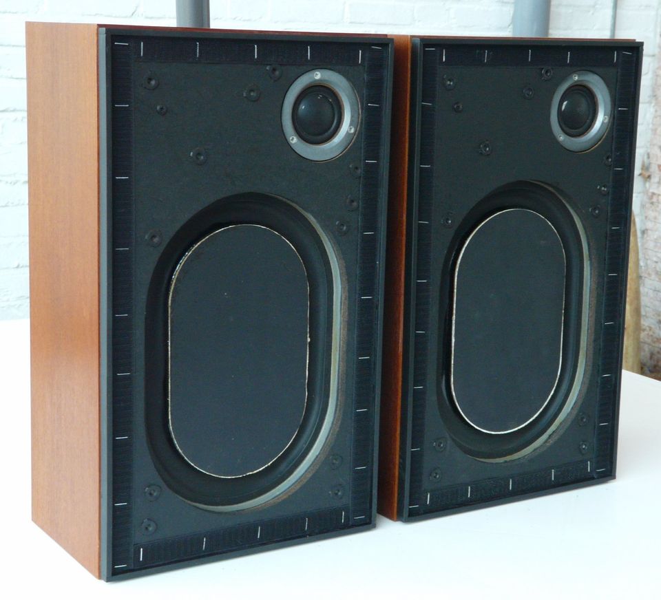

Reminiscence to KEF sandwich loudspeaker Celeste:
aluminium foil - polystyrol - aluminium foil
with B139 in 1962

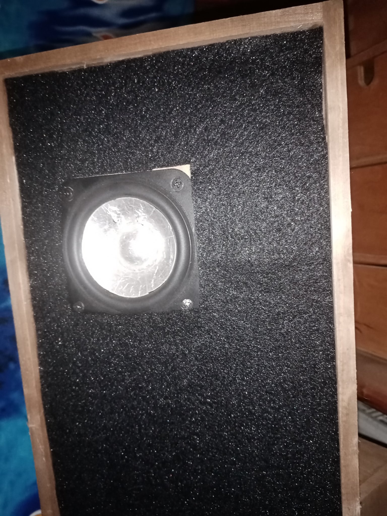

In my eyes thinner household aluminium foil on paper cones works better for fullrange drivers.
Paper adds damping - giving a less stiff but better damped core. And mellow aluminium is less prone to resonances.
I would be lucky if my alu paper alu sandwich gives 20x more stiffness.
I can tell from a listening test that a one sided covered with aluminium foil fullrange paper cone sounded better to me than the Mini Leak sandwich loudspeakers I own. But this was a subjective test.

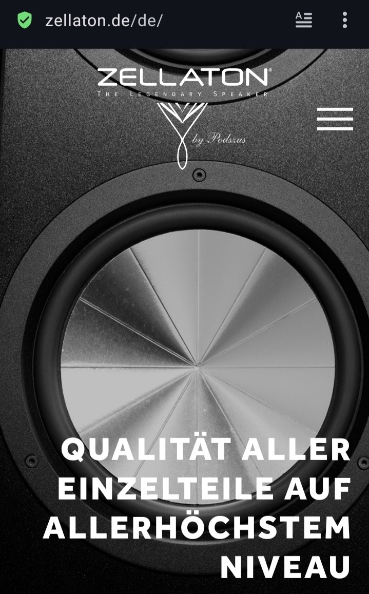

Zellaton Germany making aluminium foiled sandwich cones
I like the space age look of aluminium

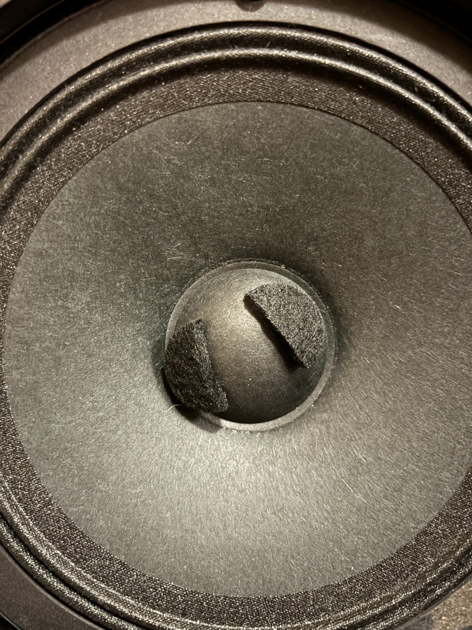

By felts I mean the ‘dots’ you can have for almost free in 100 pack meant to protect shelf’s and floor. Put under furniture. The weight of them is next to nothing. Generally they can be removed without any tear (Satori paper driver is exception. I found it ripped a bit).
To have it stick a bit less, you could place them on different material before you put them on driver.

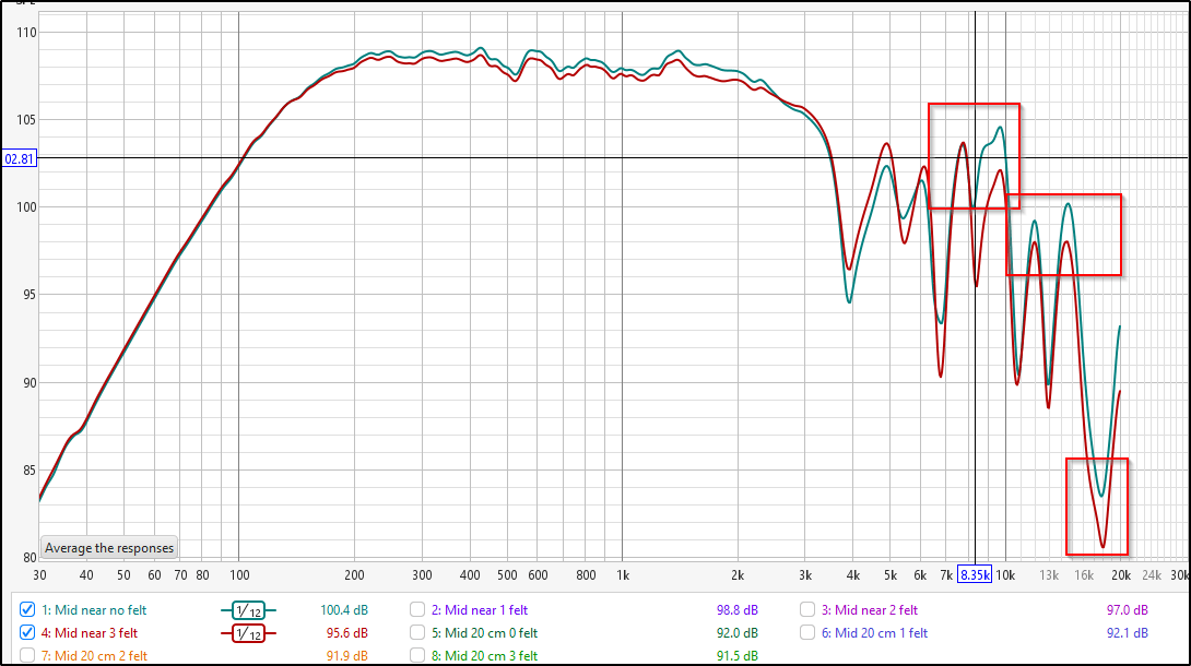

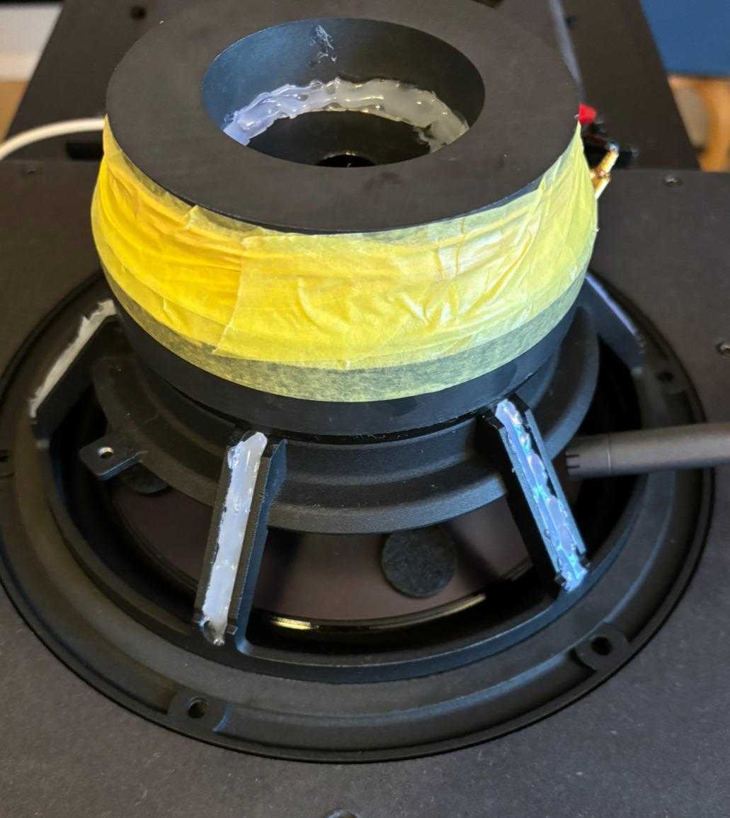

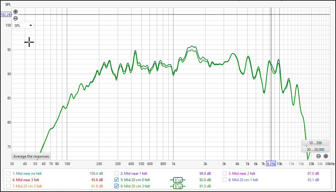

Here is some testing with 5” midrange. Definitely remove some of the peak above 5 KHz. My guess is then applying glue + alu would improve it much more.
Next is Dayton RS225 Alu. I installed 4 felt dots on the backside. It definitely removed some ringing. Not night and day, but enough I installed felt on all 4 drivers. In 1-2 year they may fall off. Then I could apply fresh glue to the felt, and it would stick till they drivers give up.
Also added bucking magnet with double sided tape and then enough painters tape to adhere further and remove some of the sharp edges. And some hot glue because gut feeling told so (properly too hard to add any damping)

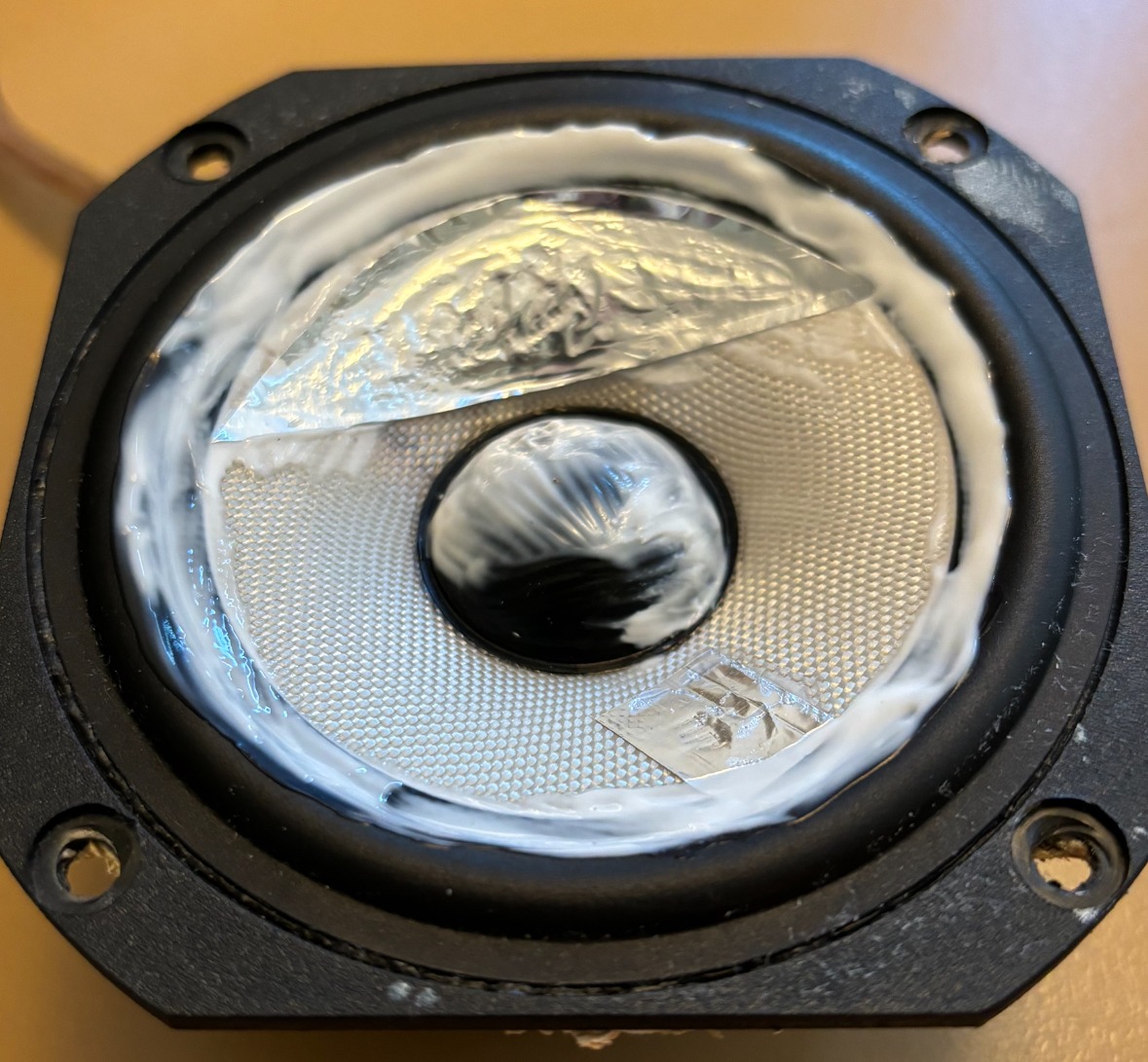

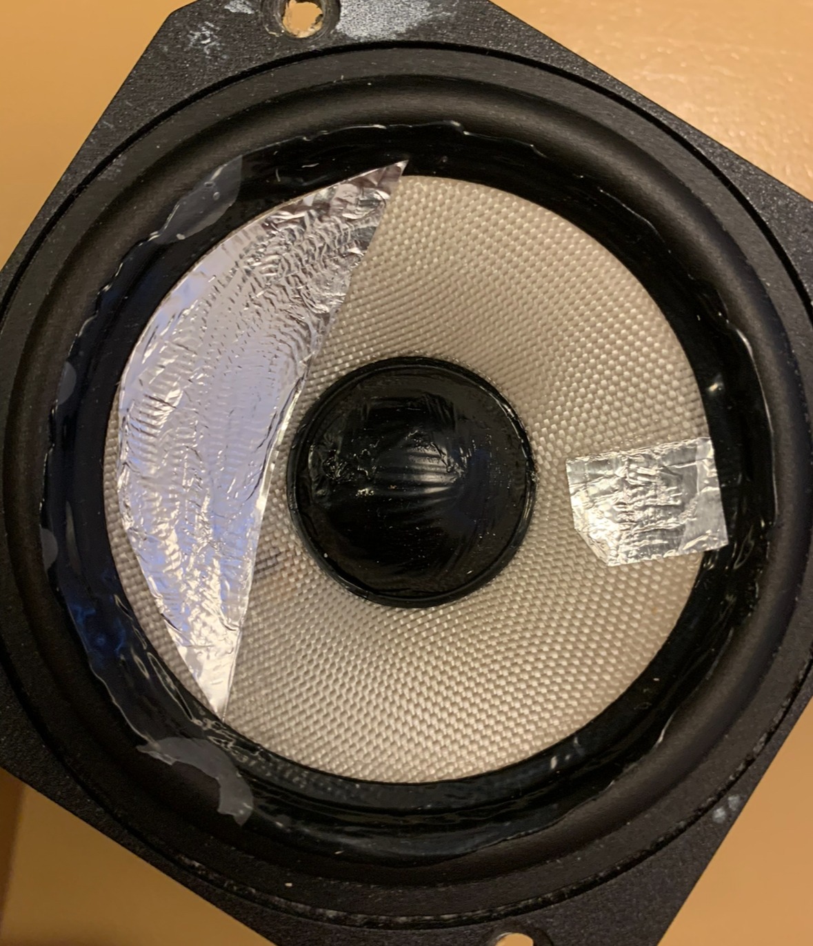

The glue have arrived: https://www.casco.dk/da/reparations-hobbylim/toj-og-sko/casco-universal-aqua.html
I guess this may be the same glue that Troels is using. Only he knows, and he decided to keep it a secret. I would say sharing is caring.
I sacrified a driver to check how the glue is to work with and how it behaves.
I feels about the same as PVA glue. I think less tendency to run. No nasty smell at all!
I admit it look like crap, but for testing is fine.
It is older driver and rather dirty. I tried if I could peel it of after 24H. I could (left side). After 48H it sticks MUCH better on the surround. And it is still soft and flexible. I guess not so soft that dust would adhere.
Plenty adhering to the alu-foil.

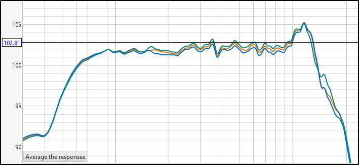

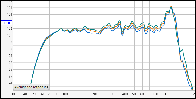

Then some measurements of Drivers
Dayton RS225 Alu
0 magnet
1 magnet
3 magnet
O magnet
2 magnet

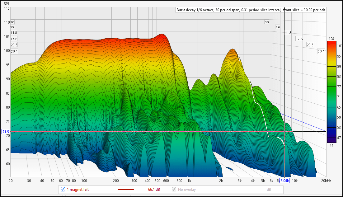

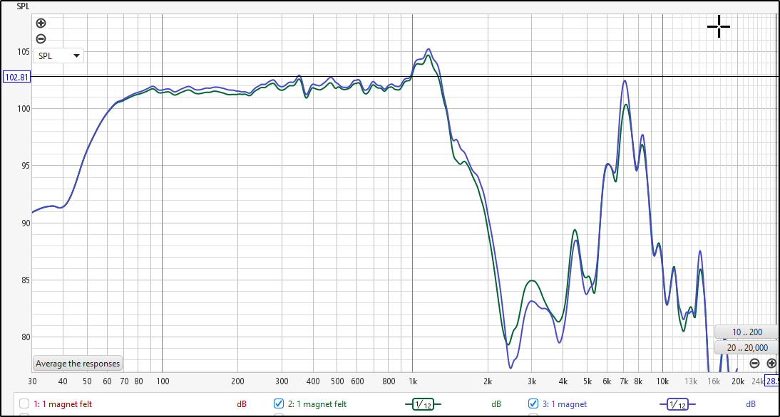

Then With and without felt:
I quess we could say resonances is just shifted, but on the other side I would say we have decent improvement from the cost of less than a dime.
Not sure if we can trust burst decay. I took it with standard measurement sweep. In all measurement it show reduction at marker:
1 magnet No felt:
1 magnet with felt:
I tested back and forth with magnet and with and without felt many times. Driver not bad as is, but I definetely prefer with added magnet and felt.
Then we have the midrange with felts on the dustcap. It is with felt like on picture above. For sure it would not stick for months before falling of.
Nearfield:
Mid Mic distance 20 cm no gating

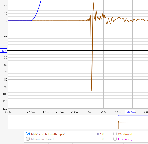

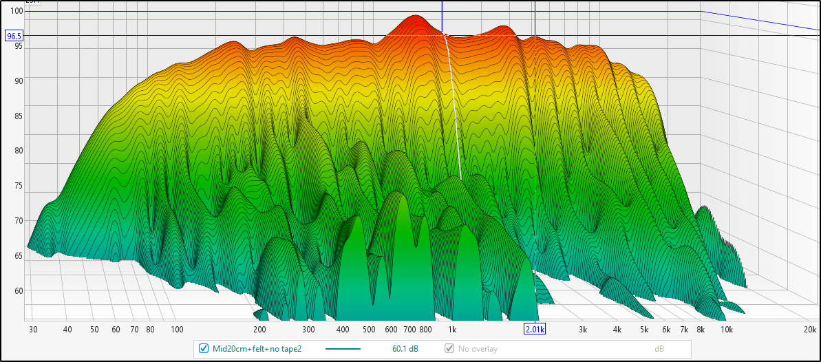

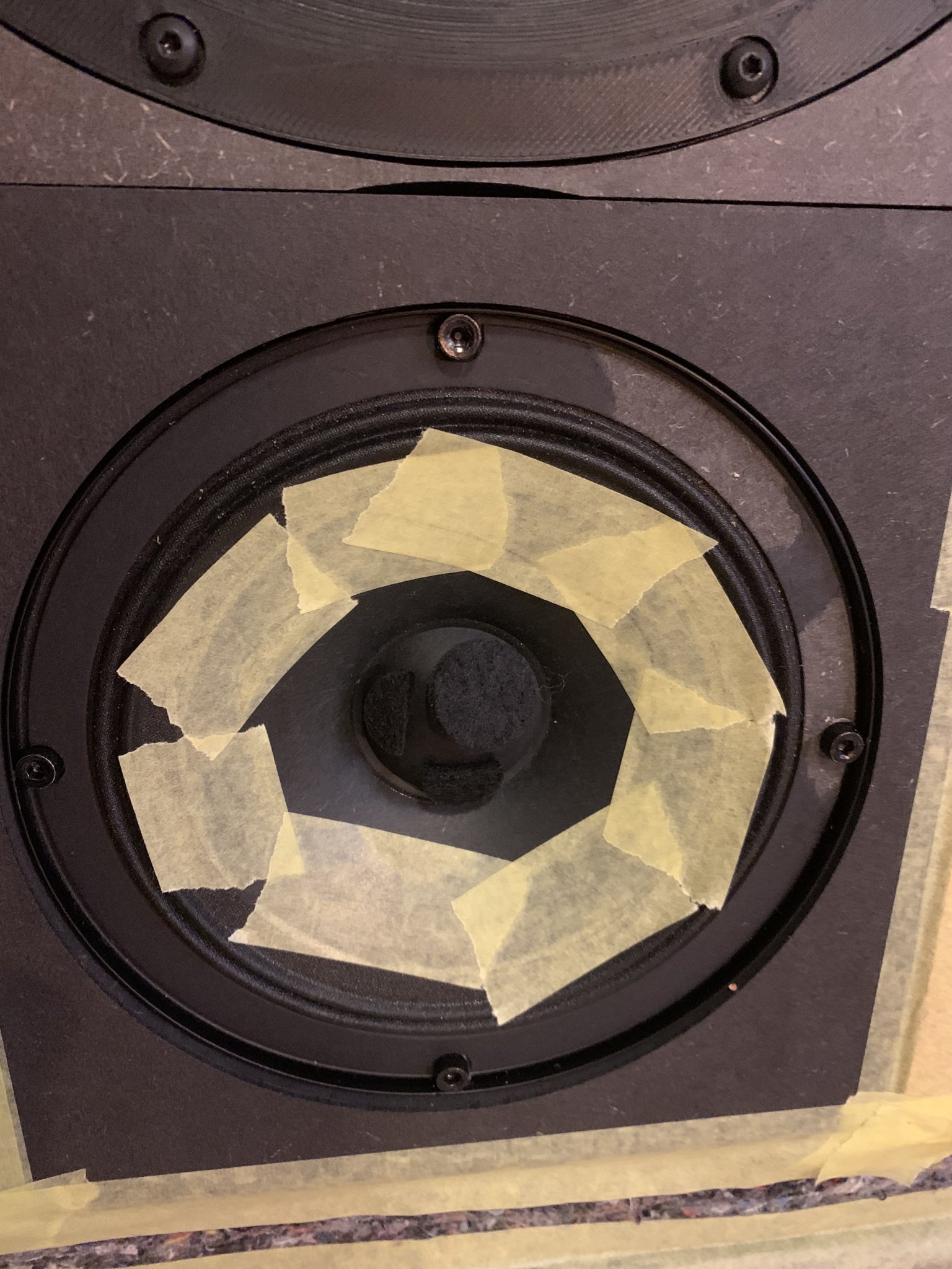

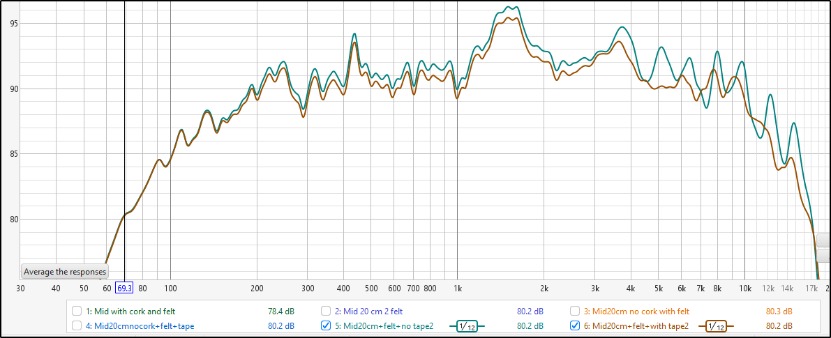

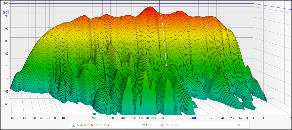

Then I thought what would happen if I add Tesa painters tape. 30 seconds later and a mindblowing result on the graph is to be seen.
Mod:
Change was so big that I did measurement backward. Ie new measurement. Then remove tape. Then measure again.
Change in frequency:

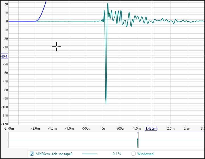

No tape impulse (impulse inverted. You could reverse your device 180 degree if it is better to the eye):
Iimpulse with tape:
Waterfall decay no tape:
With tape:
Reactions: Freedom666
