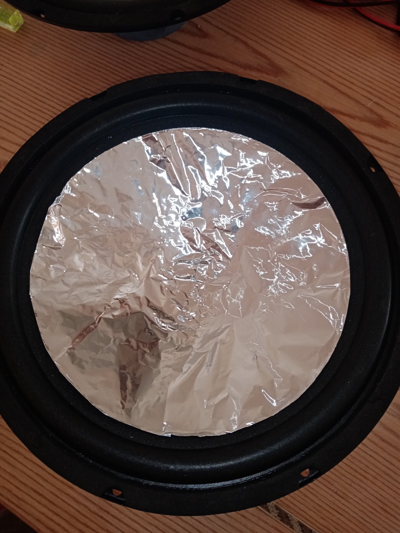

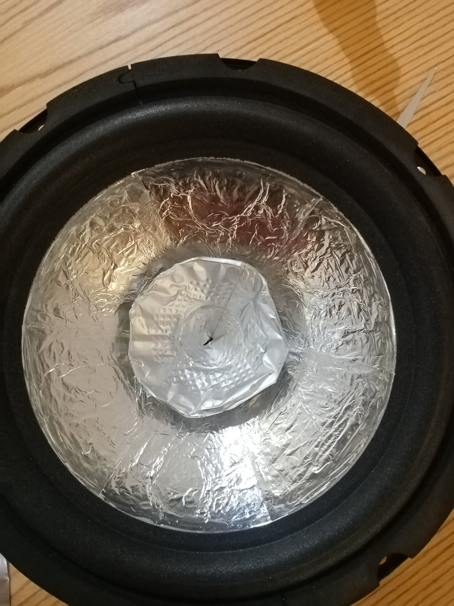

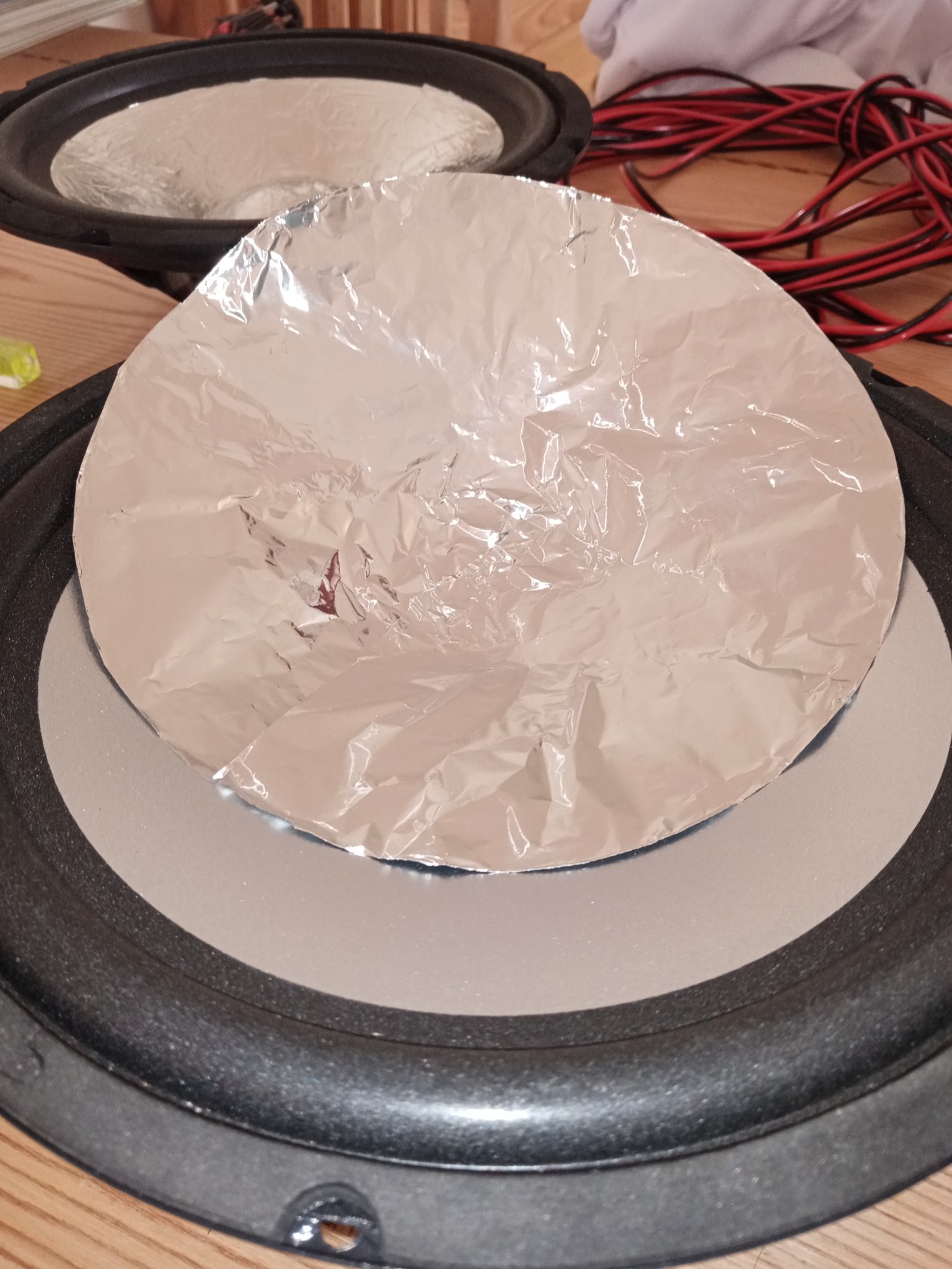

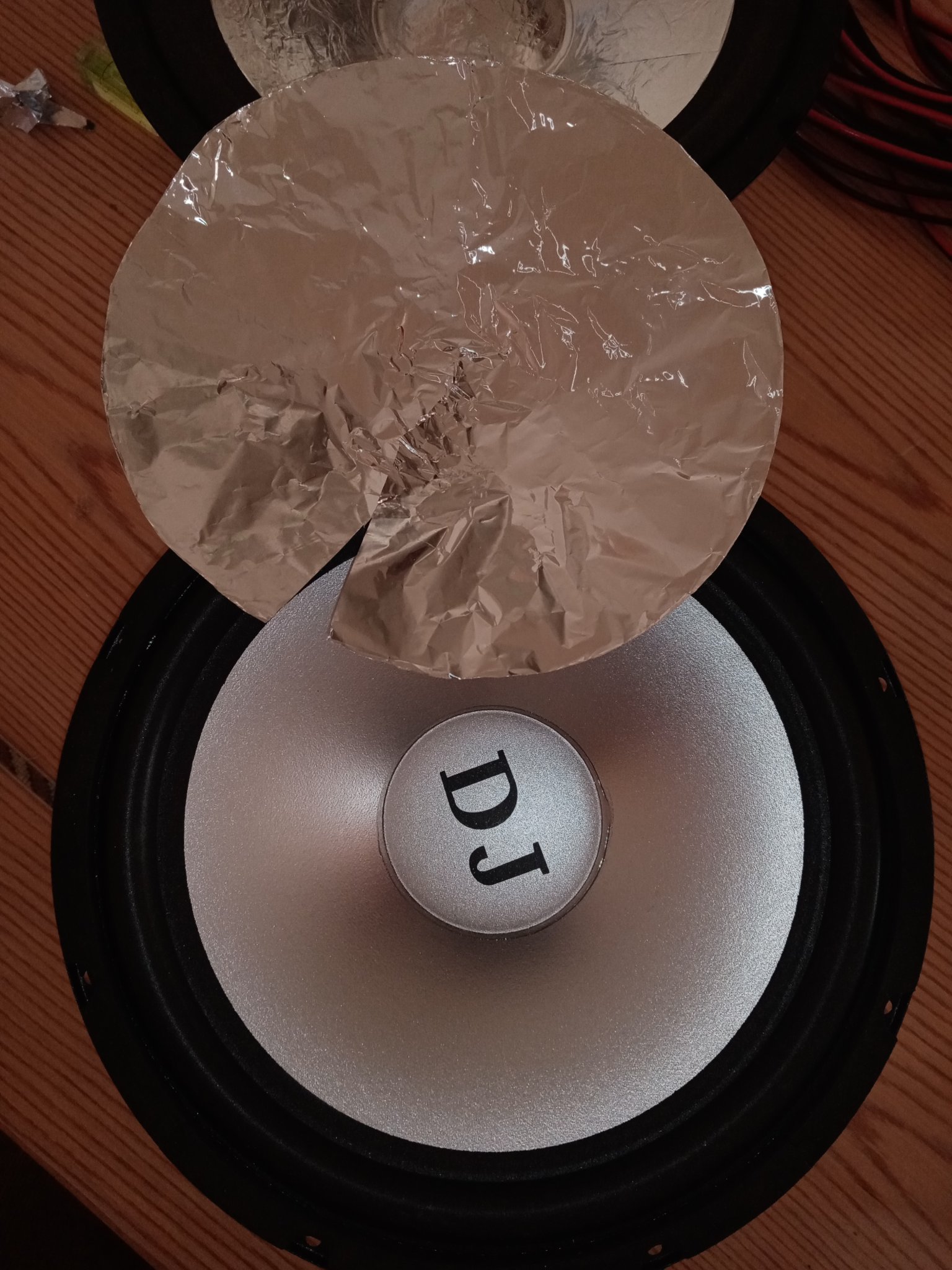

Another example of a quicker covering a loudspeaker paper cone with just one big piece of household aluminium foil.
Glue is here applied to the cone instead of on the tart like cut aluminium sheets I usually use.
The inverted dustcap of the bass driver makes the process of using a single sheet of foil easier.

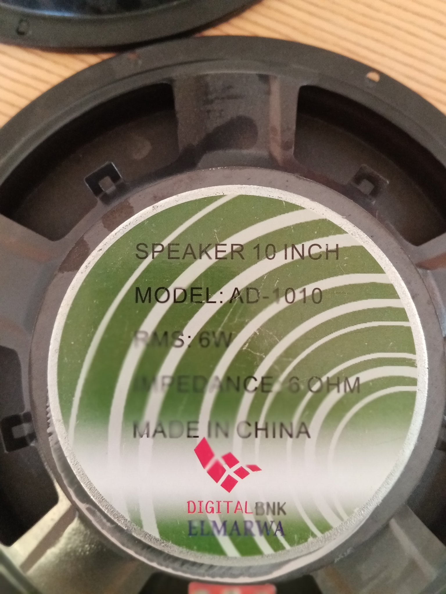

Does anyone know the manufacturer of these drivers?
Anyone has TSP parameters of these "DJ" loudspeakers?
These drivers are spare parts for portable bluetooth loudspeakers

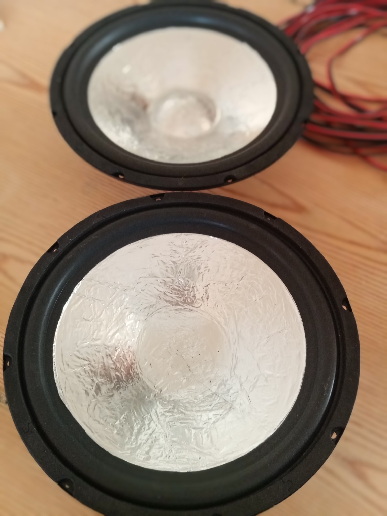

Constrained Layer damping:
A hint I got here from the forum as a key to good sound from sandwich structure.
Now used silicone sealant for applying aluminium foil to the paper cone.
Finger snipping test shows enhanced damping due to the properties of the silicone.
Work goes faster than with the household glue I used usually.

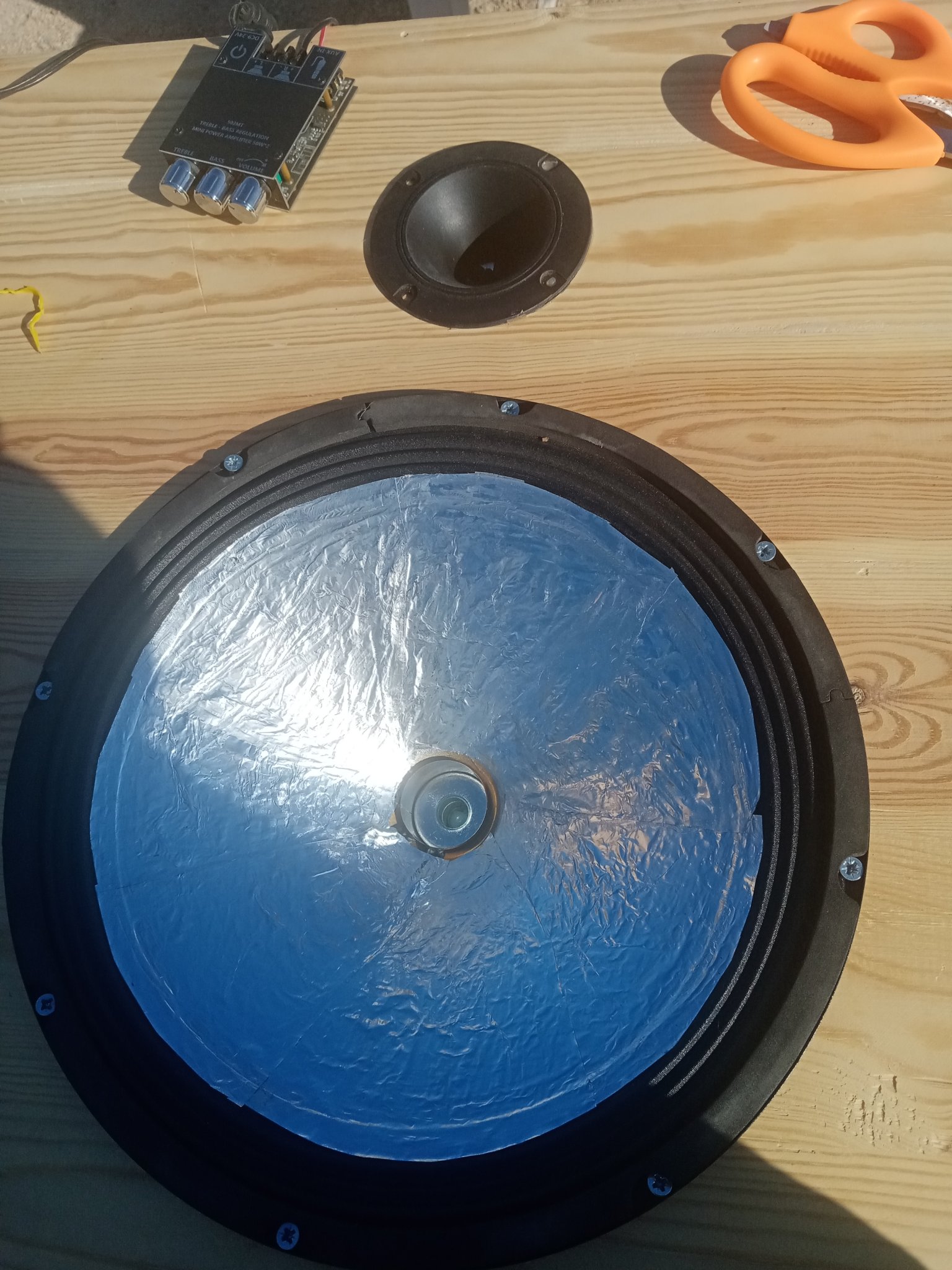

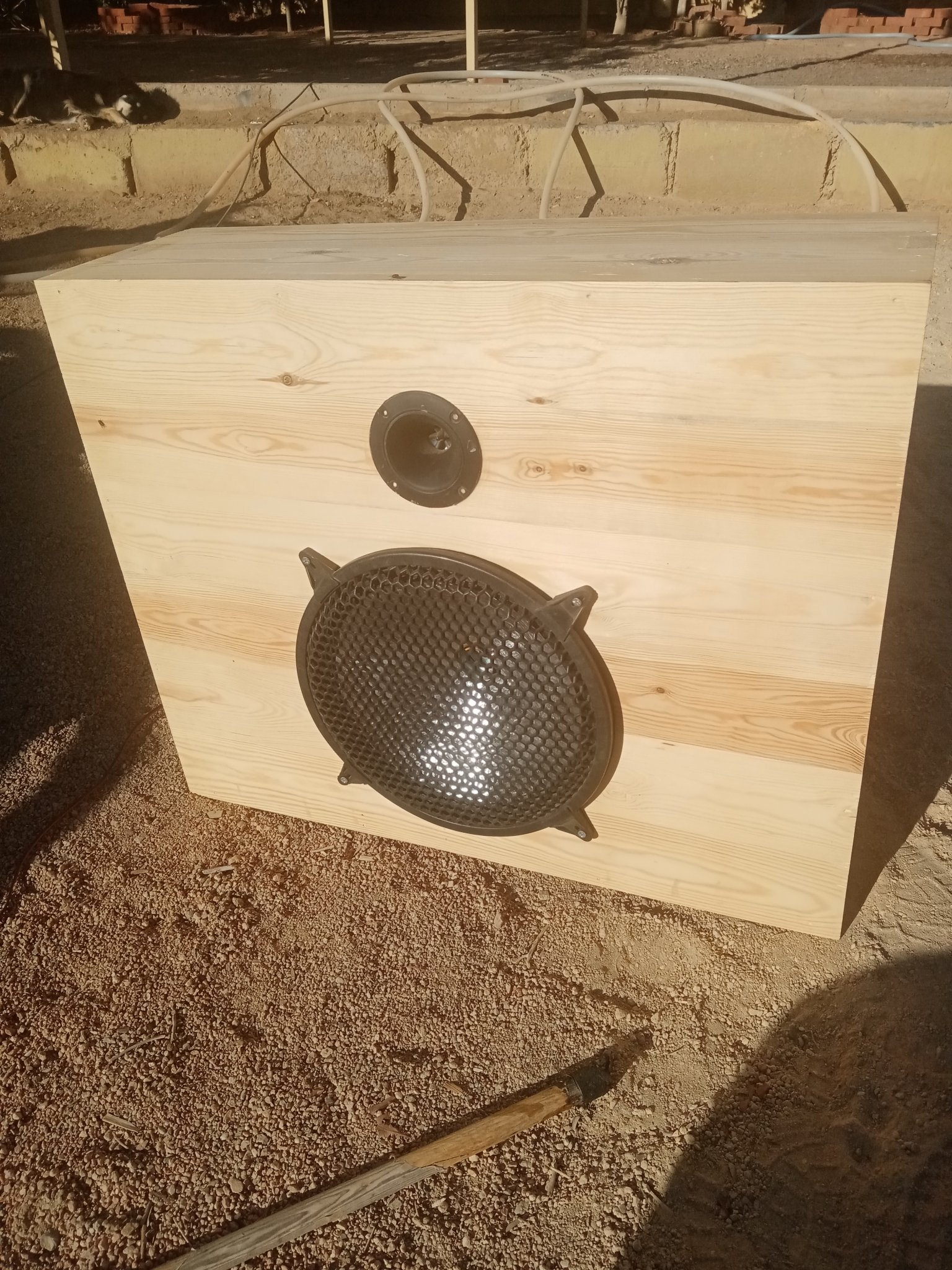

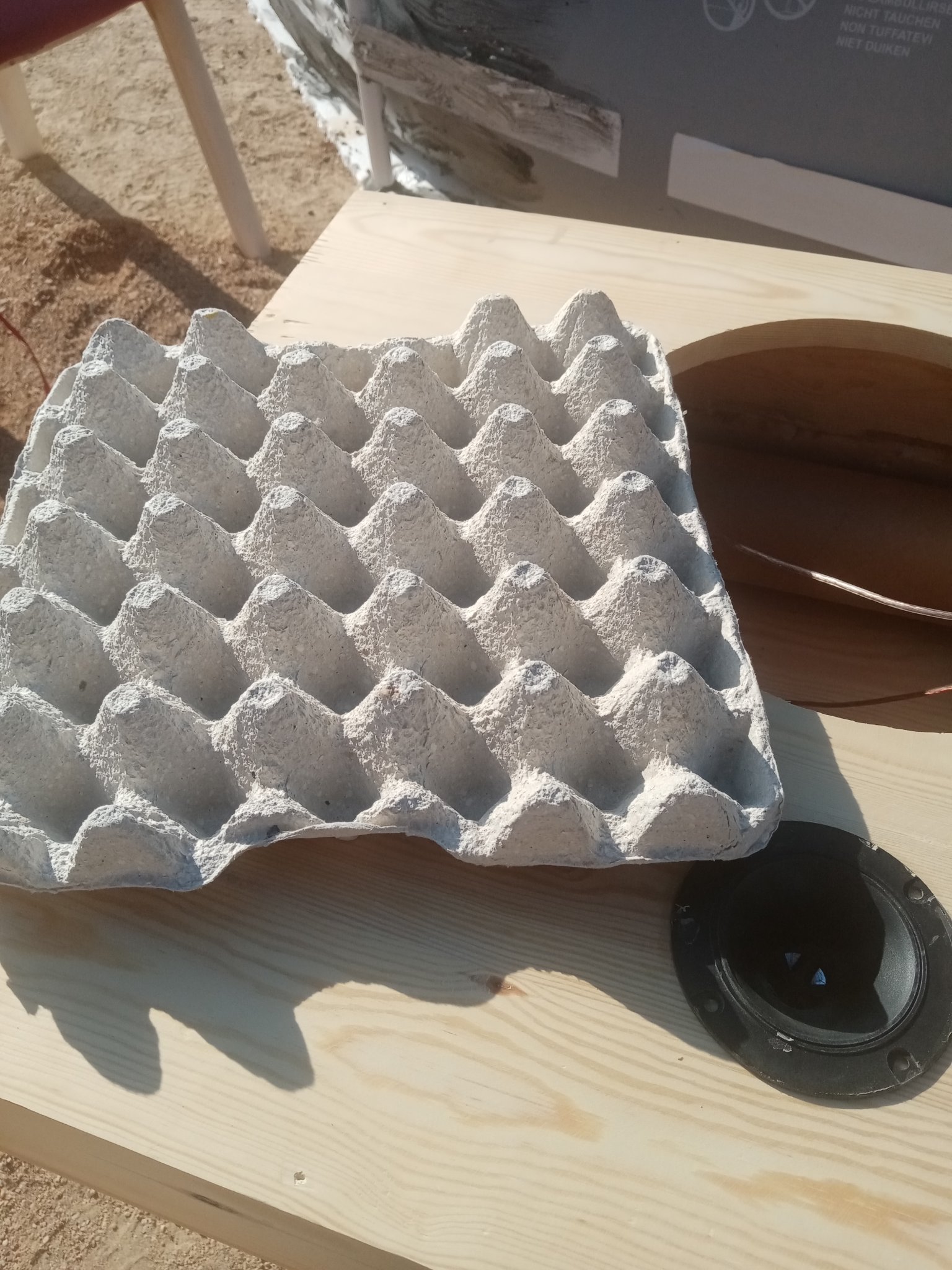

Finished a box again with great sound, sandwiched 30cm cone, removed dustcap added double magnet
low tuned reflex port 8cm diameter in 80 liter box.
Inside lined with egg crates
and 1cm foam on all internal sides
partially alu foil covered back side
first time with silicone as glue forming a more damping constrained layer. "CLD"

Can this work with car speakers and making a homemade whizzer cone for it as wellAnother example of a quicker covering a loudspeaker paper cone with just one big piece of household aluminium foil.
@L.rivera92172
Mostly I treat paper cone drivers.
Polypropylen drivers often used in car hifi do not need aluminium foil treatment.
But you can make a whizzer cone if you have a driver you want to test this.
There is a thread on it I created "how to make a whizzer cone"
