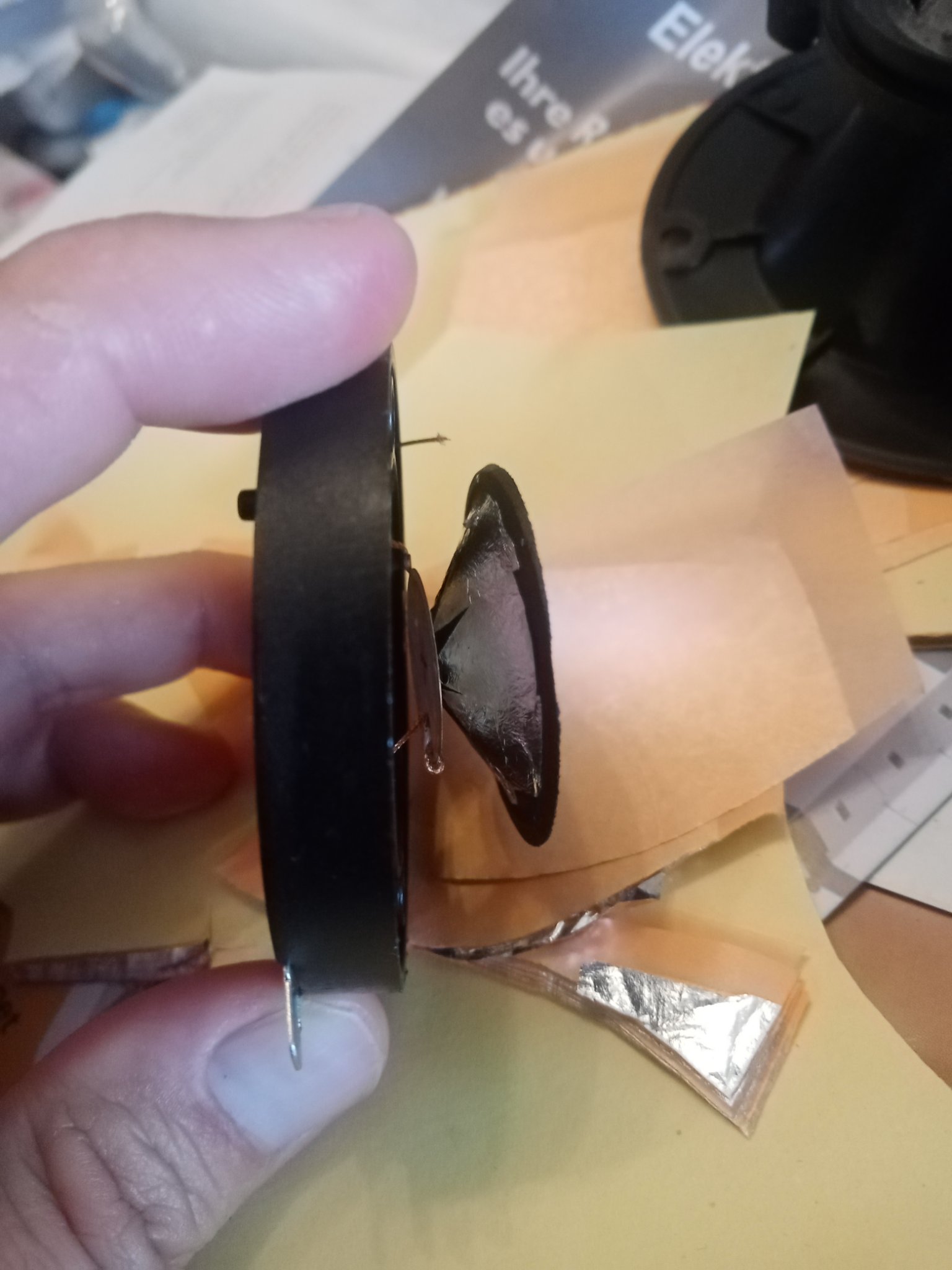

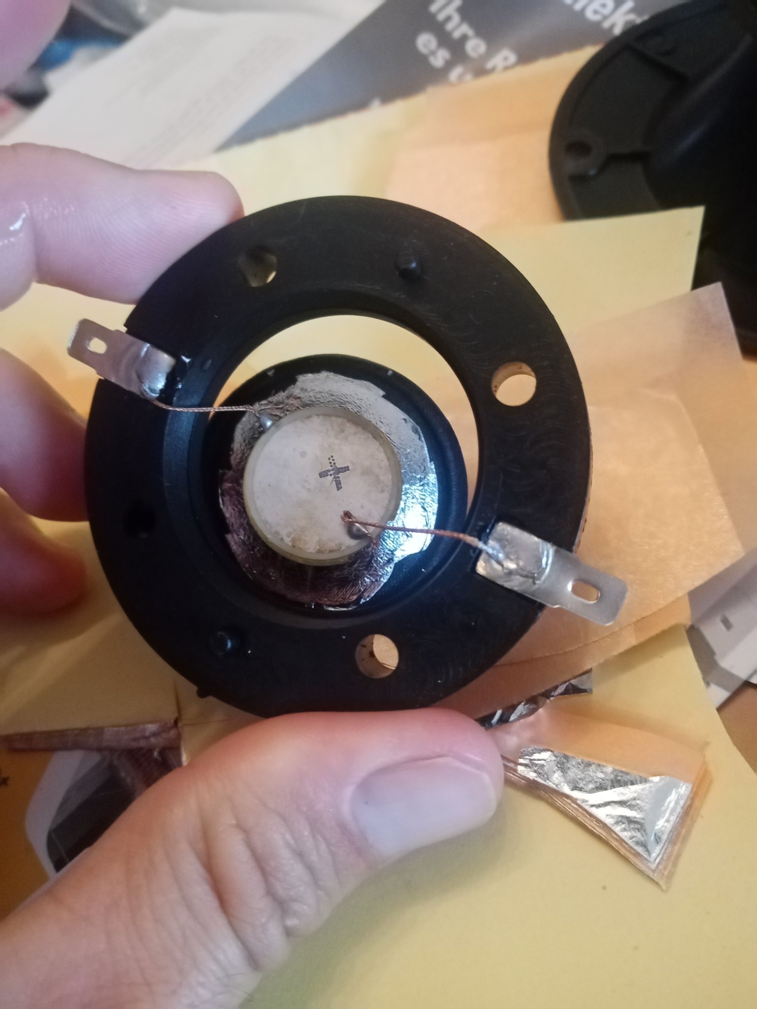

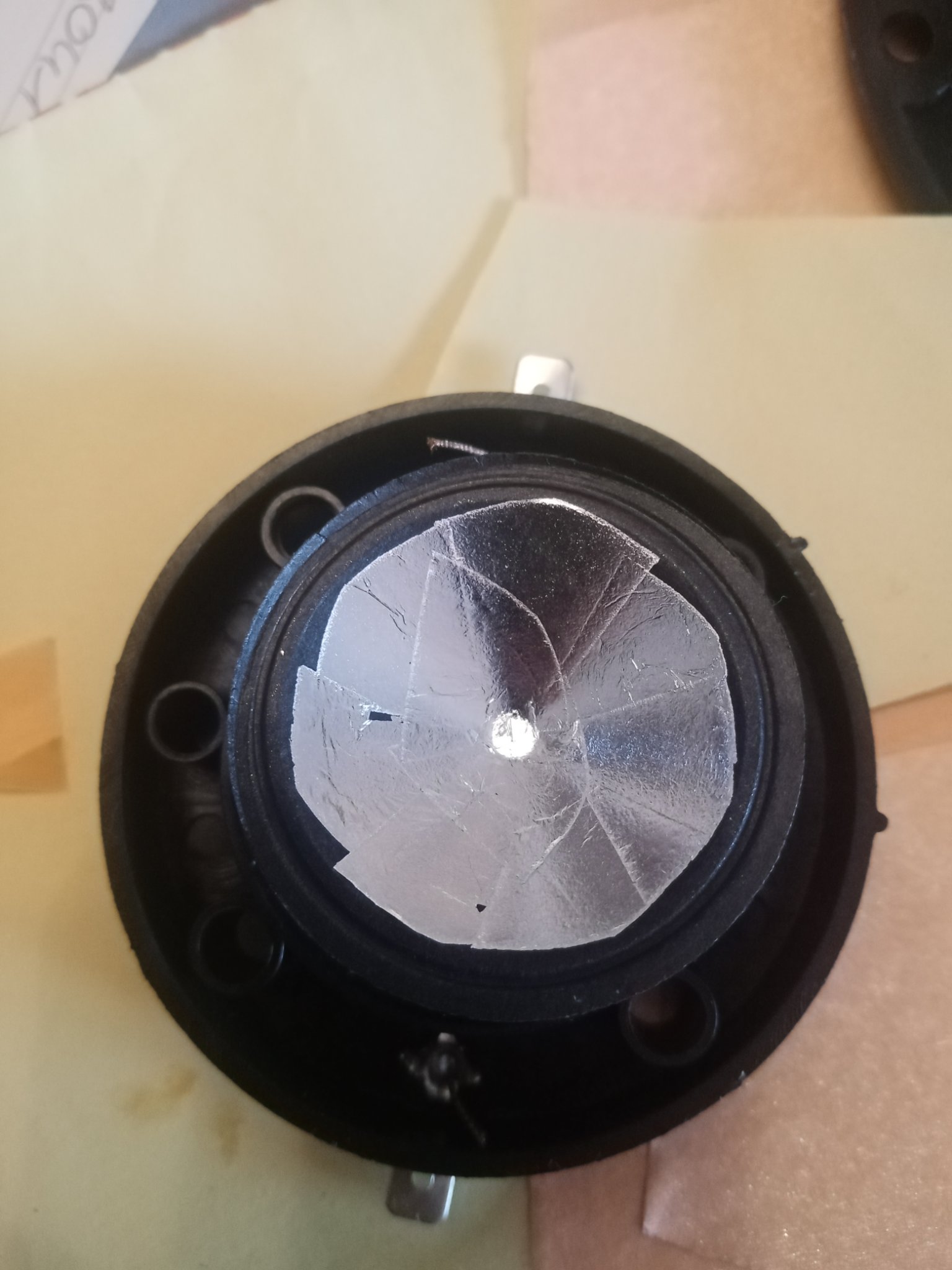

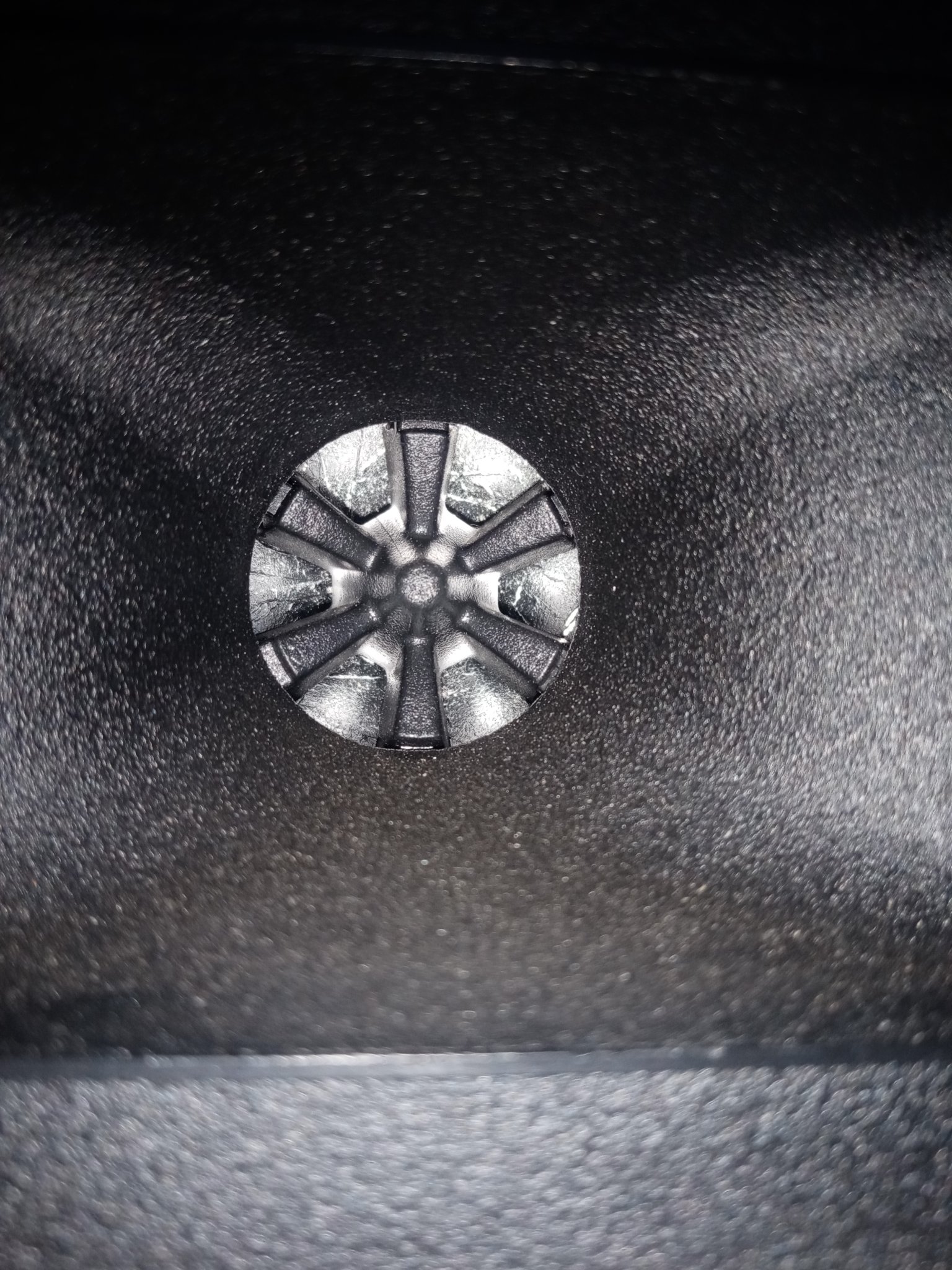

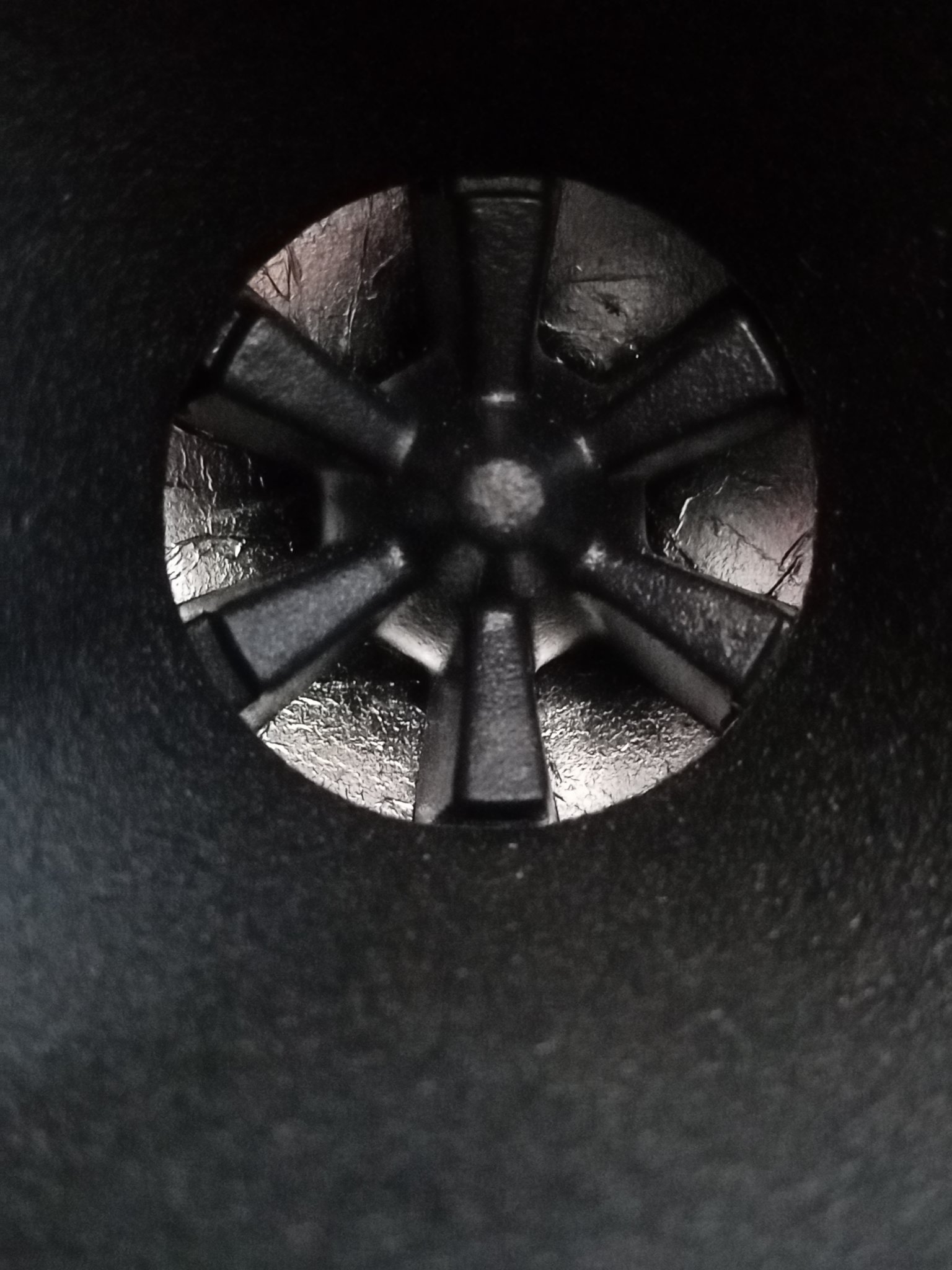

Feedback on the use of a new type for glue for the thin foil from the goldsmith.
Easier work with methylcellulose - its the glue used for wallpapers.
It has less damping properties than the "Anlegemilch" usually used for thin foil metals but its easier to work with and tidier work is possible.
It has stiffening properties.
Here I tried it on piezo drivers. Will measure if there is a benefit using sandwich technology on piezo paper cones.

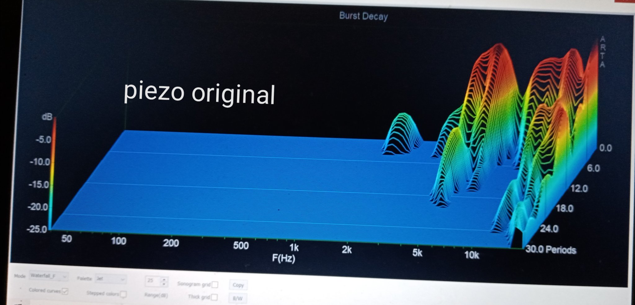

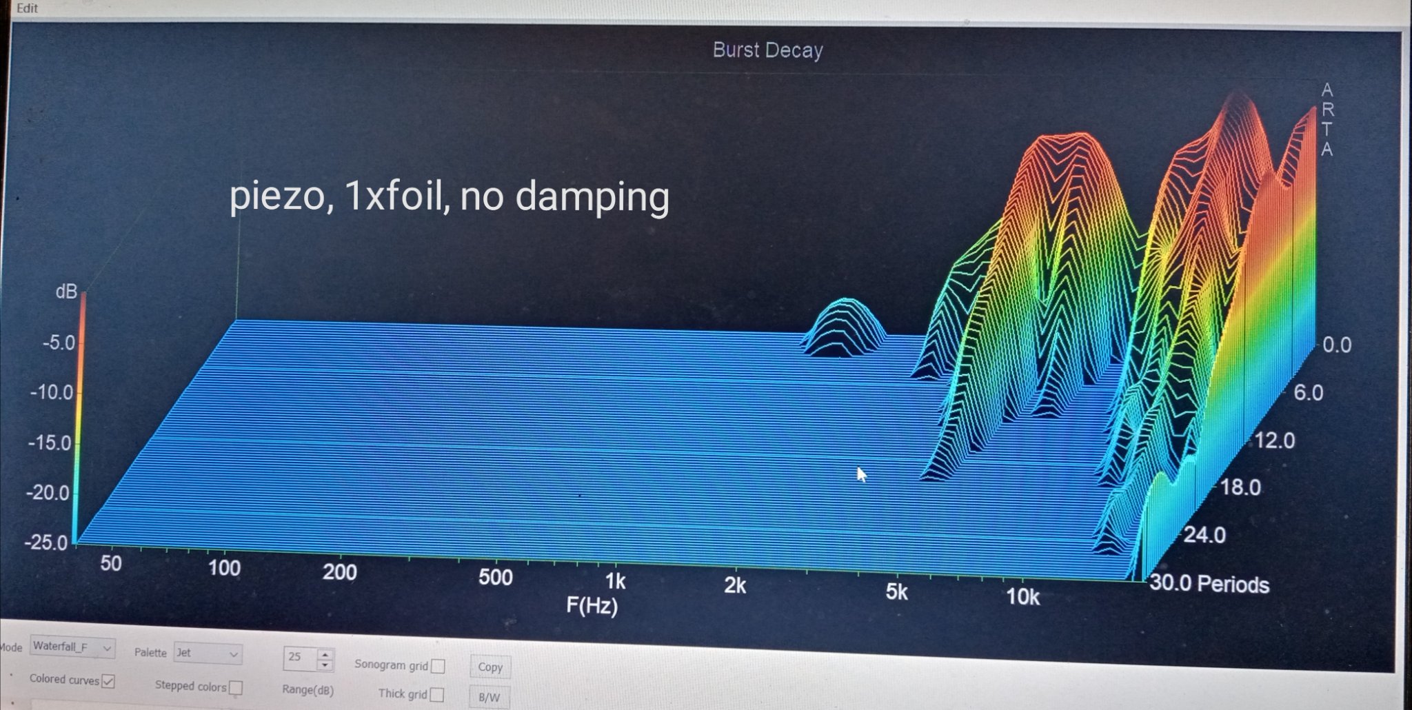

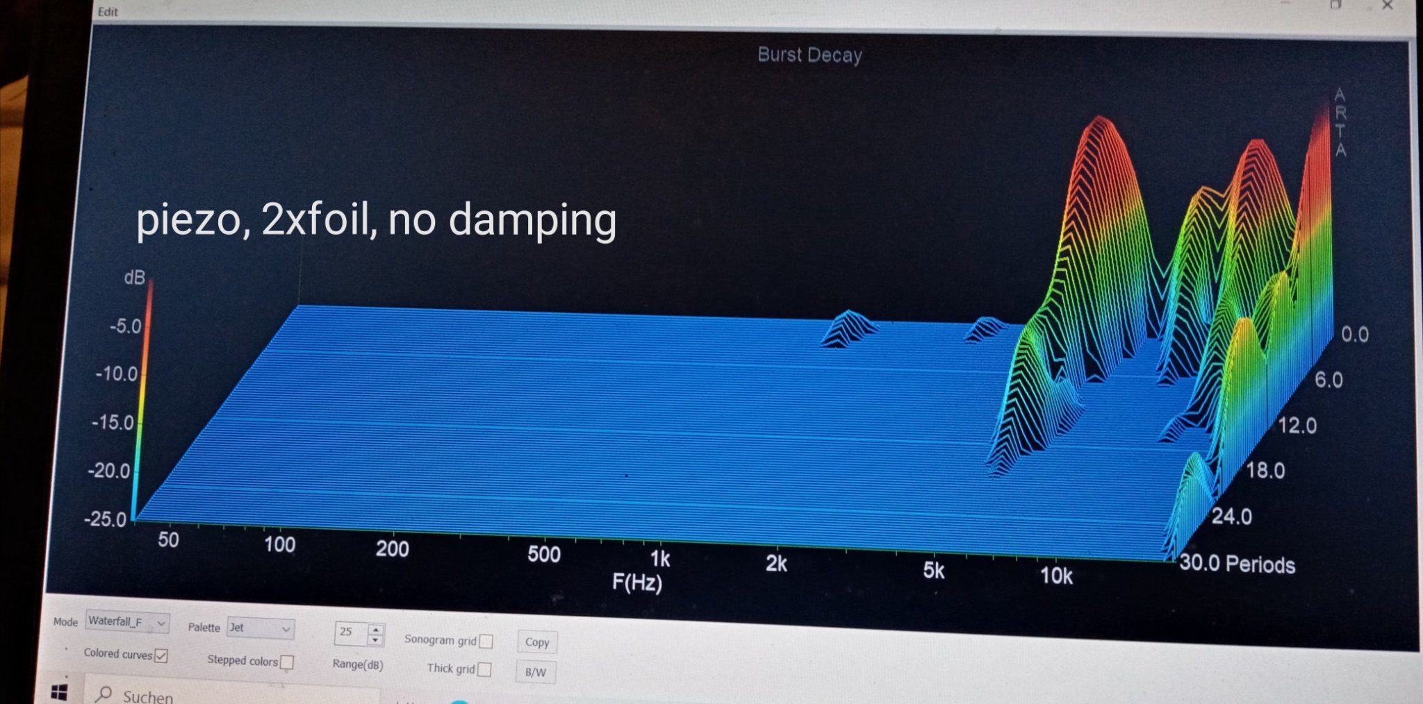

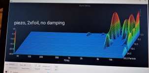

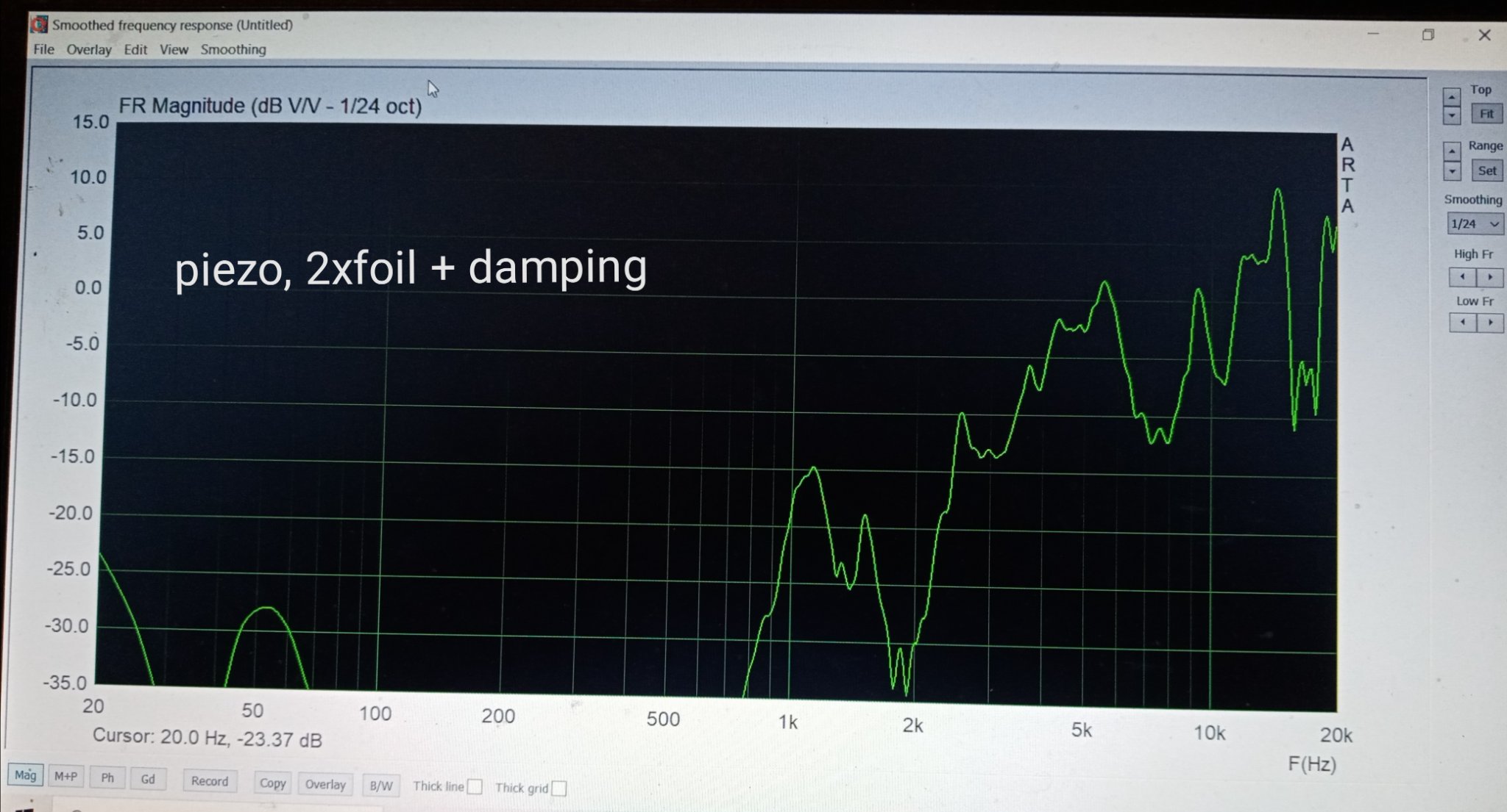

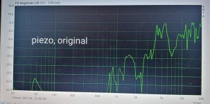

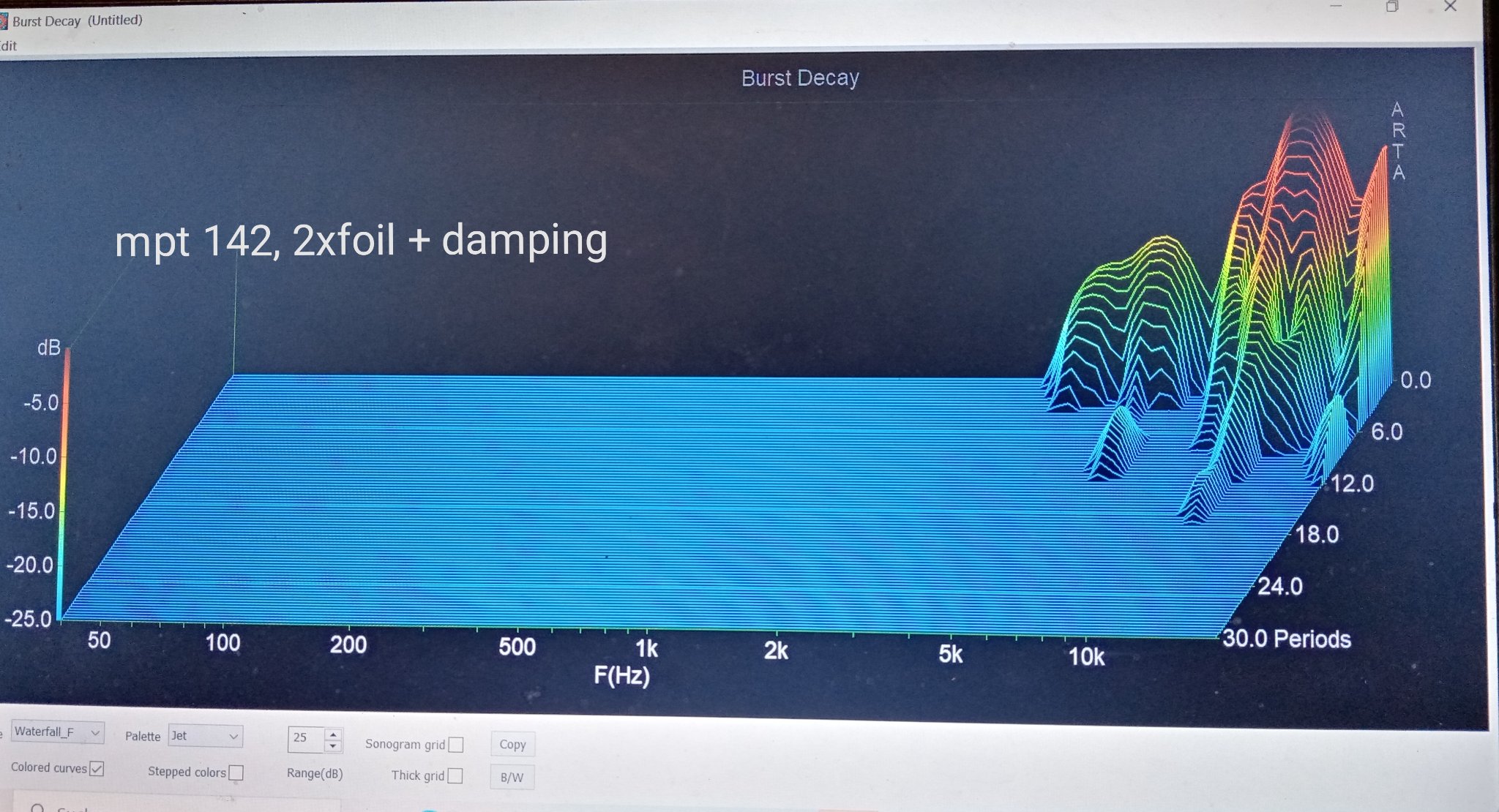

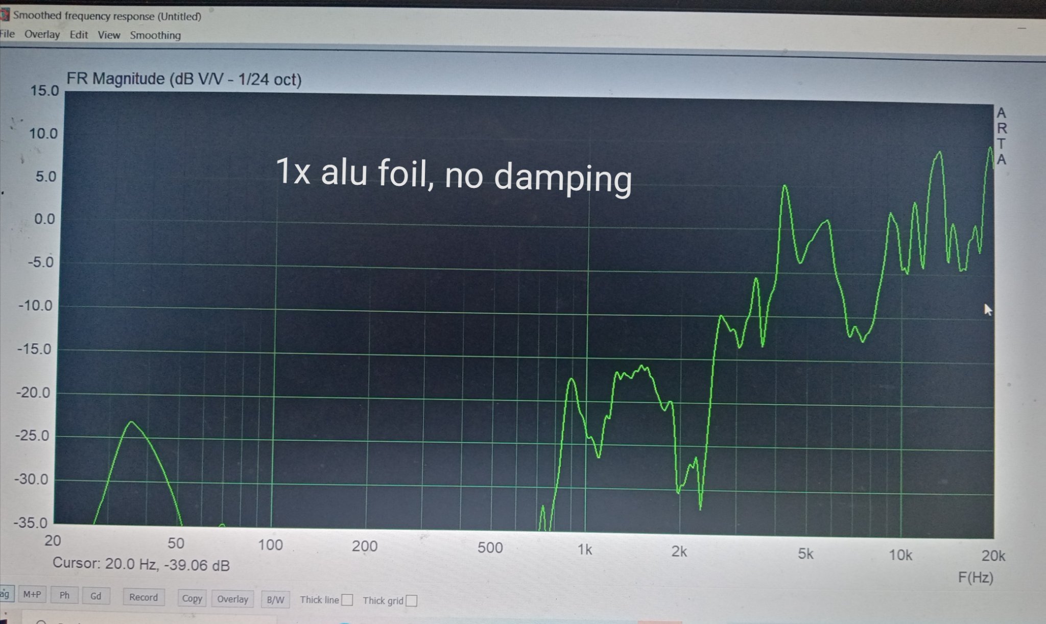

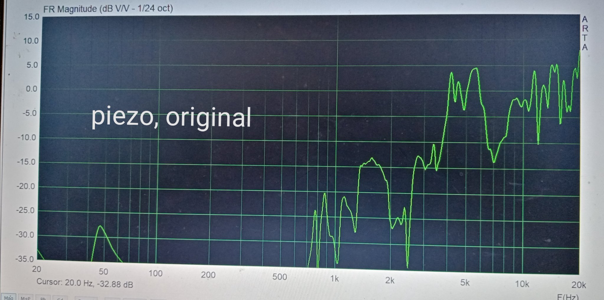

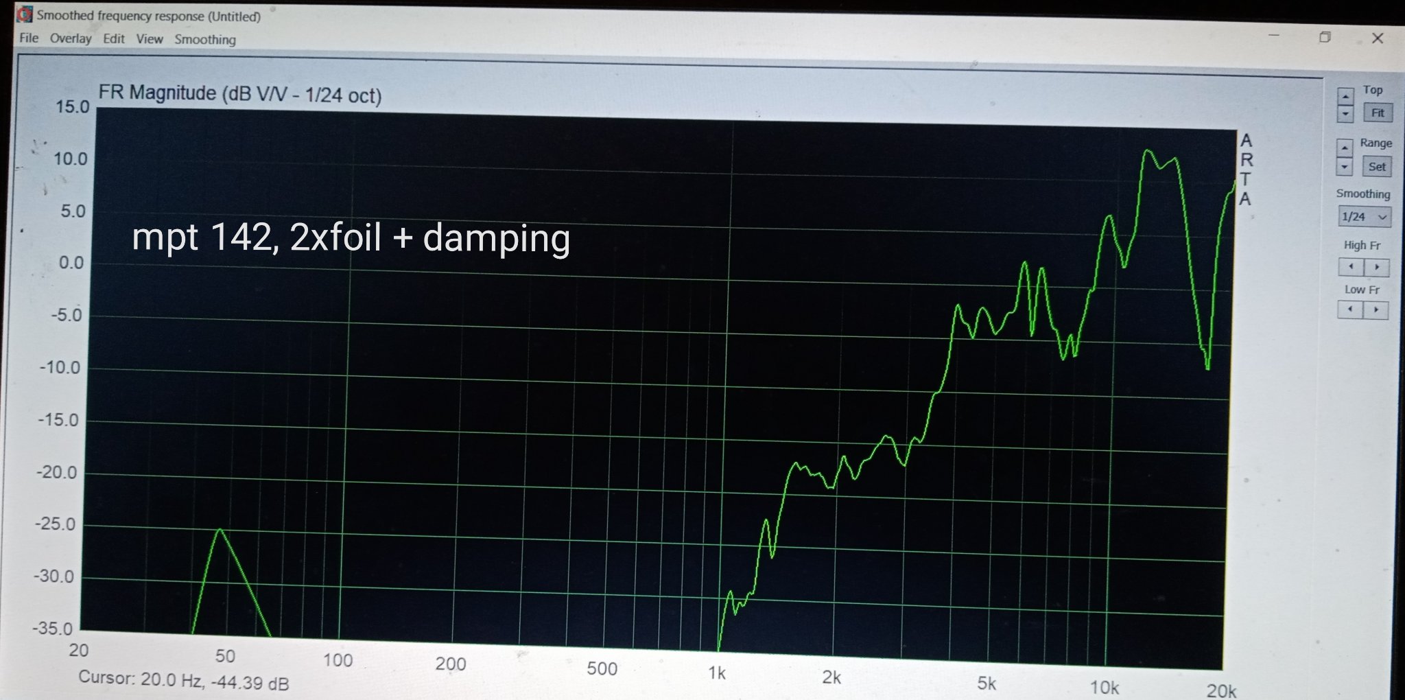

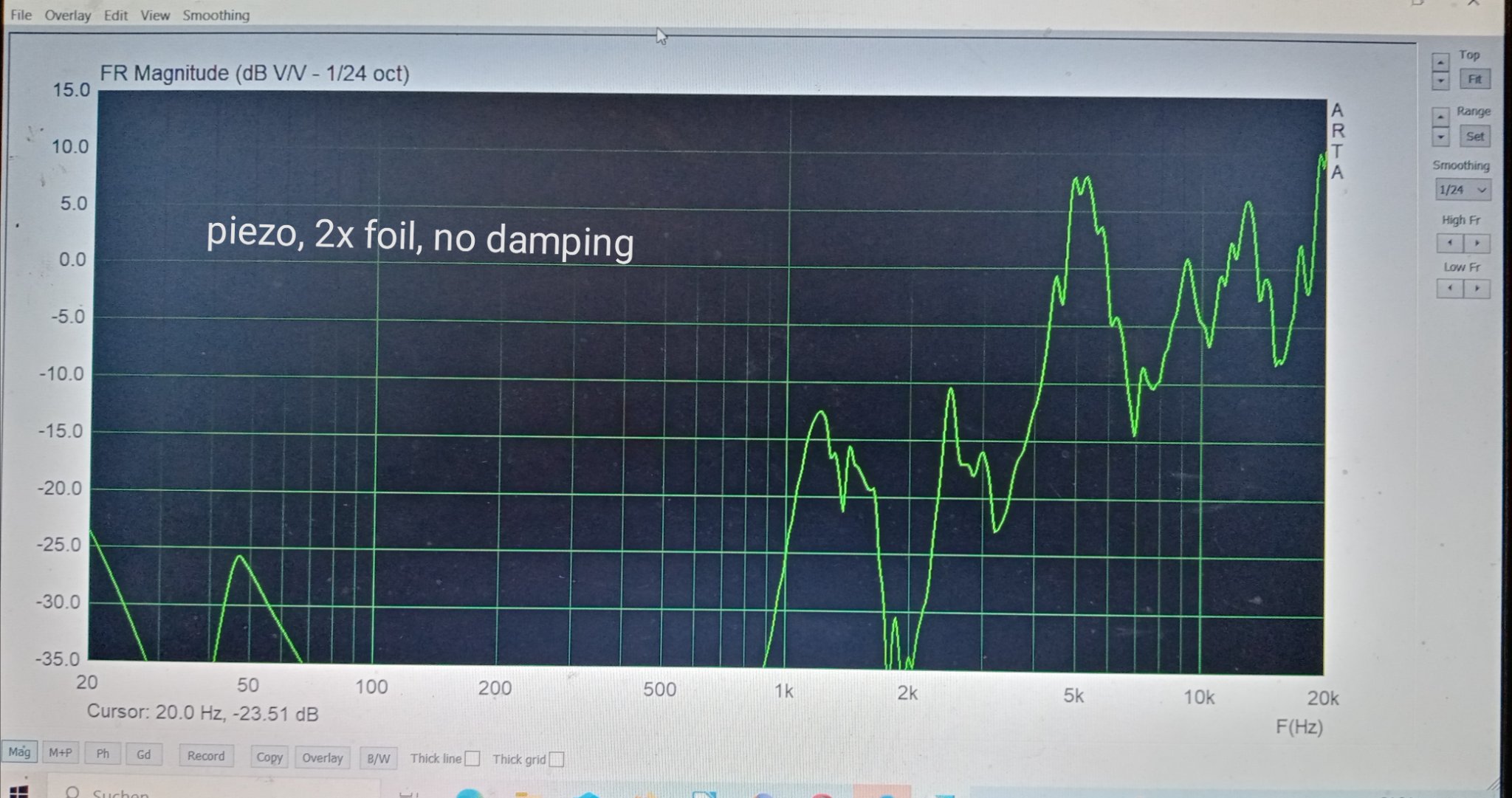

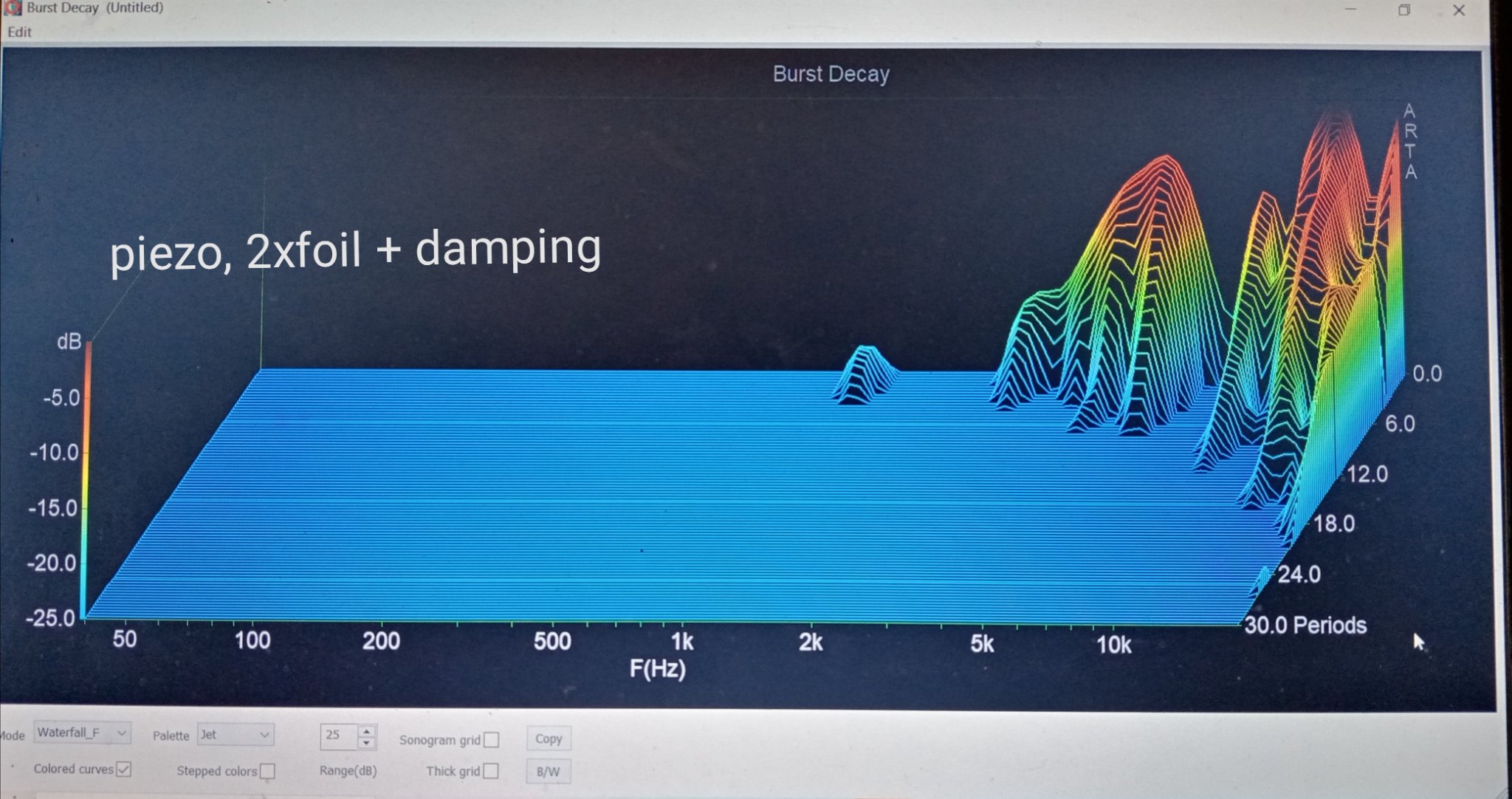

made a series of measurements
Arta f response and waterfall
4 no name piezos and one
Monacor MPT-142
all have filter:
12 ohm in line 1uF in line, 91 ohm across plus and minus on the driver
no name piezos
1 driver original
2nd driver 1x alu foil
3rd driver 2x alu foil - sandwich
4th driver 2x alu foil + damped cavity with medical cotton
5th driver Monacor MPT142
2x foil plus damped cavity
Monacor MPT-142
all have filter:
no name piezos
1 driver original

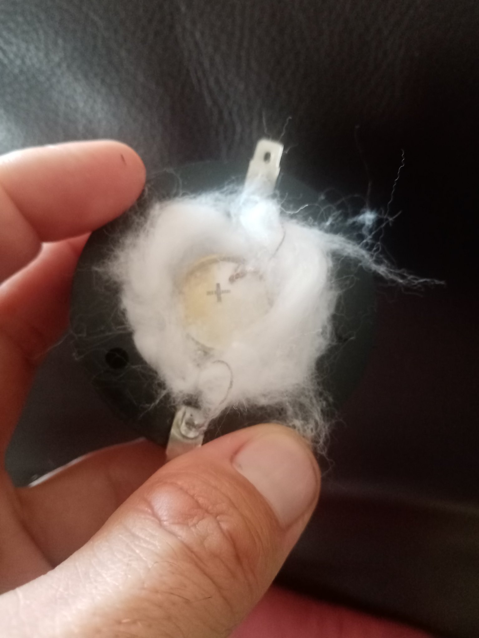

especially on piezo cones the cone stiffening foil raises resonance frequency. Due to the lack of a real suspension.
The suspension was not covered with foil.
The quality piezo MPT142 shows better linearity.
Very effective is the damping of the cavity with medical cotton
if bandwidth is important in a piezo project I would damp it only thinly with silicone sealant (no cone stiffening).
This should not raise the resonance frequency.

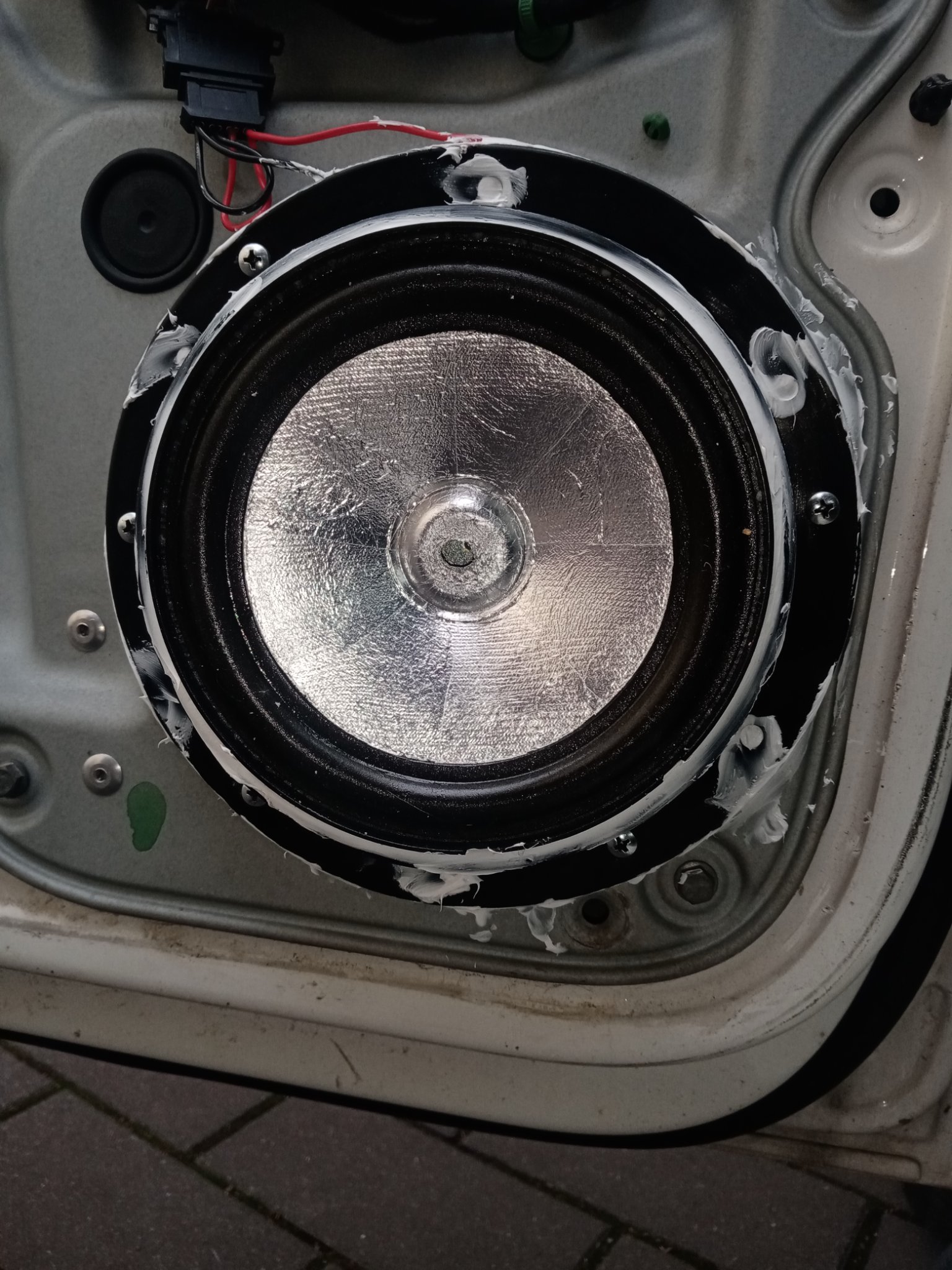

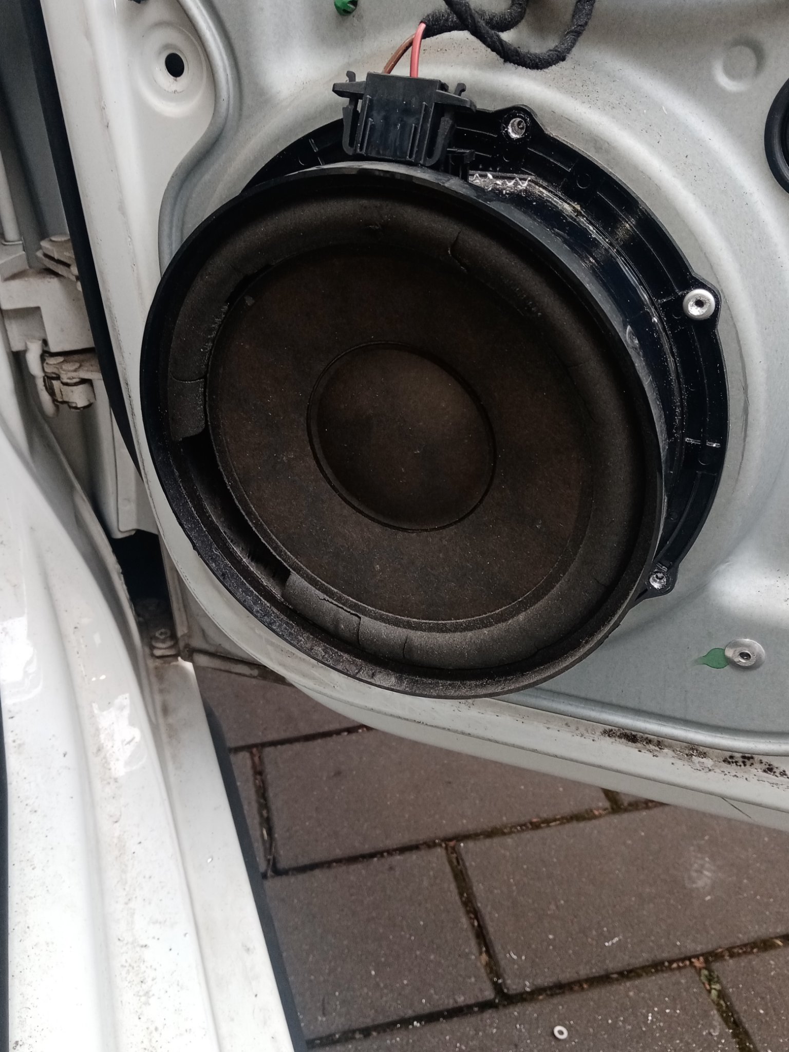

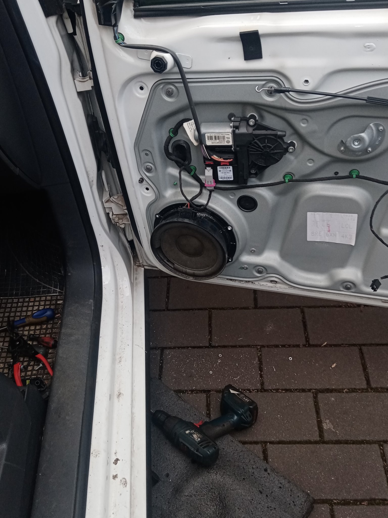

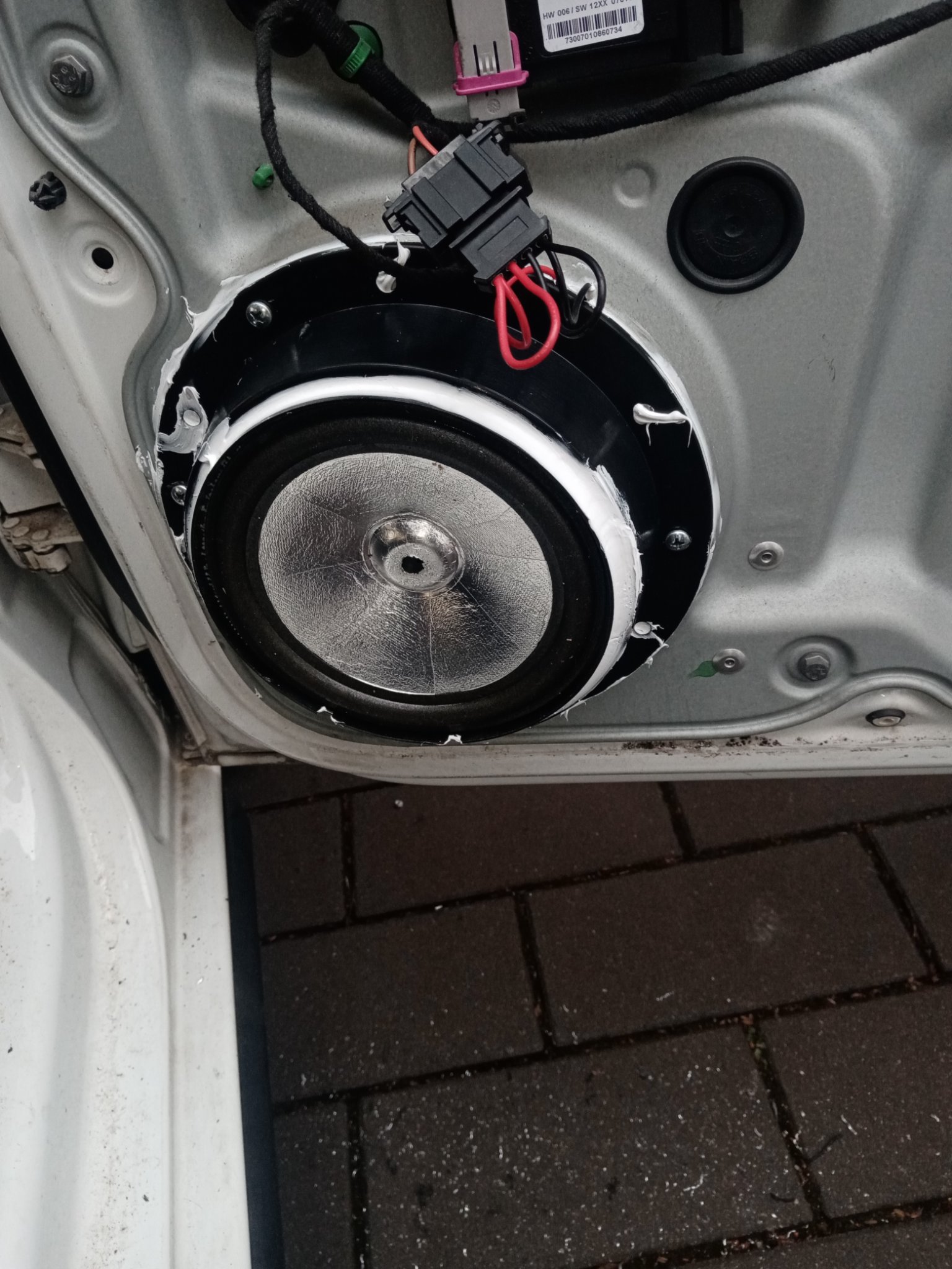

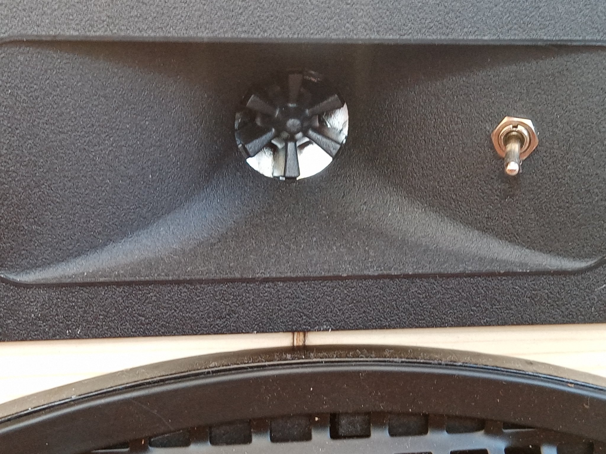

now the drivers from post 3 came to use in the doors of a VW Touran car
Defect driver replaced

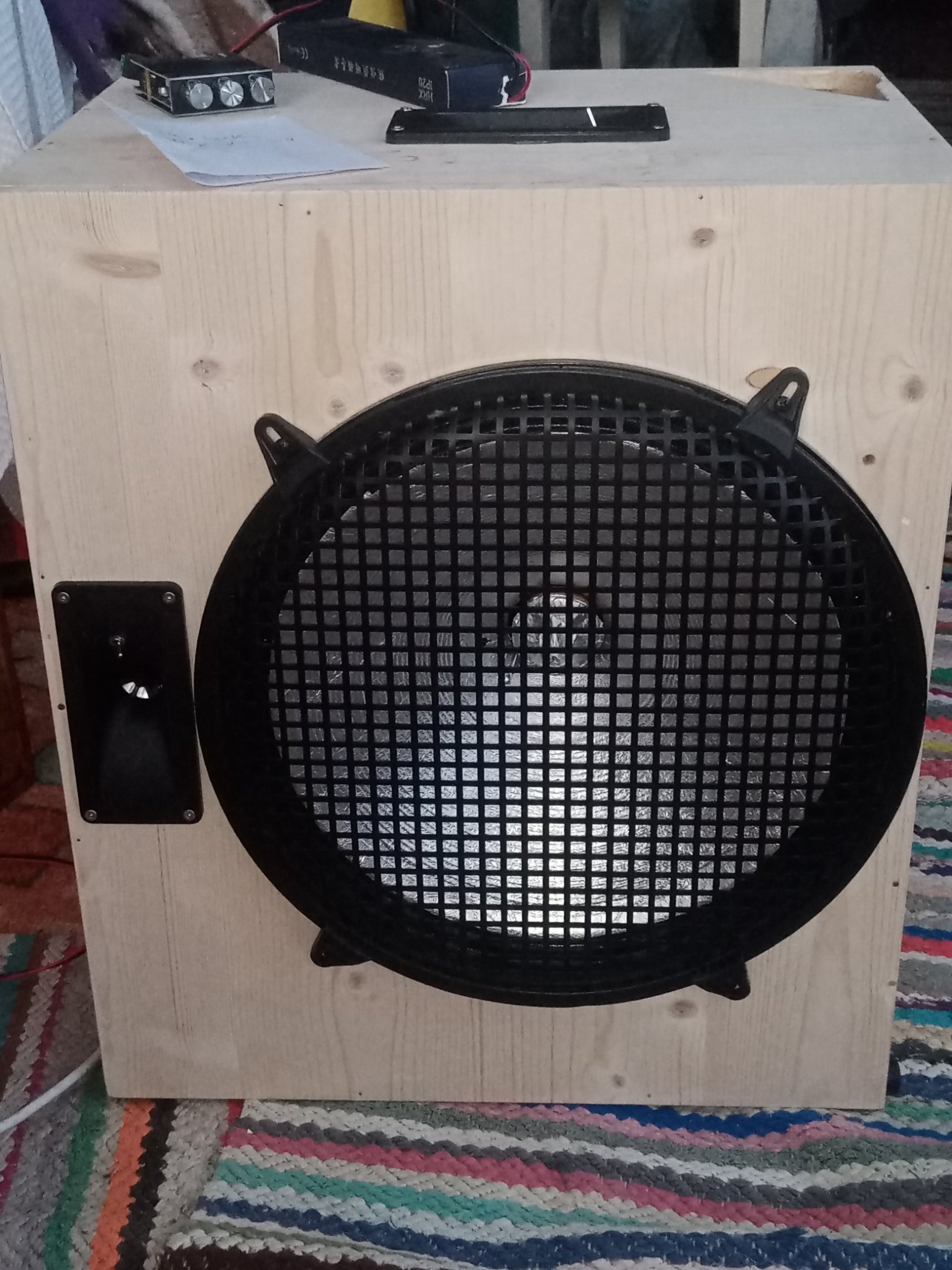

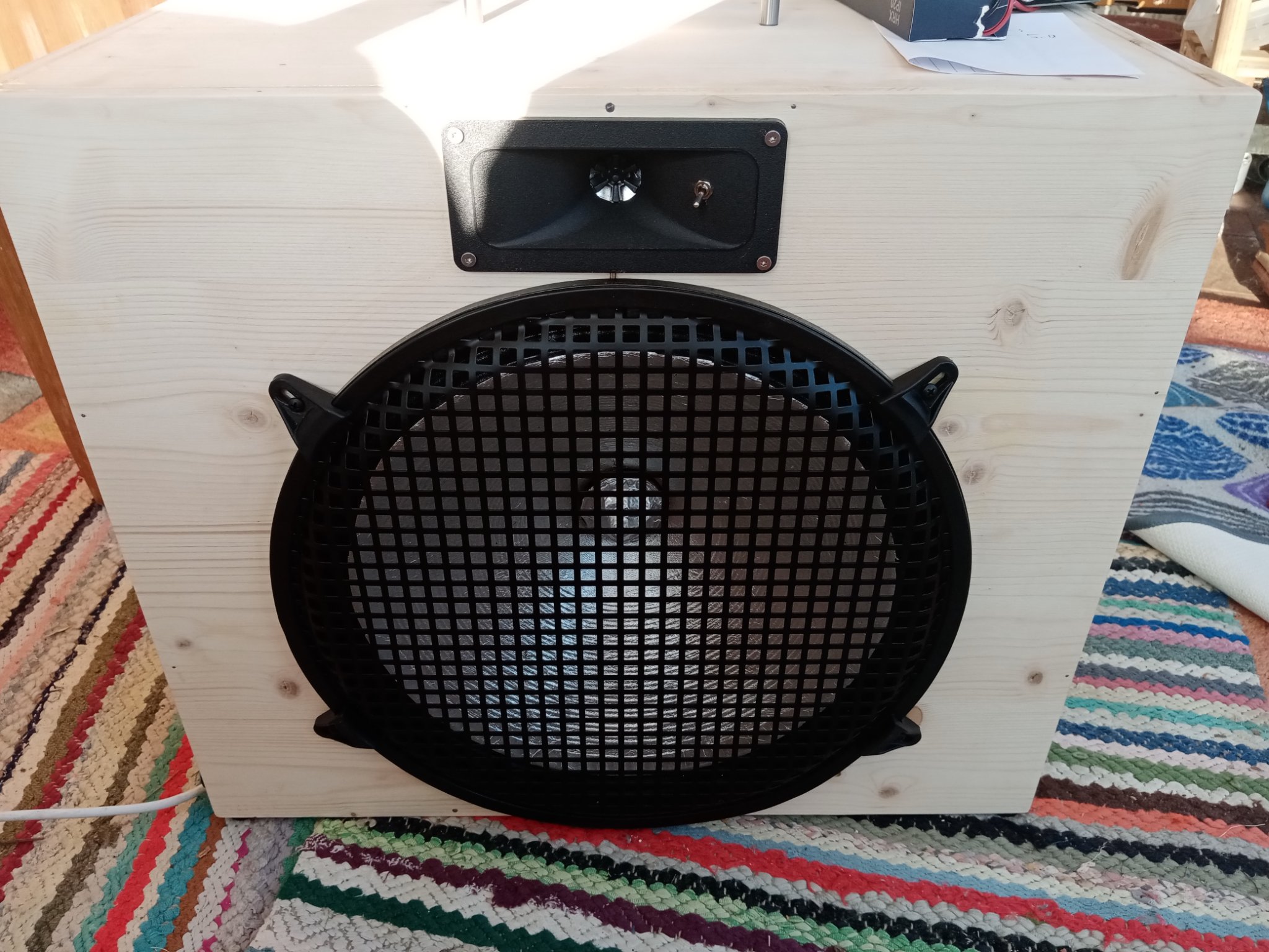

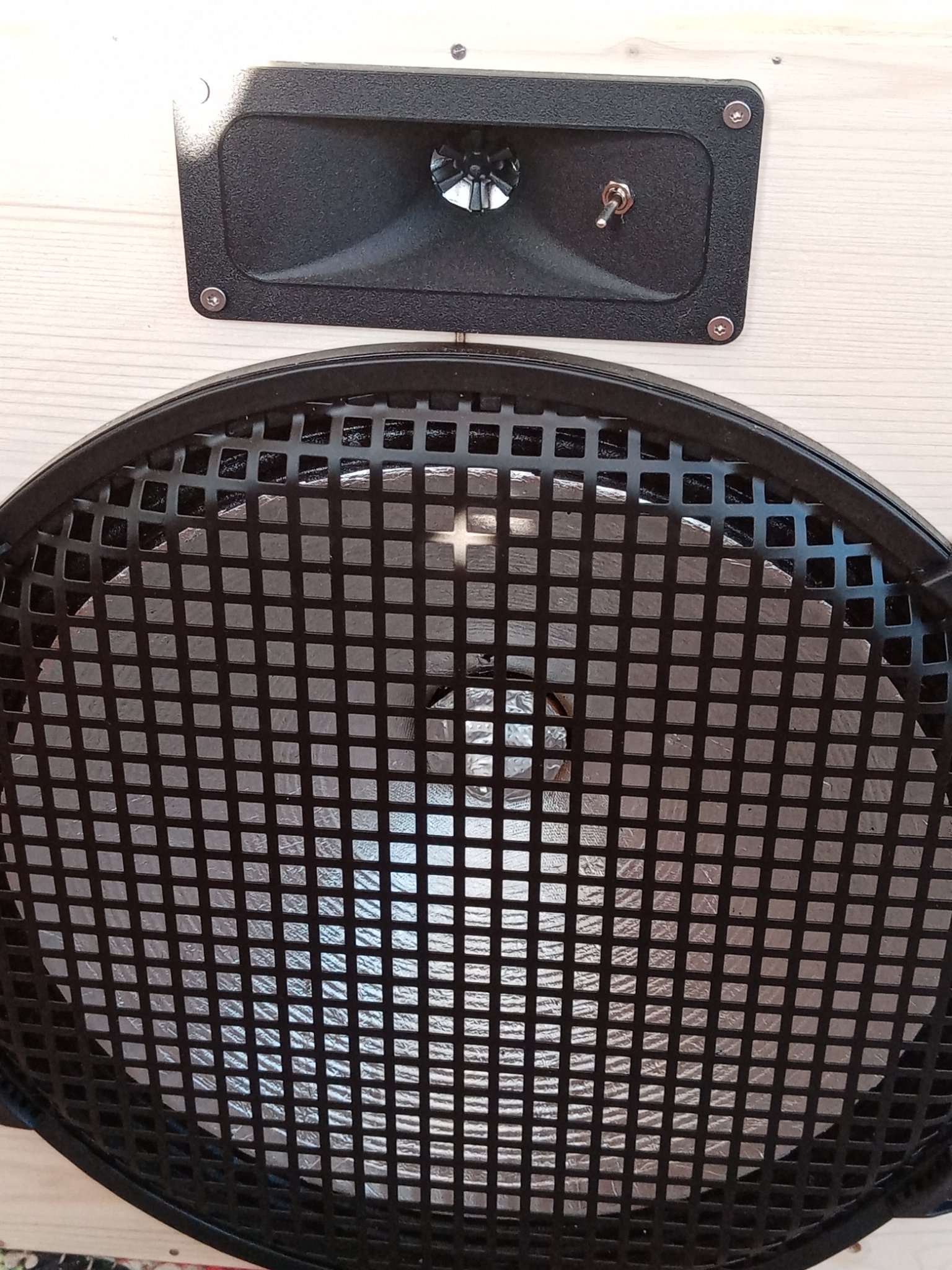

loudspeaker from post 150 got protection grill.
Will make a RCL filter for the +15db peak at 1.8khz.
Simulation shows for a test 15uF, 0.37mh and 10 to 20 ohms for taming that unpleasant peak
in a previous design I put the tweeter concentric in front of the driver. Always sounds good like this.
This time I put it above the fullrange driver.
Turning the box shows the highs sound better integrated with the tweeter at the side, so distance to the ear changes for better.
made a listening test with metal instruments and cymbals.
The aluminized piezo tweeters show with well damped back cavity and proper 6db filtering an attack and "speed" rarely heard. I am quite impressed how well they can sound if used correctly.

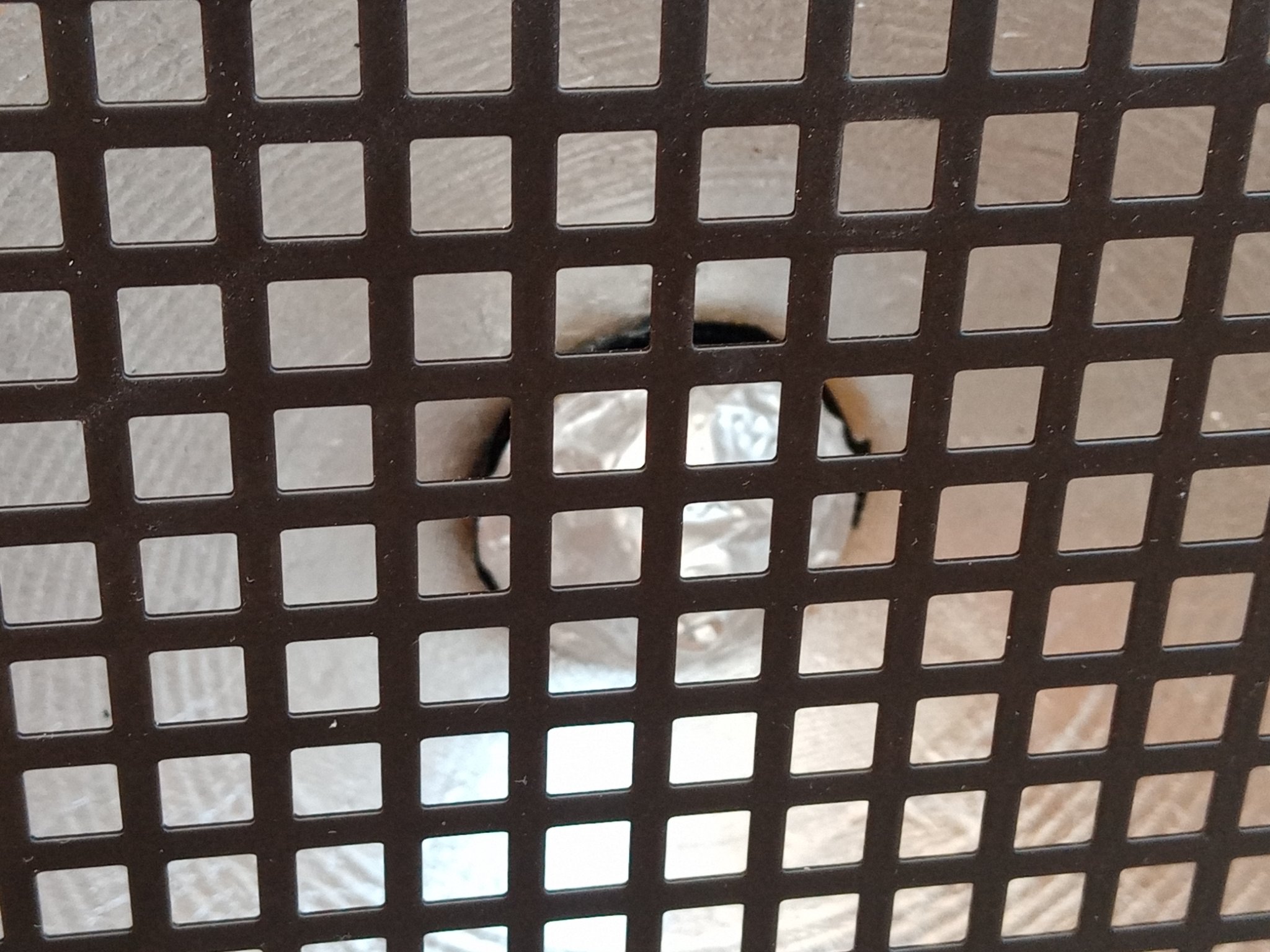

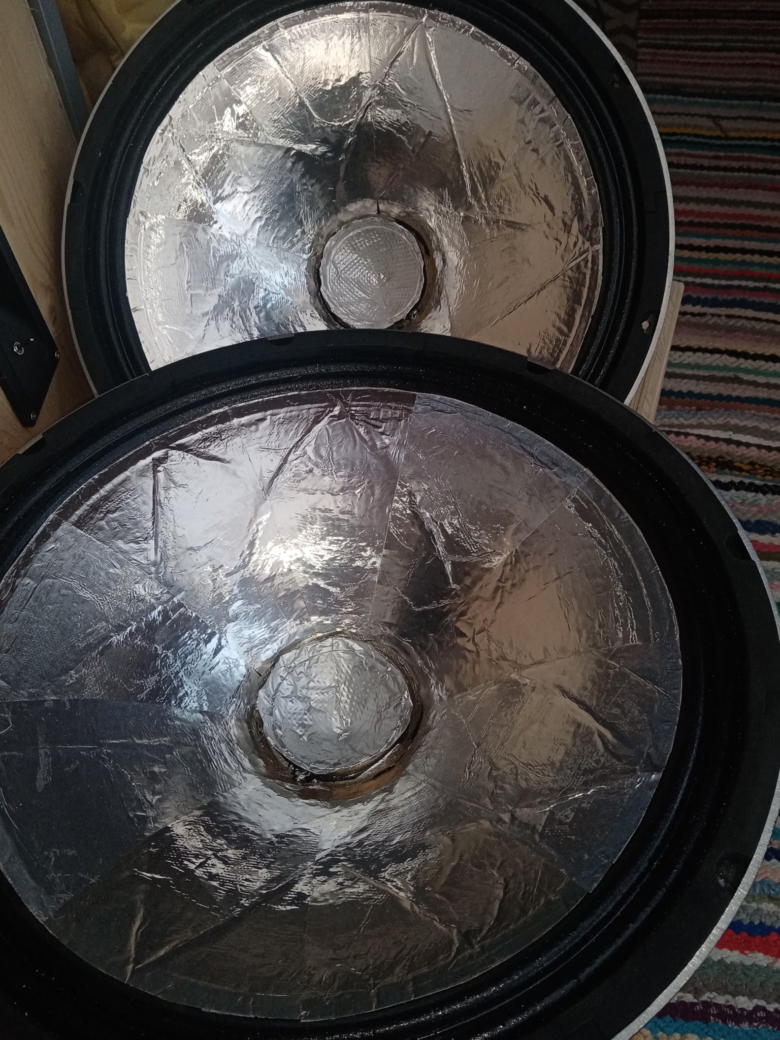

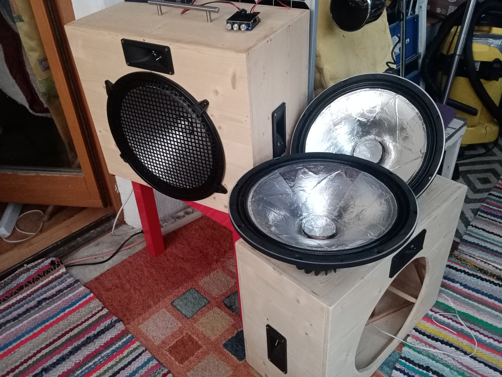

promised to make some measurement of the Fane 15 300tc.
It is sandwich aluminized, double cones are one sided.
damped 70 liter polypropylen box.
But I think I will house them one day in nice wooden boxes.
measured in near field 20cm on axis outside, so no walls only on the floor.
no tweeter active here!
First listening test - its needs with this F response close walls maybe even corner placement and a FBQ 1502 from Behringer won't hurt.
Burst decay is in 25 db but because of the rising response I show 35 db too, to see the mids.
Nice clean mids up to 2khz.
Then the double cones are contributing a bit resonant.
