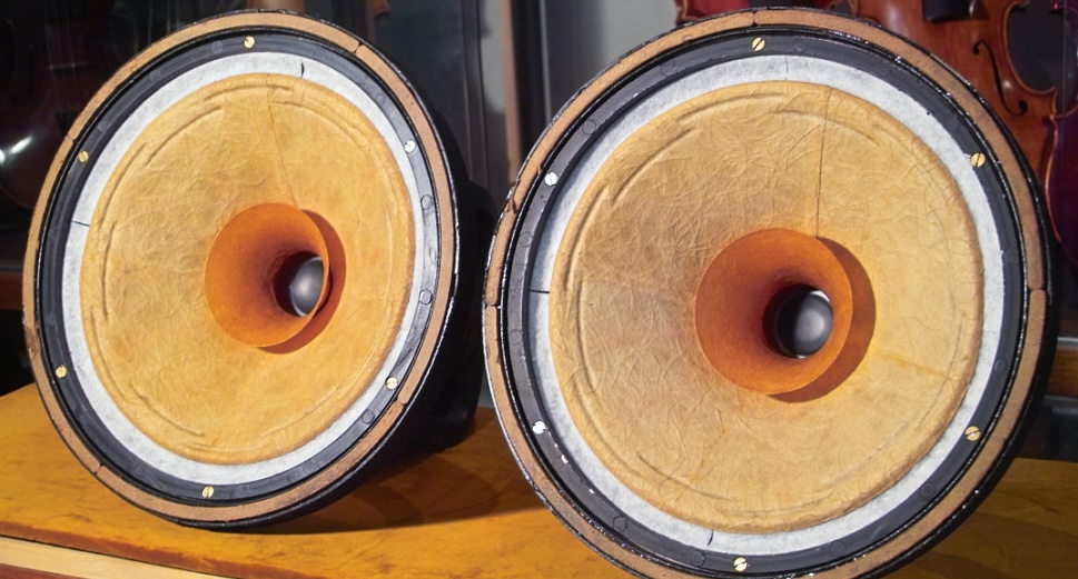

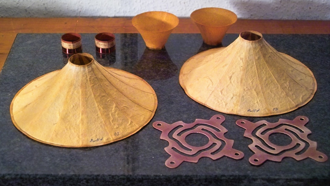

Here you see a fullrange driver of Mr. Pfleiderer which shows several treatments which were done to his creation the FRS20.
some description on it
https://www.hifi-wiki.de/index.php/Pfleid

I visited Mr Pfleiderer in the mid 90ies at the Frankfurt High End fair.
He had a patent on his loudspeaker being able to reproduce square waves and Philipps fought against him and lost before the court.
Frs20 is a point source speaker corrected with an EQ.
Optimized damping of a paper cone at the expense of frequency response and then linearized with EQ.
Sound was quite perfect as the fullrange driver had a faraday ring reducing distortion.
Used three indirect reflecting tweeters above 5khz for the reverberant sound field.
I have a functioning original pair of loudspeakers at home.

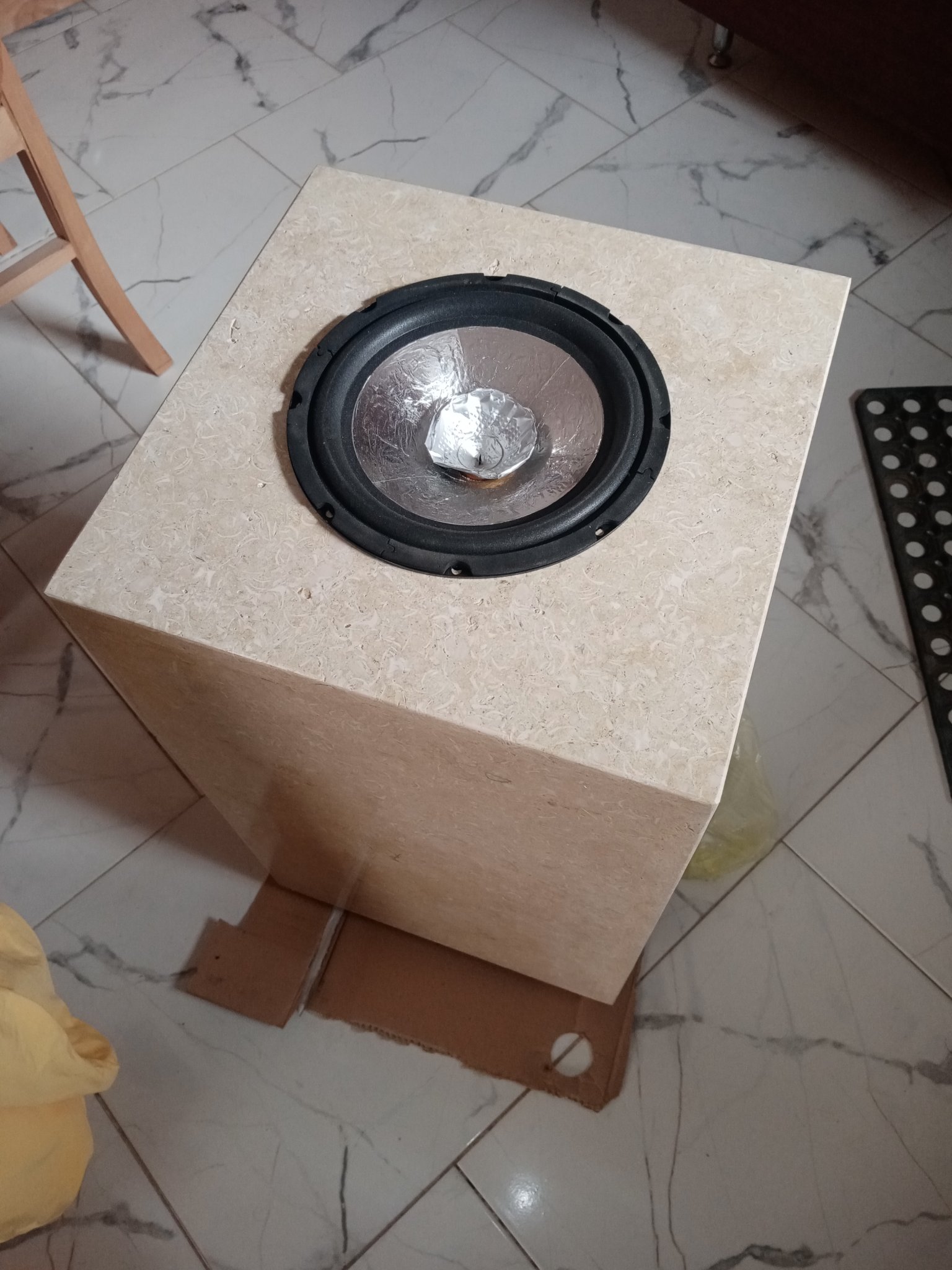

Have you ever opened it to see inside? Do you have any pictures? Is it the marble one?I have a functioning original pair of loudspeakers at home.
yes, I opened them. Its a closed box system and the driver was patented, too. As you can see on the archived website pfleid.de
In the box is white baf wadding.

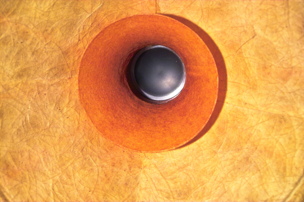

It has a rubber around the voice coil. The idea is to keep the high frequencies in the center and overcoming like that the beaming at these frequencies.

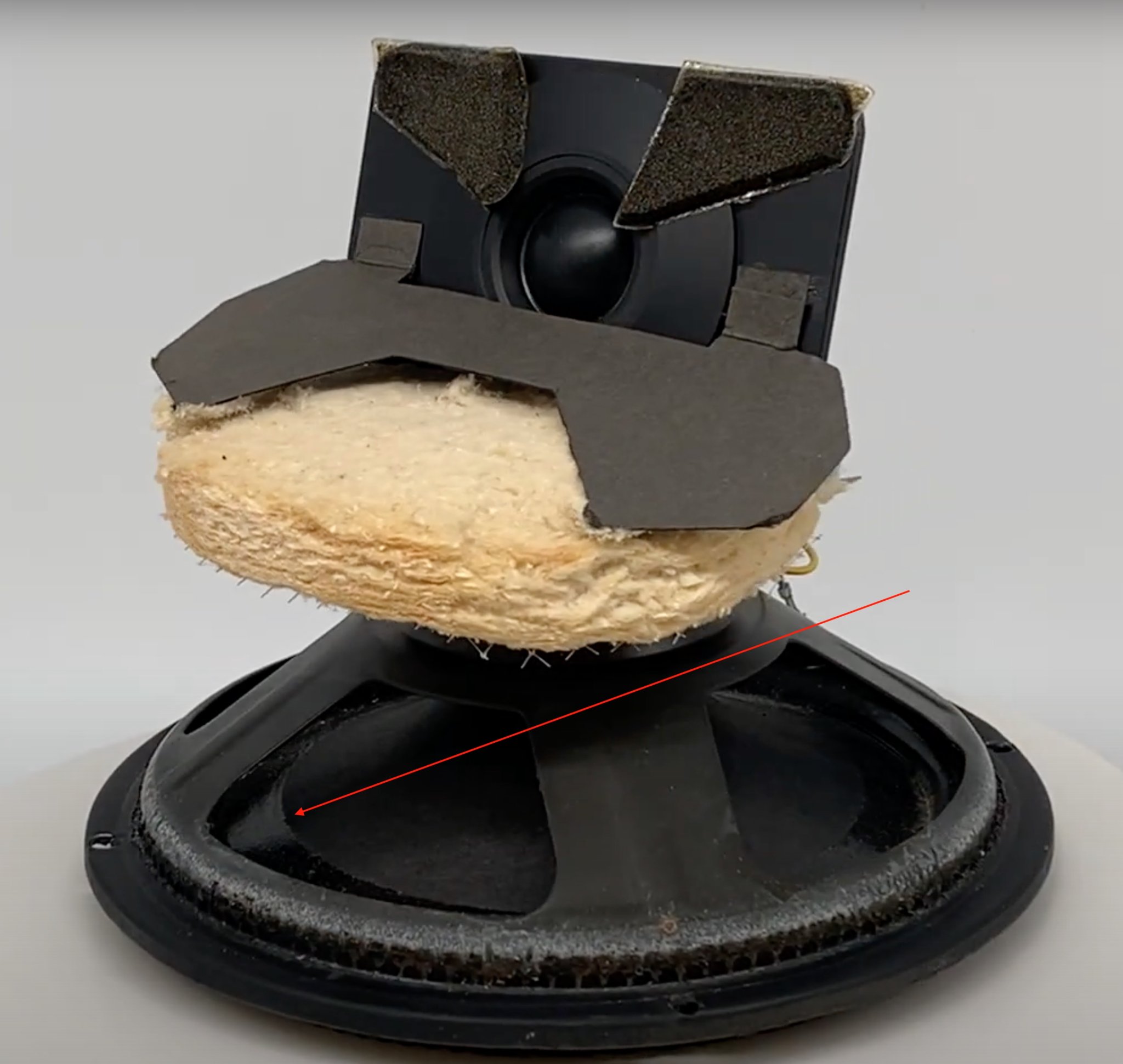

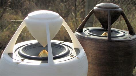

What if you make the wizzer much longer than the main cone itself? Thin and long, you know like the Walsh cone, but not that long, but about twice the depth of the main cone. And, point the speaker upwards?nice to see a structured cone. paper cones could have been since their first production structured thus more stable than only doing straight or nawi cones.
@lekha
i would fear the instability of the whizzer cone.
If you have a really low inductivity voice coil on a fullrange driver and a modern metal basket which is less obstructive on the backside you could simply turn the driver and DSP it for linearity.
Would be a nice omni.
Paper cone does well if you diy aluminize it.

If not walsh alike then traditional upfiring placement of a fullrange driver and some dispersive element does the trick. Don't forget to EQ to taste.

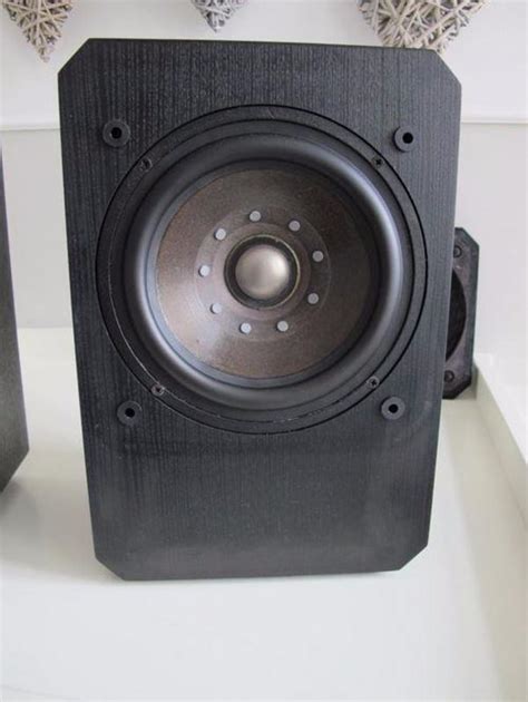

thats a design I made without dispersion element:
loudspeaker with aluminium foil covered, diy whizzer full alu foil, faraday ring on pole piece, double magnet added

Lincoln Walsh didn't live to see his speaker. Others made them later. What I see in it a long thin cone, not as wide as our standard cones, much narrow. German Physiks makes an even narrower and shorter coil. The owner talks about a German Engineer called Peter Dick, who re-made Walsh cone, but I can't find anything on that Peter Dick. Anyway, would you try to check a longer narrower wizzer, maybe made of cardboard? You have the measuring apparatus too.
