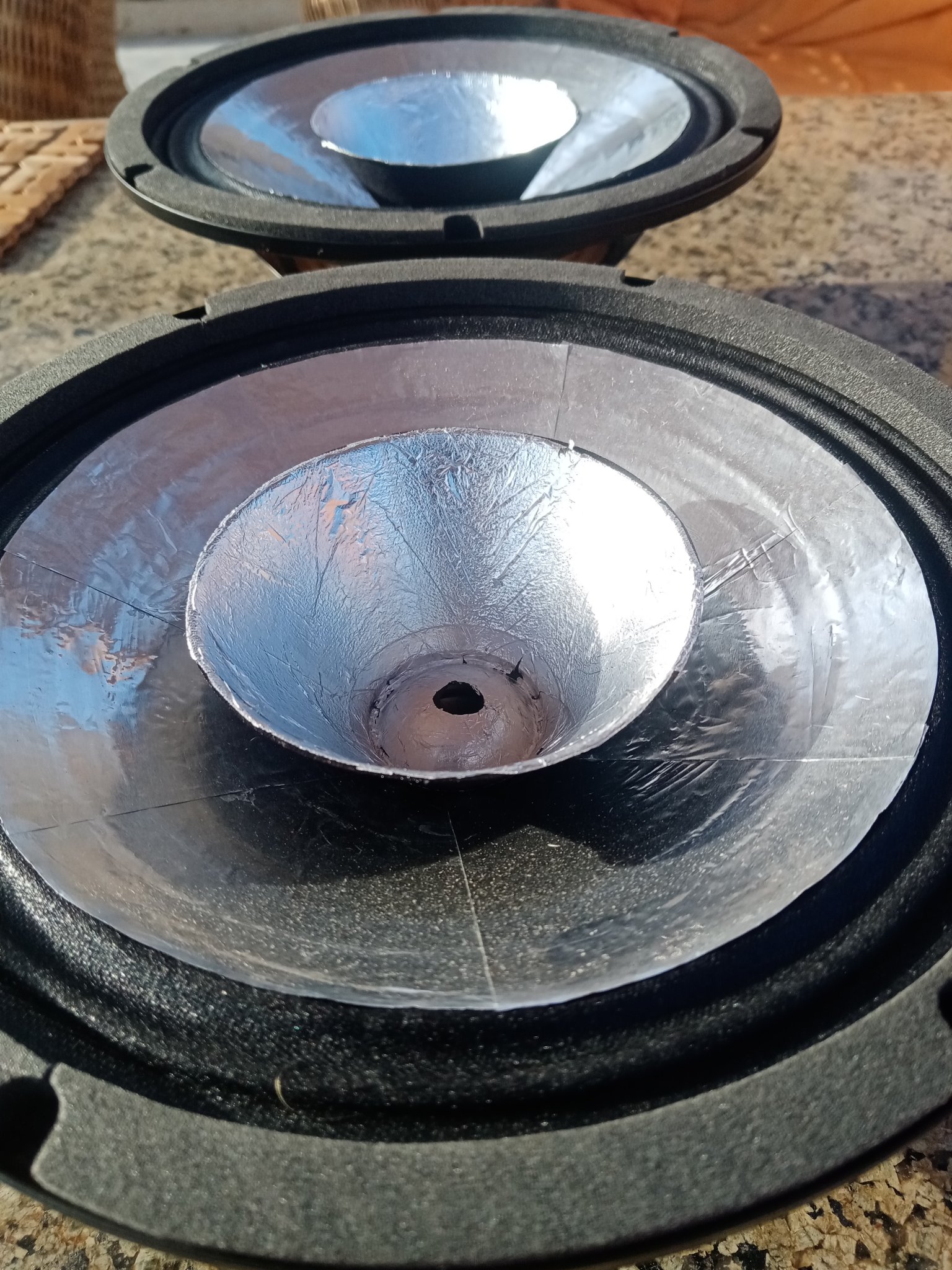

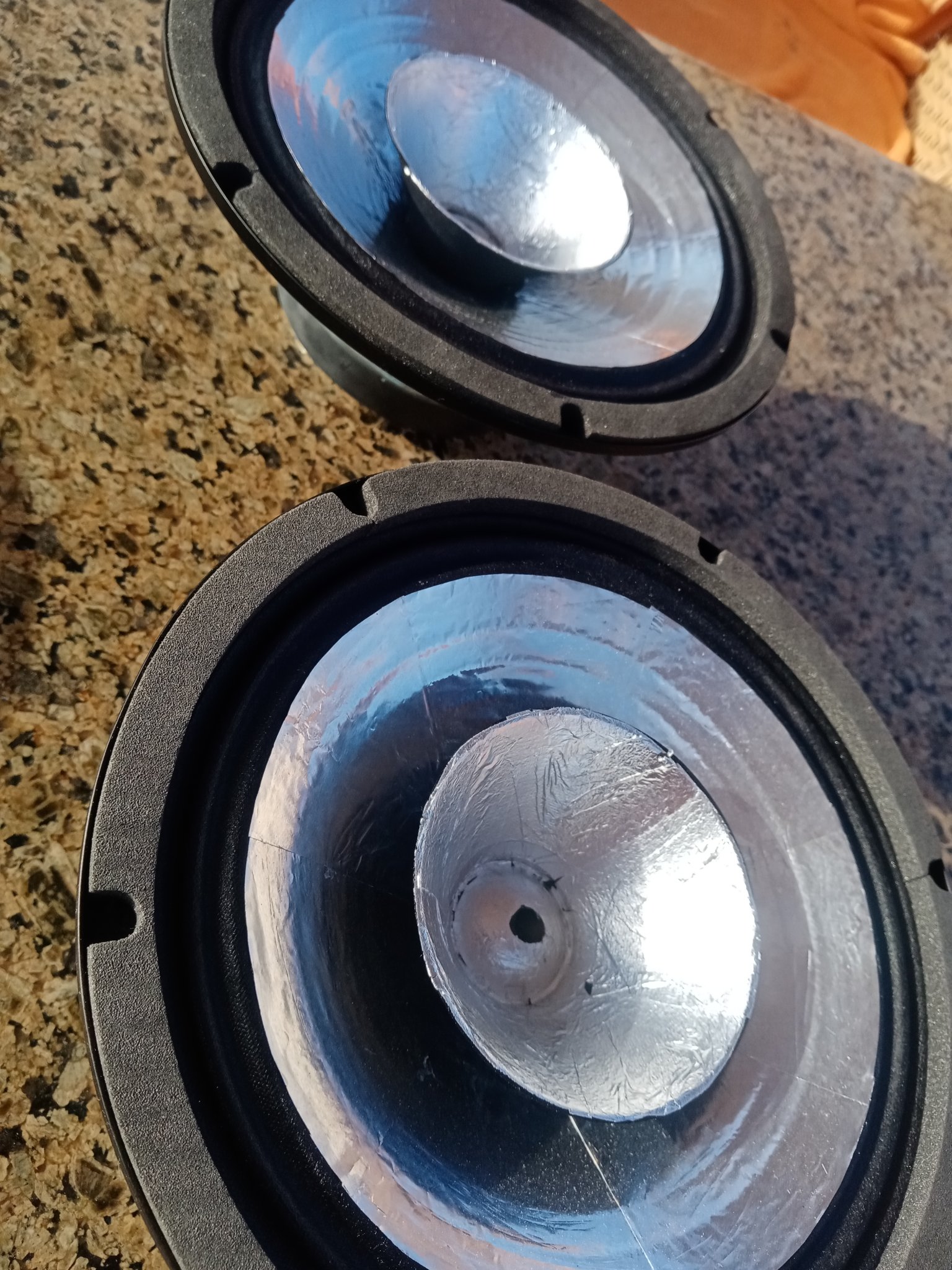

How to make a loudspeaker sandwich cone
Finished Beyma 8 ag/n with aluminium sandwich cone.
Aluminized double / whizzer cone with thin foil from the gold smith.
Tinfoil on both sides of the cone
See also posts
https://www.diyaudio.com/community/...loudspeaker-sandwich-cone.402917/post-7443460
https://www.diyaudio.com/community/...loudspeaker-sandwich-cone.402917/post-7443479
The paper surround was treated with "Anlegemilch dick" (from the goldsmith) to make the paper less susceptible to humidity.
It adds also damping.

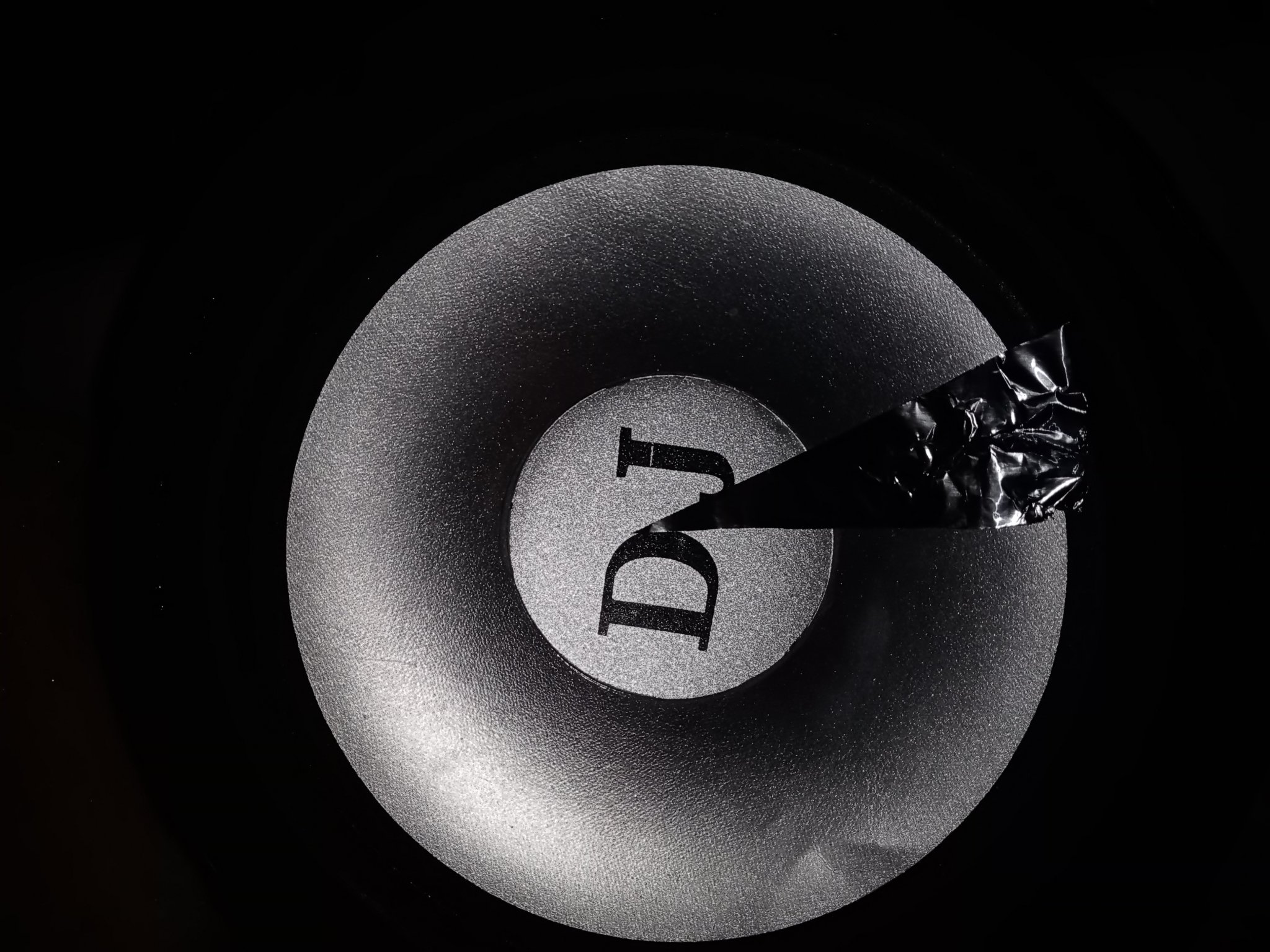

Been following with interest and just purchased a big 2" roll of 0.06mm copper-foil one-sided tape. I guess I just have to try it on enough different drivers (that I wouldn't cry over) to form conclusions. Earlier I used "plast" automotive stretchy tape quite successfully on fiberglass honeycomb and resin-coated carbon fiber (very) hard cones. But on a "coated drum paper" cone the plast (applied only to the back) failed to eliminate high-frequency peak(s)/unevenness. These "hard" drum-paper drivers already have superlative clarity and dynamic articulation/realism.
Is metal foil better suited to softer cones like wool or PP?
Yes, definitely.
Paper and household aluminium foil together minimize resonances.
Its documented here in the thread with waterfall (burst decay) measurements.
One sided covering securely minimizes resonances.
Just make an A / B test with one speaker modified and the other unmodified. The balance knob on the preamp helps to switch fast left to right and back.
However better use glue like Pattex or Uhu and aluminium foil. I do not know if self adhesive foil glues well enough.

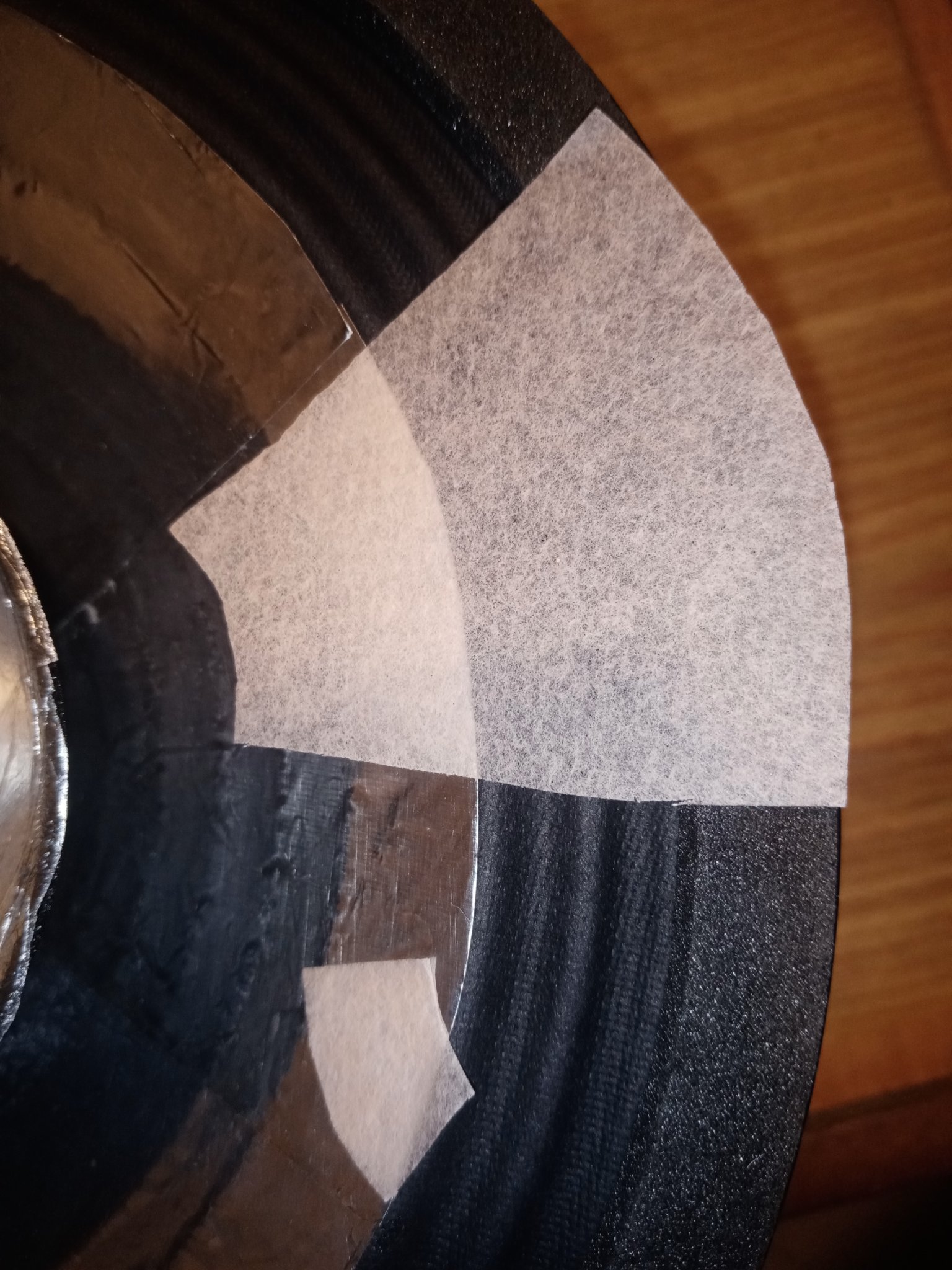

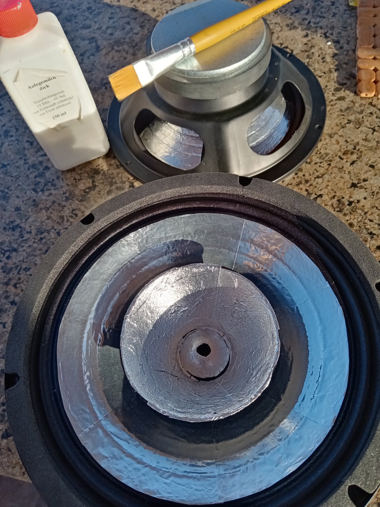

Concerning "Anlegemilch". (thin foil bonding)
For treating a whizzer cone like from Beyma 8 agn:
You first put one layer glue with the brush on the paper.
After short time you glue the thin aluminum from the gold smith with a fresh second layer of Anlegemilch glue.
This technique can be necessary on untreated paper absorbing fluids.
Reactions: wchang
Different than with working with thick(er) household aluminium foils with Uhu and Pattex on loudspeaker paper cones you apply the Anlegemilch glue only on the paper cone.
No glue is put on the thin foil from the gold smith - this foil is too fragile for applying glue on it.

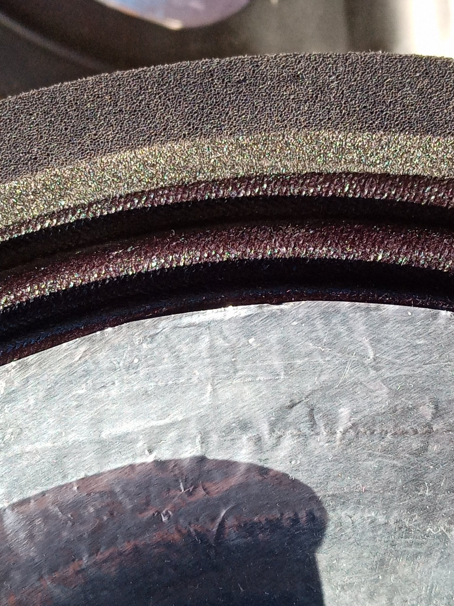

One closer look at the treated paper surround of the cone. Two coats of Anlegemilch.

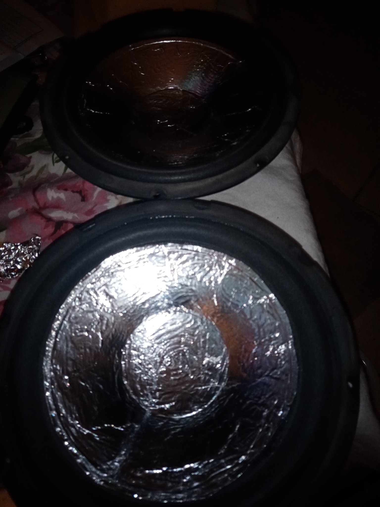

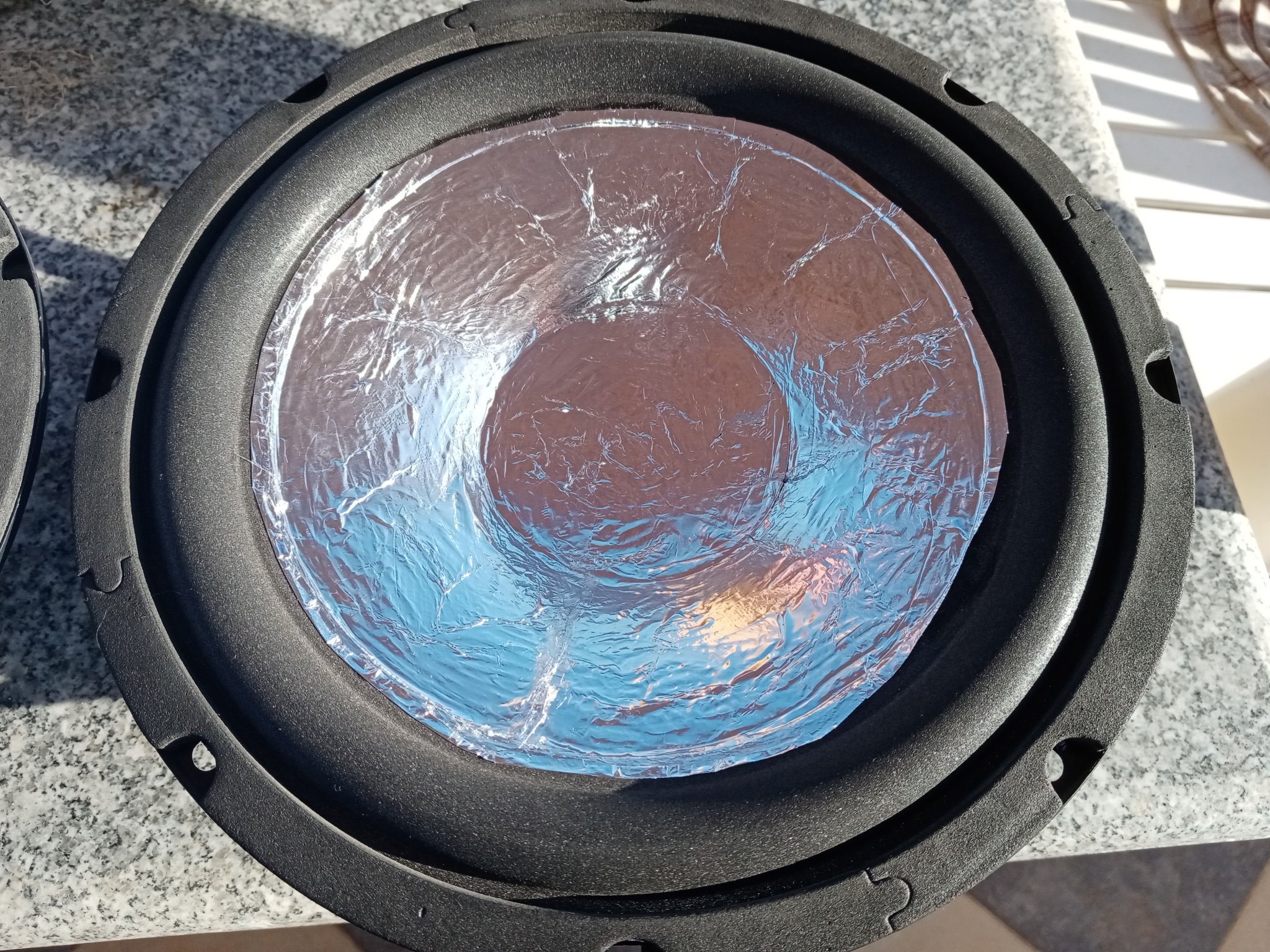

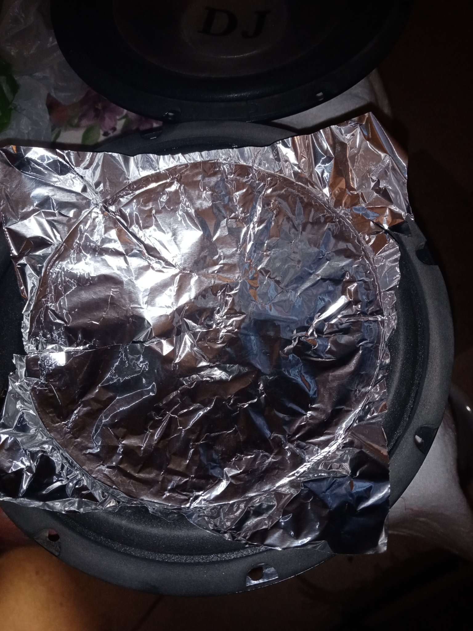

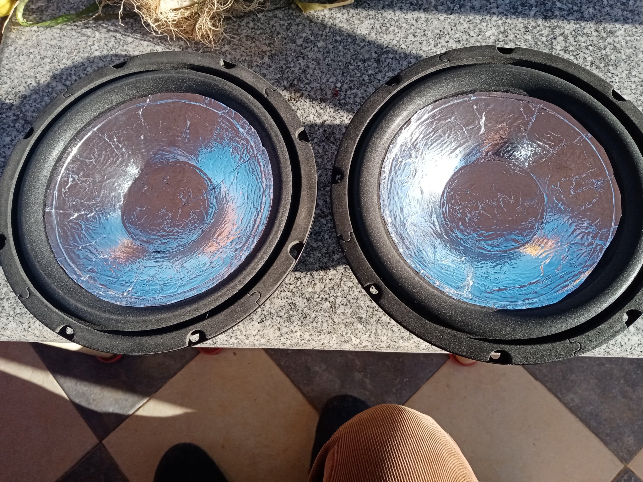

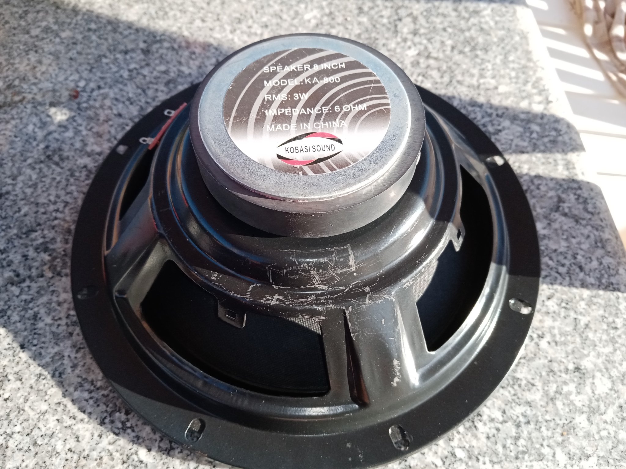

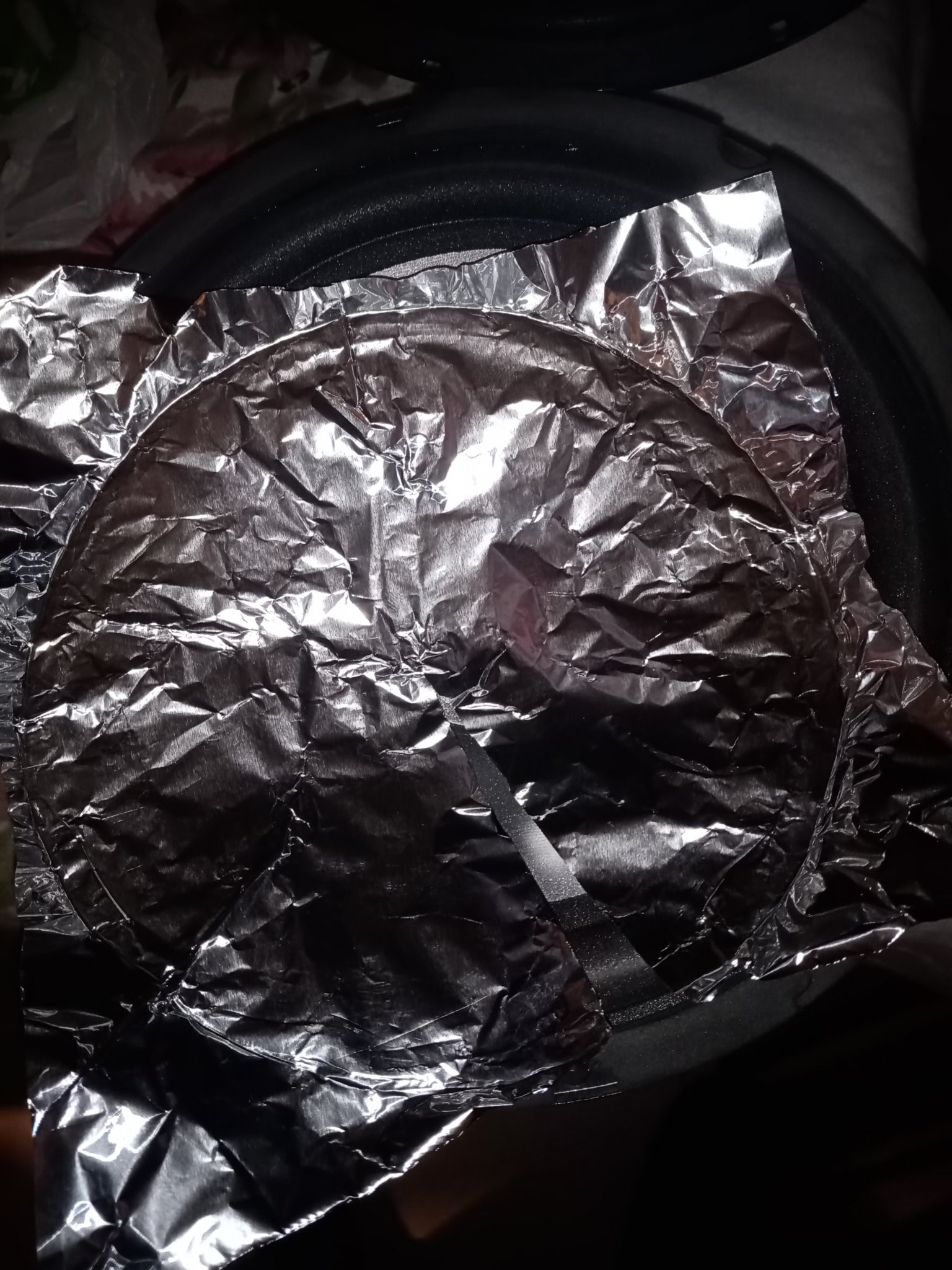

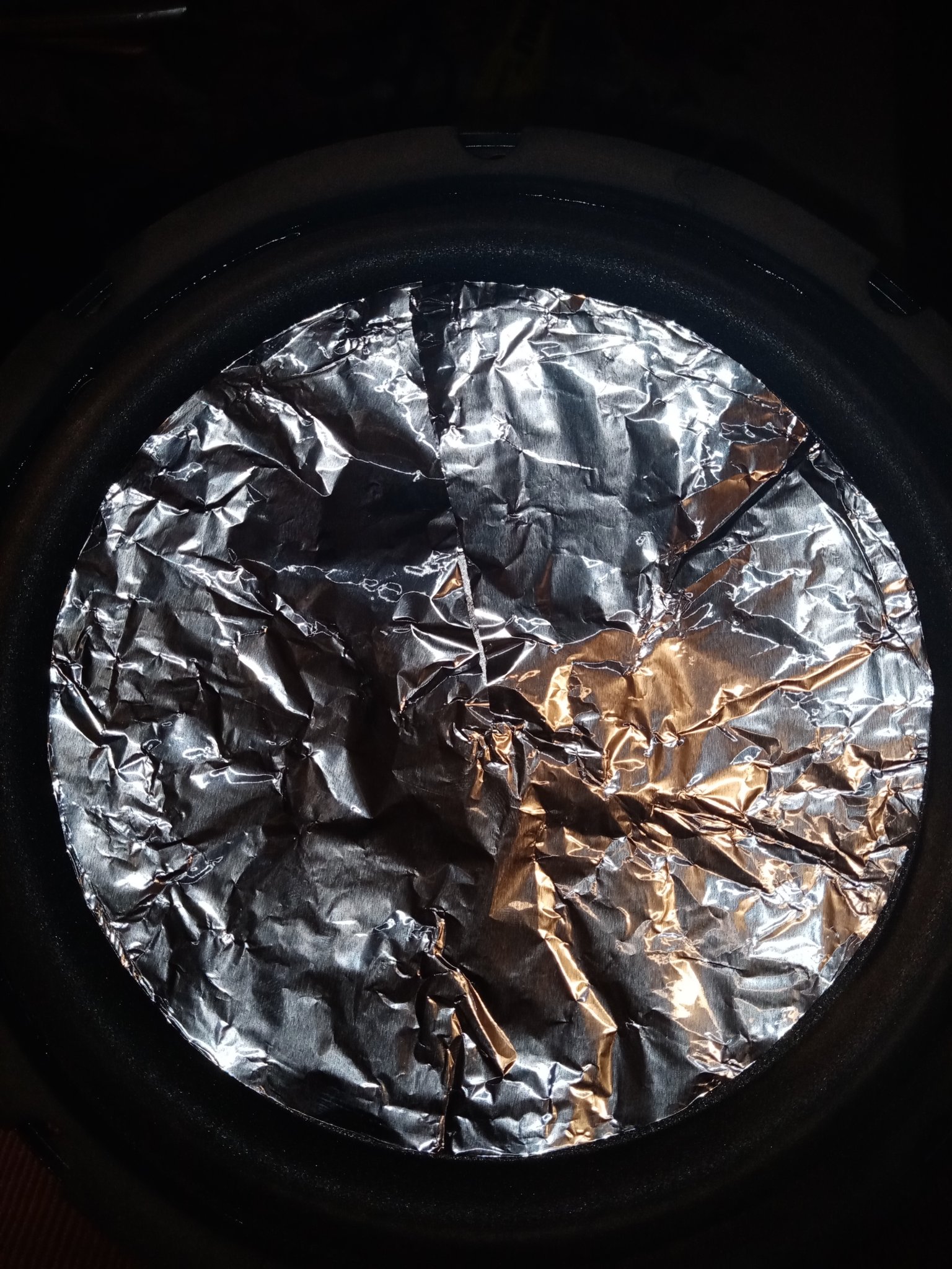

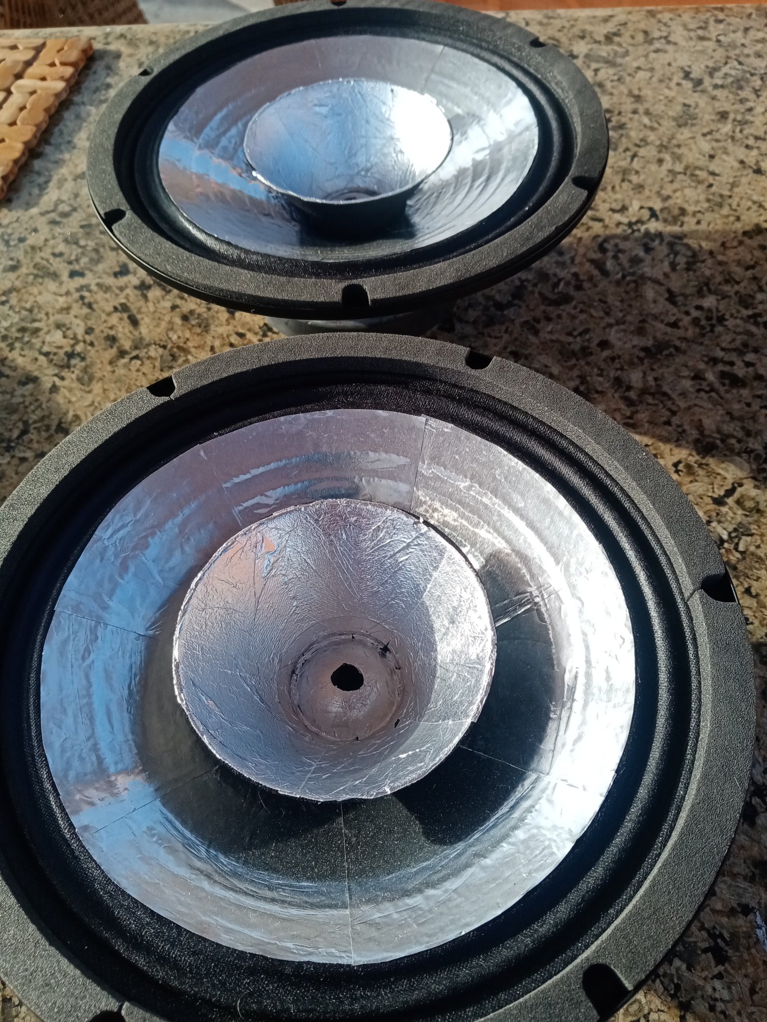

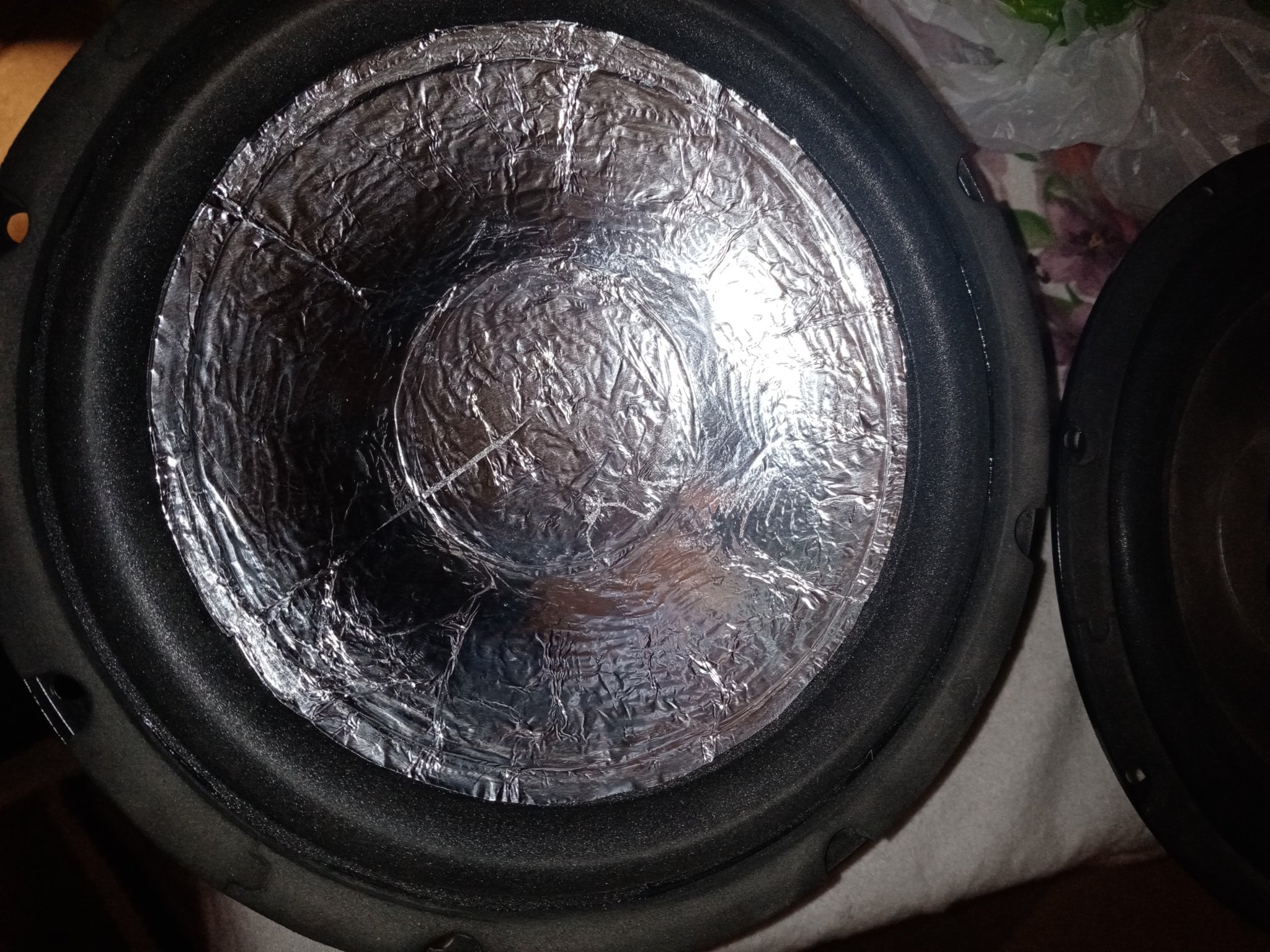

Here an example for a quicker solution to putting household alufoil on a speaker cone. It's an eight inch driver with inverted dustcap.
You can cut the foil as one part. To reduce wrinkles you cut out 1/16 out of the circle.
The Fotos speak for themselves.

Some Fotos with better light.
Already one sided with alu tinfoil there is a great stiffening effect. Will be added as bass for the Beyma 8agn speakers. Used for an outdoor Bluetooth speaker.

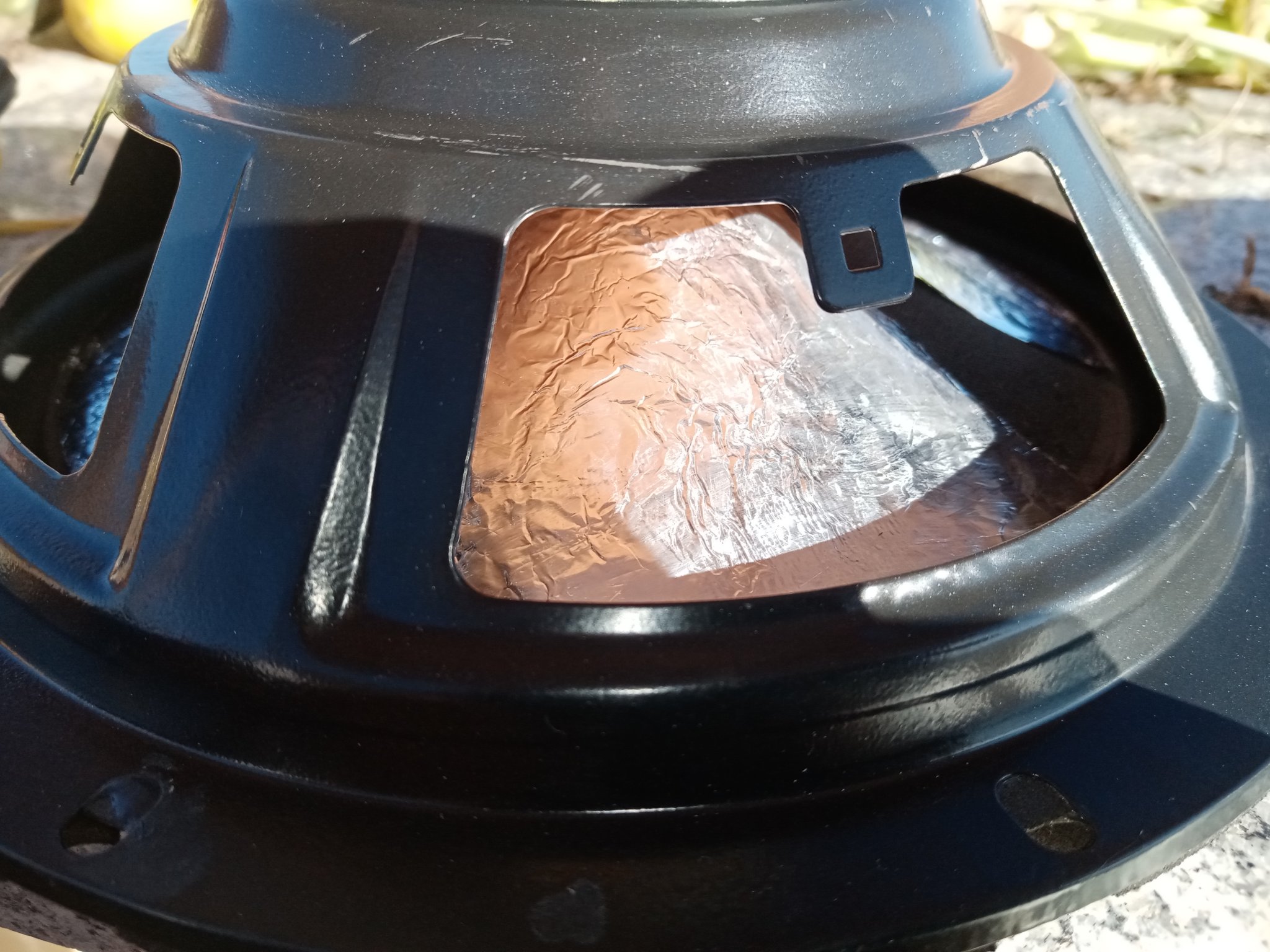

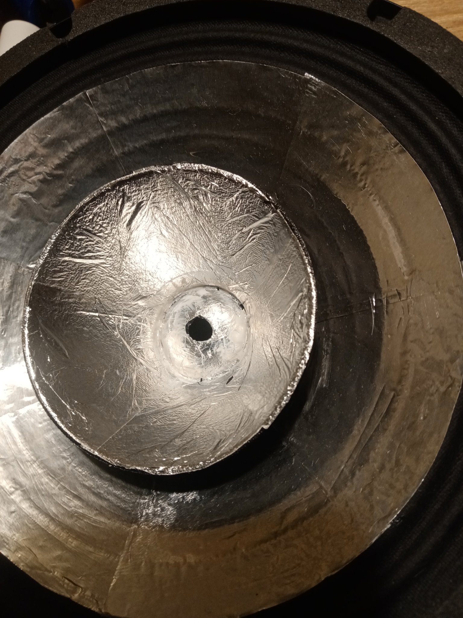

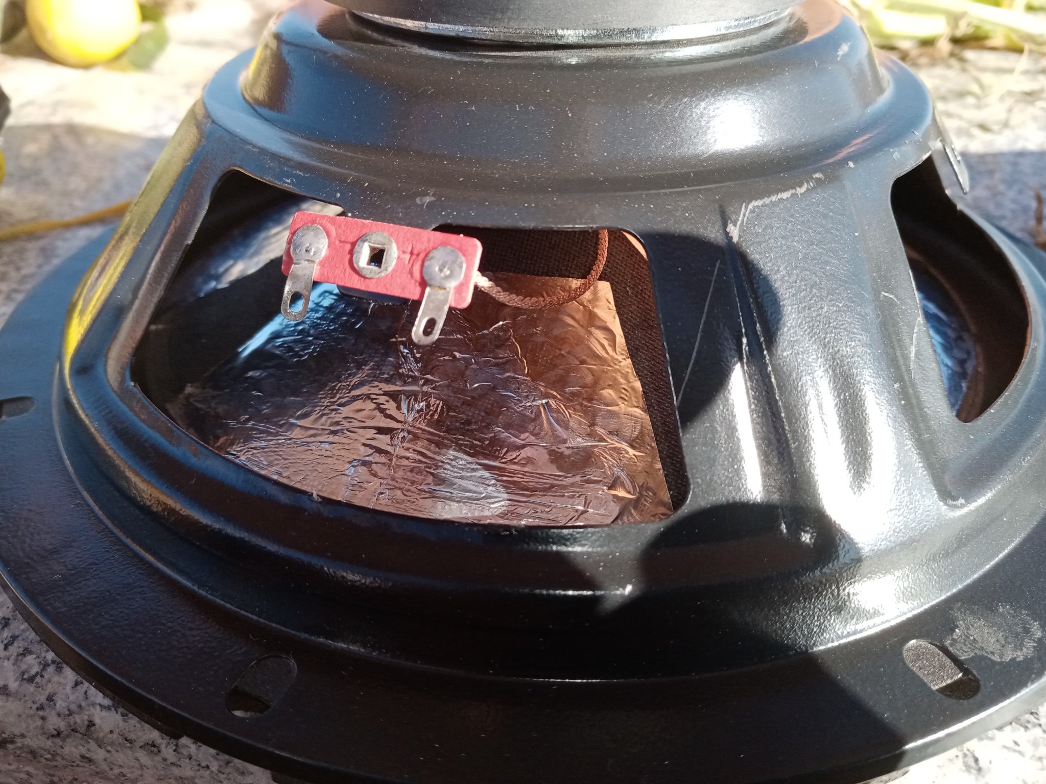

Aluminium foil parts on the backside of the paper cone making it a sandwich construction.
Audibly this reduces pseudo bass due to a bending cone.

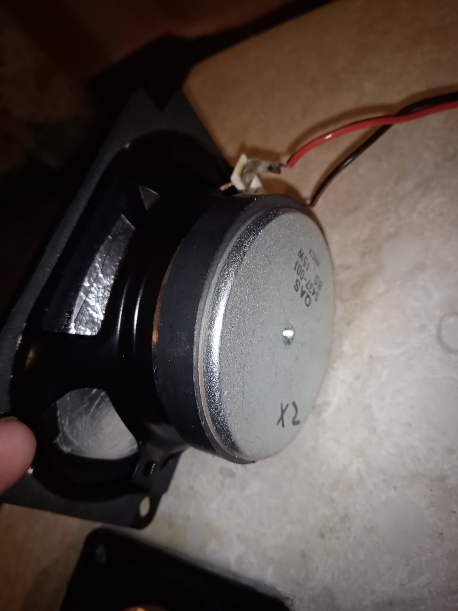

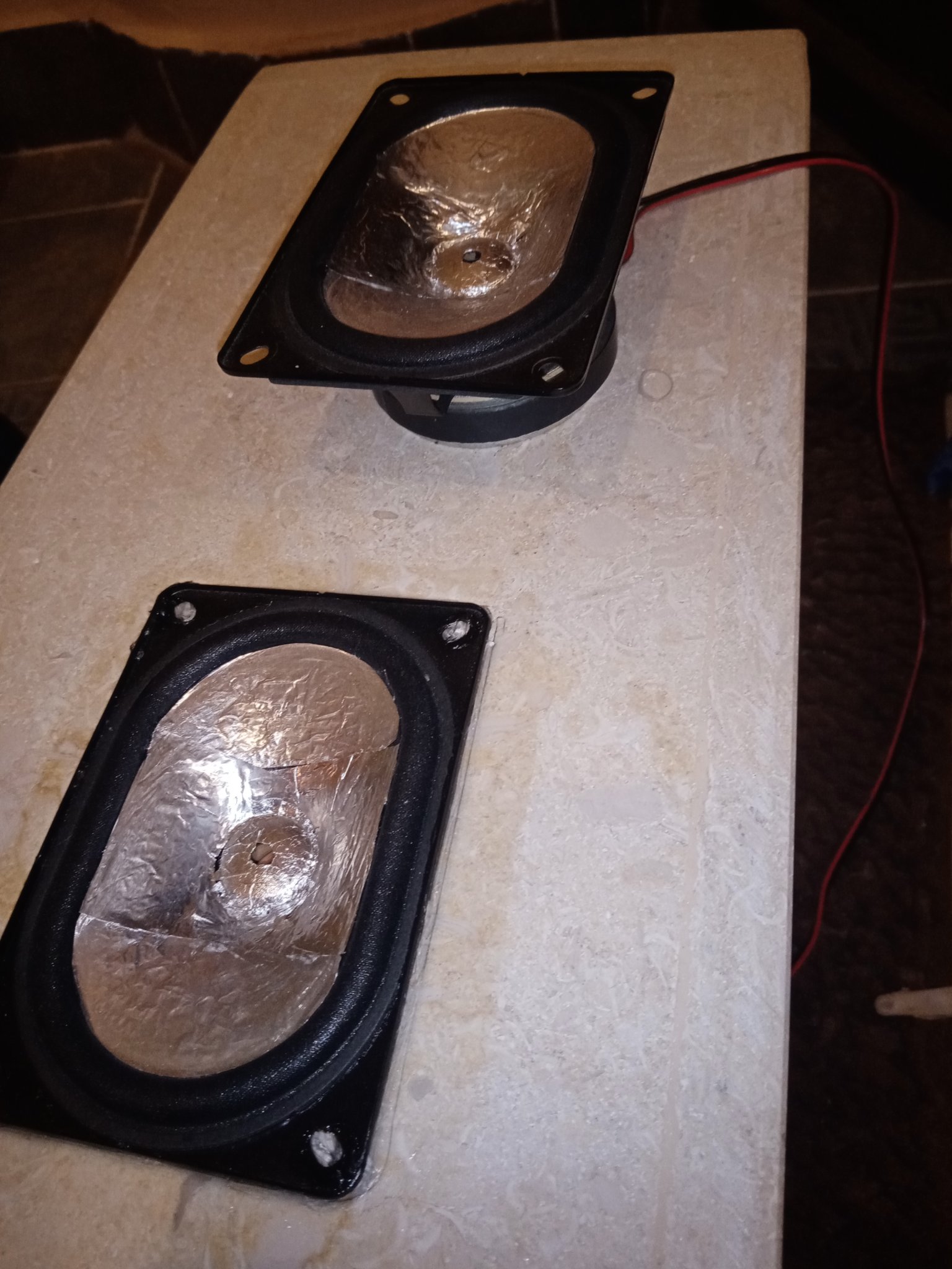

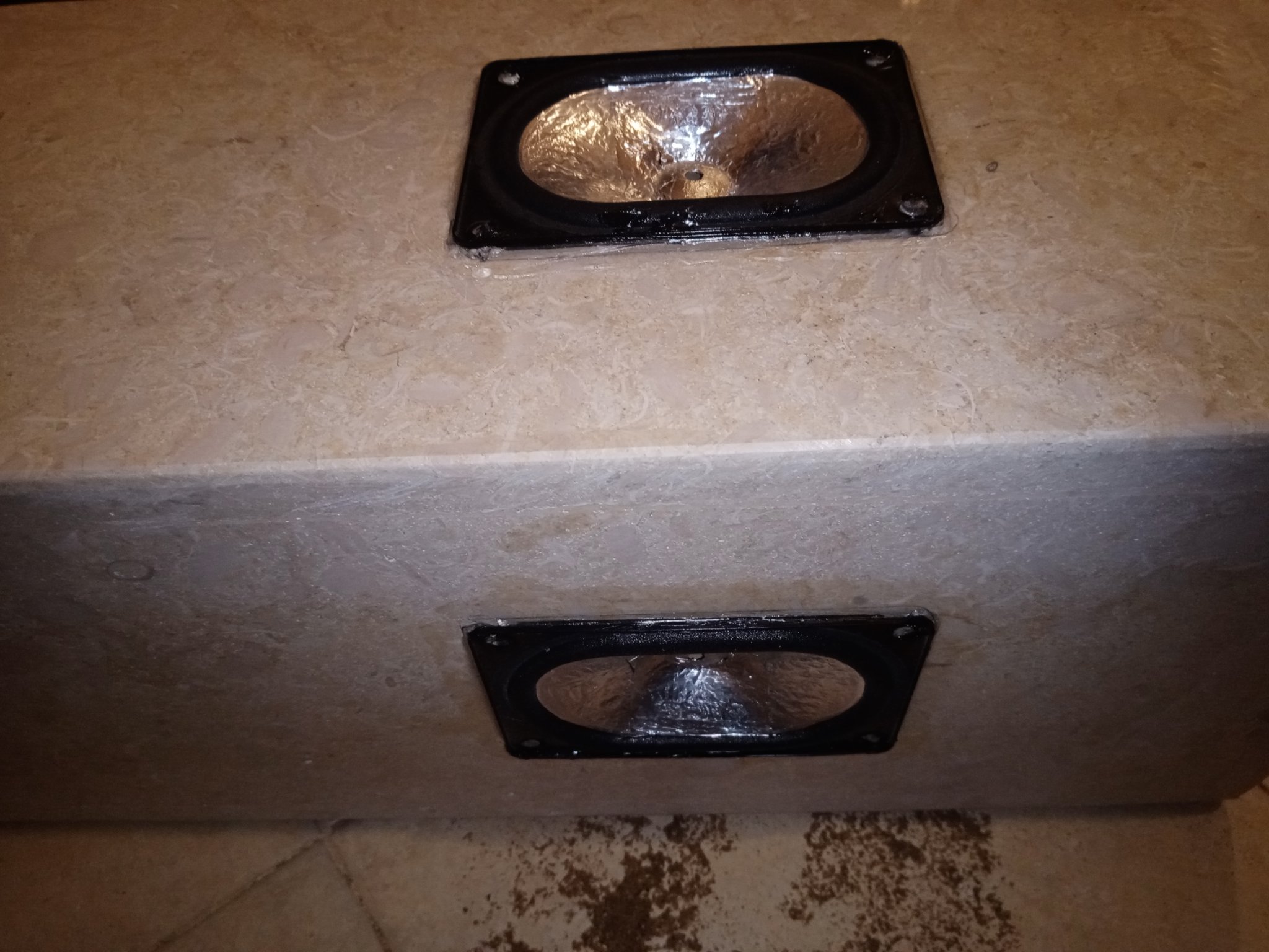

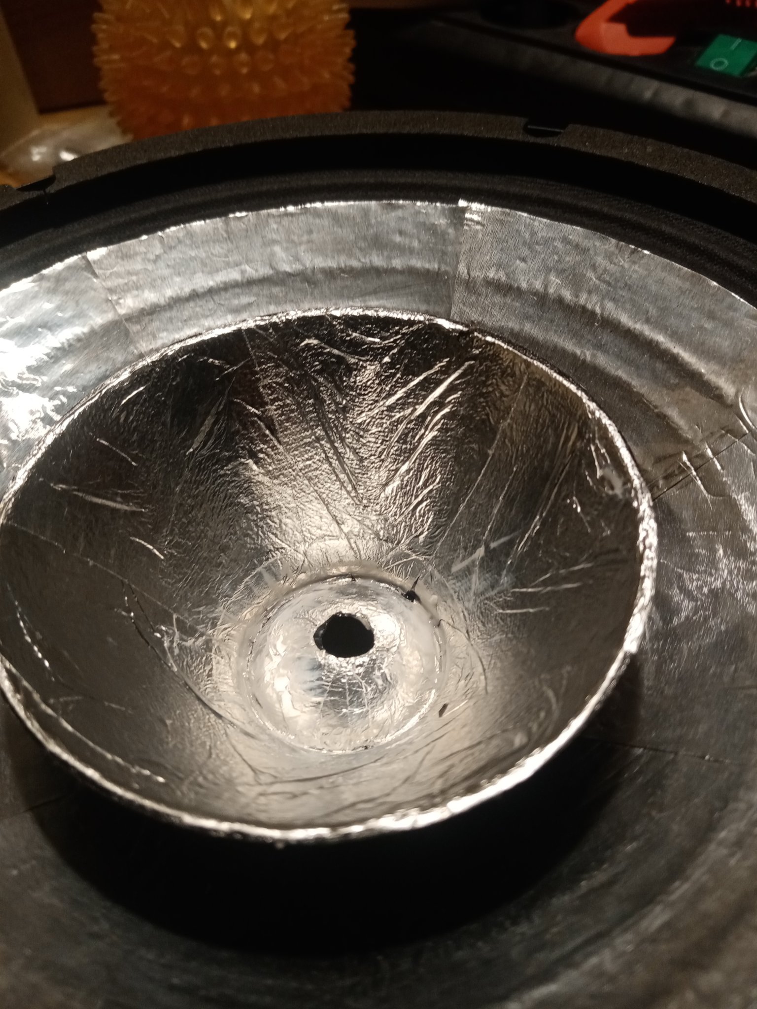

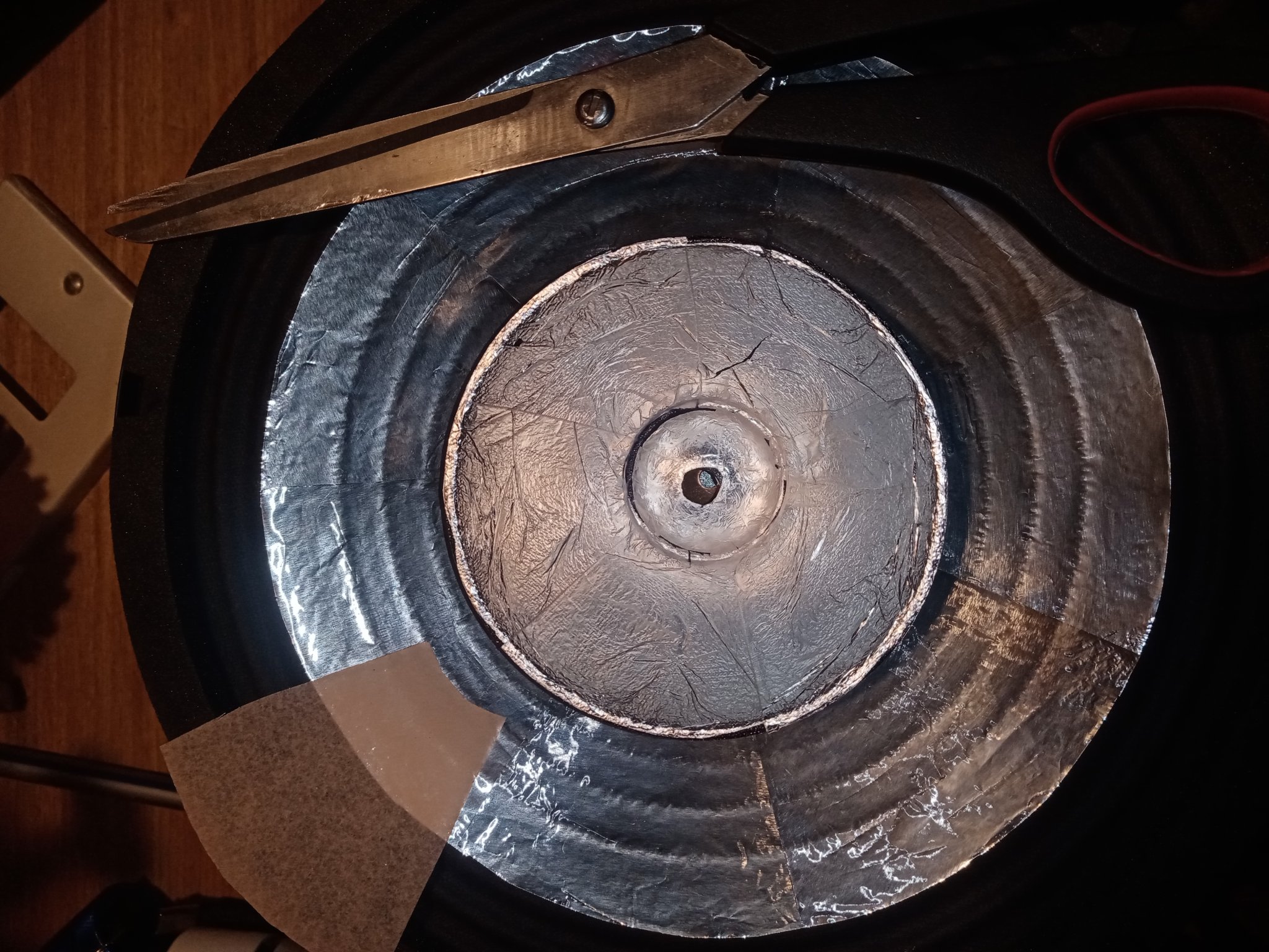

Third Bluetooth marble box about to be finished.
Alu-paper-alu sandwich cone.
Front of the cone is with aluminium household foil treated. Backside with thin foil from the gold smith.
Working with the thin foil is faster as the beaten aluminum delivered in books makes it easier to cut the foil in shapes.

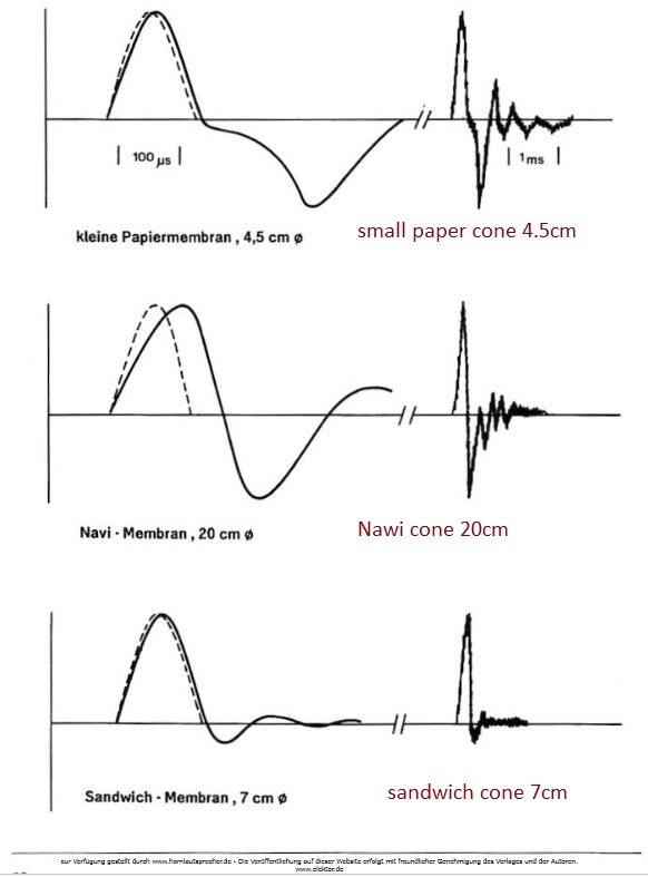

Concerning sandwich loudspeakers here some information, page 92 in the book, showing impulse responses in comparison:
small paper cone 4,5 cm, 20cm navi paper cone and 7 cm sandwich cone.
The 7cm sandwich cone has a better impulse response than the smaller 4.5 cm paper cone
